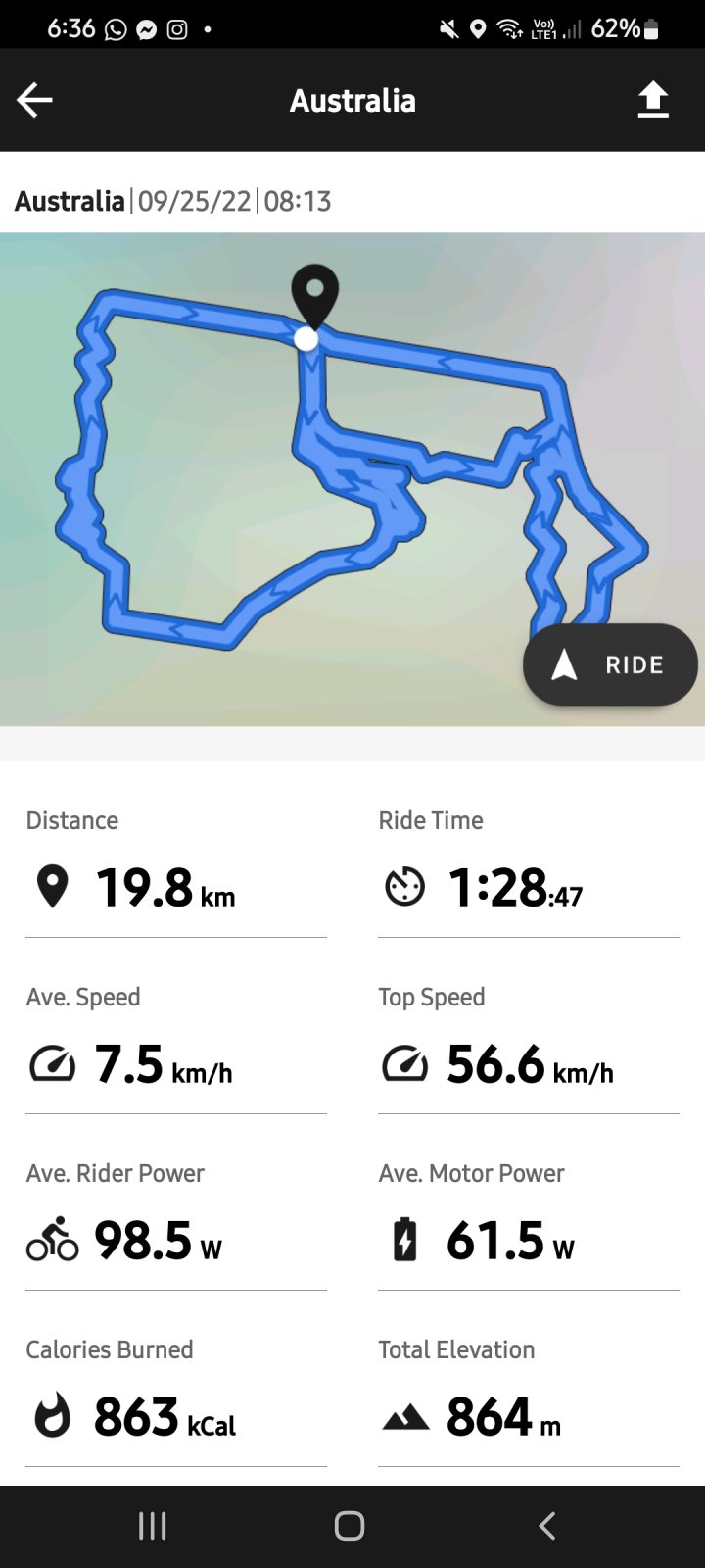

Fuel EXe Trek Fuel EXe - Trying to understand range and altitude possibilities
I searched and found only the below which says either no drag or very low drag. Obviously my search foo is failing. :(
It would seem it is, yes, perhaps similar to your drag detection foo?!? If you want the proof, pop your bike in a workstand (mind your back as you lift!), then pull back on the upper chain run. Remove the bike, pop a non assisted bike in the stand, and pull back on the chain again. Do let us know how you go...
I'm on an XL 9.8 XT Fuel Ex-e.
There have been a couple of tweaks to the spec including Maxxis DHF DHR combo with Exo plus casing. Tannus armour inserts and. 240mm dropper which weighs a bit more than the stock item.
I'm 107kgs ready to ride.
I love the bike and it rides beautifully up and downhill. Being open, it'd be nice to have a touch more power / range but with my weight it's going to test it far more than someone weighing 25kgs less.
If more range + power meant stodgy handling, I'd leave it as it is.
I'll share more range details as I log more rides.
On this ride, there are some climbs where hi power is required, then on others, I've got it on eco or no assist at all.

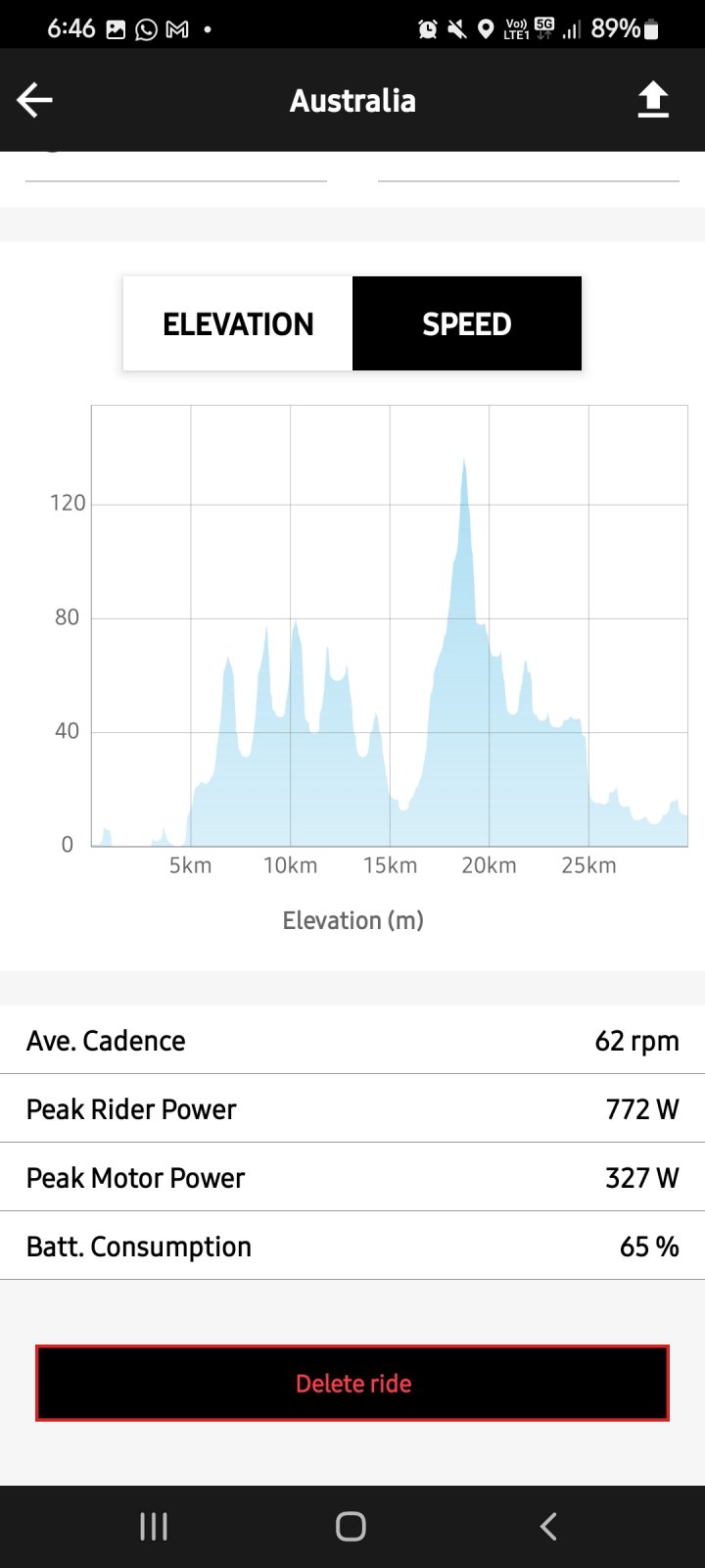

Another run on the Fuel Ex-e and this one was at a location with less elevation and more general pedalling if that makes sense. As a result it can be run in eco / off more often and with less time in mid or high.
After 30kms and 584 metres of elevation I had used 65%.
Based upon this, and at this location I'd anticipated ~40kms - 45kms range with 750m to 850m of elevation. It might have been a bit more as on the flatter sections and trails I ride with assistance off.
Again, bear in mind my rider weight of 107kgs.
