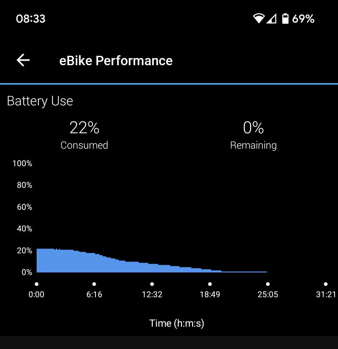

This thread made me think that the BMS on the standard battery might need to be run down to absolute 0% in order to get an accurate calibration of the capacity of the battery, and I couldnt actually remember if I had ever taken mine down to actual 0%, I know I've been down to 1% before, but I didnt think I had ever run it down all the way to zero. So my thinking was that if I hadnt ever run it down to zero, then it might be miscalibrated and I might be missing out on a few percent of usable battery.
So on Saturday I went for a ride, and watched the battery tick down , it went down from 10% to 1% quite steadily, but once at 1% it stayed there for about 4 times longer than it had taken to drop from 2% to 1% (see graph from garmin connect below)..
But what I dont know if whether by doing this, the BMS has now calibrated itself so I get an extra 4% before the 10% cutout occurs, or whether I will always just get a bit longer at 1% .

Perfect you have anticipated.
Exactly what you propose is what must be investigated, I am also afraid that that 4% more that you have taken varies a lot depending on the type of route and assistance that you have done.

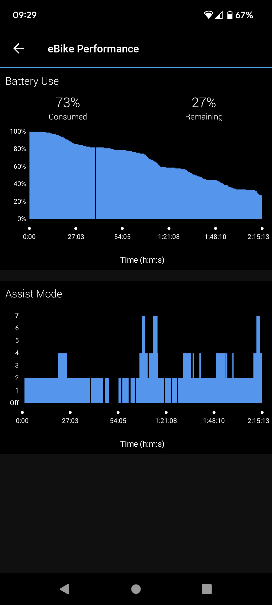

How do you get that graph that you have posted interests me a lot.

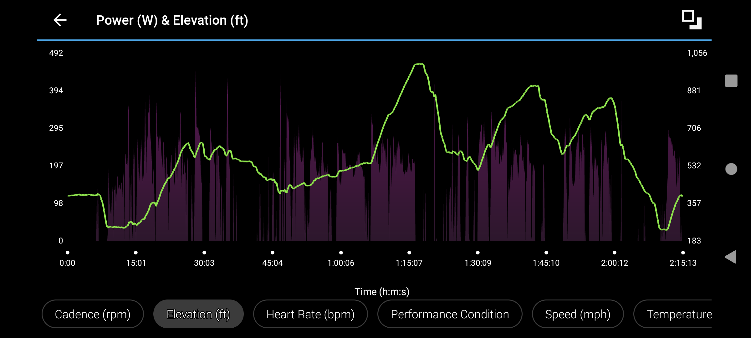

if you have garmin watch (or bike computer - and I guess other brands will work too, but I have a garmin fenix 6 watch), you pair it up to the TQ display ANT+ sensors, the bike transmits the following data:-
- Ebike battery level
- rider power
- cadence
- speed
- assist mode
Then on the watch (or bike computer) , when you ride you record the activity on the watch, and when you sync the activity into garmin connect, you can view the data from the bike, the screenshots below shows some data from a ride I did last night. Below shows battery level and assist mode, and the other shot shows rider power and elevation, but you can customise the data that is shown, so you could have rider power + cadence on the same graph for example
@Mteam Did you have to download a widget or data field to get this? I have a Fenix 5 & it doesn't by default have an e-bike field in it's list of activities.
no I didnt need to download or install any special data fields etc, its all just standard in the watch, but confusingly the ebike battery level is not listed under an ebike section, it can be found within the "GEARS" set of data fields along with info about DI2 gears etc, its called eBike Battery , also in there is eBike Range

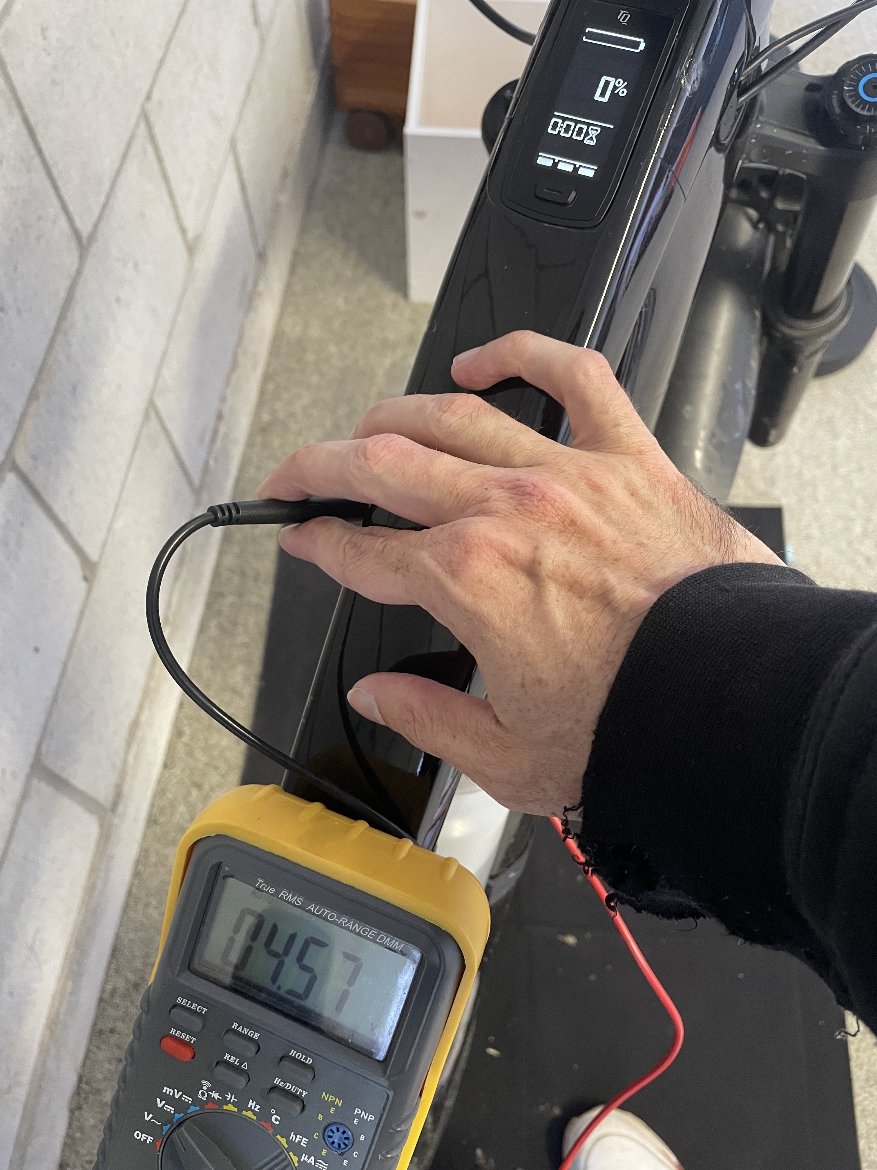

I need a little collaboration, someone can measure the voltage that the bike gives through the charging port at 100% and 0%, I am doing autonomy tests and there is voltage data on the new battery that does not fit.
The voltage is measured with a tester with the bike on.
Thanks
A bit late but I just ran my battery down to 0% for the first time (been through a few charge cycles, I’ve done about 900km on it) and I get the following (4.57V)
Let me know if you want more info, I’ll charge it back up in a couple of hours
ok thank you very much, more voltage taps are not necessary, I am quite clear about what is happening.

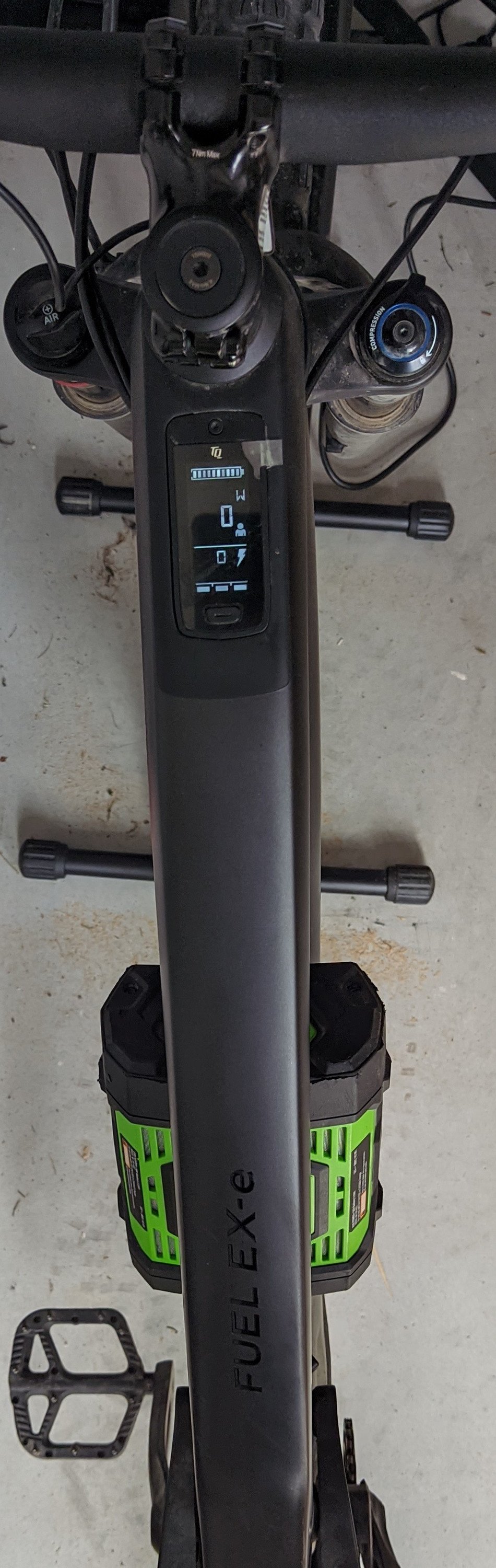

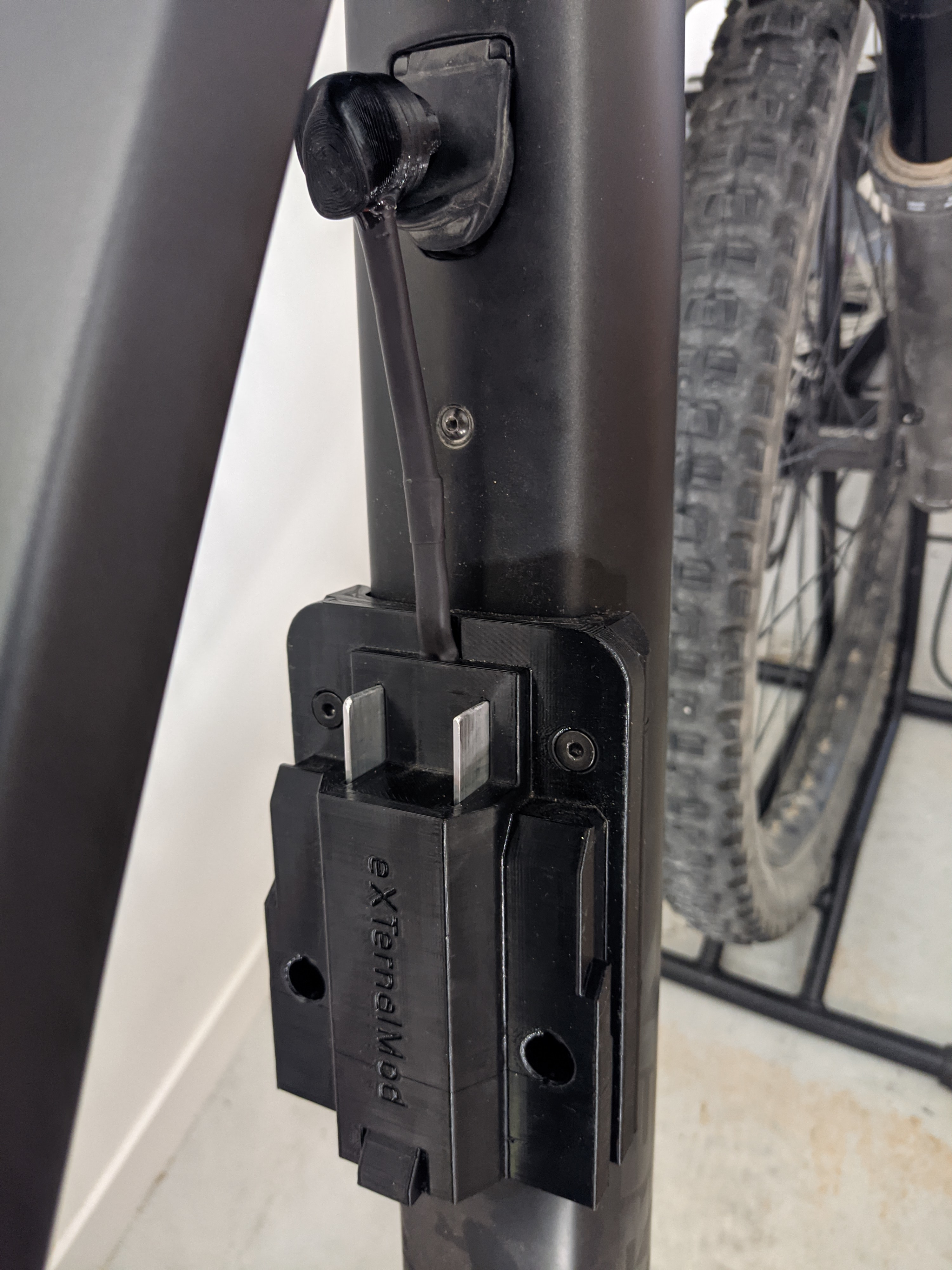

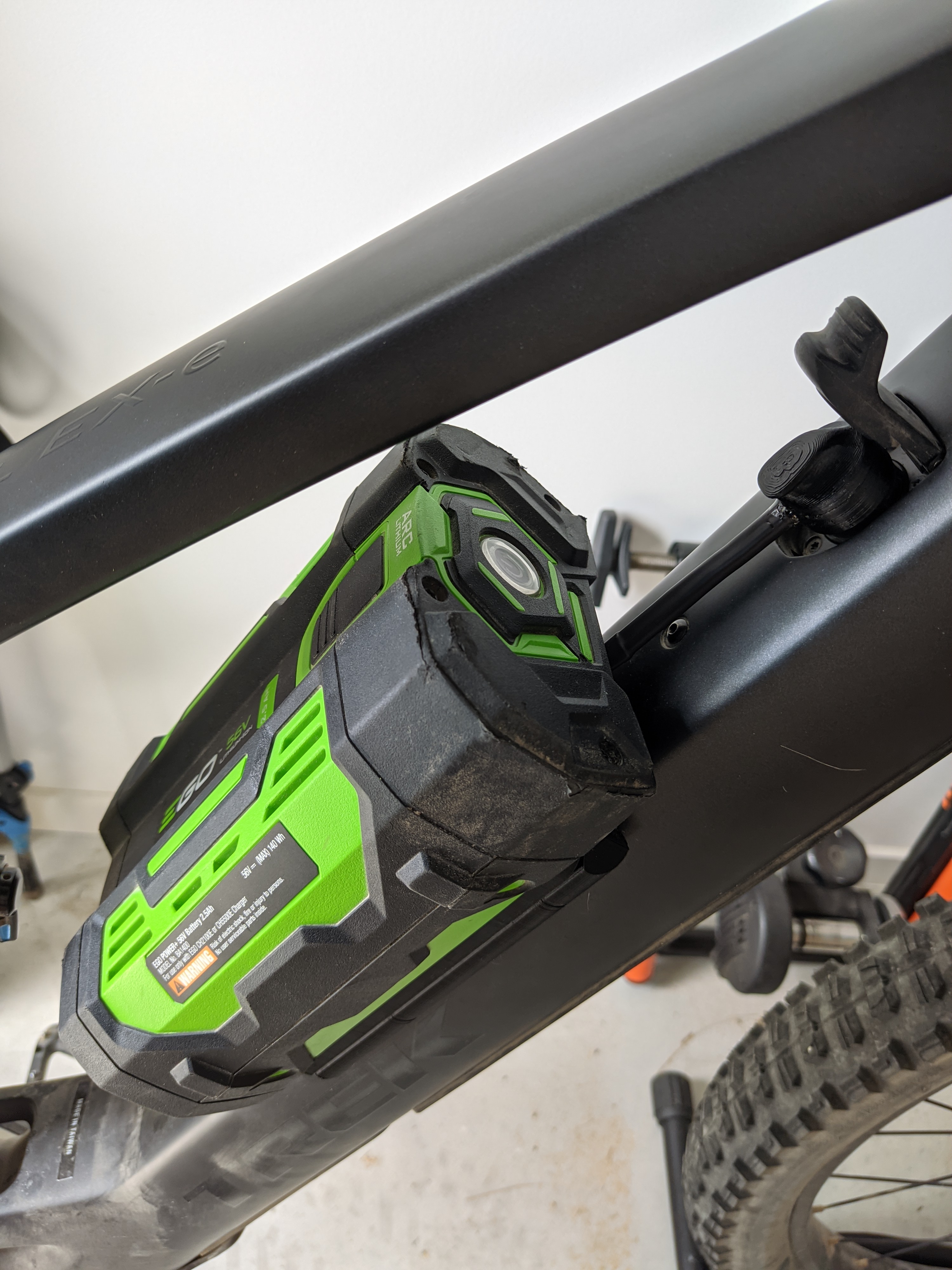

It's called the eXTenderMod. It is an adapter that allows an Ego 2.5Ah battery to securely and safely mount to the frame. The battery is easily removed to be charged separately, and connects to the charging socket. It drains with the main battery, and in testing gives around 34-38% extra range (140Wh). It possibly gives close to as much as the TQ Range Extender due to the way it works, but I don't have a TQ Range Extender to test.
It is wider and heavier than the TQ Range Extender (1020g vs 1650g), but all up the system will cost around half as much. There are more advantages and disadvantages which I'll release by 8th Feb (sorry taking an extra day to test).
I have been refining and testing this system for months, and using the Ego batteries in other applications for years, but I have a few more isolated tests to perform before I release more details.
It is wider and heavier than the TQ Range Extender (1020g vs 1650g), but all up the system will cost around half as much. There are more advantages and disadvantages which I'll release by 7th Feb.

Yes other Ego batteries will work but if you have a 9.7 or above the piggyback resoviour limits the size available to only a 2.5Ah. Still I haven't tried a 5.0Ah with my 9.5 but I think with a different mounting plate it could work. Otherwise a cable from a backpack or it mounted somewhere else would work, but obviously less streamlined.
I've tested it for couple hundred km, including a couple of bike parks with jumps.
As long as both batteries are fully charged (essentially the same or similar voltage) it works perfectly well. If the voltage is slightly off the TQ BMS produces an error and cuts power to protect the system, but I'm also testing a 5a fuse which serves as a backup to that. This is just for when people don't use the system correctly though.
