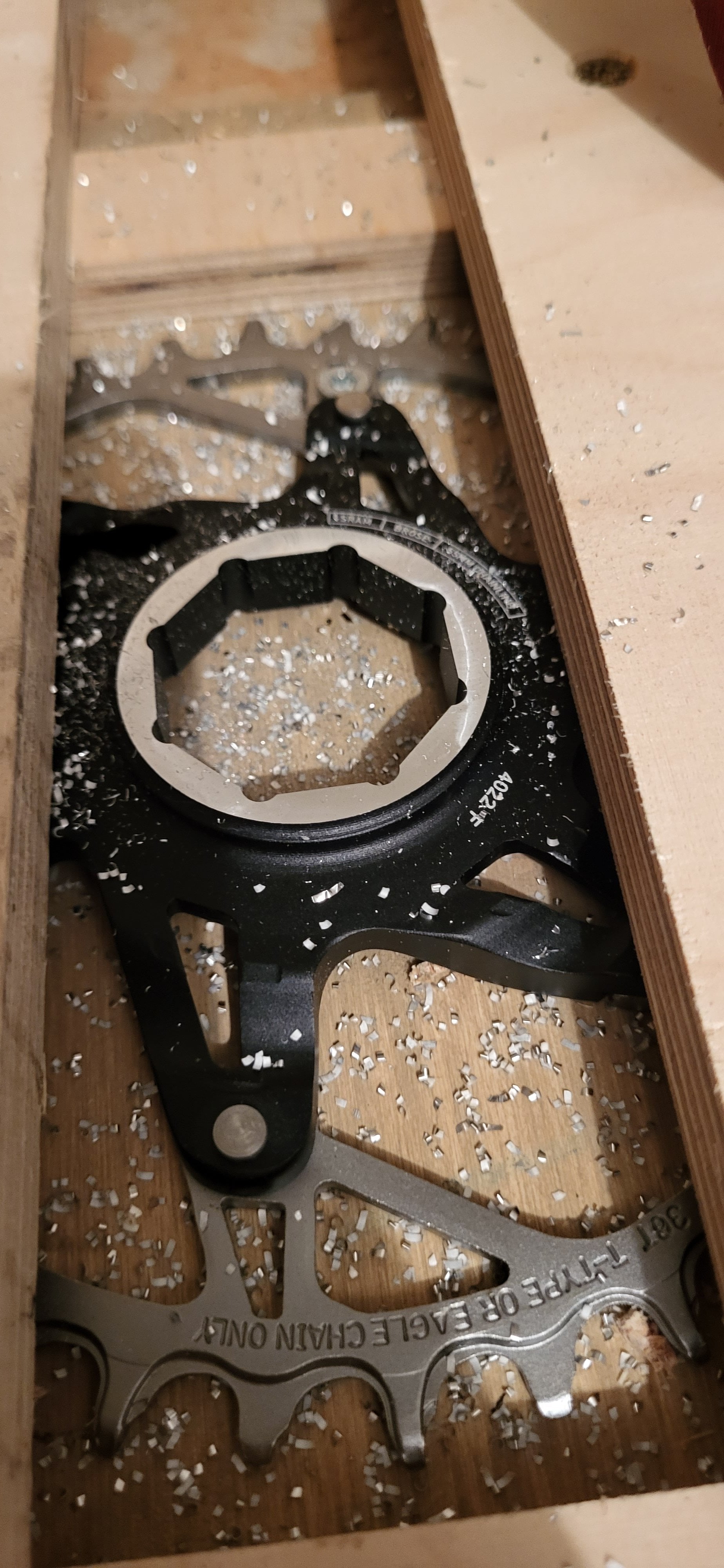

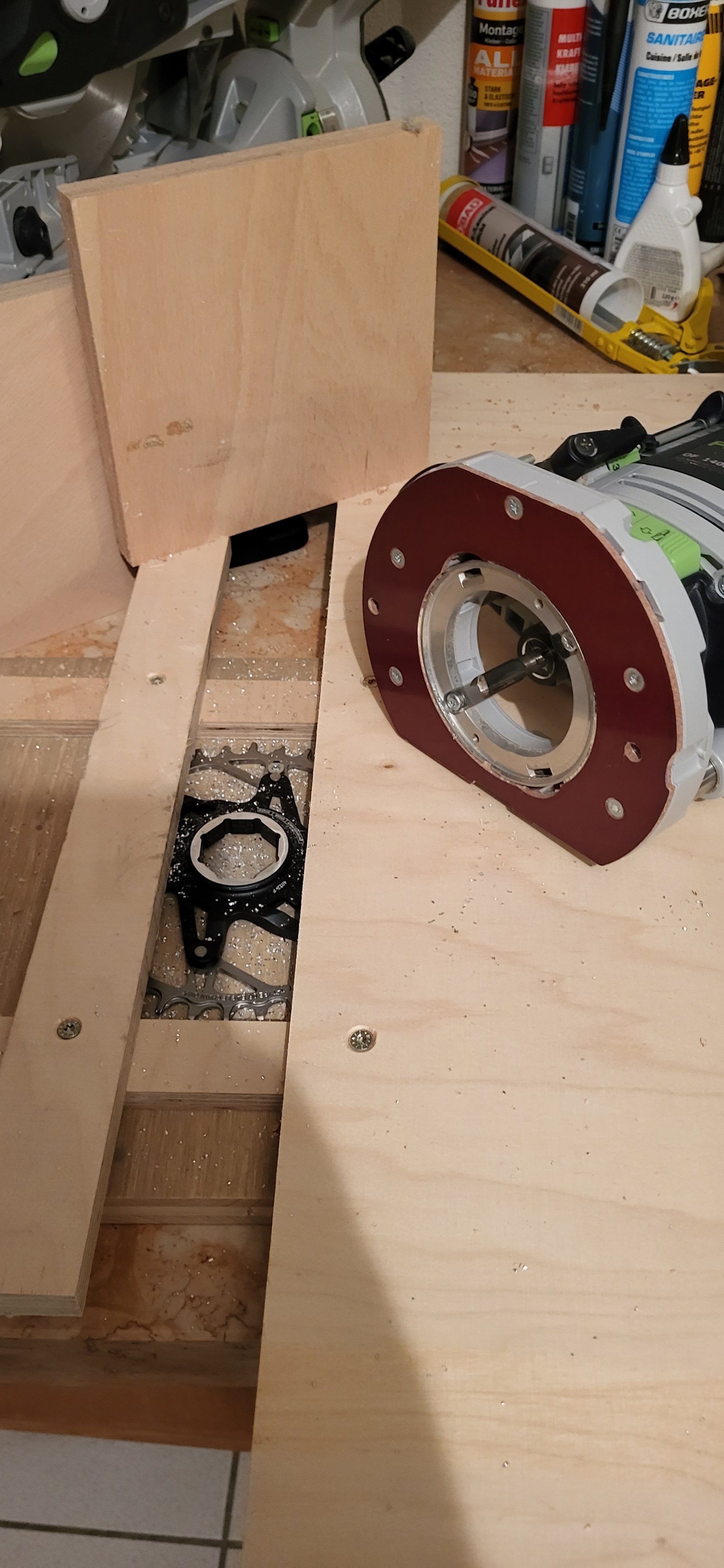

I present you my low cost solution fitting the DM-Chainring. Approx. 15min work and absolutely plain as you may see. Used a wood router with an old router bit. Works like a charm!
The alloy is quite soft, use low rpm to avoid smearing.
Cheers Rocco

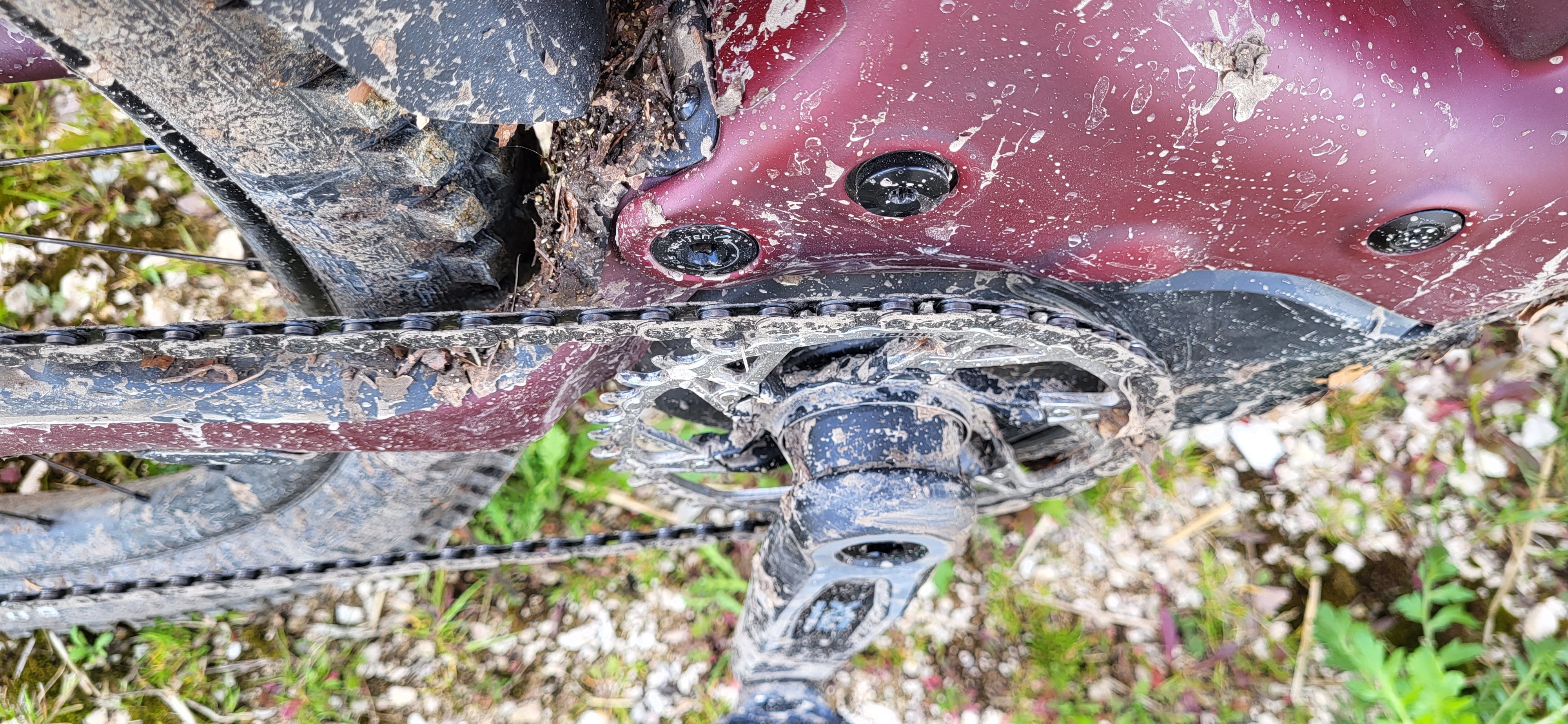

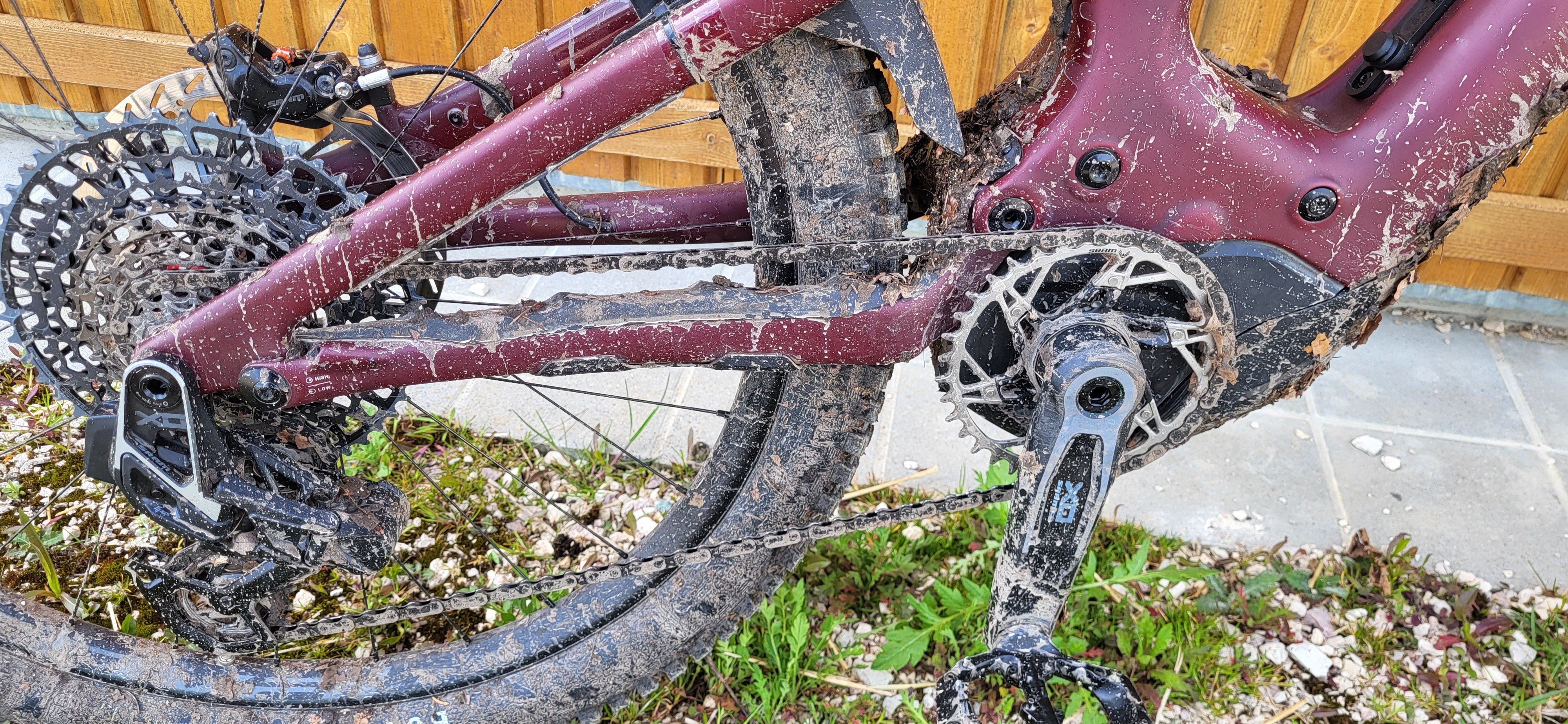

First Ride today, it is next level shifting without a Question. Shifting performance and the absence of noise is just amazing...works very well with the DM-Chainring 36t. I even would say the motor is more quiet with bigger Chainring!
No, the Chainguide is not there anymore...I don't know if there is a wider bolt available....?
Cheers Rocco
View attachment 110752 View attachment 110753
can you explain exactly what you did and how you did it? (whats needed as well) thanks!
No worries, just use a router and if you check out the pictures it is quite simple. The chainring is fixed with 3 little screws into the baseplate so it can't move around.

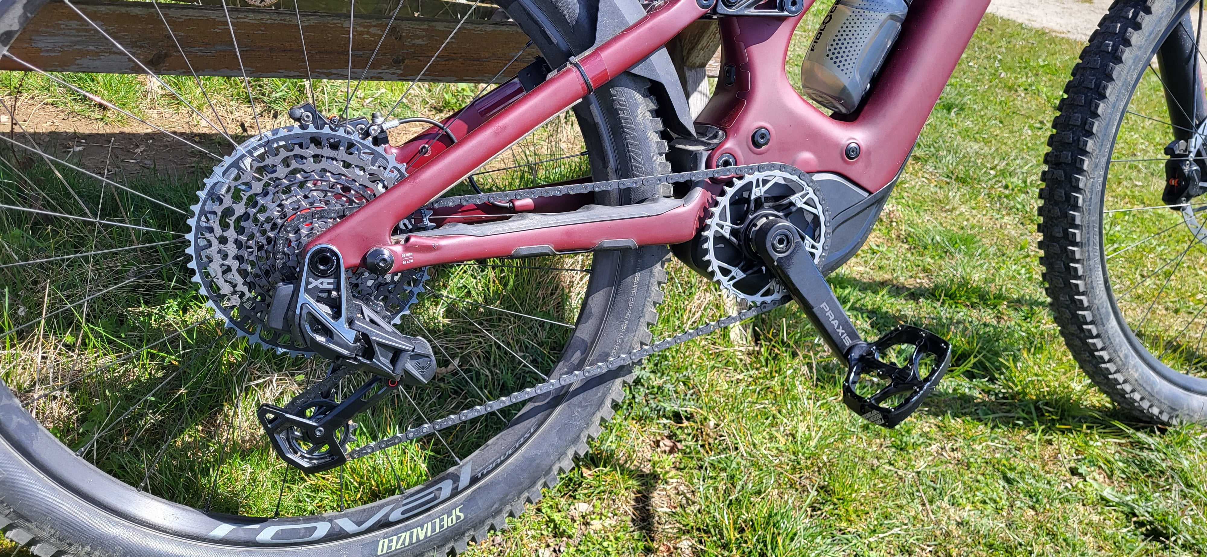

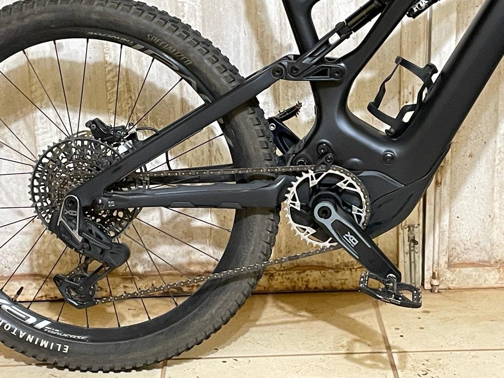

I think that the biggest unfavorable points when using the BROSE direct chainring are having to adjust the chainguard to the limit or dont use anymore, and it seems that the exact measurement on the Levo chain offset (may be due to the position of the motor) is 53mm and not 52, with DM it exceeds 55, I believe something between 56 and 57, with that the micro-adjustment of the rear derailleur on my bike is in the limit of 14 clicks.
I think you can use a 1 or 2mm spacer behind the cassette, or really remove 1 or 2mm on the chainring spider....for now I'm doing the tests, with 56/57mm the gears changes are faster and precise, only on the cog 38 I'm having a little bit of noise, but overall very good result.

The DM chainring gives you a 57mm chainline due to the offset motor. The Transmission cranks are also not optimised for the Levo as the cranks required a custom offset (again due to the offset motor). If you choose to use the SRAM cranks you will end up with a wider Q-Factor.
I have used both the 104BCD chainring (52mm chainline) and the DM chainring (57mm chainline), both the shift quality and noise felt the same to me with micro-adjust set in the middle. Some people have reported poor shift quality and noise with the DM chainring and having to run micro-adjust at the extremes of the range.

The q factor doesn't bother me at all, I didn't notice any difference, but I wonder, since we have the same bike, why is mine on the micro-adjust end?
When I was using the original chainring it was already at 10 (0-14)....
Others have reported the same, I suspect it will come down to frame tolerances. The bike industry is not exactly known for its great quality control!
