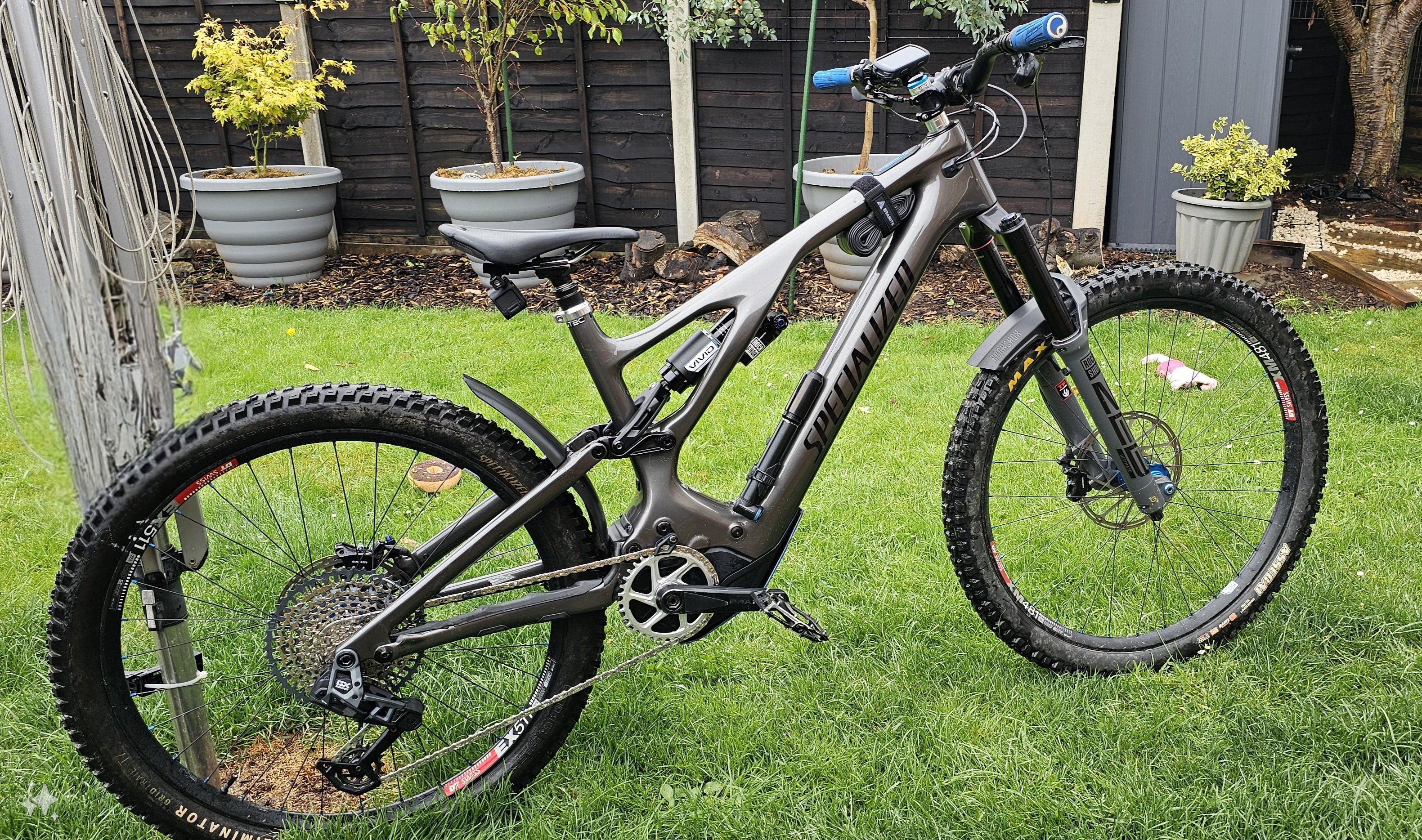

Edit: GX Axs (Brose) arrived, easy enough to install - but indeed the DM chainring isn't really suitable, I'm sure it works but it's bodgery with the chain guide etc & looks it's noticeably wider than the 104BCD Spider - but the direct mount looks so much nicer I can't bring myself to have such a £££ drivetrain & keep using a budget/naff looking spider, so I weighed up my options & while I think the absolute best solution would be using a router to trim 2mm off the Chainring to provide the SRAM Standard 55mm chain line, but as I don't have a router at hand that project is on the back burner and I have ordered a Hope R22 Chainring to maintain the existing Specialized chain line of 52mm.

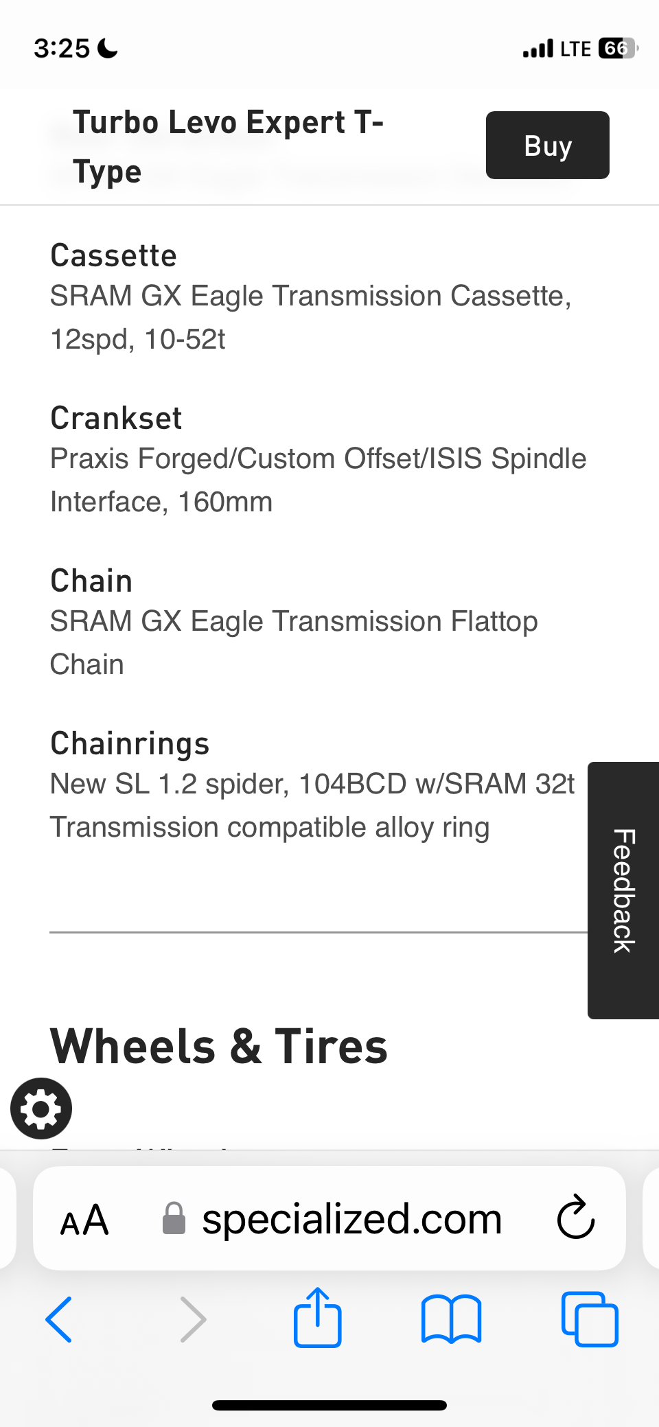

This is info on what Specialized is using on the T-Type model Levo, perhaps that crank ring is available through them?
Well, I fitted the T-Type Transmission using a 104bcd chain ring which worked fine.
But, I wanted the direct mount looks.
Currently using the Praxis cranks but I think I'll be getting Hope cranks soon.

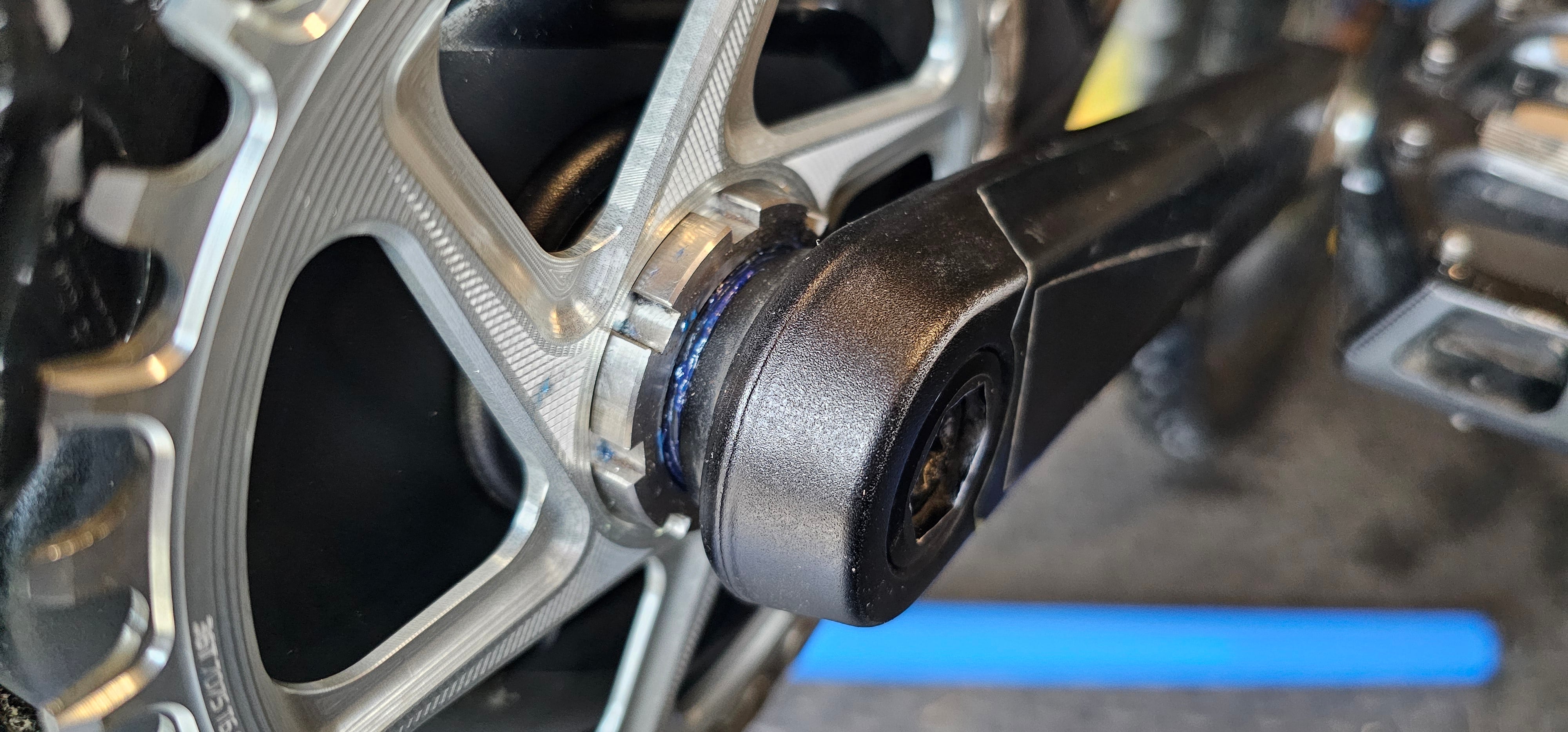

Love the overall look, although up close I'm not too sure if I've done it right as there's now alot which lived inside the spider recess which is now 'exposed'
chain ring on < castle nut tightened < rubber washer (seal I think) < crank arm.
So mostly posting pics to confirm this is correctly installed?
Edit: found the destructions in chainring box, appears I fitted it properly 👌
