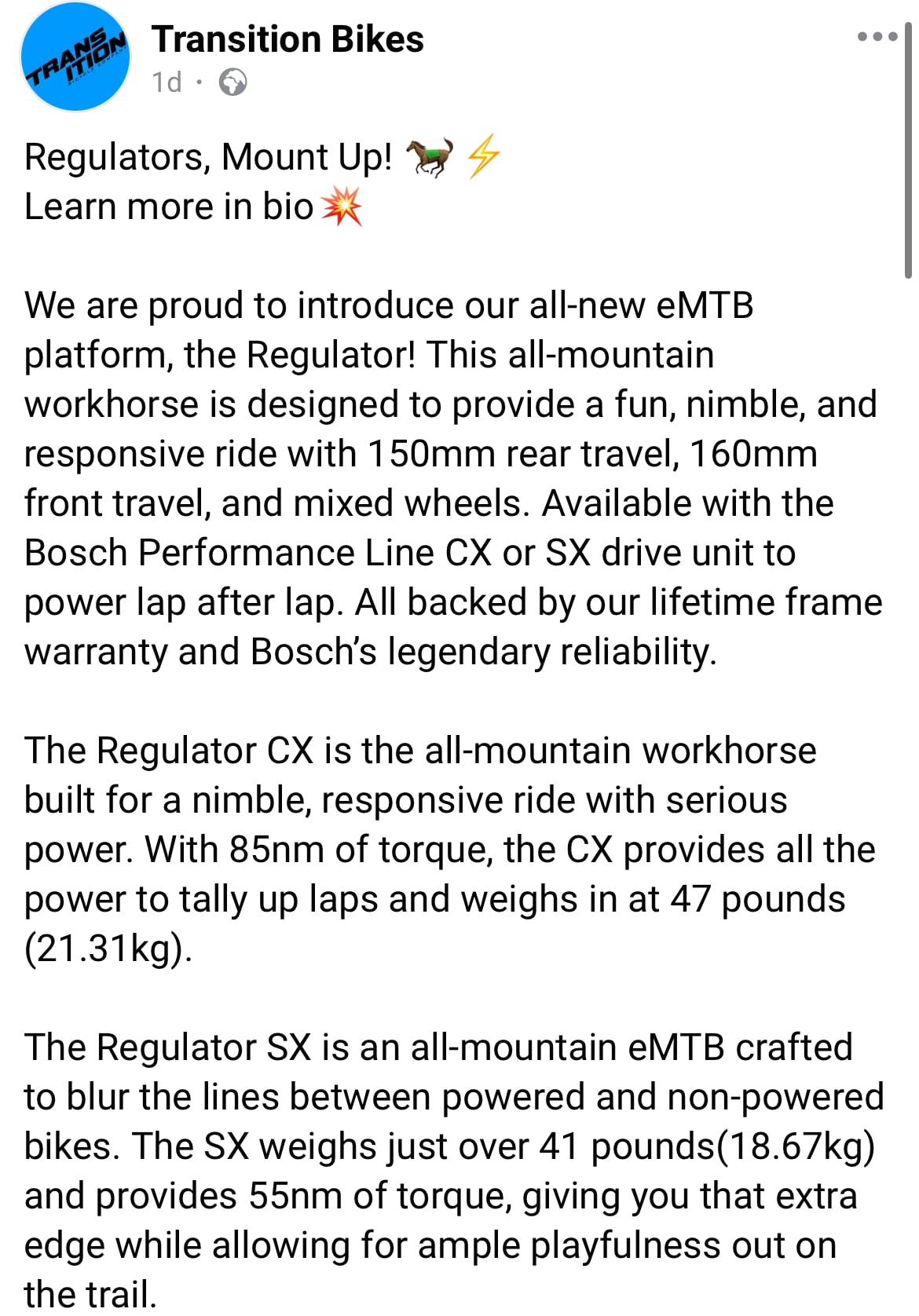

Per Transition’s FB post:
SX - 18.67kg
CX - 21.31kg
Both of these seem light, that’s probably a small frame with no pedals and lightweight tyres, but it’s competitive. IIRC my KSL was around 18kg stock without pedals, which has a much less punchy motor and smaller battery.

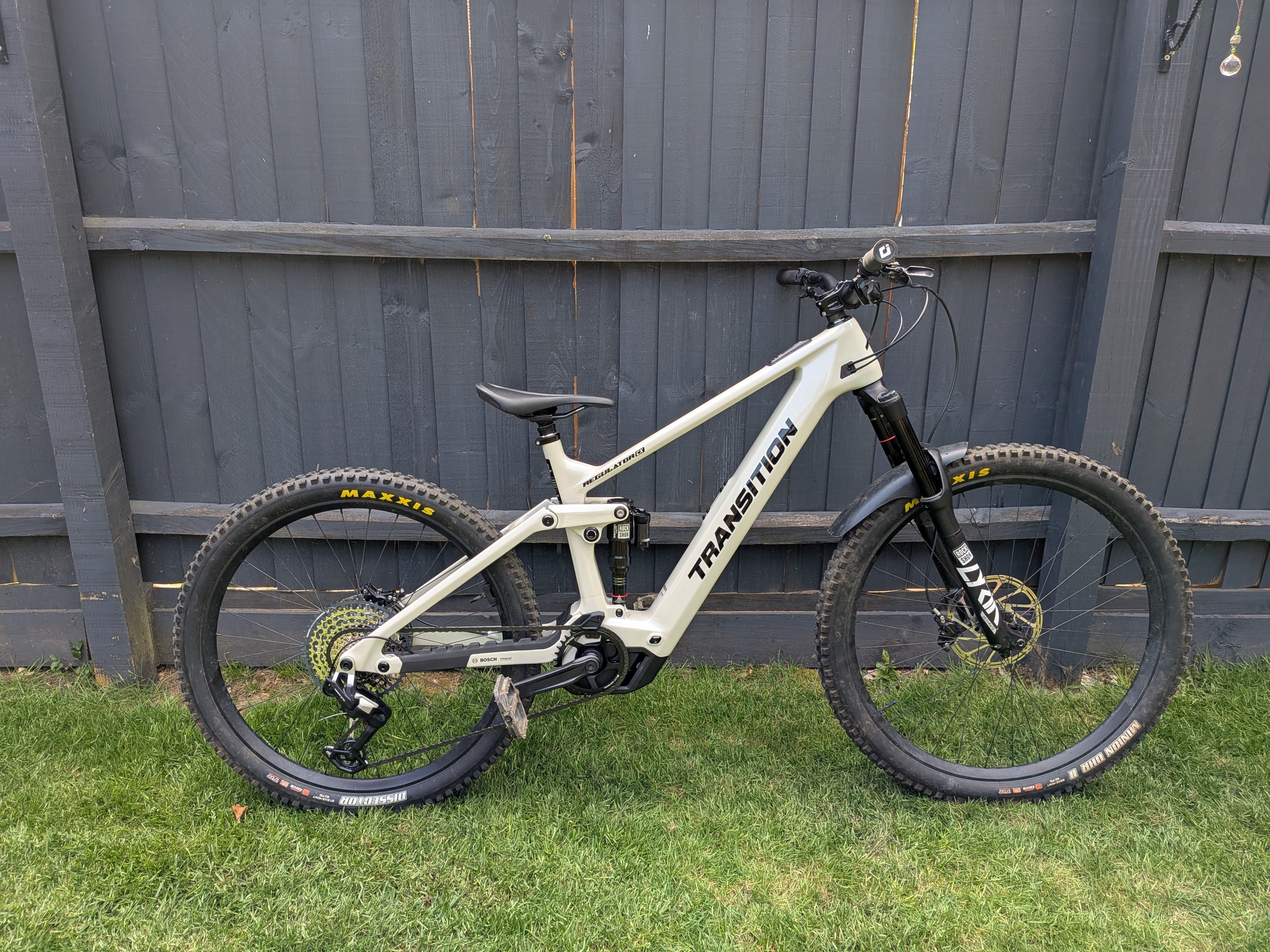

Received my CX today, immediately stripped back to frame and shock and rebuilt with parts I had from a previous build, plus a few new bits.
So I've gone for a sortve strong but light build, I live in the south of England and mainly ride small bike parks and more traily stuff. I weight about 80kg. I'm personally a big fan of the lyrik and it works well for me and the style of riding I do, I also own own a DH bike for bigger riding.
Anyway, here it is weighting in at 20.1kg with out pedals.
First ride tomorrow, fingers crossed it's enjoyable.

Nice! What size are you on?
Spec is;
Large frame
Rockshox super deluxe base
Burgtec ride high bars
Burgtec MK3 stem
I9 1/1 hubs on ex511
Dissector rear exo+
Dhr2 front exo+
Lyrik ultimate
Code RSC brakes, centerline discs 180 rear, 200 front.
SRAM 90 derailleur, shifter and cassette
Xo chain
180mm one up dropper (may change to 210)
Specialized seat (bridge?)
Standard cranks (probably change them as they look cheap😂)
So there's still scope to save a tiny bit more weight if you wanted too. living where I do I don't need double down tyres or big forks so I guess that's probably where most weight is saved.
So it rides very much like a transition, very playful ,at 6ft a large doesn't feel that big. The rear end is slightly longer than what I am used too and it feels very balanced for it both up and downhill.
In comparison too the SL2 motor it's almost silent, it feels like it has less resistance too. Range wise I did 20 miles on emtb, unsure of the elevation as the Bosch app doesn't seem to say that. I was very tired yesterday so I didn't opt for a lower setting.
So far so good 👍🏻
@dirt-diggler thats an impressive weight you got the bike down to, did you happen to measure the stock weight?
22.1kg. I believe the quoted weight is 22.3kg.
So guessing my scales are slightly inaccurate but it does show a decent saving.
I've got a few bits to swap out so I'll reweight it on my scales and check against the bathroom scales.
Thinking the Lyrik over the Domain dropped a good amount of weight, plus losing the stock heavy wheelset too
