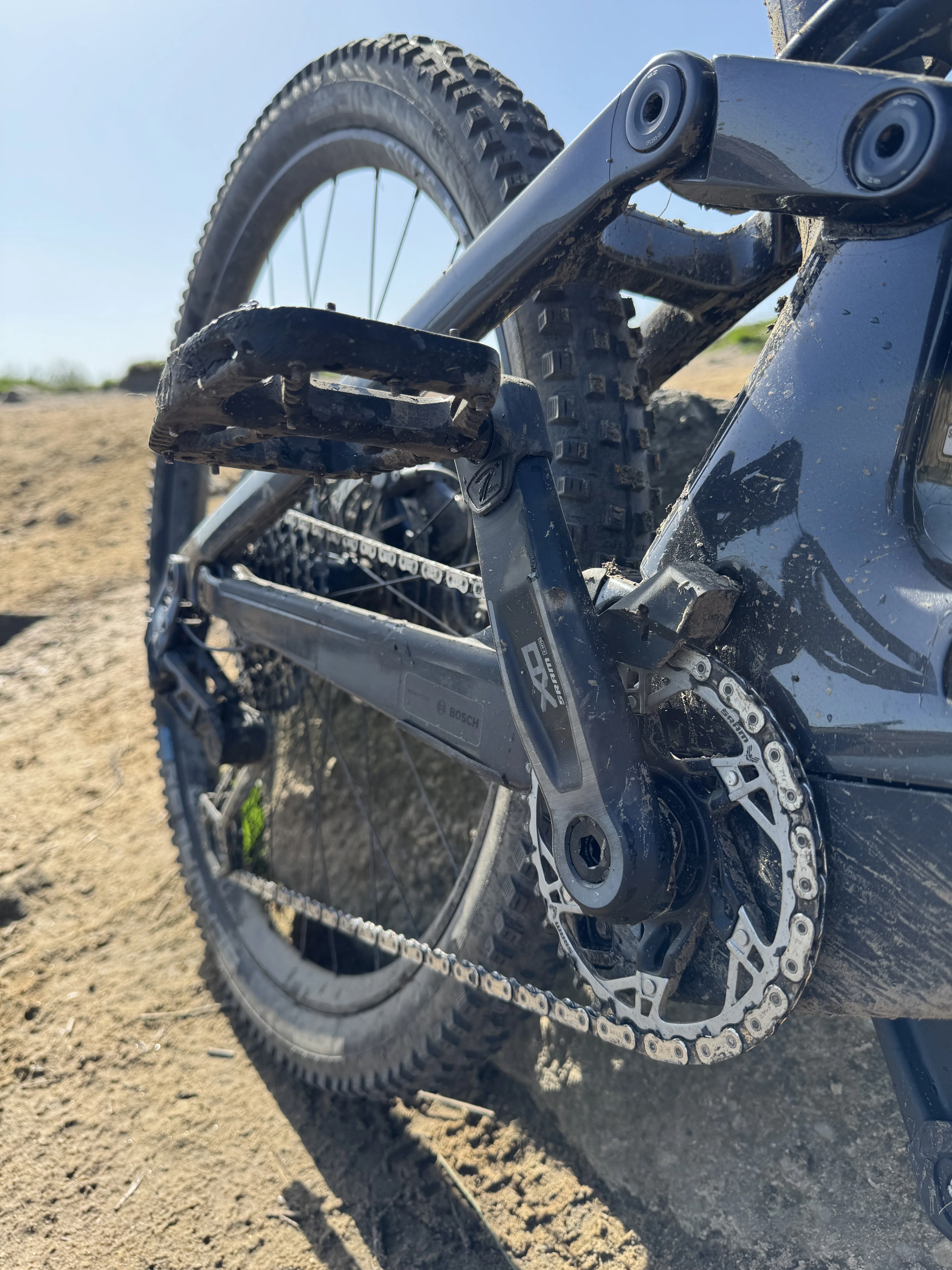

First test ride out today with the X0 155mm cranks. The riding didn’t feel noticeably different but there was definitely fewer pedal strikes, even none that I could notice. Went across my usual rocky moonscape route to check and all good. Definitely a worthy upgrade.
First test ride out today with the X0 155mm cranks. The riding didn’t feel noticeably different but there was definitely fewer pedal strikes, even none that I could notice. Went across my usual rocky moonscape route to check and all good. Definitely a worthy upgrade.View attachment 185205View attachment 185206
yeah, I can't tell the diff between my 155s and my 165s except far fewer pedal strikes and a lot more confidence when I need to pedal over roots and rocks.
