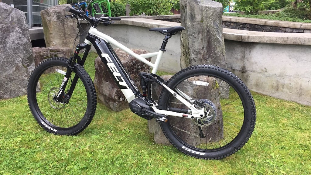

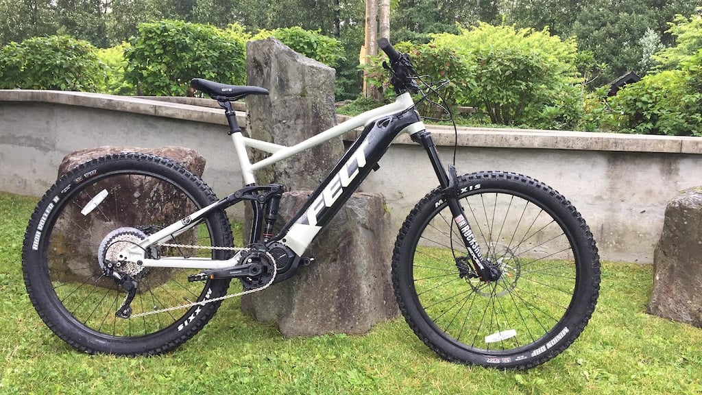

I picked this bike up for a great deal. It was an ex-demo bike with 500KM on it. It was in generally very good shape, and most parts were like new when I got it.
I'm an intermediate rider. I generally keep jumps under 12ft, drops under 6ft, and I struggle a bit on steep techy sections, very steep rock rolls, and long skinnies that go up high in the air, etc.
I'm going to break down the review into different components, and then how it all works together as a package.
Warranty Support: Poor. I'm adding a new section here, because some concerning things have come up. The details are below in the "brakes" section, but this bike comes with rotors that are incompatible with the brakes. The calipers will need to be replaced with a new model to keep the bike safe and working in the long term. Felt has so far dragged the whole thing out, and now refused to fix it. I believe all of these bikes should be recalled and the calipers changed to something compatible with the rotors.
Frame Geometery: I feel like they did a great job here. The chainstay lenth is 445mm, which is great. Some ebikes (*cough* Giant *cough*) have long chainstay lengths that make their ebikes ride differently than their non electric equivalents. The head tube angle (65.25 degrees) and seat tube angle (75.4) feel like a typical enduro bike, striking a good balance between climbing and descending. Not a ton of pedal bob while pedaling, so they did a good job there.
The reach is pretty long (464.2mm) and the frame is pretty roomy for a large (20") frame. I am a bit above 6', and I wouldn't want the bike any larger.

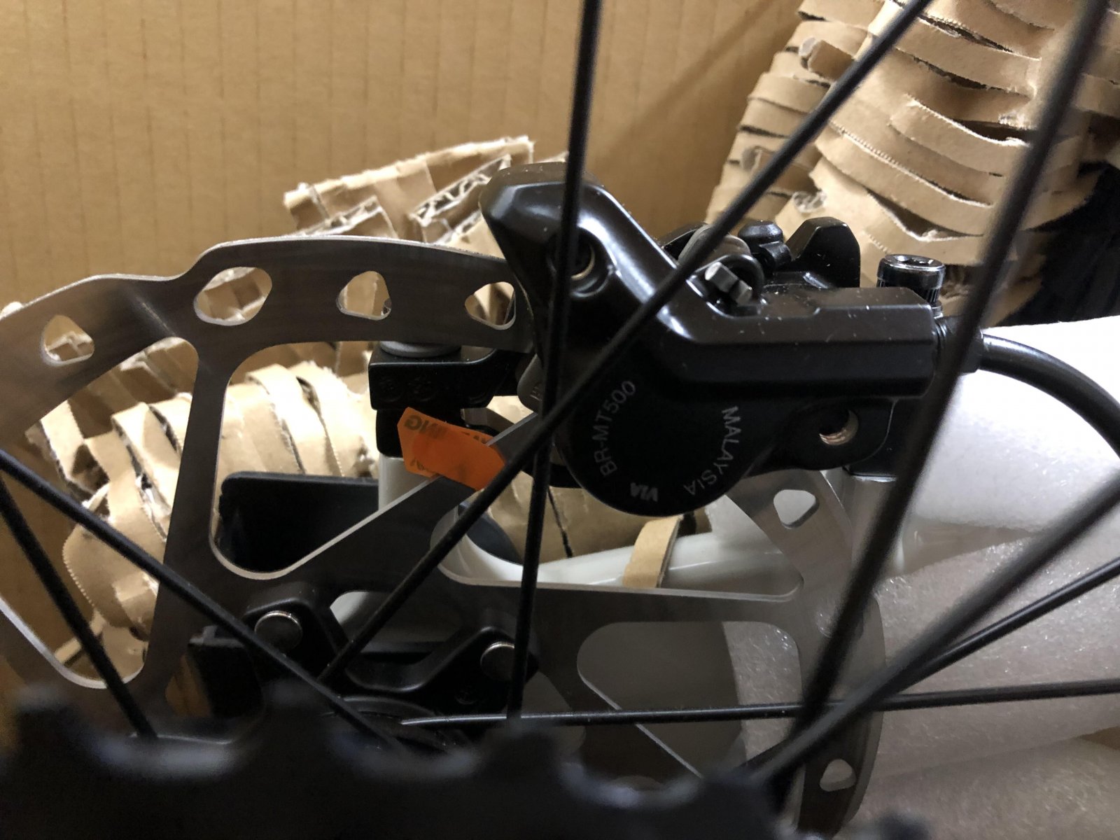

Rotors: 203mm Front and 180mm Back is a winning combination, but there are some serious problems here! They put "fancier" SM-RT64 rotors on the bike, but these are actually not compatible with the MT400 calipers they are using. The MT400 calipers are "wide track" calipers, that are supposed to be only used with "wide track" rotors such as the SM-RT56. Using a wide pad on a narrow caliper means less braking surface and slightly odd braking, because the pads contact the rotor spokes. This explains the strange ticking noise I hear when braking.
I spent a while musing why they would have done this. One reason could be that they don't understand the Shimano brake line-up. A second possible reason is that the SM-RT56 doesn't come in 203mm sizing, so they used an incompatible rotor for spec sheet reasons. Either way, it's pretty sloppy.
I recommend that anyone who buys this bike rectifies this. Either put SM-RT56s 180mm/180mm on both the front and back, or upgrade the calipers to MT420s or MT520s and keep the current rotor setup.
Levers: Shimano levers that feel good, and are actually an upgrade from the levers spec'd with the MT400 calipers. BL-MT501s with Servowave. Can't complain here.
Calipers: Budget Shimano calipers, which are decent for the price. They do a good enough job of stopping the bike, even on steep descents with organic pads. I bet they'd work even better with the right rotors! These calipers are a bit limiting, because you can't get metal pads for them, and you can't use fancy rotors (ice-tech, 203mm, freeza, etc). If you're happy with a 180mm/180mm setup with organic pads, then I'd probably keep them.
Brake Lines: They are using the MT400 spec'd SM-BH59-JK-SS, which is a slightly less stiff line than the standard shimano BH90 line. This seems to give the back a slightly spongy feel, like there is air in the lines. Maybe there is a bit of air hiding somewhere, but I've bled the damn thing four times, tapping the calipers/levers, while rotating the whole bike, so I'm starting to think this is just the best that the SM-BH59's can do.

The calipers can be swapped for MT520s (which can be gotten very cheaply from bike24 or aliexpress) without making any changes to the levers or lines. This gives you 4-pot from 2-pot calipers, and changes the pots to ceramic from resin, which helps a bit with heat transmission to the brake lines. It also makes the incompatible rotors compatible, and lets you used finned pads and metal pads if you want.
If you do this caliper upgrade, the rotors can be swapped for RT81's or MT800's/900's if you are planning on very long descents or you drag your brakes a lot. I will probably swap my rear to an RT81 or MT900, because it's a cheap upgrade, and I often drag my rear brakes while descending (poor form :p)...

I've put some new information in, after looking at the brake system further. The stock rotors are not compatible with the stock calipers! Pretty crazy stuff. I've ordered new parts to try rectify this, but I feel like I should probably call up Felt and ask them what they were thinking here.

I have the same bike in the same situation. Bought used with 300km on it. Great condition and enjoying it so far. The only change I did was the rear brake set up. Rode Squamish and the next day rode on my local mountain Burke in the COQ and the rear brake was fried! Went to Kinetik Cycle and installed:
SHIMANO ROTOR SM-RT70 CENTERLOCK 203mm
SHIMANO DISC BRAKE M640 ZEE REAR/RIGHT
As for the battery intermittent shut off which happens not too many times, I cycle the power output from off back to trail and it tends to fix again.
Thanks for the feedback! Good to see I'm not the only person in the world on this bike.
I called Felt about the brake compatibility problem today, and they were unaware of it. They asked me to send an email with further information, so I've now sent them details and screenshots of the Shimano compatibility matrix, etc, so they can verify the problem. I'll update here if they offer a recall/solution.

I've been talking with Felt for a while about the mistakes they made with the brake system. Originally, they offered me a jersey as compensation and apologized. I asked them to reimburse the very reasonable part cost (not the labor) of the new calipers I had to buy, and then they said they were denying my warranty completely.
Very disappointing.

I just got the Felt Redemption 30 and its awesome. I originally had ordered the Redemption 50 but I did not want the e7000 Shimano Steps...because I wanted the more powerful e8000 and upgrade spec of the Redemption 30.
Incredible. $3499 delivered... Pretty nice bike and totally different calipers, etc than the trouble described here.

Sweet! That's just an inventory photo...I added some RED to mine here:
Just as a heads up, make sure to protect your frame from the crazy cable rub I just noticed while inspecting my frame! I put a note about it underlined in the original post! Wouldn't want to see the same thing happen to your bike. Looks like it could saw through the frame within 2000km if you weren't careful.
