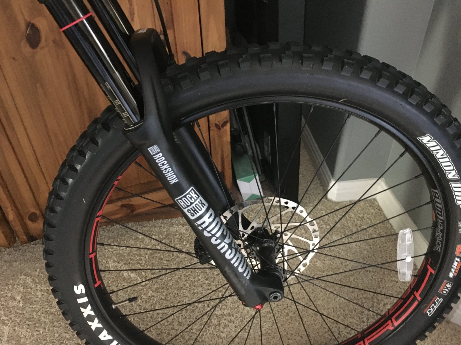

I plan to swap out a lot of parts: fork, brakes, wheels, and an e8000 off my wife's Focus Bold2.

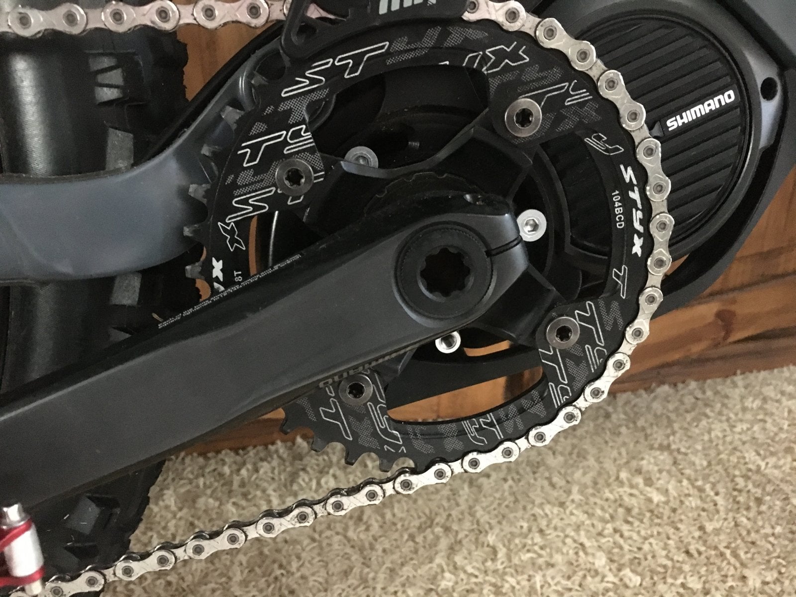

The bike has a Shimano SLX, 11-speed, 11-46T. The 46 gets your very low gearing.
The stock chainring is 34. So go up to 36 and you'll be at 30 MPH easy.
But you'll want to unlock it. Because the drag past 20 on all these will slow you down. But I've gotten to 26 or 28 even with the drag. Unlock it and 30 is nothing.
Regarding climbing the 46T out back is pretty large. So you should be fine with 2 bigger on the front chainring.
I used standard chainrings for non eMTB's with no problem either.

Anyone try a longer shock to get 150mm rear travel?

here’s the beast in question 38t up front
