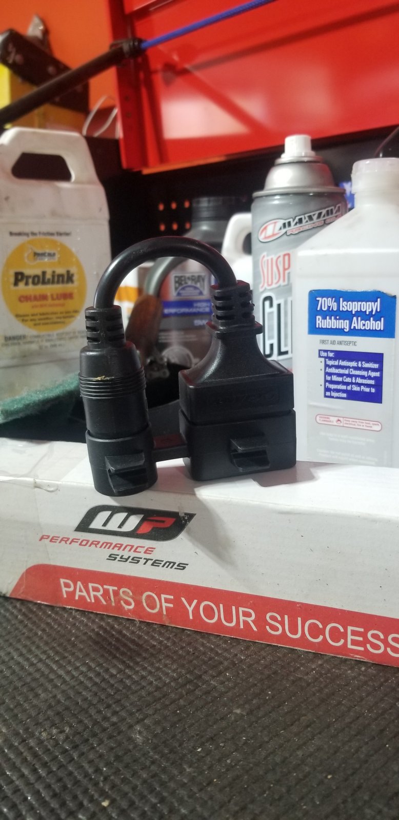

no powersource at parking spot. need to charge in my flat. but bike to big for elevator.
Make sure the dealer provides you with this, its needed to charge off bike, and some folks have had trouble getting them after the fact.

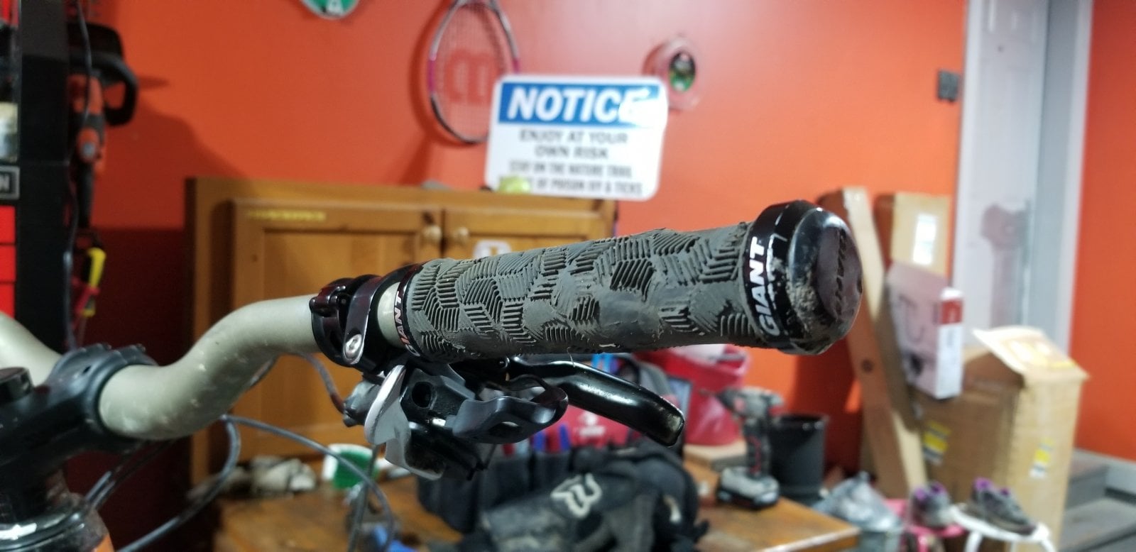

Added grips to match the trance19..like the metal caps at end.
They do wear out fast though, only outlasted the drivetrains by 5 or 6 times.

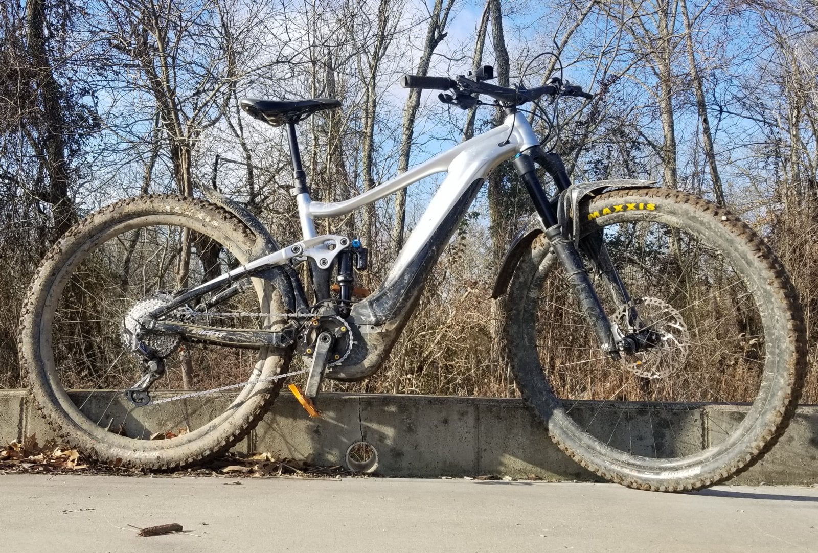

The X is sorted. Meduim cage xTr derailleur, 10-45 SLX cassette, 32T CR.
It works almost as good as my 10 speed at 3 times the cost. We'll see how well it holds up.
Edit
Can you share what fenders those are and if you are happy with them? I live in a wet climate and could use a good set.
I like em fine enough, though better may be available by now. The one in front is a Crud XL, and the rear is a Mucky Nutz Mug- Gaurd Long front trimmed to fit.
