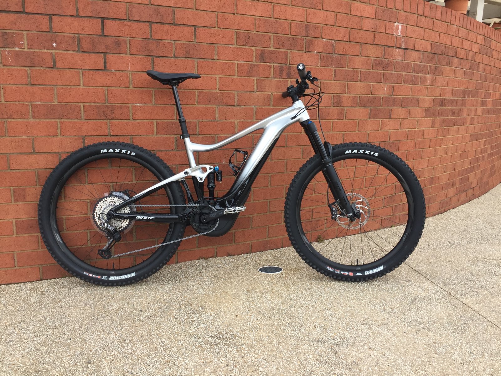

And it's ready to take out on the trails. Spent 2 days setting it up and covering with Frameskin. First e-bike, slowly getting used to cadence requirements and how to get most out of motor vs physical input, learning curve. First trail ride Sunday.
You have enough time to ditch the plastic disc on the rear wheel before Sunday though !
Can you link
Can you
Can you link frameskin priduct please and tell us how is done?
Thanks
Can you link
Can you
Thanks
120€ it looks perfect
