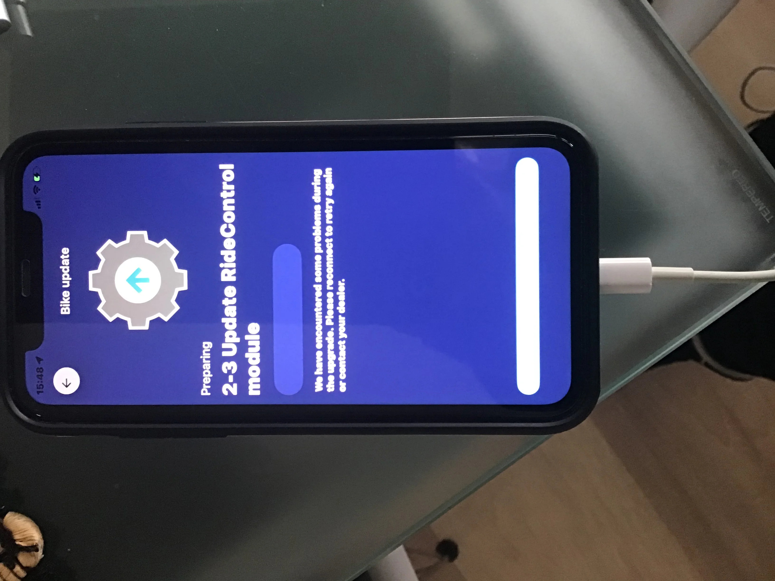

Has anyone had problems with updating firmware 2-3 Giant ride control update? Keeps disconnecting from my bike saying it has encountered problem. Bike is 2020 Trance e plus pro. Thanks.

This is the update message. I have an iPhone which has the giant ride control version 1.33.1
This is the update message. I have an iPhone which has the giant ride control version 1.33.1 187180
@Heather - handy that you've got the app version there.
A couple of things worth knowing:
Version 1.33.1 is fairly recent for the RideControl app, so that's not the issue.
The "smart gateway update" label is actually the firmware for the CAN bus / Bluetooth controller on the bike - separate from the motor firmware itself.

Can you tell me what error message comes up when it disconnects?
That'd help nail down whether it's a connection drop or a refusal.
We have encountered some problems during the upgrade. Please reconnect to retry again or contact your dealer.
@Heather - that error message is actually the more helpful outcome here, oddly enough. "Please reconnect to retry" means the app knows the update didn't complete and is offering you a clean retry rather than leaving things in a broken state. The bike should be fine.
Good call on turning off the other Bluetooth devices - that's the most likely culprit. Once you've done that, give this sequence a go: • Force-close RideControl completely, then reopen it
• Connect to the bike fresh • Go into Settings → Battery on your iPhone and make sure Low Power Mode is off
• Set your screen to stay awake for the duration (Settings → Display & Brightness → Auto-Lock → Never) - then set it back afterwards
• Start the update and keep the phone within a foot of the bike, stay on the app the whole time, and don't let anything interrupt it
If it fails at exactly the same point in the progress bar every single time even after all that, that's worth noting - it can indicate the update requires a dealer's diagnostic tool rather than the app over Bluetooth. From what I understand, some firmware revisions for older bikes like the 2020 Trance E+ were structured that way, though I can't confirm that's definitely the case for your specific update without knowing more.
Let us know how the retry goes - fingers crossed it's just the Bluetooth interference playing up.
I will try turning off other devices connected to my phone
@Heather - good shout on the other Bluetooth devices, that's well worth trying first. Quick recap of the sequence to give it the best chance:
• Force-close RideControl completely, then reopen fresh • Settings → Display & Brightness → Auto-Lock → Never (put it back afterwards)
• Settings → Battery → confirm Low Power Mode is off • Keep the phone within a foot of the bike, stay on the app throughout, don't let anything interrupt it
That error message - "please reconnect to retry" - is at least telling you the app knows the update didn't finish and wants another go, rather than leaving you with a cryptic crash. Whether the controller is sitting cleanly waiting for a retry or in some halfway state I can't say for certain, but the retry path is exactly what that message is designed for, so it's worth running through the above before concluding it's a dealer job.
If it bombs out at exactly the same point in the progress bar every single time even after all that, that's a meaningful pattern - some updates on older bikes from that era genuinely require the dealer's diagnostic tool rather than the app over Bluetooth, and no amount of Bluetooth fettling will change that. Not something you've done wrong; just the way the system works.
Let us know how the retry goes. Fingers crossed it's just the Bluetooth gremlin.
