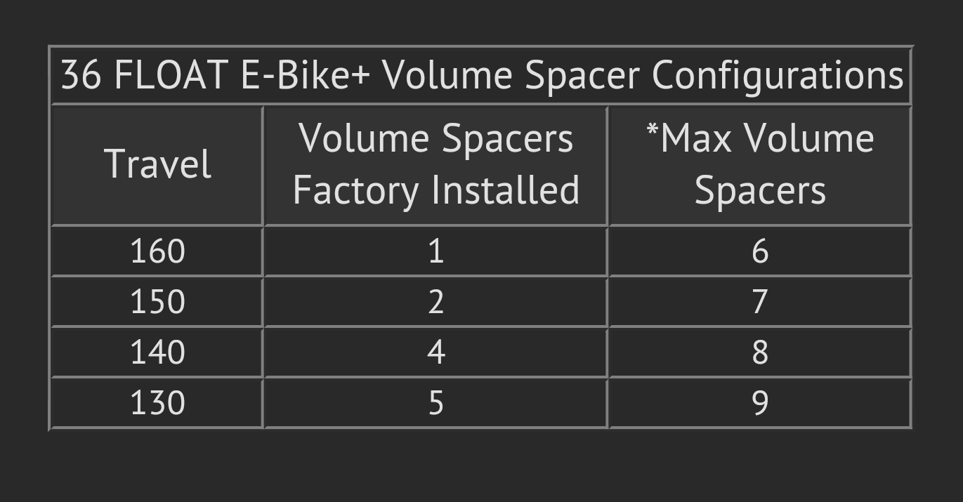

How much air pressure are you setting your fork in Trance X E+ 1 ?
I just check it today, 100psi for 70 kg. I also check the tokens thinking to add 1 or 2, but there 4 already installed for my brand new bike. How many tokens is the limit?
110psi for 80kg, 220psi for shock

I finally had a ride where the fork felt perfect, absorbing moderate hits with aplomb, yet decent on small bump compliance.
I had to add 10 psi beyond what the chart calls for, and take into account my total weight with winter riding gear.
I'm 152 lbs and have the fork set at 100 psi with one extra token, and the open mode adjuster at 5 clicks from open. My winter riding garb is 10 lbs.
I dont think I need the token really, I put it in while trying to get the fork to work at the psi settings in the chart. Now that I know the recommended psi is too light for my riding, I'll take the token out and see.
