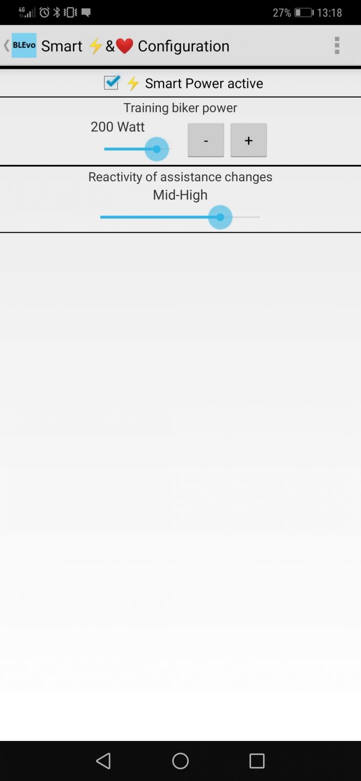

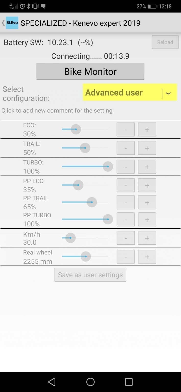

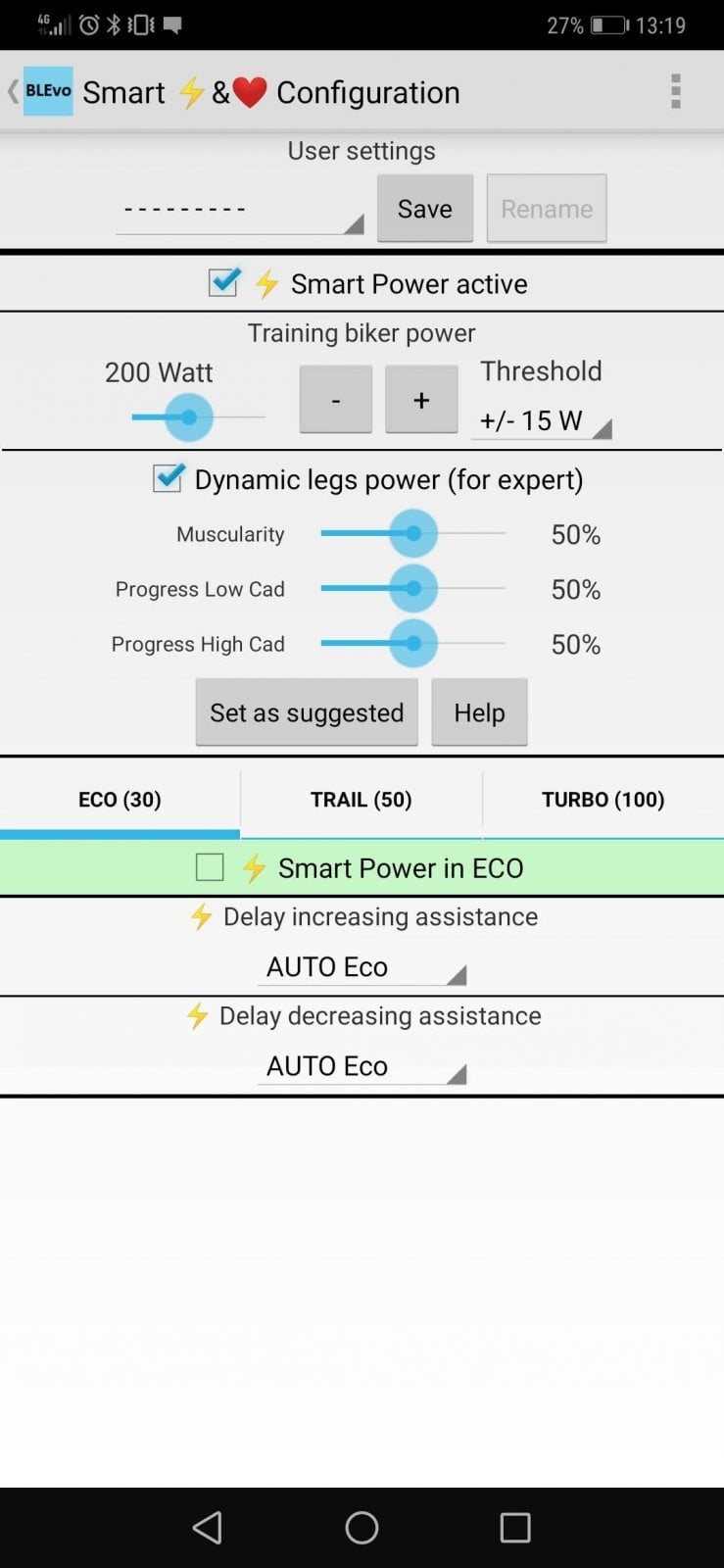

Can anyone recommend smart power settings for a Kenevo? I really like the idea of smart power mode. My mate rides a cube with eMTB mode and it is very efficient. When I use smart power mode by battery drains really quickly so I've generally managed the modes myself via the handlebar remote.
Thanks
Thanks
Please share your setting and I will adjust for you. Did you see the settings example in the user manual?
@PaoloBLEvo
I haven't really messed with the settings other than increasing Training Biker Power from default (was it 180w?) to 200w to try and improve battery range.
Ive not used expert mode but have enabled it to grab a screen shot if it helps.
not so heavy.. Smart Power should work correctly with this setting..
Which TCU version you have?
If you have 2.019 or 3.019 maybe there are some problem for Smart Power..

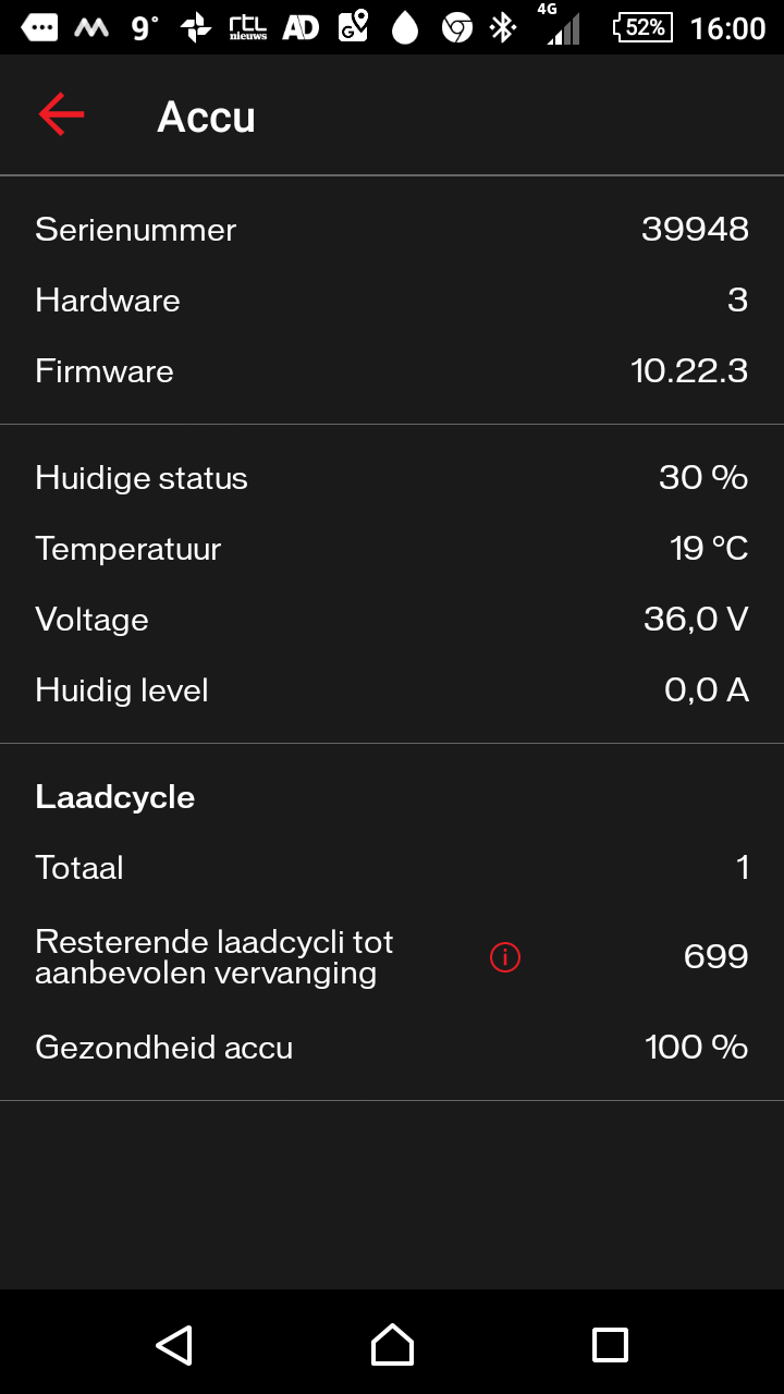

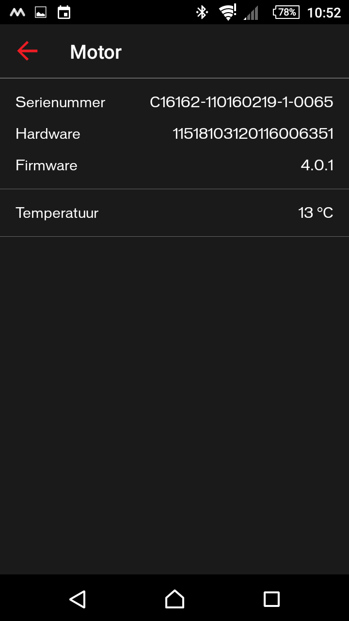

Hallo everybody. I am new here. I ride one of the first LEVO comp FSR in Holland. I got in warrenty a new battery.
I use BLEVO from the beginning it was there. I used it only to change some parameters. Now I discovered that there is smart and hartpower. I understand that the IPhone must stay connected while using smartpower. I also use a Garmin 1030 while I am riding.Also I use the Garmin wireless controller for changing ECO/TRAIL/TURBO. I use GPS for speedmy question is: Can I use this all together. Ps. Excuse my English

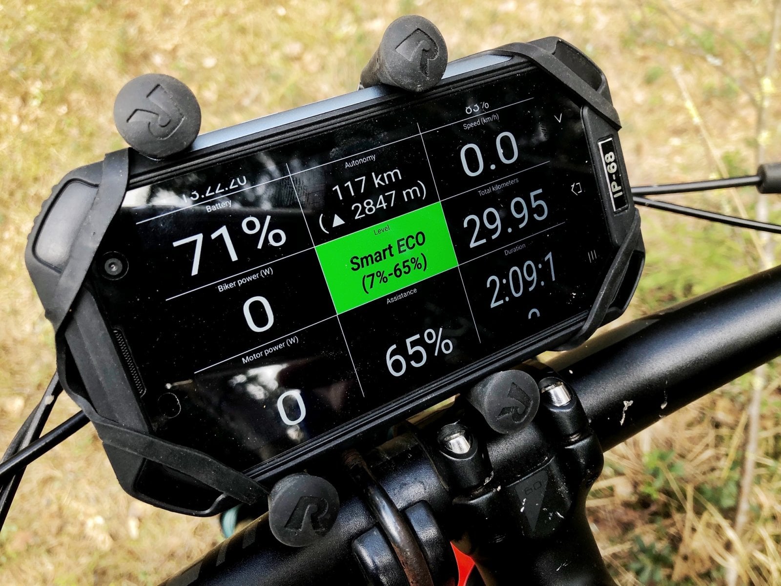

Ok.. thanks for the explanation.. usually I ride in ECO with Smart Power from 4% to 79% and if I need "instant" power, I push on the pedal few meters before the high hill. This is my trick but maybe cannot be used in all the trail situation..
Let me know about your test
Thanks Paolo, I have been doing some tweaking to my settings, and based on your comment, I think I've found the sweet spot. I went yesterday for a 55 km ride and I think that never gotten the average Wh/km such low and also never done so little amount of manual assistance changes during the ride. I was using my home-made, extra 250 Wh battery and came back with 43 % battery left :cool:
Now my settings are:
7-65 %
70-80 %
94-95 %
And thresholds set up so that Eco power goes up quite soon, when I push pedals hard, but also comes down, when I don't need the power anymore. Trail is for steeper and/or more technical uphills and Turbo for going over logs or other short technical sections.

Since my new motor on my Levo 19 , I cannot change the speed anymore. After the restart it resets always to 25,5km/h.
Do I something wrong?
