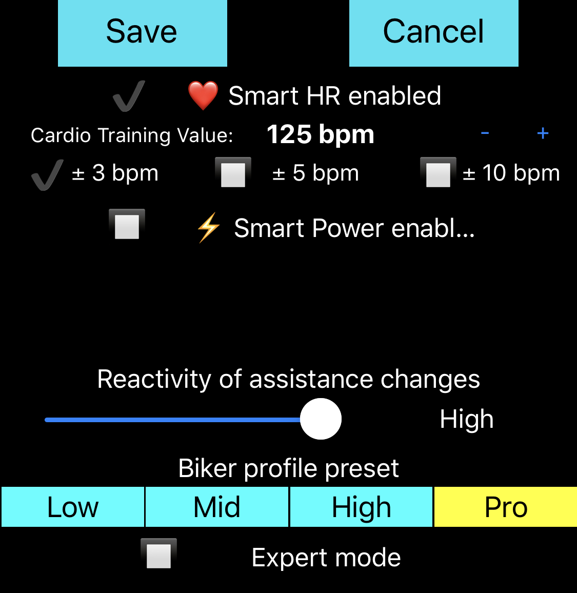

Hi, I just bought a levo 2020 comp in Switzerland (TCU 3.038 , 26B and firmware 2.4.4.i guess the most recent ones ), 120 km ridden, and I d really like to have the advice of this highly competent forum on MC and BLEVO.
I struggle with both . MC does not currently even pair with the Apple Watch (Blevo does it, not well enough but it does ) and that s simply ridiculous for an ebike of that price (and a rather amateurish UI - not a compliment unfortunately, a laughing stock just like many automotive apps like Merc or Porsche - demonstrates that app development is not a side hobby or should not be...). Blevo is a noble individual effort and seems to do a lot more ( though it does not even have a UI to speak of) yet, as a beginner, it appears to me to be failing on various levels:
- the main dashboard kinda Often freezes between modes (eco, trail , turbo) until the user manually switches from one to the other. until then the levels of assistance appear to be somehow unresponsive to The changes in HR, and often random
- it pairs with the Apple Watch and occasionally loses the heart rate tracking (that s normal) but unlike Strava and other fitness app that quickly reconnect and show the right HR soon after, Blevo takes a lot longer to do it. one can see the HR reappearing on the fitness app while blevo is blind (Is it waiting for the fitness app to read from health kit? Why can’t blevo read straight from health kit?) This makes smart HR hardly usable.
- using only smart HR (not smart power) and a threshold of e.g. 130 bpm +- 3. with the highest responsiveness Setting, blevo is anyway super slow to increase assistance . E.g. with eco at 4% (range 1% to 79% in configuration) and HR quickly jumping to 140 on a hill climb, blevo Slowly makes progressive adjustments in 3% increments Which are nowhere near enough to keep the HR under control...Instead of quickly ramping up the assistance, which is then needed by changing mode (eg eco to trail)
thanks a lot!
Actually you can set delay of increment and % of increment, to adjust the response. Setting low delay and %max the increment should be very fast
Hi,
thanks for the advice. I was trying to do that by maxing the "reactivity of assistance changes" (on an iphone, like in the picture) . Yet, eg., in trail mode that still only increases the assistance by 3% steps and by the time blevo has added 10% the heart rate is already far out of control due to the sharp incline...
where can i decide the % of increase for each step?
thanks a lot!
Apologies, I don't know the iOS version...I was actually describing the android one, maybe there are discrepancies in regard of this...

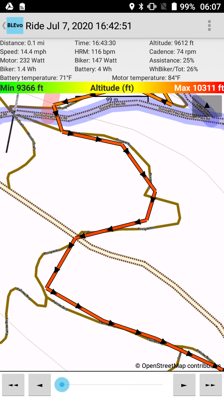

Is there a way to configure how often BLEvo records location points? The default setting is nice on storage space but seems to be chopping off parts of quickly turning trails. (see attached) I have the configuration set to use bike data instead of GPS so I'm guessing the computed distance wouldn't be affected. However, if that weren't the case then using GPS data might result in a different distance measurement, too short in this example.

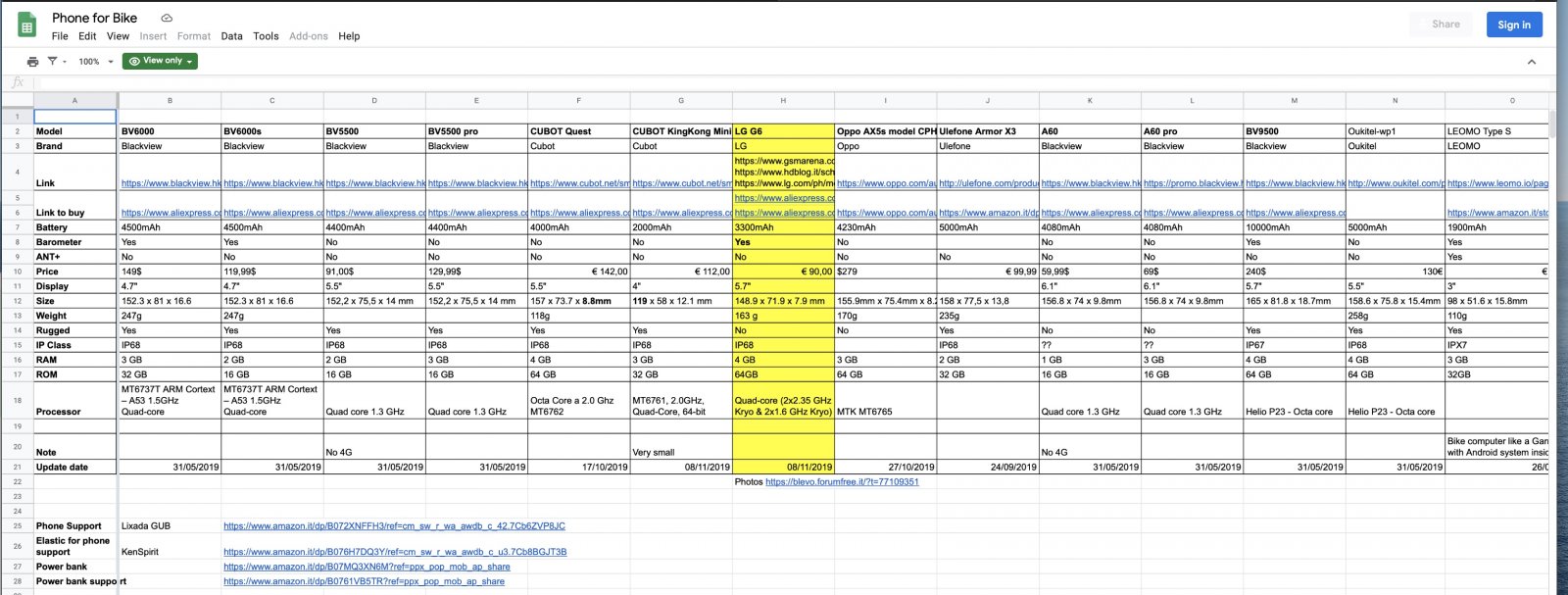

Hi , what do I need to check to see if a phone will work with Blevo ?
Gps and blutoth ?
is this ok ?
Gps and blutoth ?
is this ok ?
This lists the best devices and should help.
docs.google.com/spreadsheets/d/1FdndbYis42Xs3r8ydFVkXVJgolDjODwrXhr7lq1dPvs/edit#gid=0
I'd like something much smaller than the Blackview. This is the smallest. Smaller battery of course but presumably also much lower power usage.
