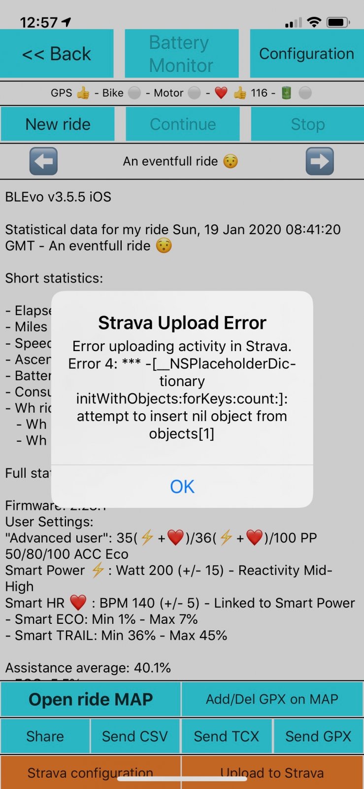

Anybody else have problems uploading to Strava.
I've had the same issue since my Samsung Galaxy S10 auto upgraded itself to Android 10.
I have to de-authorise and re-authorise Strava after every ride.

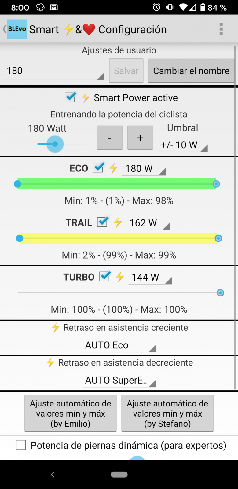

Thx, I already knew this list and followed everyhting in there.
Are you sure that my settings make sense? I see that many other people dont use the full range of power in the different modes, could that be a problem?
For me it feels that the bike is mostly pushing with full power, even if I just pedal super lightly.
Hi I have exactly the same thing. It only happens to me when I am in Turbo Mode. My turbo is set 90-100%. My Trail Mode is 6-89% and in that mode all works as it should. I did wonder about my freehub mechanism. The freehub needs to be cleaned because it is spinning with the wheel instead of stopping. The front ring is then being driven by the chain!! I think in Turbo Mode this is sufficient the fool the motor into thinking I am pedelling, hence the bike drives itself! I am having the freehub sorted out soon and will let you know the result. Robert

I have just released version 3.5.6 of BLEvo for iOS.
Here are the news:
- Increased the maximum of the second battery to 1500wh
- Now if there is a Strava upload error due to authentication, authentication is automatically requested
- Bugfix upload activity in Strava
Download the update from
‎BLEvo - For Smart Turbo Levo
