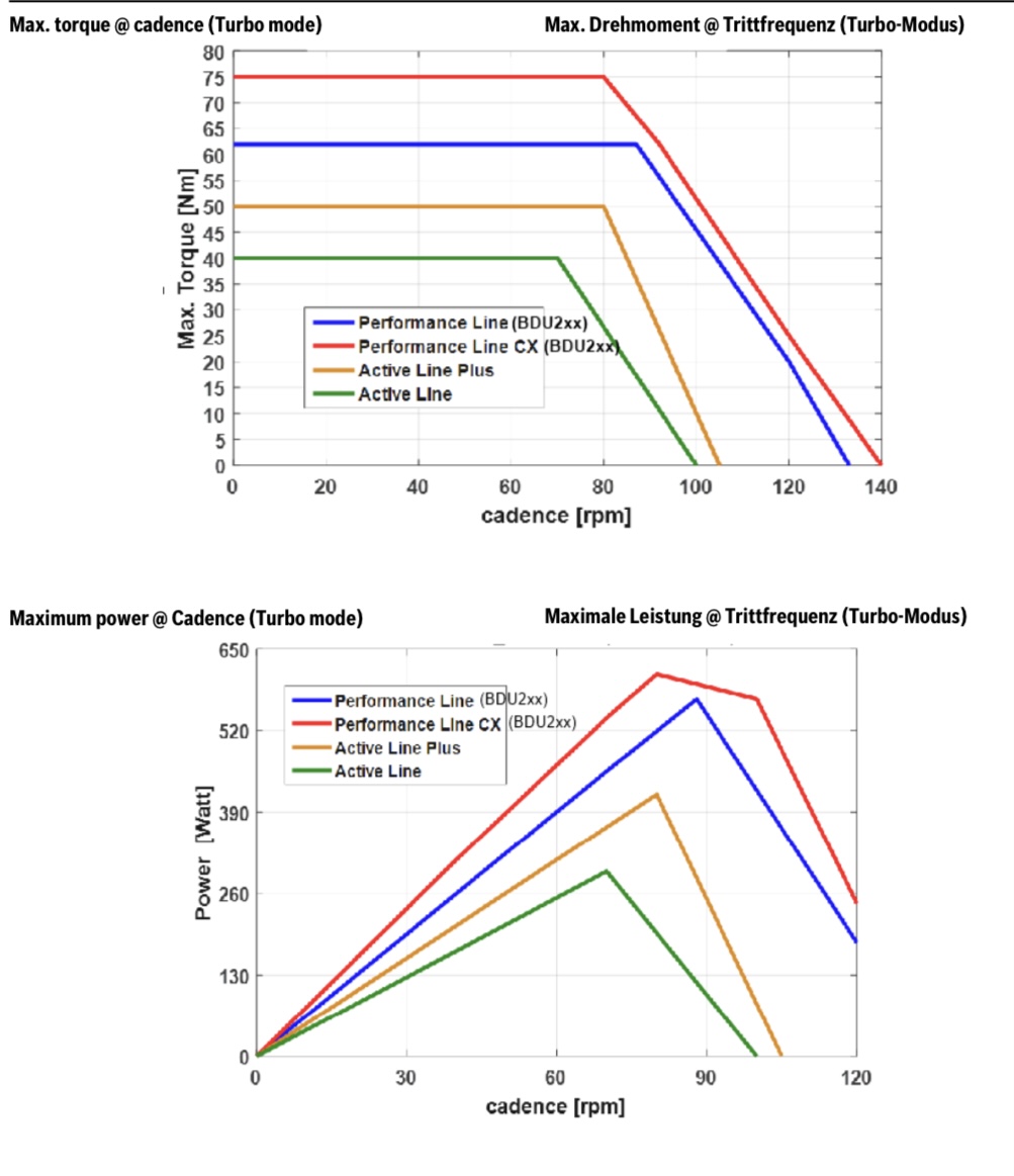

I have seen a report from a german review pointing out as one of the main changes is that the CX Race is optimized for Higher Cadence Ranges, possible to give decent support upwards of 120rpm range.
If that is true and the fact that Bosch didn't want to spit out anything about the internal changes of the motor, that tells to me, that they had to implement some internal motor gearing changes to make that possible.
As internal gearing is the main limiting factor(due to space constrains)for good support in higher cadences in today's motors.
The CX Performance Gen4 is optimized to 80rpm as far as I know.
If the Race has this limit higher in the 90rpm's range, that would be something radically new that none of the other players have and would mean a significant advantage on really steep climbs where high cadence(low gears/big sprockets) is used.
With a higher cadence optimized motor you don't loose the torque levels as fast as you would with one that is optimized for lower cadences.
I think the future of ebike mtb motors should go into making motors optimized for higher cadences and tuning different modes according to the usual average cadence used in that specific mode.
The Levo is optimized for 85, FWIW. Given that you really don't need big gears for downhills, the low gears are already pretty low on a lot of eMTBs with 12 speed rear cassettes. A 32-52 with 400% boost is gonna get you up just about anything that the laws of physics would let you get up.
I am aware of the cassette/chainring gearing and how your example gets you up almost anything, but in racing it's how fast it gets u up anything what matters.
I am not talking about cassette/chainring gearing, but about motor internal gearing that down-gears your input cadence to an reasonable rpm for the electric motor inside that then does not need to spin to fast, as when it spins to fast the torque decreases pretty fast what you can see nicely in the attached graphics...not sure where exactly the graphics are from found them on the forums, but for example purposes they are quite clear, you can see the relation of torque/power to cadence.
Now imagine a motor that has the ideal cadence range shifted higher into the low 100s.
Don't know how often you follow your cadence when climbing physics possible climbs in the 32-52 combo?
I do and my best possible combo is 36-51 and my cadence is way over 100rpm...so yours is even higher with the lower combo...now if you check where the torque is at those higher cadences you can see that a motor optimized for higher cadences has an advantage in power and torque at given cadence. Time will tell if the CX Race really has new guts inside. Definitely hope so as I think this is what the emtb motors are missing, higher cadence support.
A good example of this kind of thinking is the R&D of the new TQ HPR50 where because of no multiple gears inside, they didn't have this limitation and at their testing they found out that riders sometimes with short half stroke pedaling reach cadences north of 140rpm so they optimized their motor much higher because of the design they could.
The classic motor design with multiple gears have some limitations because of the space constrain.
Well so much from me...✌ happy riding ⚡
