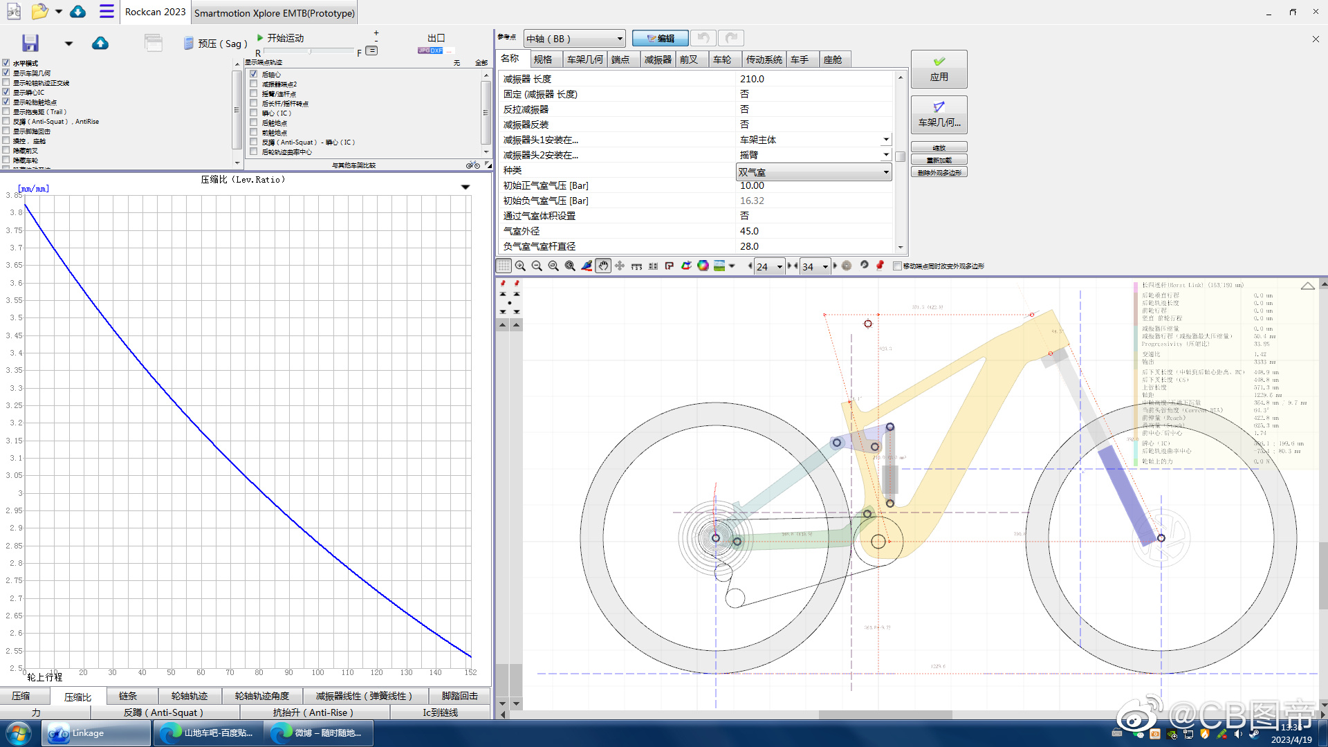

33% progression in the leverage curve. Linear air can on super deluxe would probably suite it better, than meg-neg. Or coil.

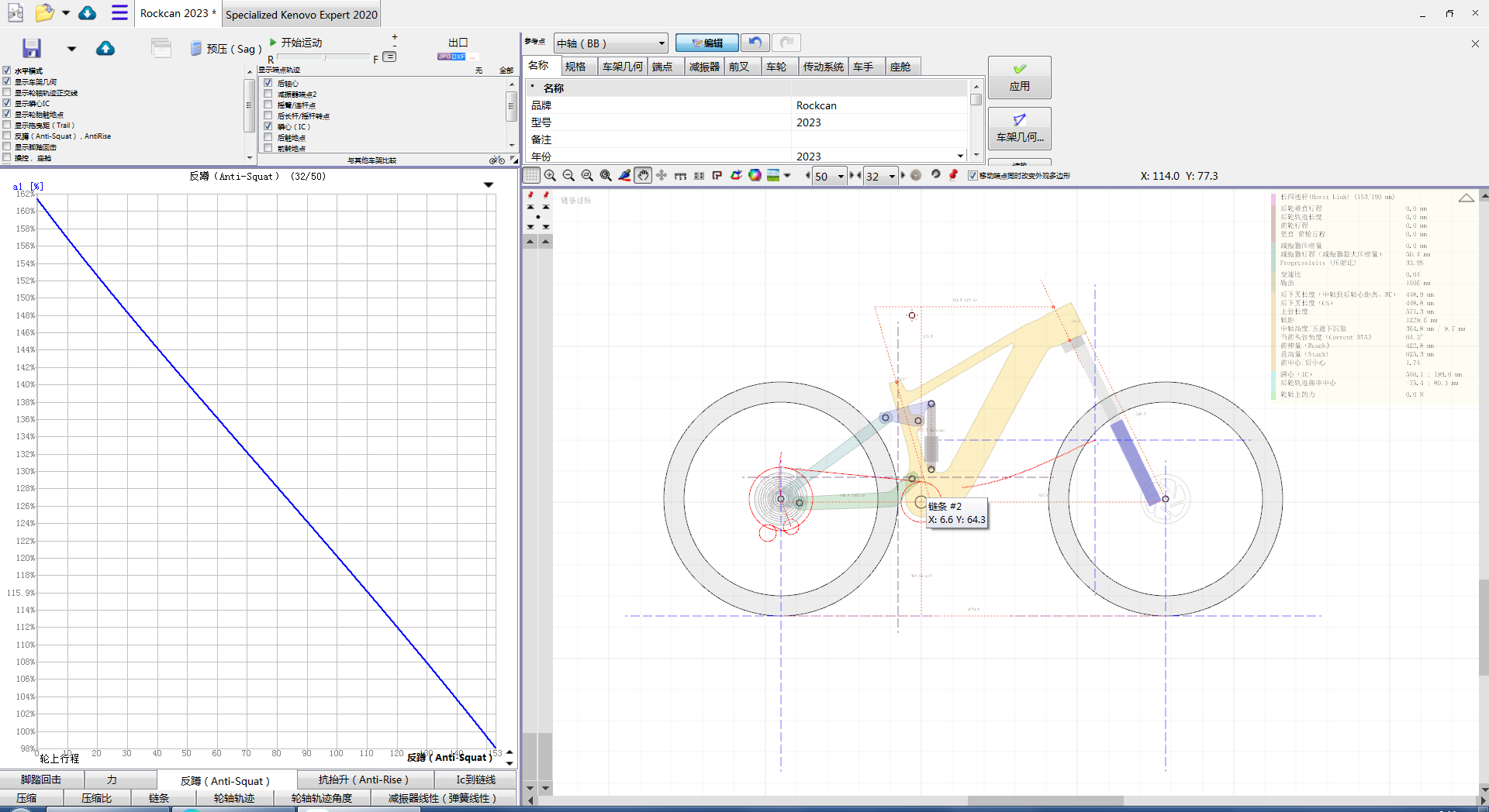

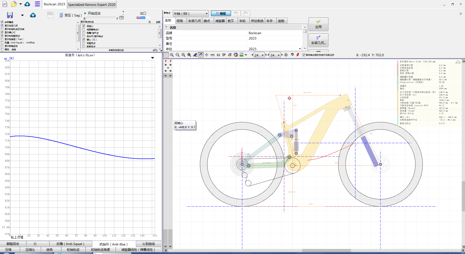

@Lehr Do you maybe also have a braking anri-rise curve? And anti squat for 32/50 or 34/40 rings?
tnx

This is with a SuperDeluxe ultimate Air 210x50. Based on the leverage curve imo makes no sense to go for a megneg or a coil.

This is with a SuperDeluxe ultimate Air 210x55. Based on the leverage curve imo makes no sense to go for a megneg or a coil.
