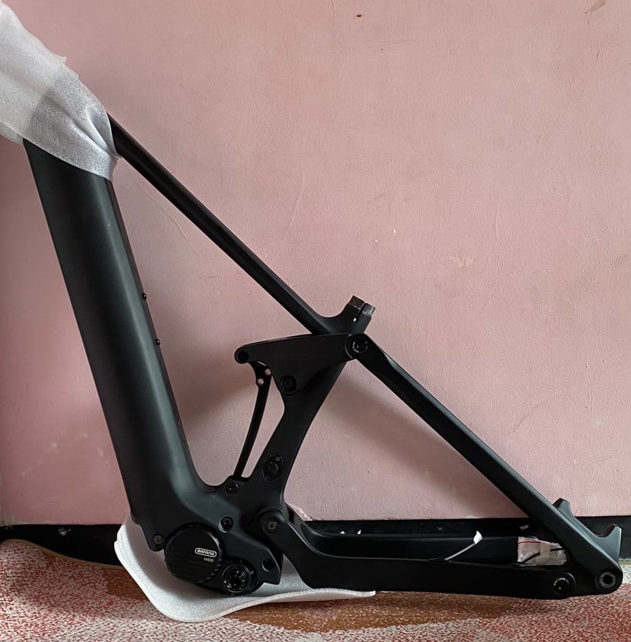

My Frame kit arrive safely after 3 weeks delayed of Ied holiday. I will assemble as soon as possible, hope can test it next Tuesday. It is Size S with 720Wh battery.

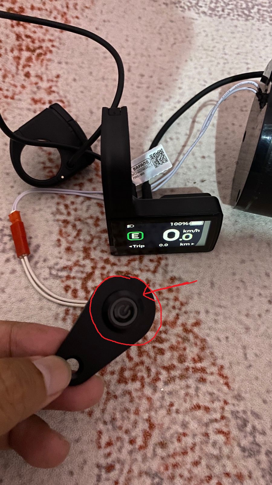

To @LAnton and @stuff , this button don't have led indicator when switch on?View attachment 115095
That doesnt look like the oem one, should hace a CAN interface and thats why it doesnt have light. Check the DP E171 manual.
About that button. It is supposed to be a control with assist levels etc so if it is canbus it would be a communitions line. You don't want to connect it to a battery like that, might burn it out. Canbus devices talk to each other over the canbus so it is not a simple switch.
HOWEVER, canbus should always have four wires. Power, Ground and the two communications wires. So something is wrong with that picture with only two wires.
