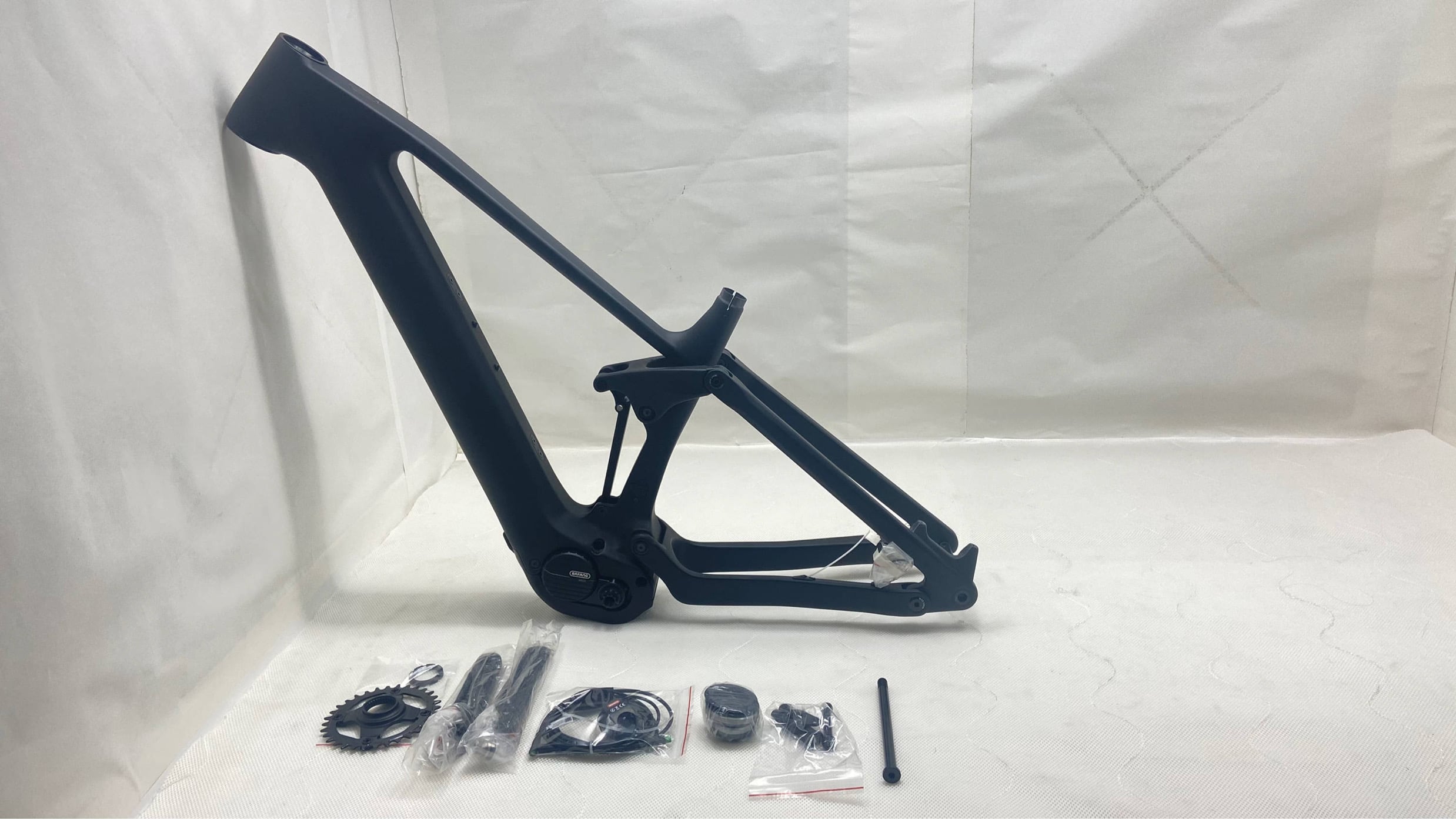

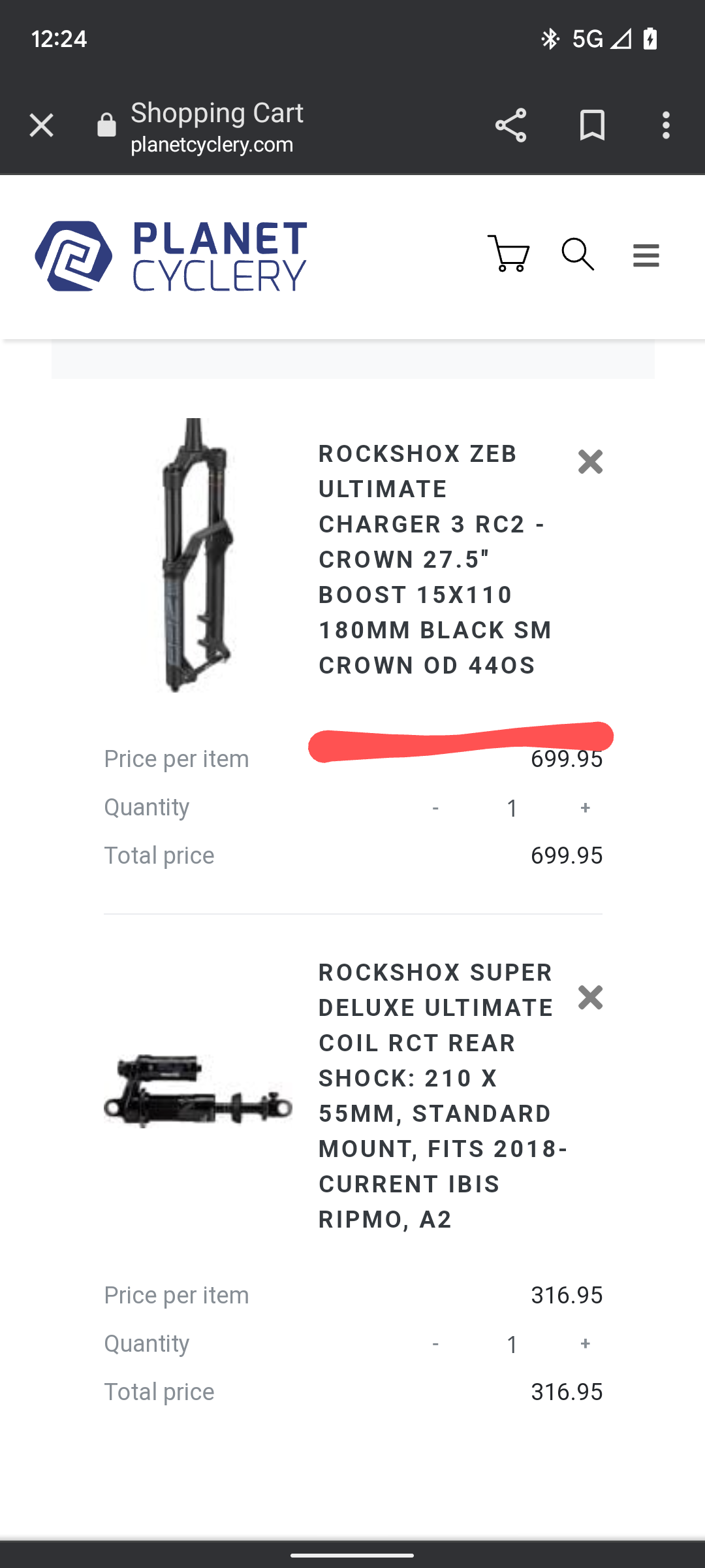

My thinking was to match the frame but what the hell do I know. I'll be running it MX so that would slacken things out a bit. Also I was going to run it 170mm. So it should end up being somewhere around 165/170.
Wait...my bad! 44OS not 51. I forgot as I bought them almost 4 months ago now since I committed to the CEF50 frame ...wow!

I’ve tried both 44 and 51 on my Ripmo. The biggest thing I notice is the speed of the steering. Not crazy but it’s a bit more sensitive. For my riding style it gives me the feeling at speed I can change directions very easily. It can make a longer bike feel like you can chuck it around a bit more. Either way given 5 rides on a new offset you completely forget about it.
I just went with my 44 OS cause was on sale and I got the Zeb charger 3.1 damper and buttercups etc. 😁
Also, the article said 44 tends to be 27.5er and 51 29er "standard'" .
I probably couldn't tell you if they feel different unless you pointed it out to me. Like you said habituate fast with muscle memory.👍

You are just going to change the angles slightly. If you want to be true to the design use 51 but you can certainly try a fork you have and see what it feels like. I have a 48 that I don't think will change thing much.

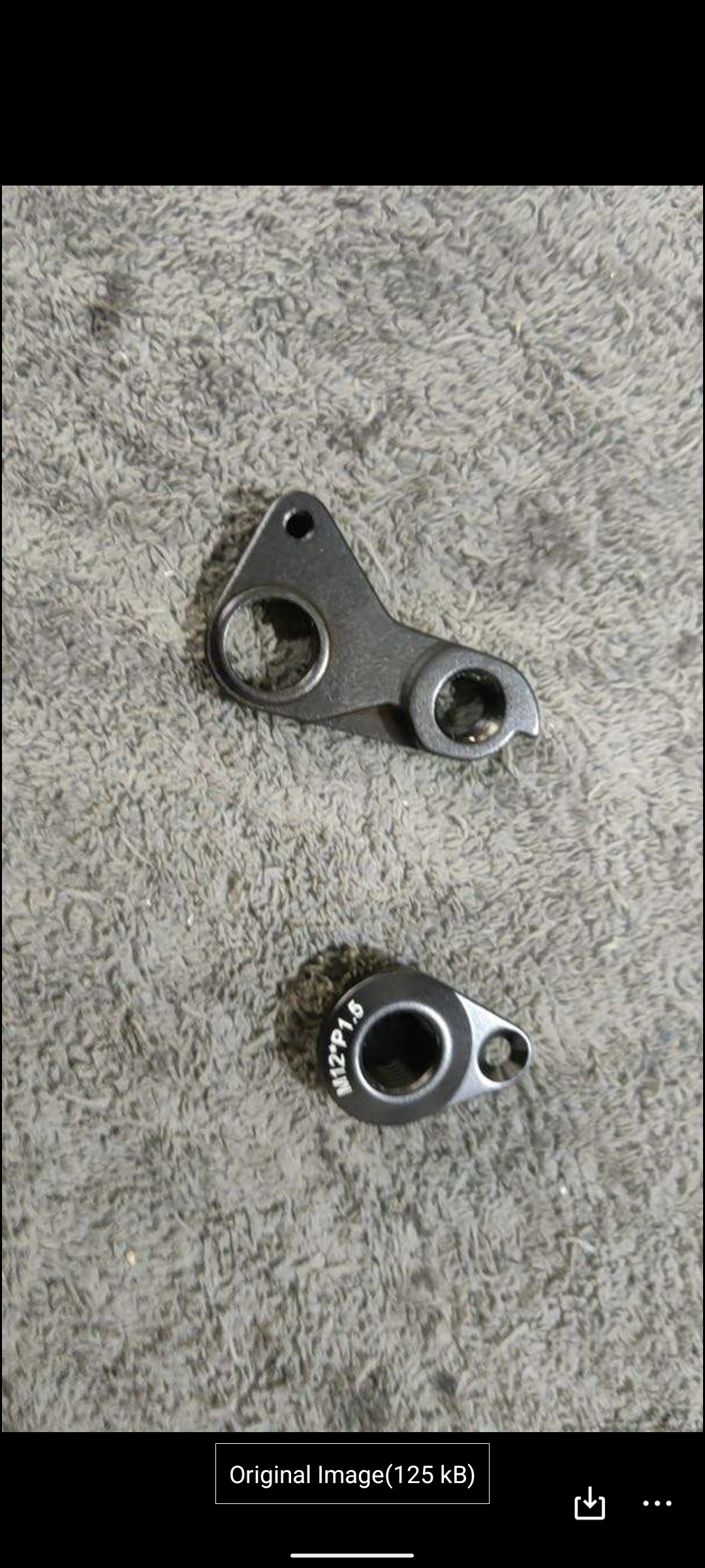

speaking of which, does anyone know if this frame uses a Universal Derailleur Hanger (UDH)?
Standard. I'm pretty sure. But it might be wise to clarify with SZC.

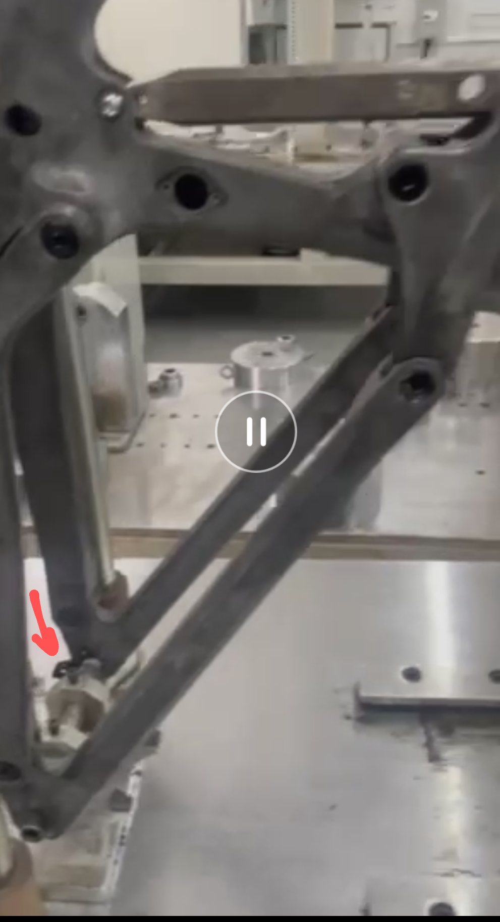

Update: I just request a pic of the current derailleur hanger. I'll post it when she answers. Unless someone else knows for sure.
New update: it looks to be standard from a still pic of one of their stress test vids Linda sent me.

I'm using 51mm on 180 27.5er. Probably best feedback will be from our resident mechanical engineer with big travel Enduro knowledge: thaeber. He's the man!🤛
Thanks for the flowers mate 😊 ideed I investigated this in deep to get my opinion on that. Takeaway is, that the difference is almost not noticeable. There is a slight reduction of trail with the bigger offset, that should result in a livelier steering bahviour. But at a 130ish mm trail the difference is only a few mm, and I doubt that this is a gamechanger. @Myalteregohamish had the opportunity to try it himself on the same bike (what I never had), and I think his answer tells the story quite well 😊
