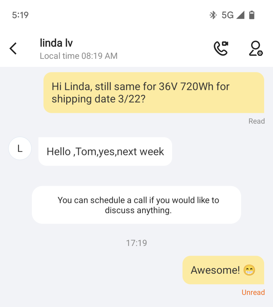

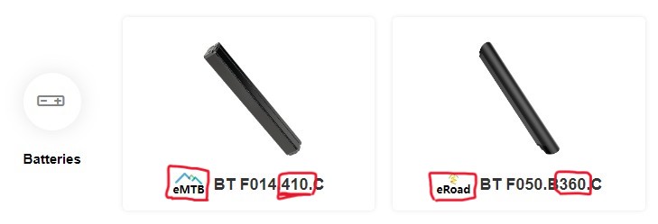

Linda, says you have to choose between the m820 motor, 43V 410wh battery and 36V 720wh.
The 43V 410wh battery is marked for eMTB and the 36V 360wh (36V 720wh) battery is marked for eRoad on the Bafang home page.
What should I choose?

Take the additional 3 lbs and go big! Pretty shure You regret the decision for the smaller battery, if no range extender is available.
It totally depends on how you ride. If you ride a 12 mile single every day then there is no reason to carry the extra weight. if you ride all day adventures to the top of a 5,000ft mountain then you probably want the 720whr. If you ride 12 miles singletrack and once in a while do a big adventure then you probably what a 410whr and an extender for the times you go farther. There is no right answer it just depends on how you ride.
All the M820 ffamily can be used for road or mtb. Both the 360whr 36v and the 410whr 43v can be used for mtb. The 36v 360whr mtb battery is FT100.b360.c.
I agree with this except I already do 17 miles and 2000' in very chunky terrain on my pedal bike.
Seems the 410 would do 30-35 miles like it was nothing.

You have the wrong 36v battery for the CEF50. The 36v 360whr battery for the CEF50 is the FT100.b360.c and I have two on order for my two bikes. You can see the battery page from the Bafang catalog above earlier in the thread.
