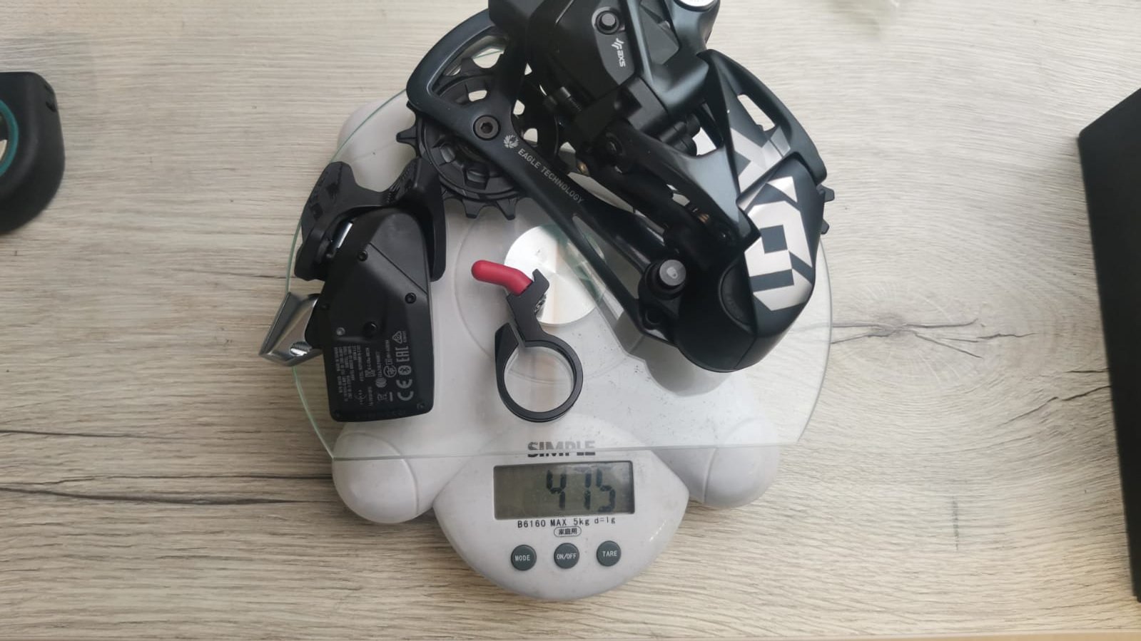

Hells yeah! I got it. I found 464 g off the original dry weight. It's mainly the cassette and dropper + saddle switch out. The 12 spd cassette is a zitto light steel that saves 220 g for only $85.
So, new overall total = 20,715 g/45.68 lbs! 🥳

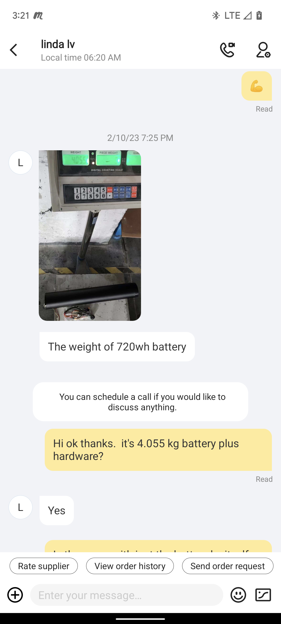

Sorry, but I'm sort of asking you for clarification because you are our resident expert.
Bafang has the 720 battery listed as 3.8 kgs
You have the 720 battery listed as 4.06 kgs. Is the hardware the .26 kg weight difference and should be applied to all published battery weights?
Bafang has the 410 battery listed as 2.6 kgs
AND, I have written in my notes that Linda had showed a photos of their custom 710 battery weighing only 3.3 kgs.
Can you clarify what is correct? thanks

Bafang does not make a 720whr battery that fits this frame downtube only a 360wh and a 410whr. Zhaosheng has contracted a third party to make the 720whr battery that TC is getting.
Bafang does not make a 720whr battery that fits this frame downtube only a 360wh and a 410whr. Zhaosheng has contracted a third party to make the 710whr battery that TC is getting.
Linda kept referring to at as 720 in-house....I know their geo diagram shows 710 but I want to err on bigger capacity if possible.😁 But we'll see, maybe the extra 10wh is the hidden reserve for Rocky mode?😉
