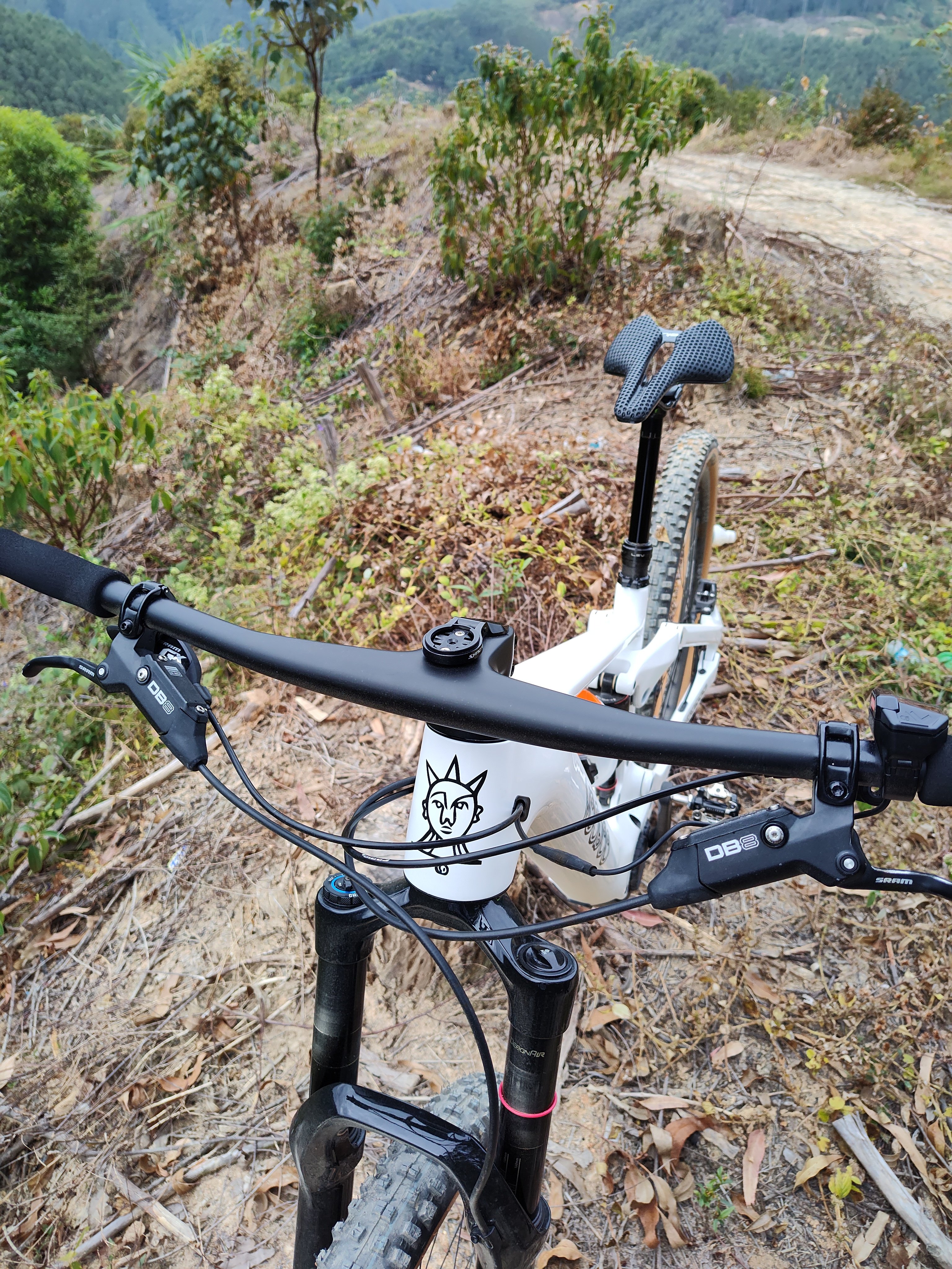

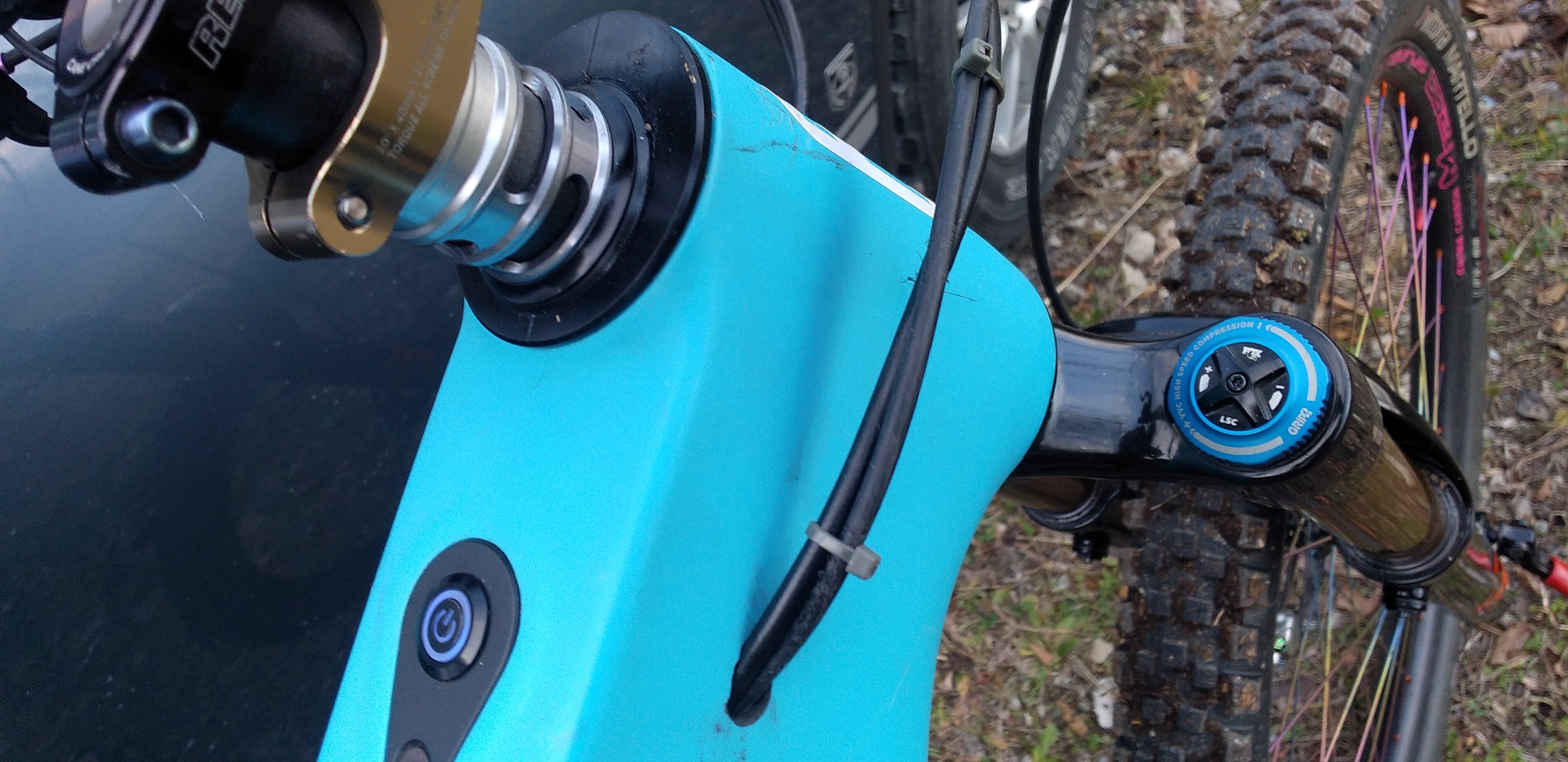

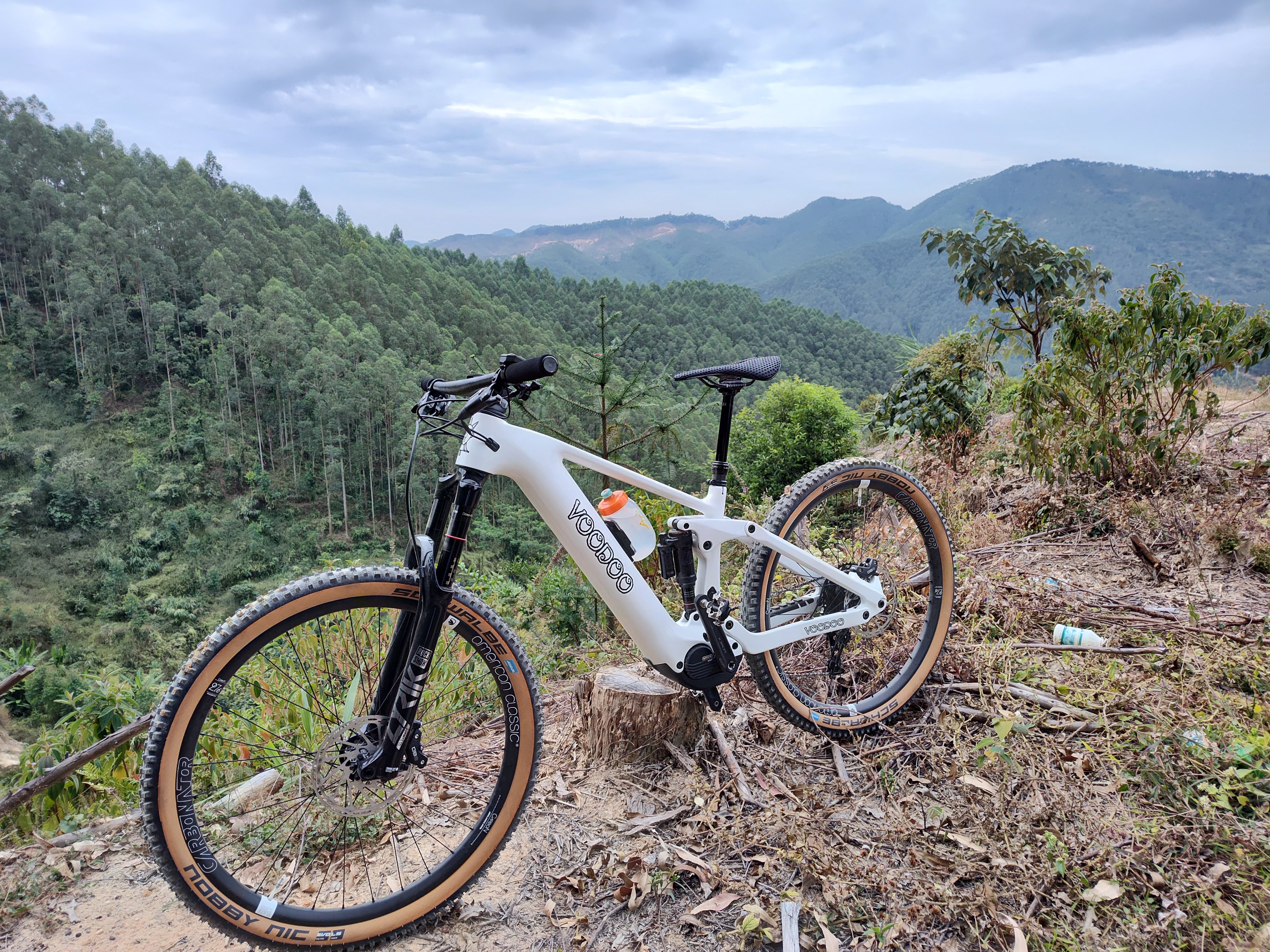

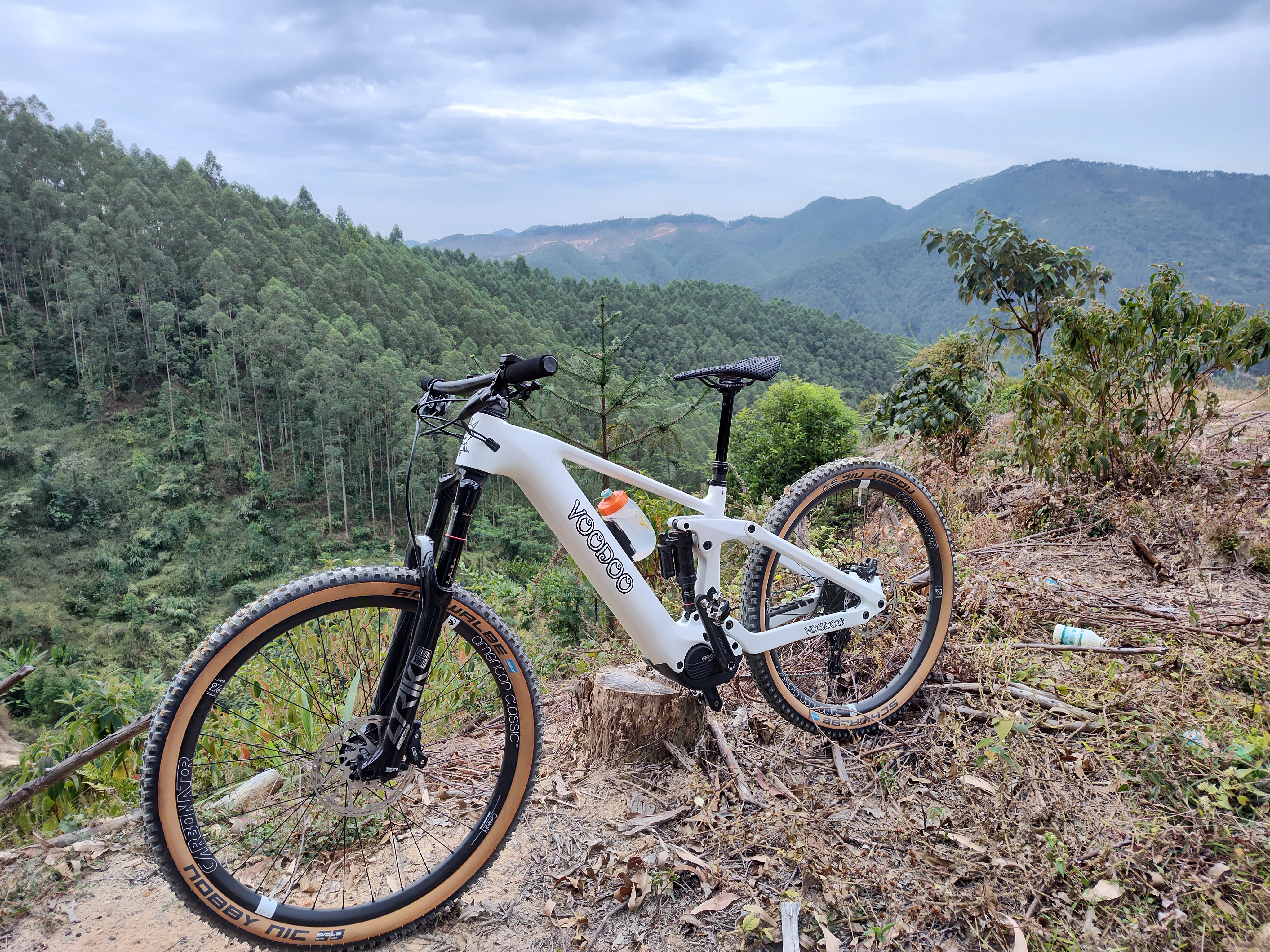

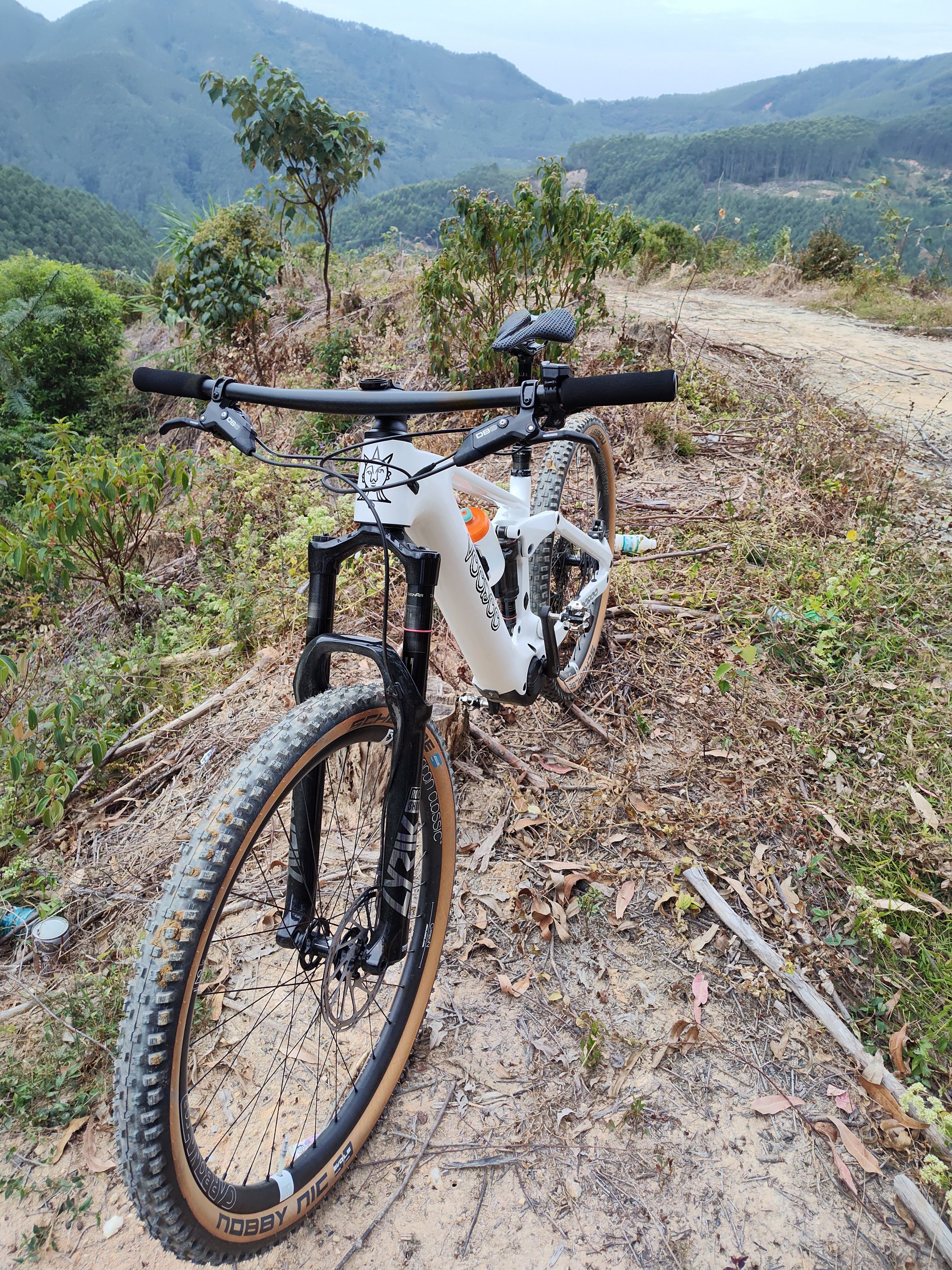

I got tired of wiring so I drilled holes in the frame. I was able to change the head angle twice by combining head parts.

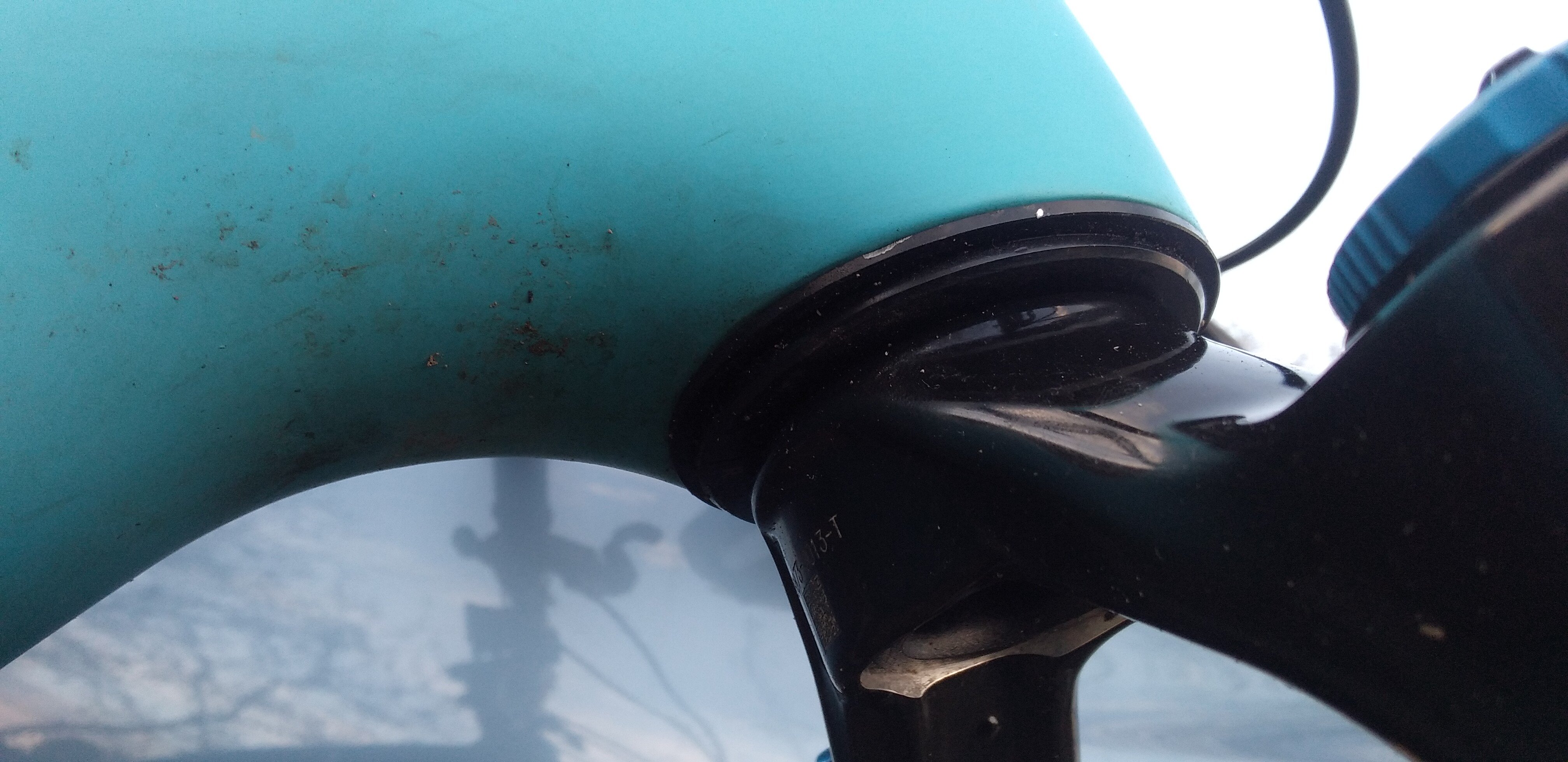

What is the bronze thing under the stem? Nice job on the cable routing.

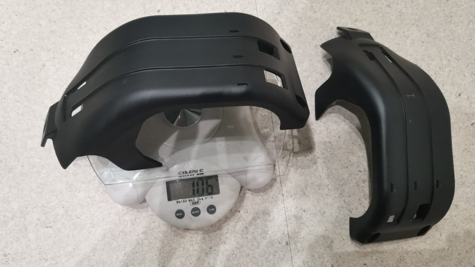

Does anyone have the motor guard weight? Linda doesn't know.😝

Yet, Linda disclosed they knew the first motor guard (Gen 1) was really weak...it broke with their pro rider when he was testing the frame. He recommended the protective armor guard be used to help mitigate the material flaws. But they still launched with the error anyway.
This convo happened after the second Gen broke on me and after I strongly suggested to Linda that SZZS make a full carbon guard. And to boot with the 3rd Gen, they are not able to stress test it because their testing machine is "down". Then they want the consumer to pay for it rather than warranty it straight away. They're having consumers beta test it I guess? In sum, not so impressive on the motor guard, even a little unethical, but hey it's DIY.😒
I agree support has been good on my frame warranty replacement (which was damaged out of the box). 5 ⭐. They balked on my chainstay replacement and took some convincing 4 ⭐. 0⭐ for quality control on sending me the shorter main pivot bolt at the outset. And was luckily to have one fabricated locally rather than wait another 3-4 weeks for shipping the proper size. But again it's tough to ride without a working motor cover.
It also looks good on their new upper headset I just installed. It appears like an improvement that's far easier to set up, looks to be better sealed, and has a custom slot to fit the chunkier display plug. 4 ⭐ (I didn't bother with a warranty for a new display cable and old headset for sake of time).
Sorry to sound overly critical on this one. However, SZZS has failed fully so far on this piece of important bike protection. - 1⭐
Jus' say'n hoping Gen 3 plastic works, given absolutely no stress testing...🤞

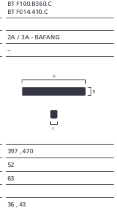

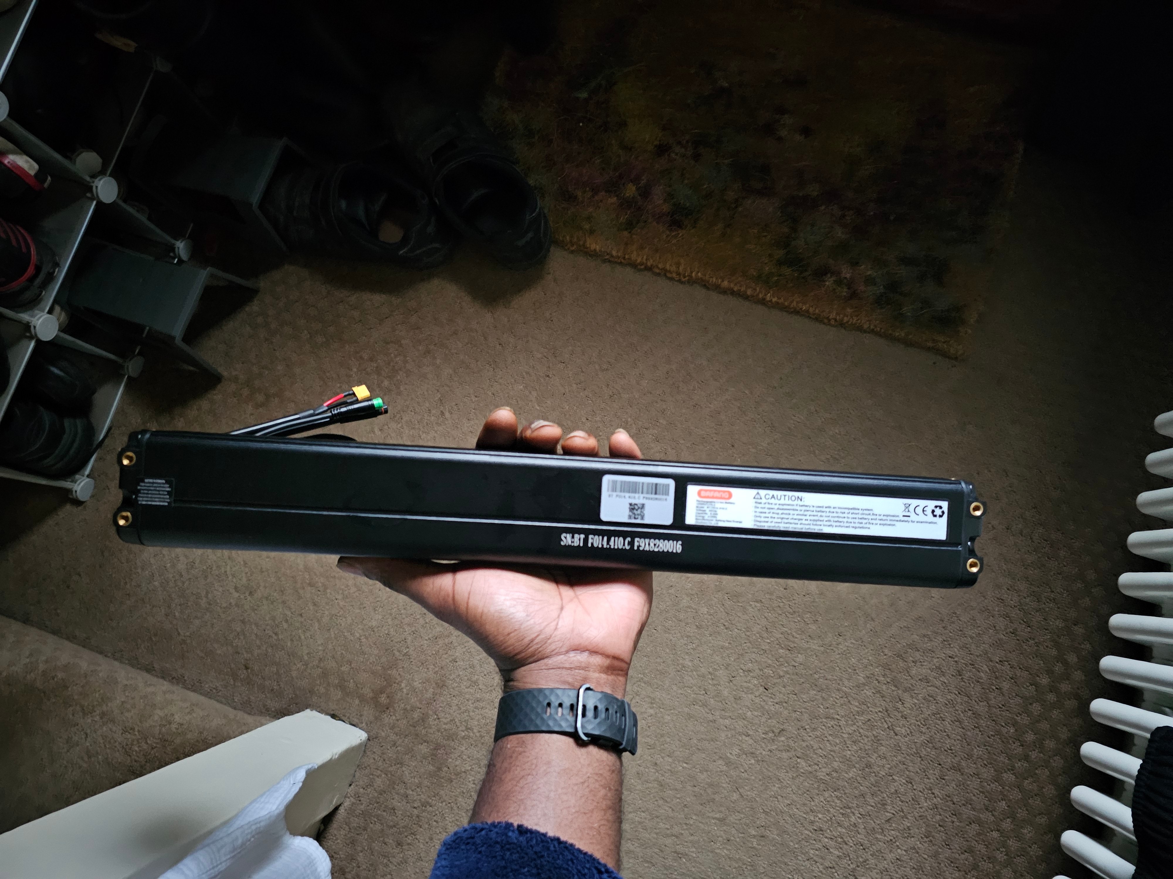

Does somebody have noted the space avilable (the 2 width) for battery in frame ? I'm too lazy to remove motor to mesure 😪 700W was too much (18% for 1000 D+) i will never use more than 50%, i will be phisically HS before. I whould see to install 480 W (and win 1Kg)
Here are the measurements that Bafang provides for the BT014 in their catalog.
A=470 B=52 C=63 for the 43v
It fit inside the CEF50 ?
Yes👍🏿
You should have the mounting plate for the frame to attach the battery.
The only thing I'll add is that you may want to use insolation foam, as the space between the interior of the downtube and the battery is roughly 20mm on all sides. Without the foam, you'll hear a rattle between the battery and cables within the downtube👍🏿
Yes👍🏿
Thanks. that would mean that space availble is more than A=470 B=52 C=63, 54 X 65 ? I plan to insert battery whitout casing, only fixed upper and lower (alike i have done on the LCES1075), not verticaly along the diagonal tube.
In fact i have measured item build to support the battery, i have 80mm width between each motor fixing point (and more for the battery space). Enough to pass 75mm battery. It's that i wanted to know b efore ordering one.

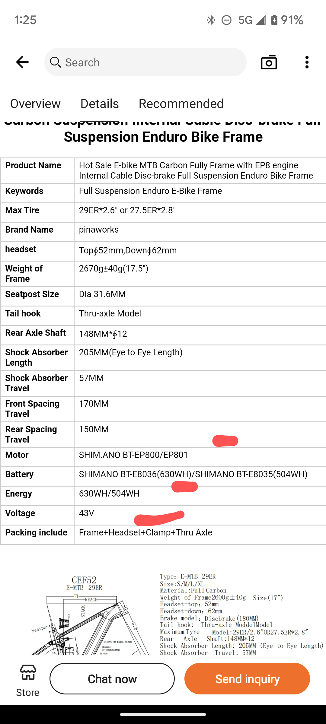

EP801 Mid-Ship Drive Unit US for CEF52.
Just found this item on AliExpress. Check it out! $704.85 15%OFF | SHIMANO STEPS EP801 Mid-Ship Drive Unit US Class 3 Device Supports New CAN and ACC Ports DU-EP801 E-bike Parts
My final analysis CEF50 V. CEF52: gain 10 Nm of torque but lose 90 Wh of battery juice and probably should buy a spare EP801 and spend an extra $800 plus an extender$?.

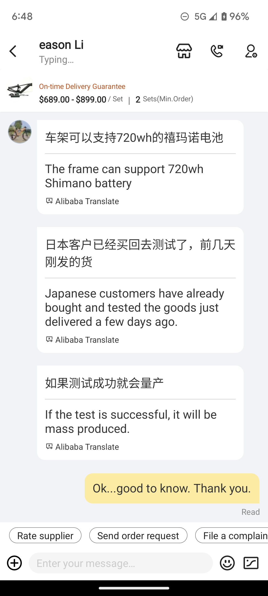

UPDATE: SZZS is checking on the battery size for the CEF52.
Currently no Shimano batteries are available, but should be able to make a bigger 720Wh battery for the +10 Nm of torque.
Salesperson is checking TBD...
Looks they can use a 720 Wh as well for the CEF52.
