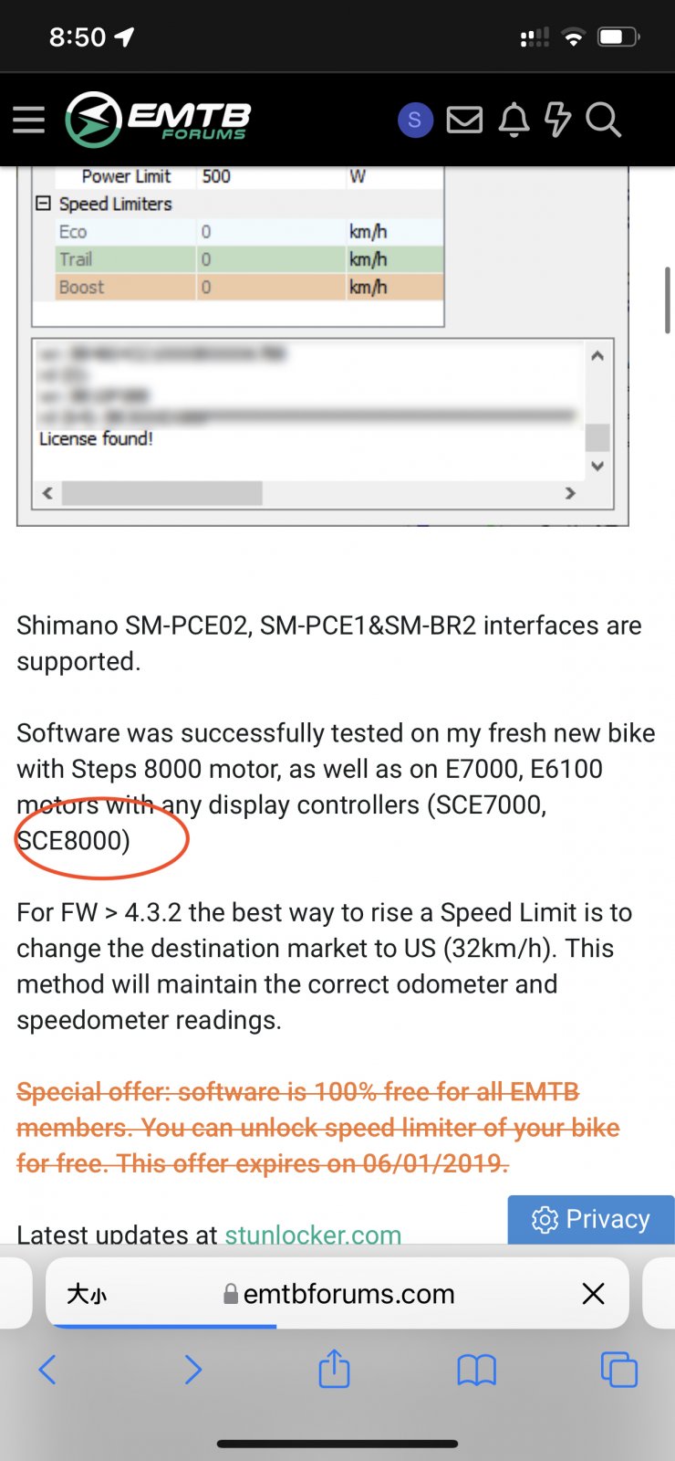

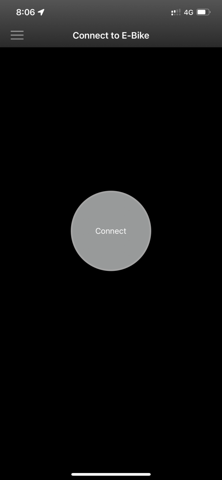

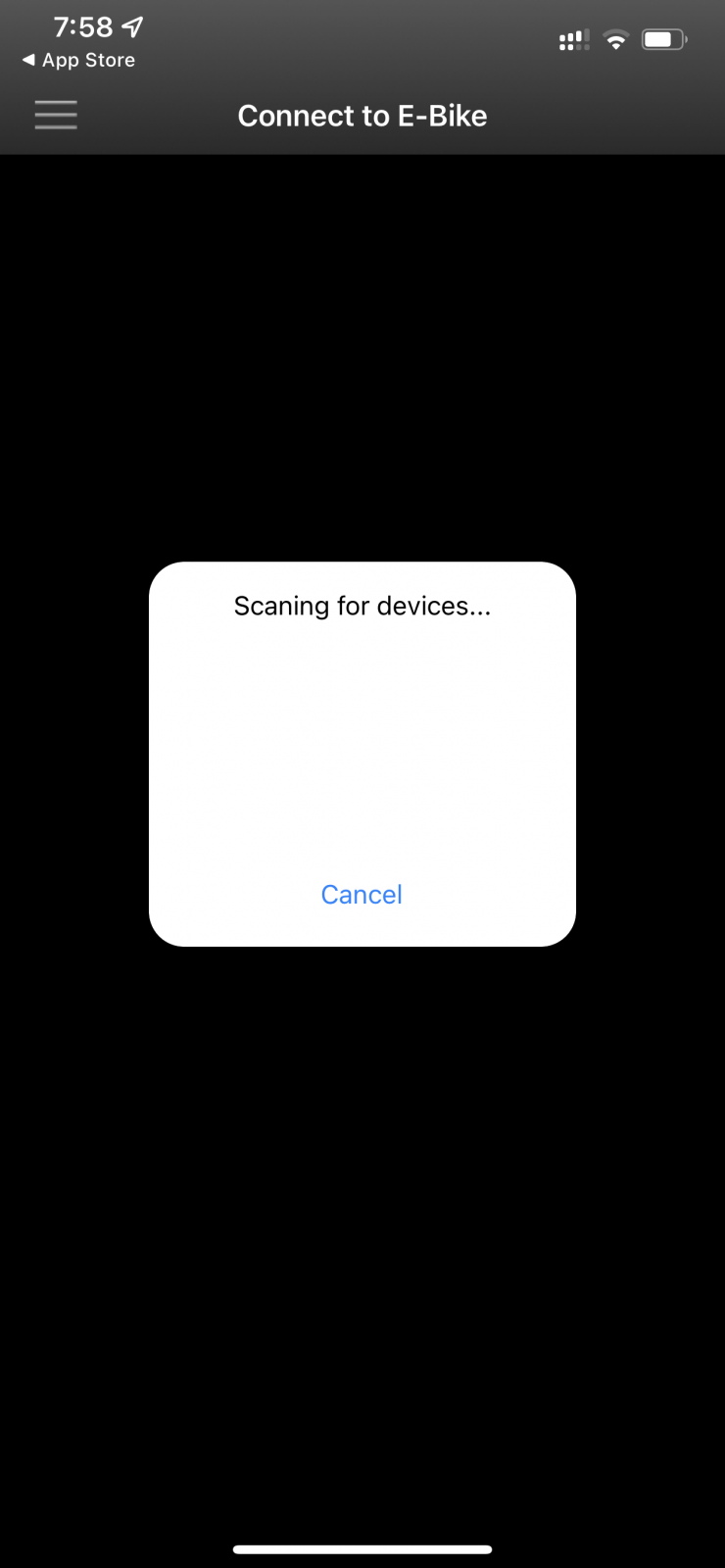

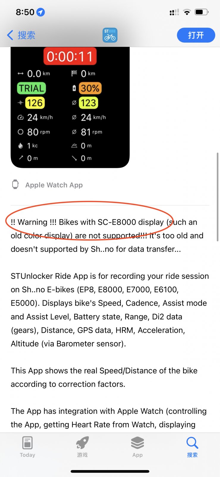

Hi, everyone. I just got a emtb with e8000 motor. Unfortunately it’s speed limit to 25km/h , pretty annoying when riding through woods. I do some research and find this Stunlocker ride app. Brought it and find a problem to connect to my bike.
1.I have no problem to connect with Shimano E-TUBE, but fail with this app.
2, on the app’s description page it says sce8000 display are not supported, but under this topic says test with sce8000 and works. I’m a little bit confused.
3, if this app not working with sce8000 display, is there any way I can unlock the speed limit? For example, by change the display?
Thanks for your time and much appreciated!

St ride is not for derestriction. What you are looking for is STUnlocker
Hi, thank you.
Just download the app. And successfully connect to my bike.
it seems if I want to unlock the speed, still need purchase a premium license?
