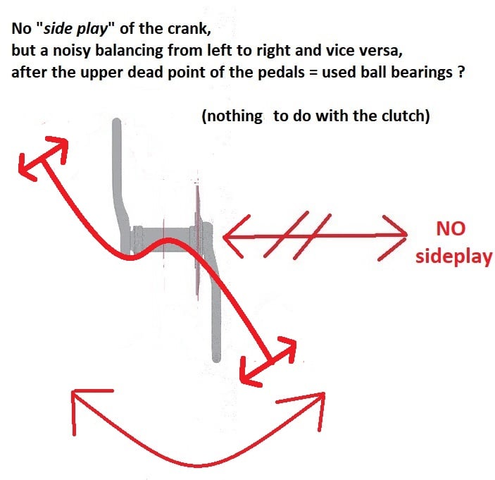

Crank play like a metronome.
No difference when the engine is on or off
The noisy swing is rather on the right side,
and even slightly perceptible under the feet when pedaling in a silent forest.

Thank you @S13 for your answer.
I can firmly say that there has never been with my E8000
any side play of the crank, even currently with this "noisy" swing.

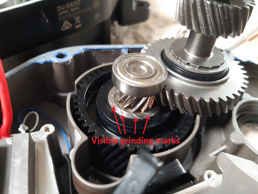

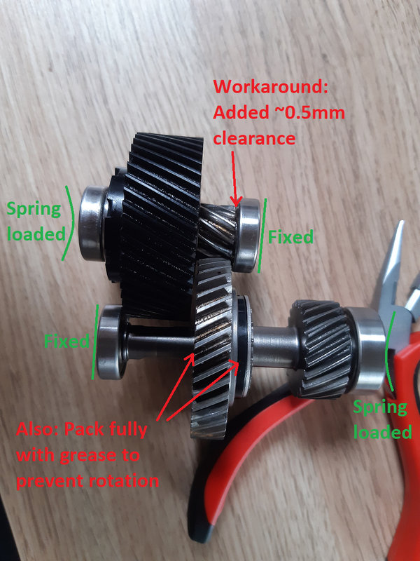

Ok, so i think ive finally found the true source of the whining sound in my motor. I thought it was the failure of the grease on the metal-metal gears, but i now think that is just a result of the problem, not the cause.
The cause is excessive play on the motor clutch gear (i think someone mentioned it here before, guess it is an important factor to look at!). The rubbing it causes probably heats up the gear and that leads to a failure of the grease. Hopefully the pictures show whats wrong and how i temporarily tried to fix it:
So for now ive added a little bit of clearance by moving one of the bearings to the outside. Also i packed the entire clutch full of grease until it came squirting out all openings. This stabilizes the gear a little bit.
This is my workaround for now, see if this prevents the whining sound and if the grease now holds up for longer than 500kms.
I do think this is a crappy design by Shimano. That clutch gear should never have been fixed with just a tiny retaining clip. It should have had a proper ball or needle bearing. Or otherwise a more precise retaining construction.
Ideally with this construction there should be a very thin shim with a large surface area to provide stabilization for the gear. Perhaps i will try to add one such shim next (if i can find one...)
I think the problem is also compounded by the fact that the gears are helical, meaning there is always a bit of sideways force on the gears. A straight cut gear would reduce this problem. But yeah those make more noise, so i get why shimano went helical here...
Anyway, back to testing next weeks. I'll let you know.

So in my last picture, with the term "washer" i actually meant the retaining clip. Its actually a E-clip or E-ring. That clip is too loose, has too much free play. The clip is actually too thin for the groove on the axle. And it doesnt support the gear all the way around (since it has a cut out on one side). So the clutch gear is allowed to wobble too much, because it has no other retaining mechanism (its just free floating).
Its causes an intermittent "ying...ying...ying..." sound as you pedal. Perhaps its identical to what you are describing.
If you were to open up your motor, see if you find the same scratch marks. Then you will know.
So the different solutions that i im going to try are:
1. A thicker E-clip. The standard E-clip measures 0.8mm thick, 9mm hole, 18mm outside diameter. Ive ordered a couple of 1mm thick E-clips, see if they fit. Should arrive by christmas.
2. Put a metal shim between the E-clip and the clutch gear. Still not sure what the best size would be. At most you can get a M12 shim on the axle. The axle itself is M10 however:
Ive ordered several 0.1mm shims with different inner diameters, see if i can make something work.
However, Im hoping the thicker E-clip is sufficient to stabilize the clutch gear... Would be the easiest and cheapest solution.
By the way, im not implying the E8000 is a totally crappy design. In fact most of it is pretty good. Its pretty easy to work on, bearings can be replaced etc and most constructions are pretty solid. But every design has its strengths and weaknesses. And this clutch retaining mechanism is one of the weaknesses for the E8000 motor.
Technically the gear should be allowed to float, it will stop it binding or wearing the clip. If all the bearings and wave washers are set right, your noise and damage should disappear. Many of the motors we work on have bearings set at particular depths to give very particular tolerances.
The bearing you pulled back by 0.5mm should have a measurement of 0.8mm from the inner race of the bearing to the end of the gear shaft. The opposite bearing on the other end of the shaft should be 0.4mm.
Each bearing on the other shaft holding the steel gears should both have 0.5mm clearance from inner race to end of shaft.
The wave washers, if flattened, should ideally be changed or at least some form put back into them. This should stop your gears grating without changing any design parameters.
For those reading this who may not be aware... if a bearing needs to be pulled back on a shaft, it should, ideally, be replaced because you will be pulling on the outer race and this can damage the race and balls leading to premature failure.
Hope this helps.
