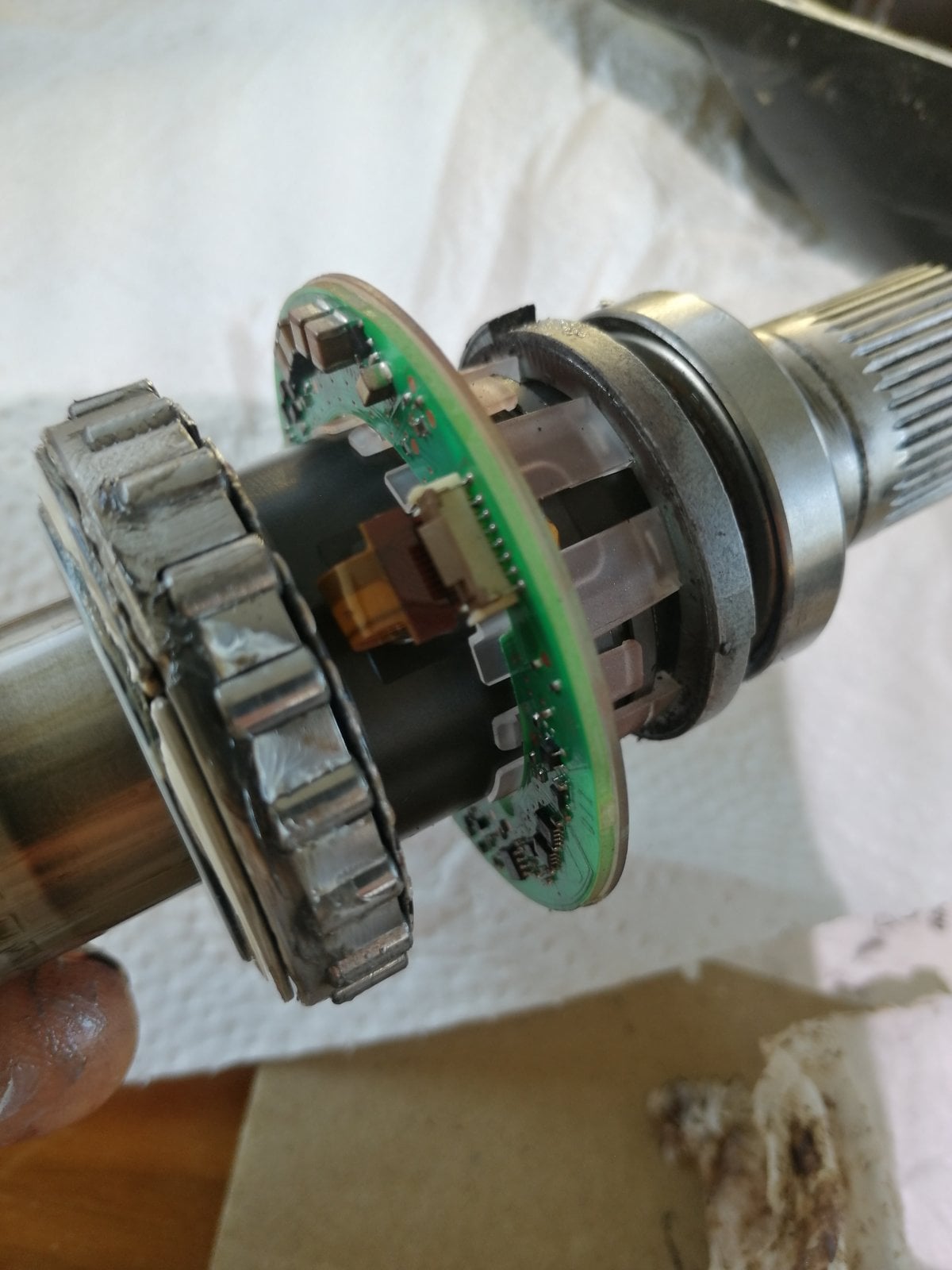

Measured battery voltage which was fine (36V), so I reluctantly opened the motor. The only connector I had unplugged was the main one between the case halves. I found it wasn’t fully seated - it clicked in a bit more when pressed firmly. Reassembled everything... but still E010.
At this point I considered giving up and calling a pro. But I decided to open it one more time. This time I removed all the gears and the torque sensor. On close inspection, I noticed the torque sensor ribbon cables were loose in the connectors - the connector clamps were both in the “up” (unlocked) position.
I never intentionally undid those clamps, but I guess I must have somehow bumped them?
I made sure the the ribbons were fully inserted and locked the clamps down properly.
Reassembled the motor again... and this time... it worked!
TLDR: If you get E010 error on powerup after bearing replacement, check that the torque sensor ribbon connectors are locked down. In fact, I’d recommend checking this before reassembling the motor the first time 🙂

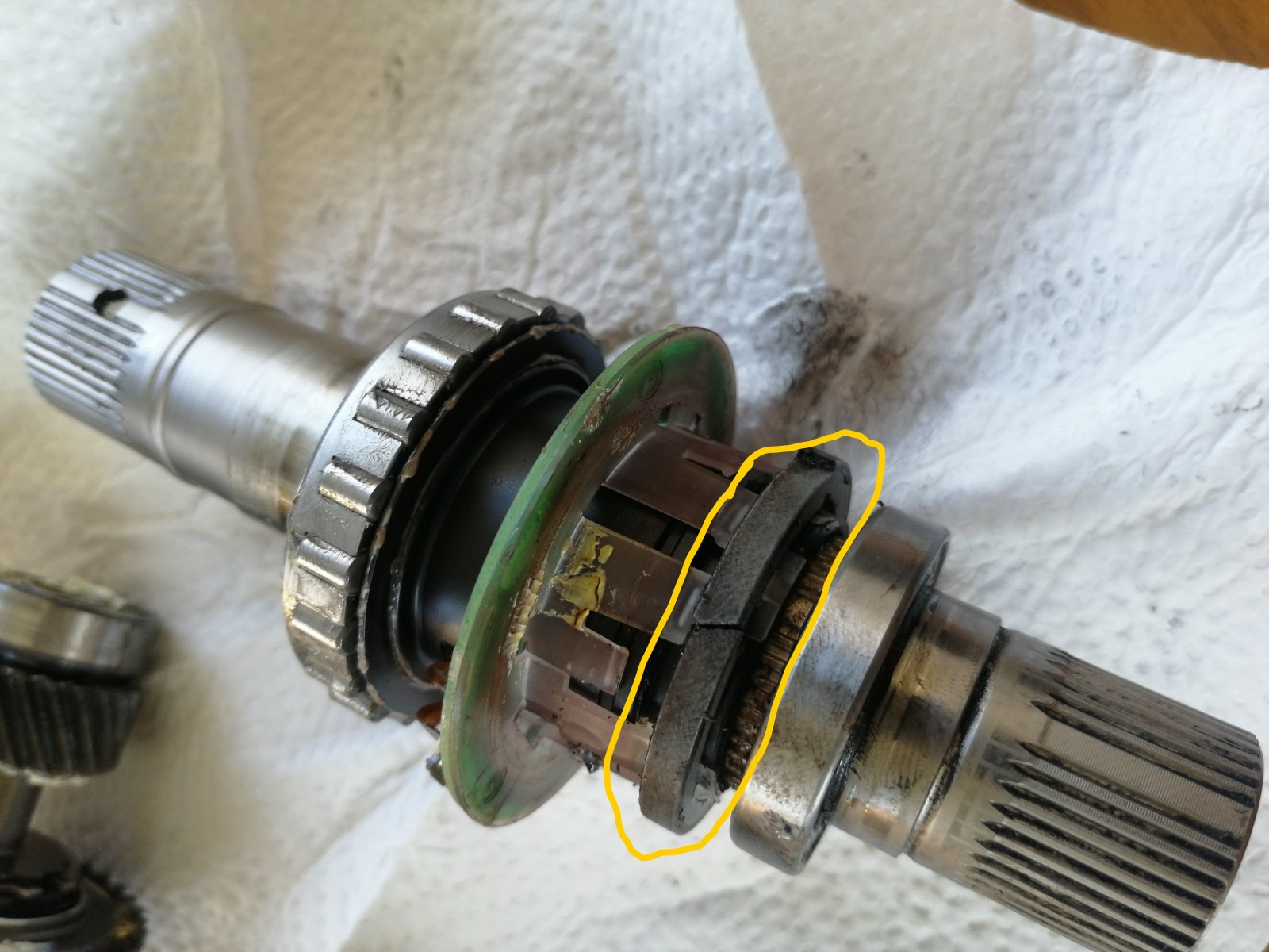

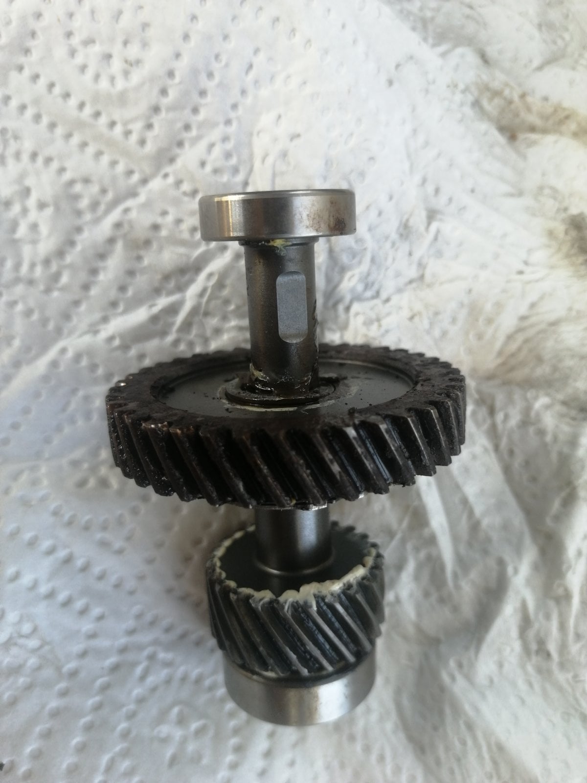

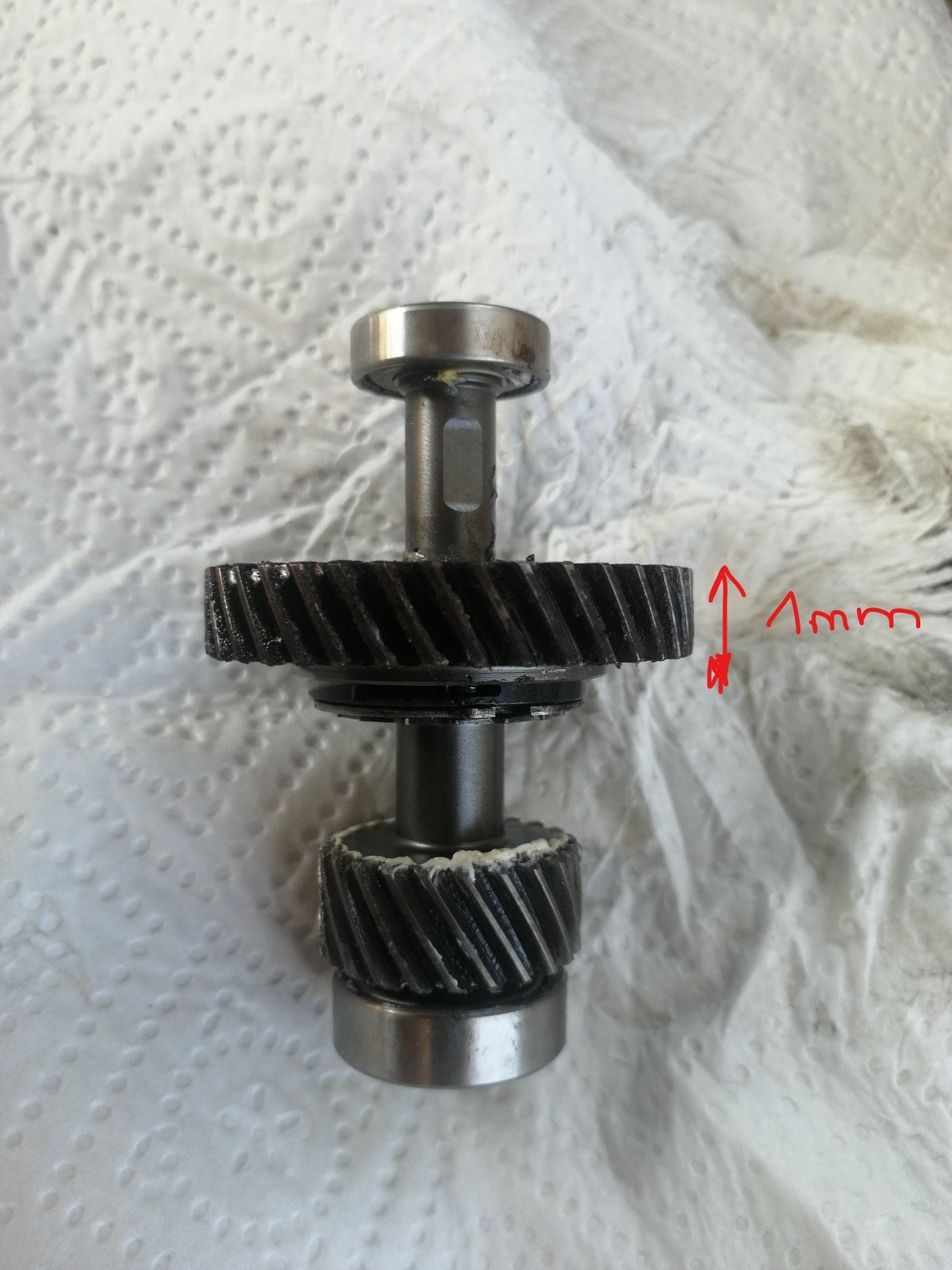

Hey guys,
I tried to dismount the e8000 and broke the magnet (yellow marked in the picture). In one describtion it's called magnet for cadence and position sensor. Is this sensor available somewhere? Is it still useful to change the bearings or is the engine fucked?
Also the gear (red marked) on the other photo, moves around 1 mm and is really instable. Is this normal?
Thanks for your help of the guys, who have done this before.
Cheers,
StefanView attachment 95721View attachment 95722View attachment 95723View attachment 95724
I also broke the magnet. I used heat-shrink sleeve with resin to secure the two broken parts in place, and the motor is working just fine! Unfortunately, I don’t have any photos

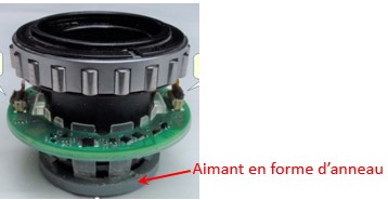

J'ai cassé l'aimant en cinq morceaux (avec l'extracteur de roulement) et j'ai cru que c'était fichu. Un peu de superglue et de résine époxy ont permis de le réparer. Le comportement des capteurs reste inchangé. L'anneau magnétique est composé de quatre segments : deux sont magnétiques et deux ne le sont pas. Il ne fait pas partie du capteur de couple, il sert uniquement à mesurer la vitesse de rotation de l'essieu.
J'ai également cassé l'aimant annulaire en quatre morceaux, mais dans mon cas, cela s'est produit lors de l'utilisation de l'extracteur de roulement.
Sur ma version de moteur, le capteur de couple était collé en place, de sorte que le roulement était très proche de l'aimant.
Au début, je pensais que le moteur était irréparable, mais ensuite j'ai trouvé votre message et j'ai suivi vos conseils.
J'ai recollé l'aimant avec une colle époxy bi-composante, mais comme je n'ai trouvé aucune marque d'orientation dessus, je l'ai réinstallé au hasard.
Après avoir tout remonté, j'ai obtenu une erreur E010 au démarrage, qui a disparu après le redémarrage.
Depuis, le vélo semble bien fonctionner, hormis un léger à-coup au démarrage.

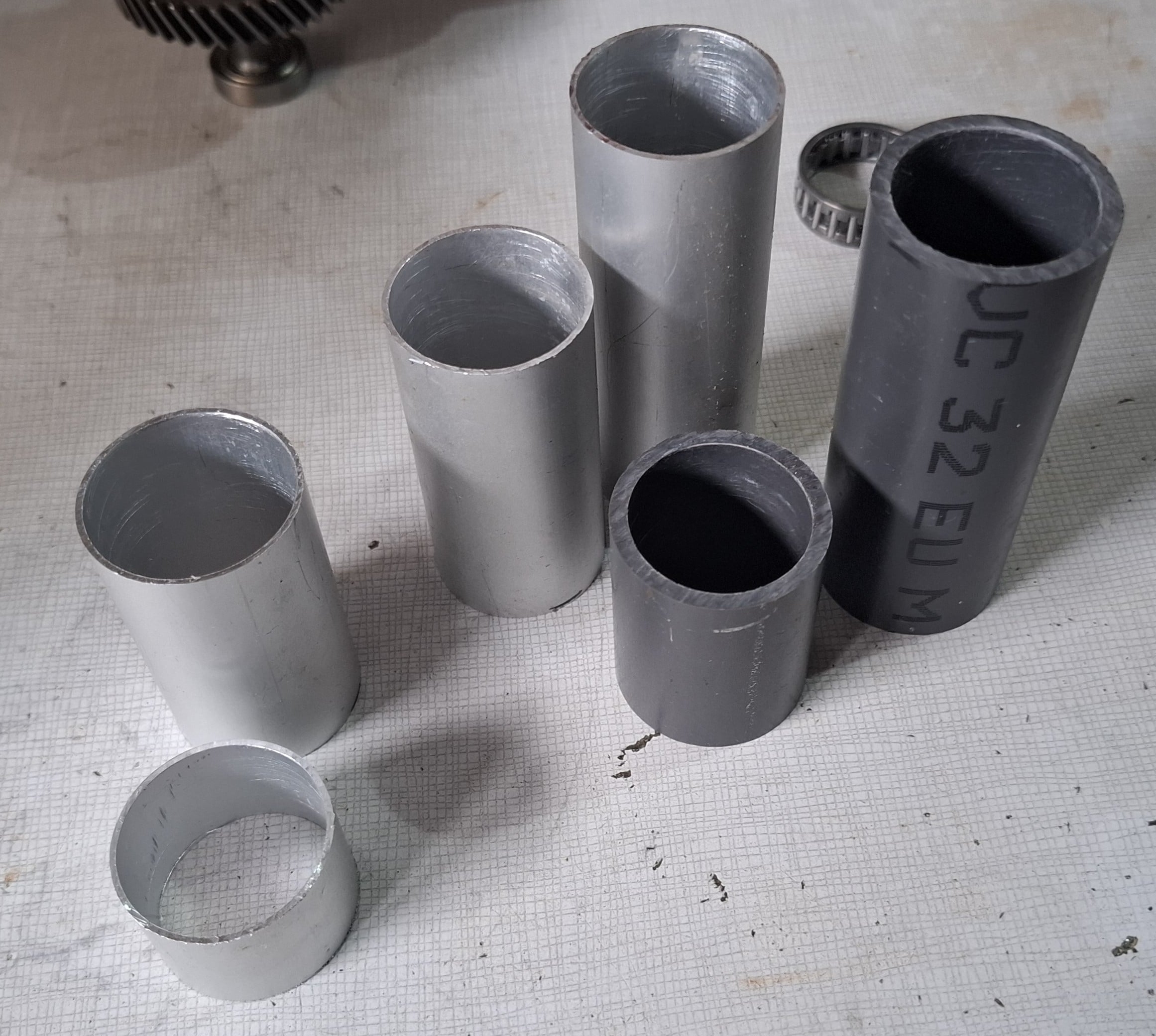

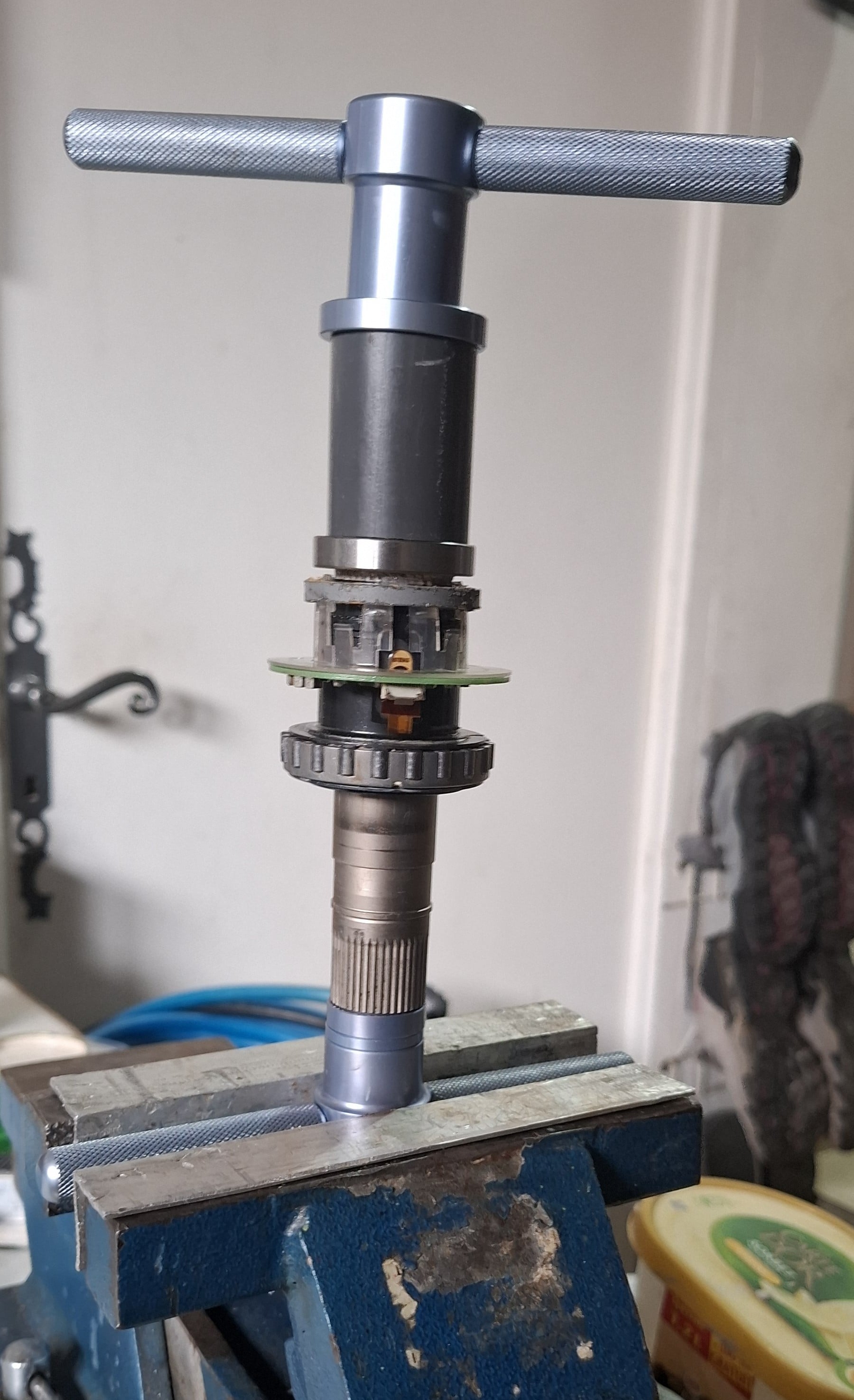

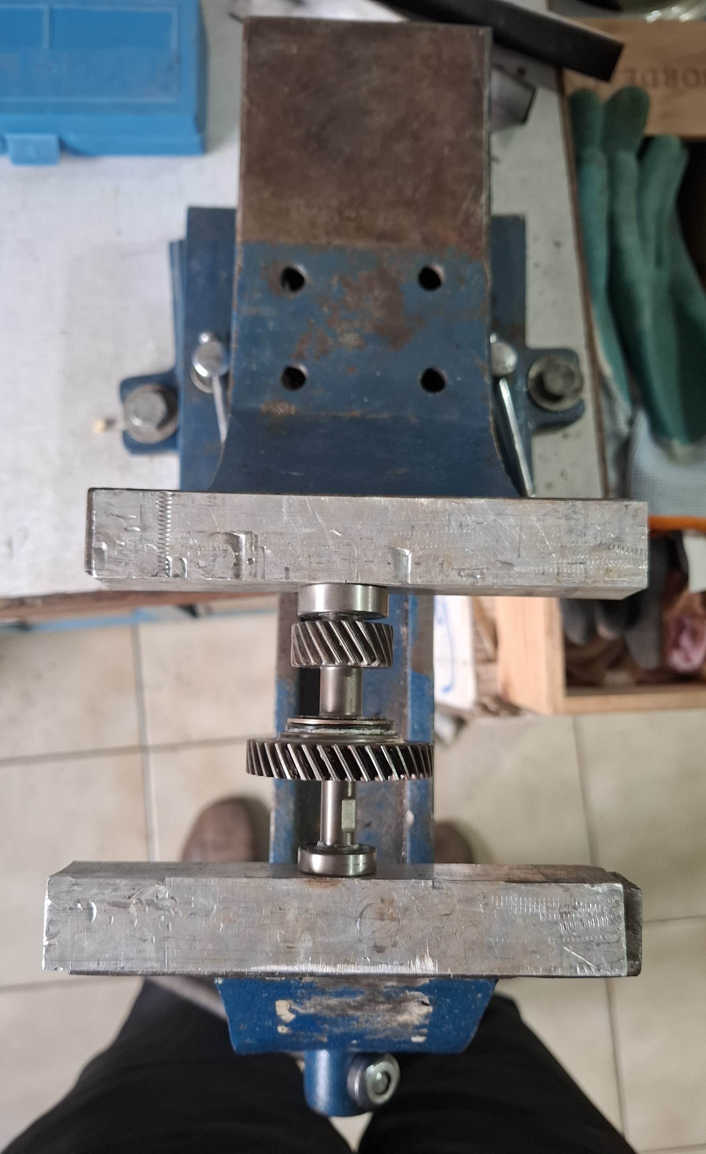

Certains membres ont demandé comment remonter les roulements sans presse. Voici ma méthode : j’utilise simplement un étau. Et pour les pièces comme le vilebrequin, plus long et creux, j’utilise une tige filetée avec des tubes de diamètres et de longueurs différents.

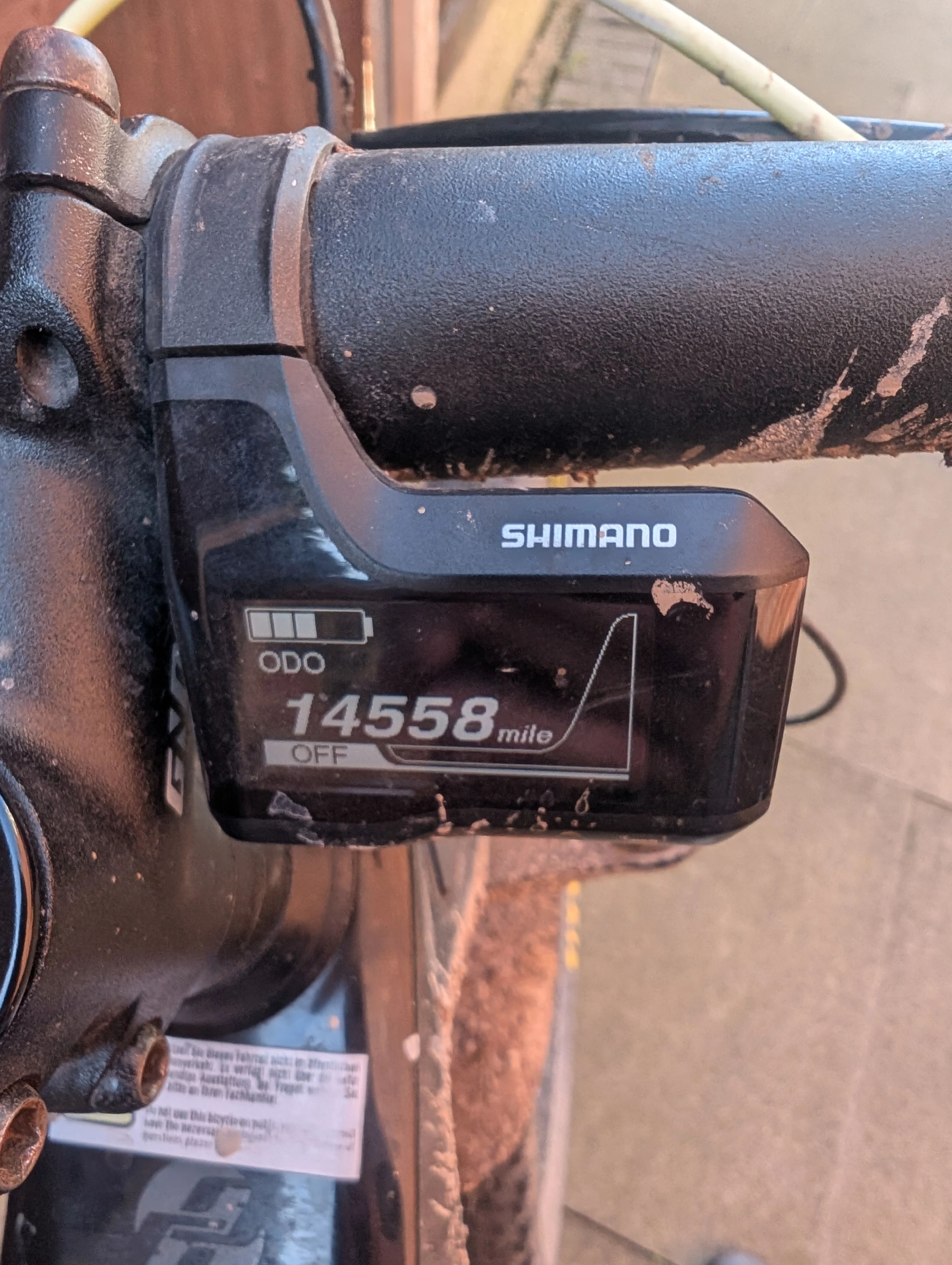

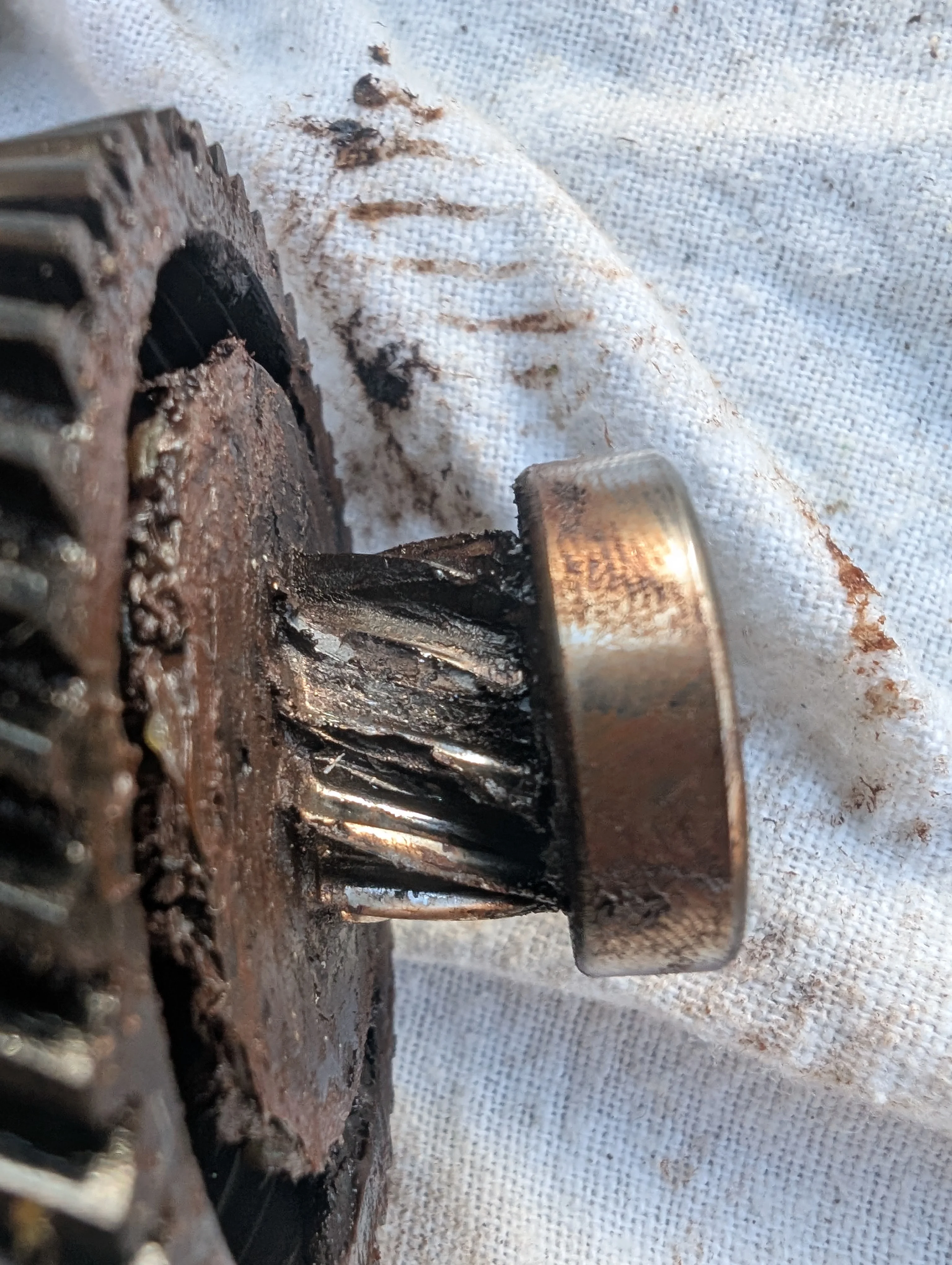

Well my (2nd) E8000 may finally be done having repaired it twice before with the main bearing been replaced first and then one of the crank bearing failing and replaced...
But now it seems it's not a bearing failure but the teeth on whatever the below cog is have worn so much they have failed. @ ~26,000 miles (14,558 indicated due to running minimum wheel size in st unlocker).
Road it back with assist off when I felt the assist starting to judder so only a few teeth have come off but the rest of them are worn out anyways...tis toast.

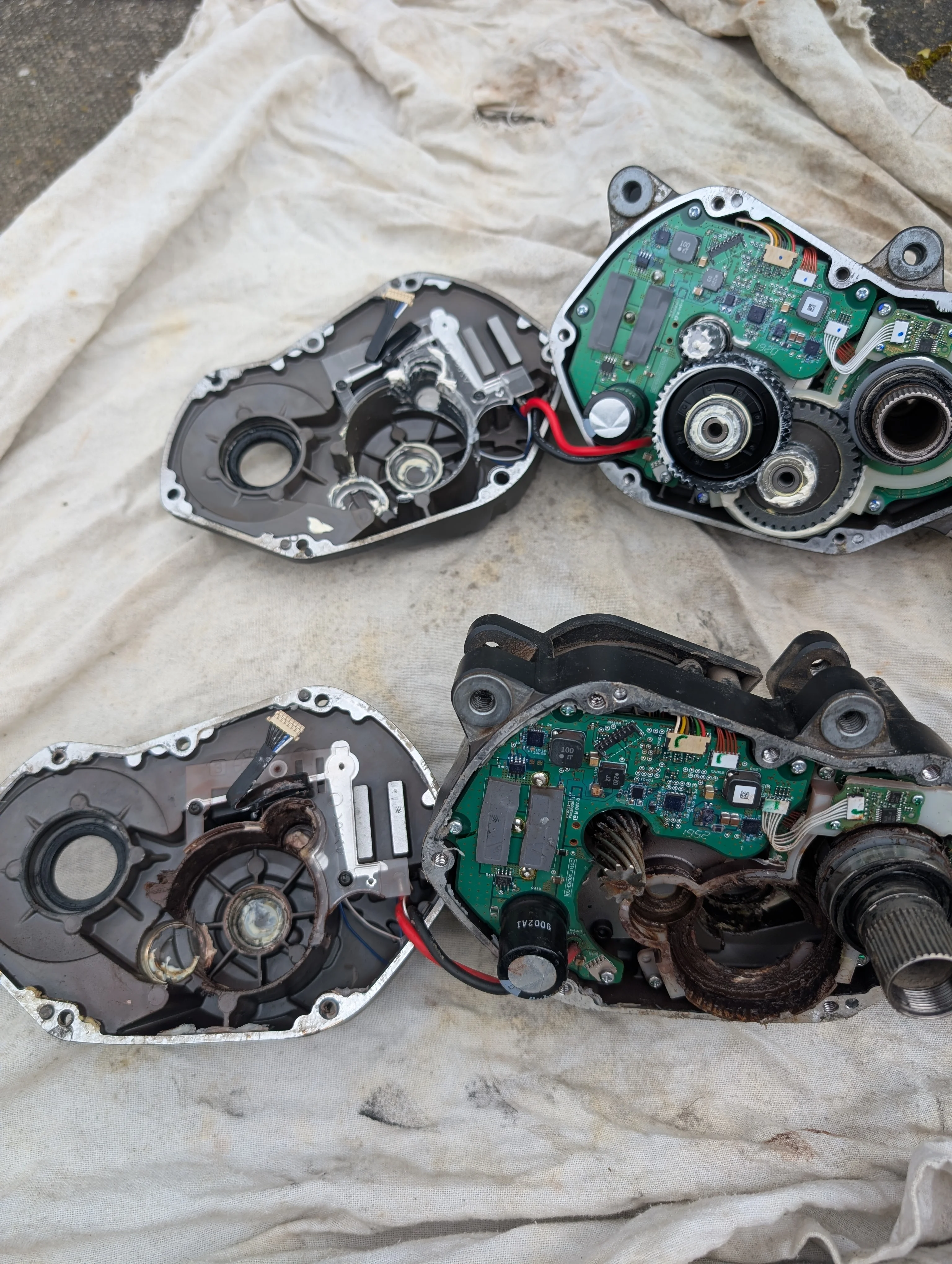

Looks like my 26,000 miles E8000 will live on. Used/Dead/parts E8000s are pretty rare in the UK EP8s everywhere...guess maybe the ebike repair shops hoard then. I tried a few local bike shops thinking they'd have some dead ones sat on shelves but they all basically said they have absolutely nothing to do with Shimano motors or ebikes in general. I think given availability of new and used EP8s at much cheaper prices than E8000s converting to an EP8 is probably the better bet over a new E8000.
But anyways a week looking on ebay and facebook a used E8000 turned up....apparently working. The logical thing was probably to just use the used one but keeping my mileage rolling seemed more amusing + don't have to get another emax license.
The ebay used one looked a bit ropey externally however internally happened to be mint condition (looked brand new) so do wonder if it actually worked or not (I couldn't be bothered plugging it in to find out).
Spent ages cleaning all the crap out of my E8000 swapped in the two intermediate/shafts gears (and a shim that had worn out/spit)...remembered what an absolute %%%% to get them to go in.....resorted to a hammer as previously :).
Chucked it all back together....it works.....only rode a few meters as it's raining. But looks good. + Now depending on whatever fails next there's the possibility I'll already have spares to fix or swap bits back into the other unit assuming it works.
Prior to cleaning it all out and the swap....the donor and the 26k miles.
