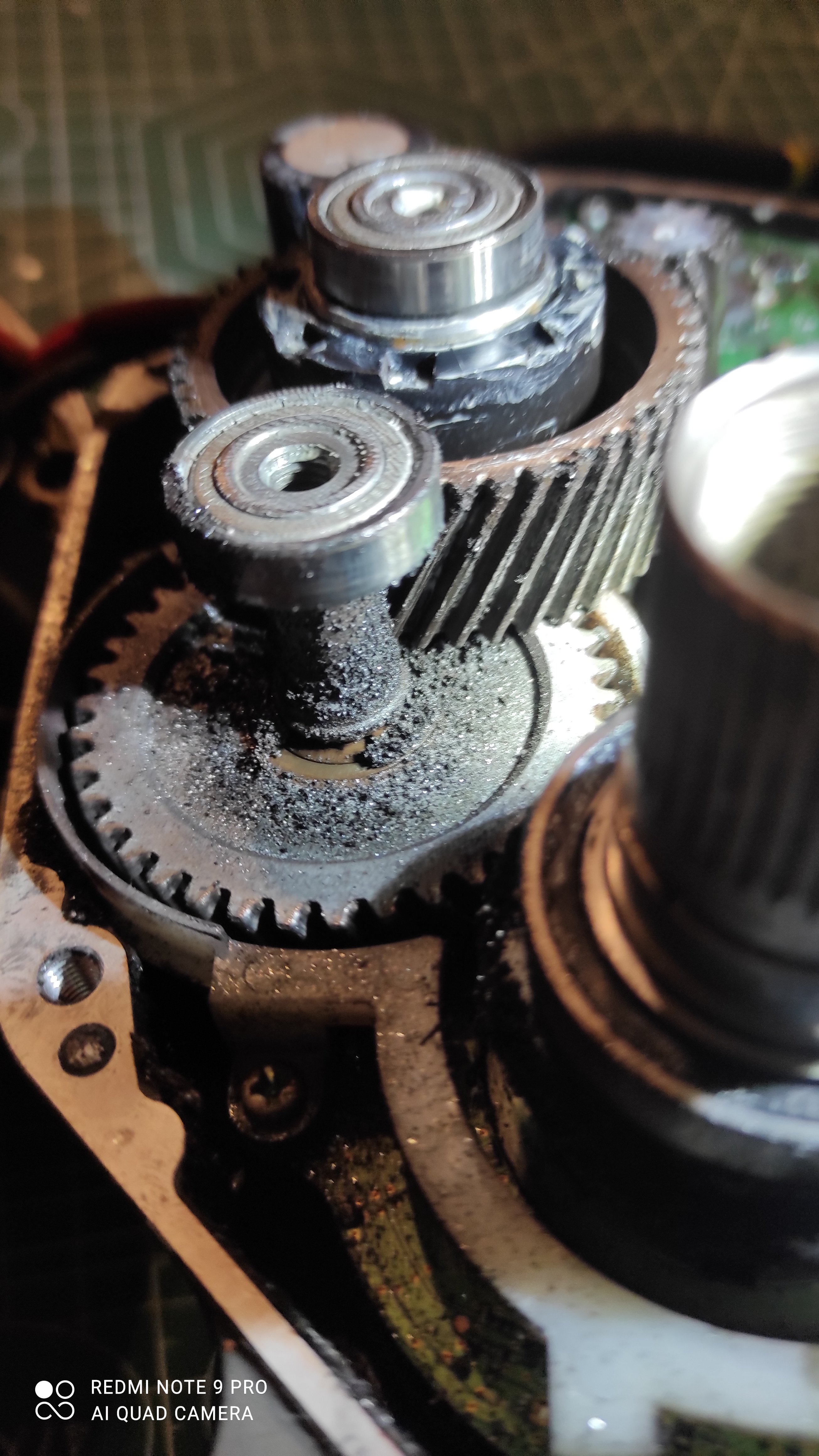

Mine has 9800km on it, from 2018. Suddenly came quite draggy and ofc heats up a lot. Drag is more on boost and less on eco. Also, engine freewheel started to stick simultaneously, and is basically not working at boost(cranks keep spinning), eco is still rideable. This appeared quite suddenly half way down a trail.

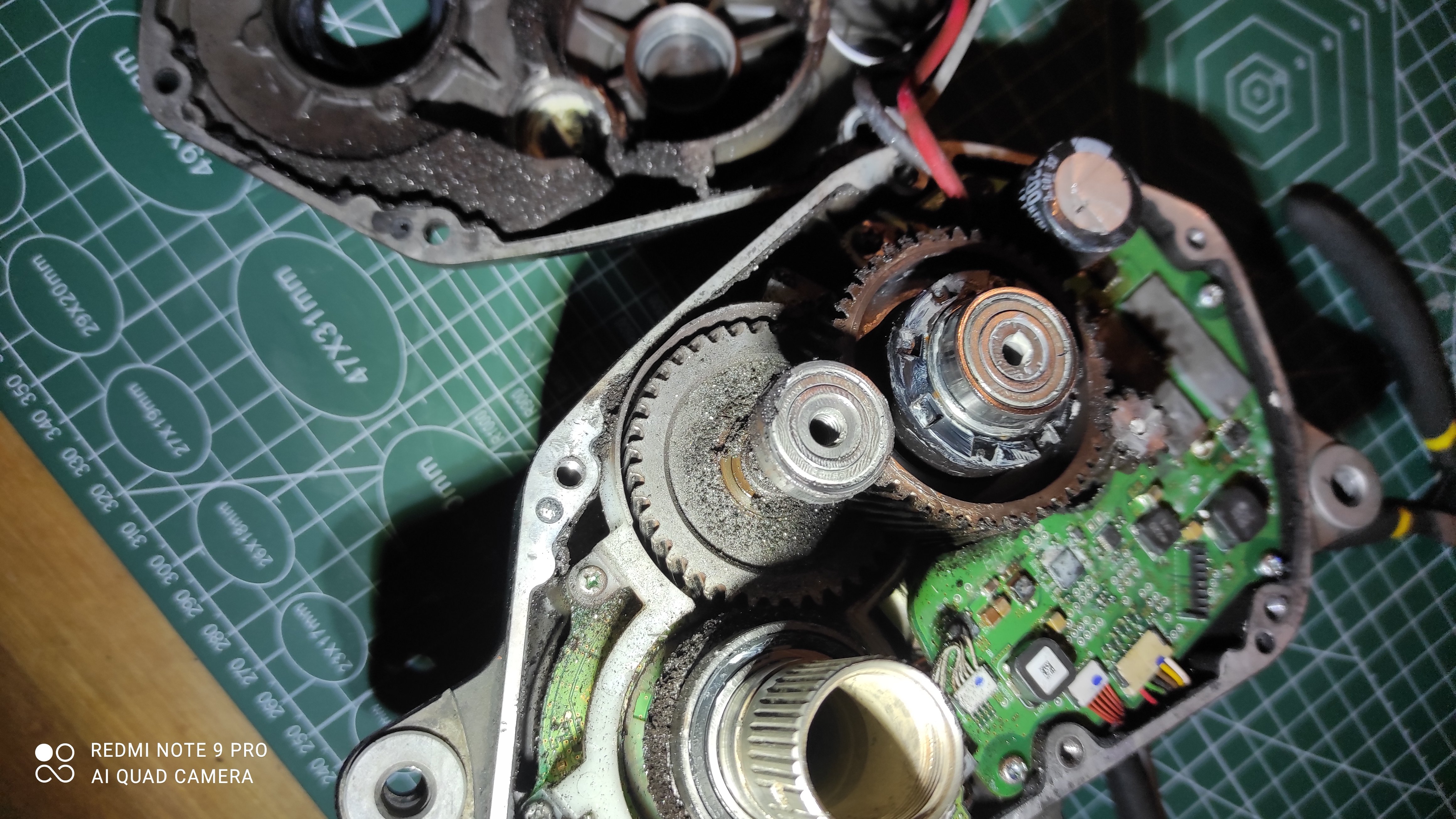

I’ve got my 700km e8000 motor opened and it looks pretty new inside- the grease is white, no signs of water ingress inside. I’d like to add some grease as I feel like there could be a bit more in there but here is some problem in choosing which one to get as some of them are hard to source and also there is lots different of options in this thread which confuses me…
The question is simple:
If this were your personal motor which one you’d add in there (i don’t really want to remove the original grease)?
1. PG-75 - i know that’s not the one of your choice which is kinda good because this one is hard to source and rather pricey…
2. EM-50L - easier to source, not that pricey as above.
3. EM-30L - the one i can get without any hassle, is this any good for my application or I should lean towards EM-50L more?
4. Any other contender?
As for Roller bearings/clutch: Shell Gadus S2 V100 2 , will it be good enough or shall I not bother?
I’d like to order this and close my motor asap and put my bike back together. I will appreciate your input. Many thanks in advance!

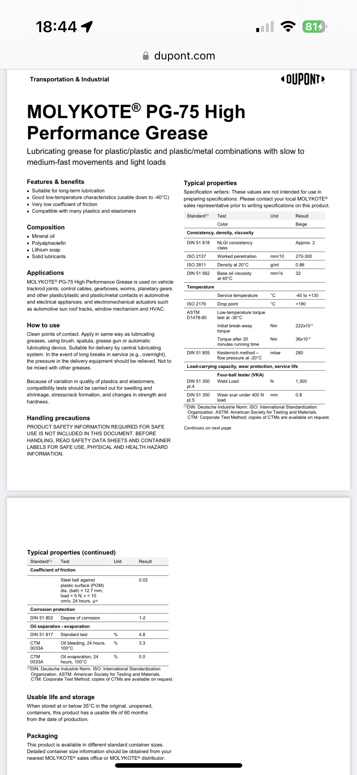

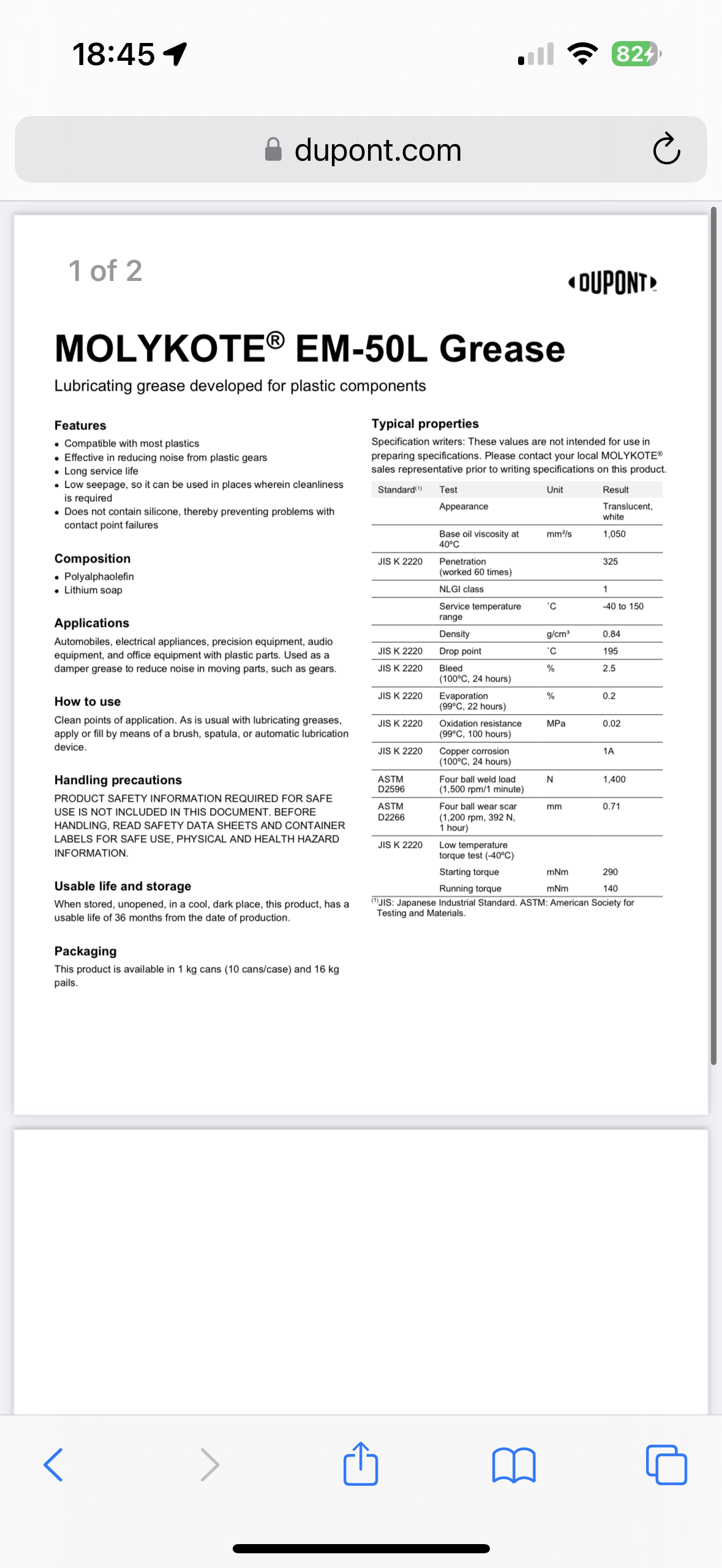

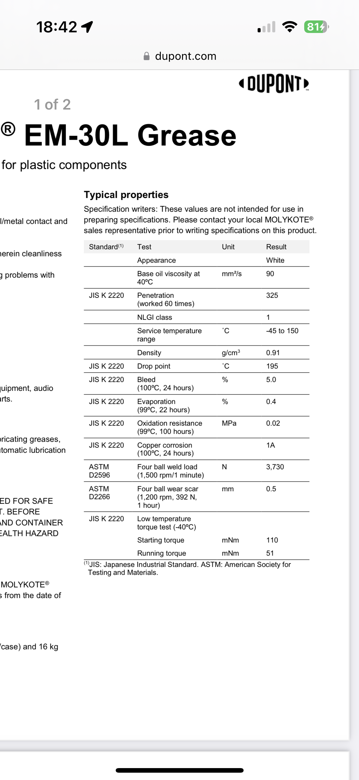

That OKS 270 looks good on paper but it’s even harder to get and even more expensive then Molykote! Seems way better then the glorified pg75. I’m no expert on lubricants but read a lot in the past few days. PG75 is for slow/medium fast movements and LIGHT! loads and it’s NOT fully synthetic…Compared to other contenders it’s got pretty low weld load at 1300N (higher =better) and quite high wear scar at 0.8mm (lower=better)… I found something that looks better on a paper also from molykote and it’s EM-30L: higher temp rage, weld load=3730N and scar= 0.5mm, it’s suitable for plastics, metals, rubber and it’s white! I think this is what I’m going to use on mine
“…MOLYKOTE® EM-30L grease is a premium quality lubricant that meets a range of requirements for the lubrication of plastic-plastic, plastic-metal and rubber-metal interfaces. MOLYKOTE® EM-30L is well suited for low to medium speed motion and medium to heavy duty applications…”
There is one Polish guy who made almost a scientific research on various greases for ebike power train that are easily accessible on our market
(use google translatator if you’re interested- i don’t have to because this is my native language:)
Basically he claims that every fully synthetic grease or the one that contains PTFG is suitable for plastics even if it’s not mentioned in the specs. This is his list of candidates for polyamide gears in our motors:
1. Mobilith SHC 1000 special - gray/black, highest weld load at 6030N.
2. Mobil SHC Polyrex 462 - white, 4000N Weld load, good water isolation.
3. Mobilith SHC 100 - red.
4. Molycote G 4500/1,
Anyways, use your common sense and do your own lesson as I’m not recommending anything here. I’m just adding to the debate whether pg75 is the really the best choice for this application…

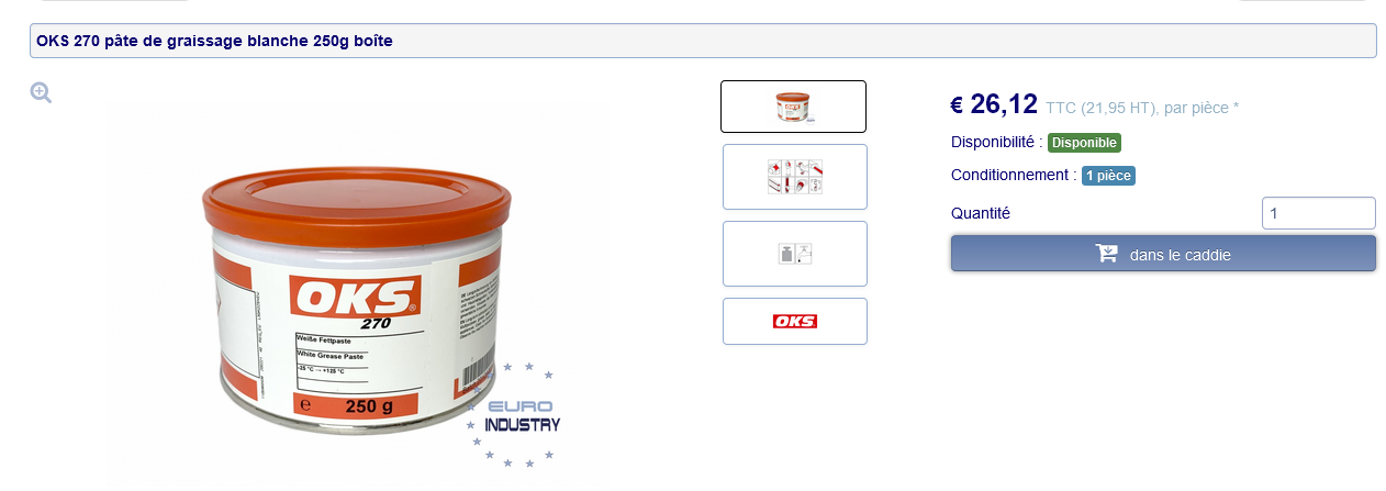

Not expensive for our purpose: 26,- € >>> 250 grammes
And you can also use this OKS 270 grease when you overhaul the bike's fork.
I'm sure you have dealers for the industry in your neighbourhood.

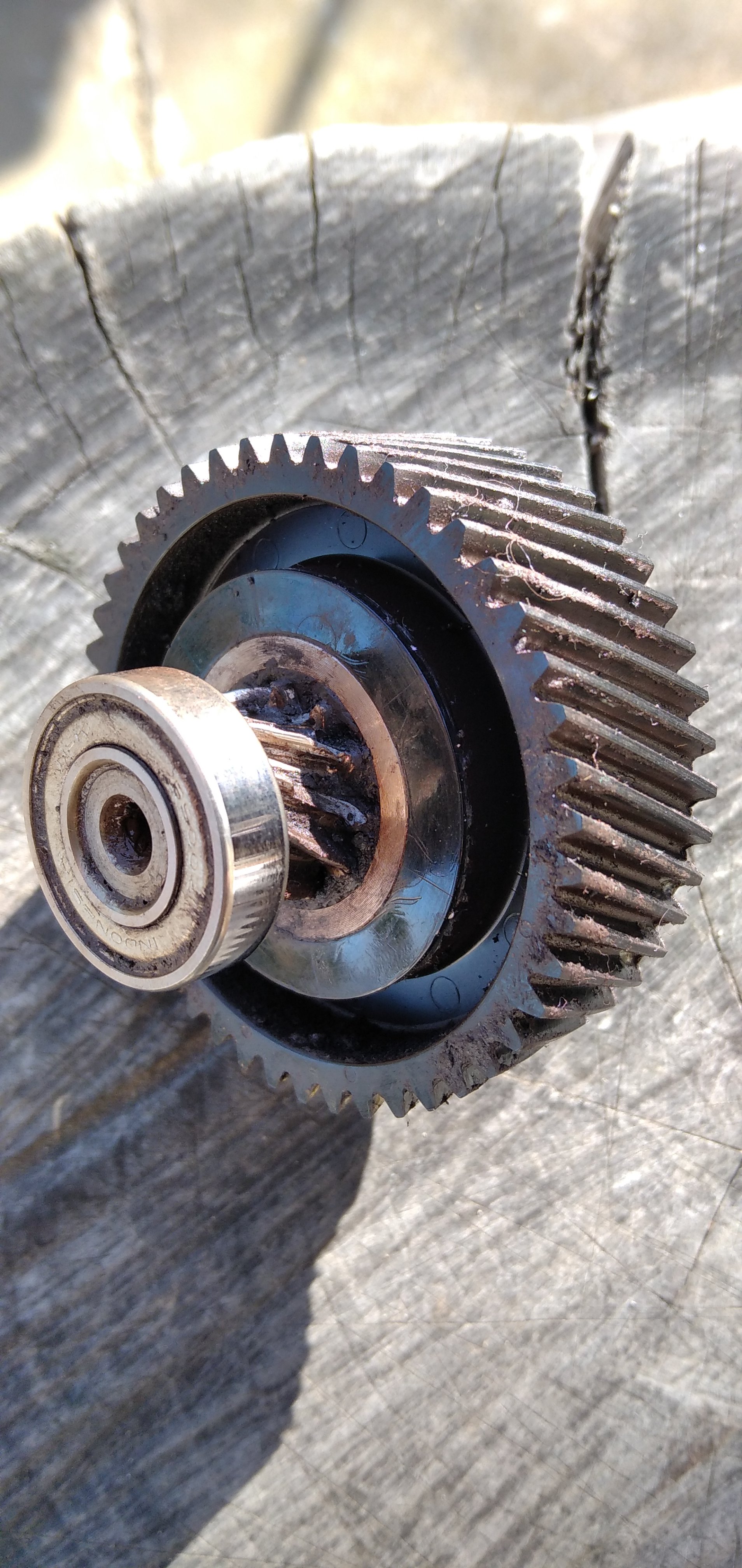

@Spiff @S13 - different height of big metal sprockets therory.
There was a discussion regarding grinding noise, burned grease and some theory that one design is better over the other.
I’ve opened 2 motors:
1. Early one 2017 - 3 clutches, big metal sprocket has height around 8.4mm
2. Later model - 2 clutches, metal sprocket is around 9.4mm so 1mm thicker.
My theory:
Technically higher (9.4mm) gear seen on later models should be better as the area of contact is larger therefore smaller forces are being passed onto the teeth, less friction but on the other hand it reduces the clearance between the top of the plastic gear.
2. Maybe grinding and grease burning has nothing to do with clearance or gear size? Maybe it’s the way motor is being used? Please note that bearing that holds the shaft with metal/plastic cog assy is mounted right on the motor’s housing so it takes all the heat it generates and passing it onto the small metal cog which suffers the most. Maybe earlier design (3rd clutch system) was better as since there was “more metal” inside the cog which helped in pulling away all that heat from the smaller metal sprocket underneath? Later on they’ve removed the 3rd clutch so now everything goes into the gear itself causing grease degradation? Maybe gear size has nothing to do in this case?
I have swapped big metal gear assembly from the older motor and put into then new one (2clutches) - it was riding nicely and quietly.
I’m just wondering if putting the thicker gear to 3 clutch design motor OR thinner into 2 clutch design can be a bad idea?
Well we can only guess what motivated Shimano to change the design. However the grinding and misalignment problem of those gears is seen with both the early model and the later model.
I personally think they shouldn't have used helical cut gears, because of the axial force involved that pushes the motor clutch mechanism out of alignment. And when that happens, you get more friction, grease displacement, grease failure etc... And yes the heat of the motor nearby doesnt help either.
Maybe they should have used a double cut helical gear (or herringbone) or at least stabilized the clutch mechanism with an additional needle bearing to handle the axial forces.
Which of the 2 designs is better? I dont know. My later 2019 model started to fail after ~5000km. And ive now swapped the gear set to the older design type (with the 3rd clutch inside). Its holding up for now, but im not actively using the E8000 any more.
Thankfully i now have a dyname 4.0 motor that has none of these problems (all gears and clutches can be cleaned, greased and replaced from the outside).
If you can at least regrease the E8000 gears every 2500km or so, it should be able to last quite a bit longer.

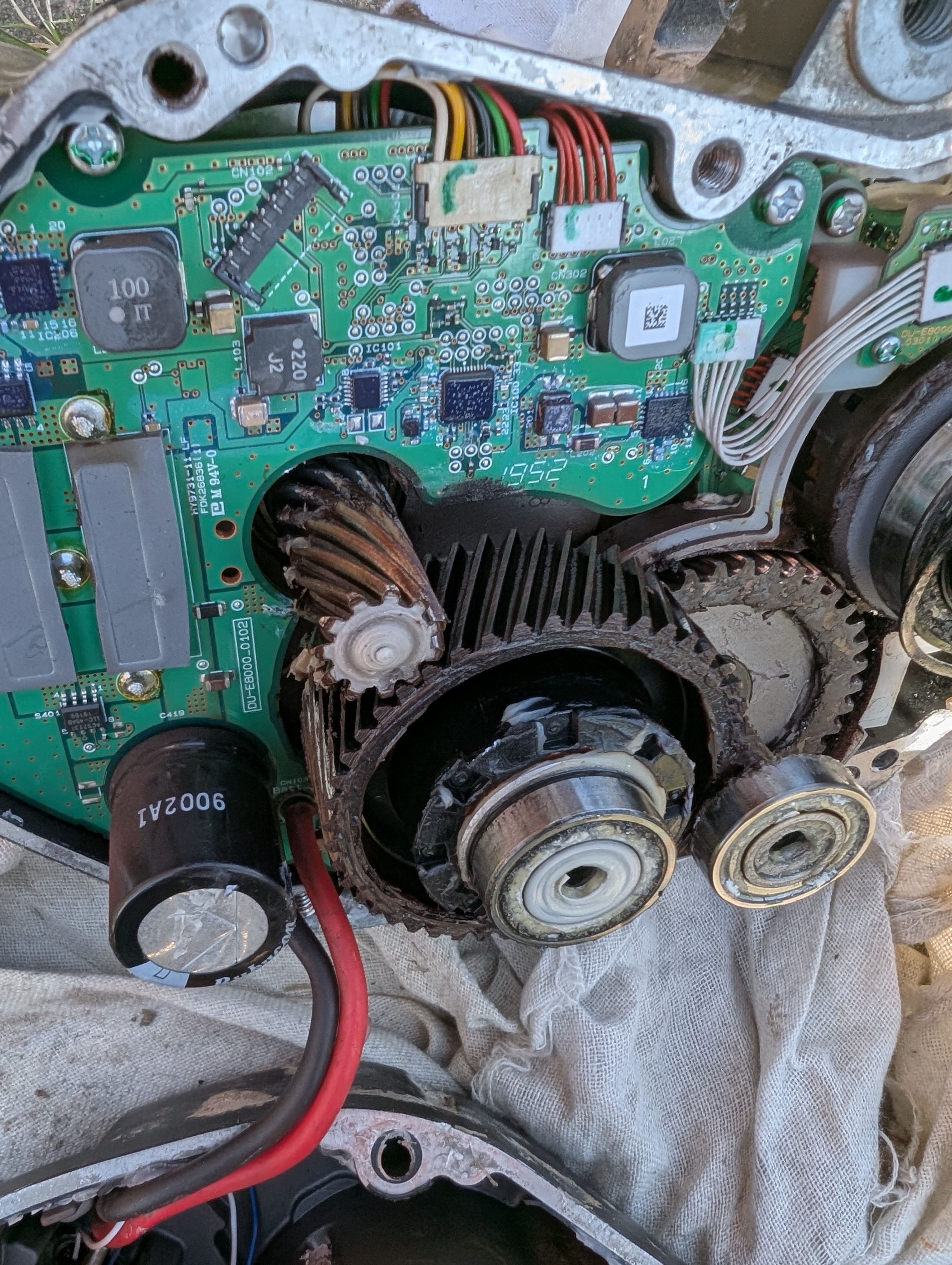

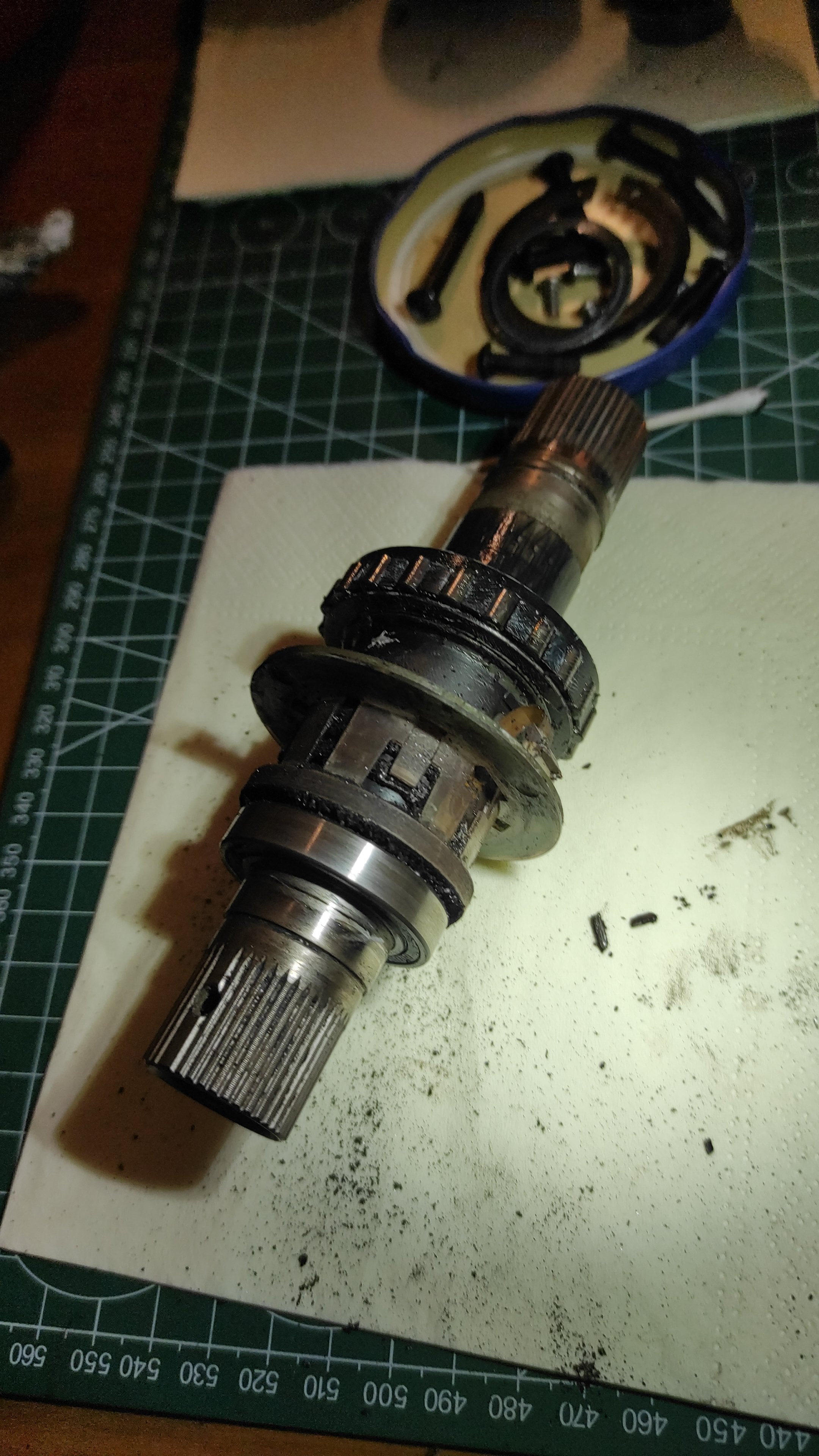

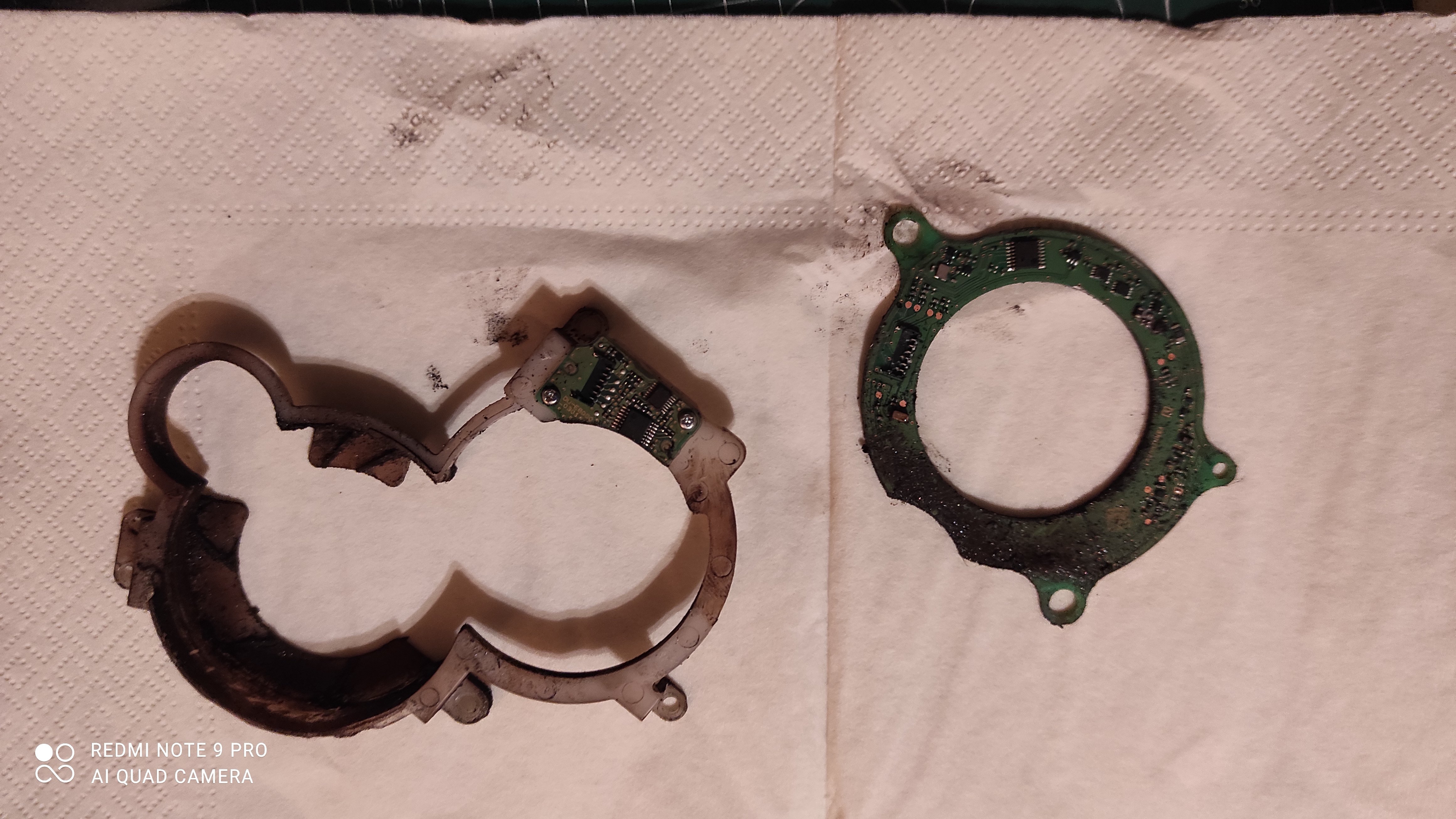

My friend's e8000 broke down and as it was out of warranty he took it over to me, to see what could be done. I have previous Bafang motor servicing experience, and I have agreed to check.
When I opened the motor it was trashed inside and full of grime. The previous mechanic who replaced bearings didn't use any silicone and the motor was in horrible state.
I have managed to take it apart completely and found that the first clutch bearing connecting to rotor failed. I have found a replacement for it and it's on its way.
Now here's the issue though. I was trying to take out the crank shaft out and didn't succeed. So I had to unplug both cadence and torque sensor stationary boards. I then mashed to take out the shaft with the torque sensor assembly.
Not being fully familiar with Shimano I have assumed that there might be a bearing inside and decided to take out the shaft which was pretty stuck. Inthe end I did maybe to press it out. But that has resulted in the plastic portion of the sensor flying off and both ribbons got loose. Luckily both remained intact. I have then assembled it back, but lost track of orientation and I am not sure if they are plugged in the right sockets.
My questions are the following:
1. How do I determine the correct orientation of the plastic bit in relation to the metal sleeve?
2. Is there a hack how to calibrate torque sensor by adjusting magnet position?
3. Will flashing new firmware recalibrate the torque sensor.
Currently I don't have the bike here and new gear is on its way, so can't really test. But the more I am reading about it, the more worried I am becoming
IMG-3cad0aa3611736d5a3ee527e814c1880-V.jpg IMG_20240310_205944.jpg IMG_20240310_210342.jpg IMG_20240310_212318.jpg IMG-ba7550bcde783b51db4905271a4ebf5a-V.jpg
View attachment 136153 View attachment 136154 View attachment 136155 View attachment 136156 View attachment 136157
Hi. Basically if you moved any of the parts on main shaft (magnet, PCB that is rotating together with the shaft or the whole plastic assembly on which the round board together with the magnet is sitting) you are buried.
Sorry to say, but the only place that can calibrate your torque sensor is Shimano assembly line, and they do not accept any motors for repair.
Therefore if after assembly your motor will pop Error 010, just simply give up. You will waste your time trying to position the PCB's/magnet together and chance to success are leaning towards zero.
Sorry to give you that info, but Shimano is way overcomplicated/ unserviceable compared to any other brand like Brose, Yamaha, Bosch etc...
Its totally different level of 'being careful' while working on Shimano compared to any other motor...
@TeoElFeo may I ask what mileage is the motor and at what stage service was done to that motor?

Hello all. I'm new here. I've read a lot of the posts and thank you for all the contributions so far.
I've got a e7000 and id like to service it for preventative maintenance. I have pg75 and motorex 2000 to hand. I know pg75 is preferred for the gearsets but the motorex is actually a higher load and it's stickier than the pg75. Has anyone used it for the gears or should I just stick to pg75?
I'll clean off all the old grease first so this is really just a question of which of pg75 and the 2000 is better for the gears under load.
Thanks !!
It's a little over a year and 8000 or so more miles since my motor started sounding rough and I subsequently rebuilt it (new bearings and grease). Coming back after a 50 odd mile ride earlier this week it occurred to me it still sounds as sweet as a nut. There was some debate around grease at the time, I used PG-75 (from bearing man) and can only assume it's doing an excellent job.
Damn been a minute, many thousand problem free miles (bikes showing 12.5k miles but the wheel circumference has been set to min size since drive units day1 so would think it's into the 20k miles) later since the rebuild in October 2022 the 6808DD crank bearing started to collapse whilst out on it yesterday. Nursed it home took it apart today banged in a new bearing and it's good again. First time looking inside since the last rebuild and the PG-75 had kinda 'gone' i.e. little visible white stuff however seems it was still doing a good job, cogs seemed 'oily' and it hadn't burnt like the factory stuff had and all the cogs still seem in good condition.
One dead bearing:
How the grease cogs held up since last rebuild
22375 miles bravo Marc
