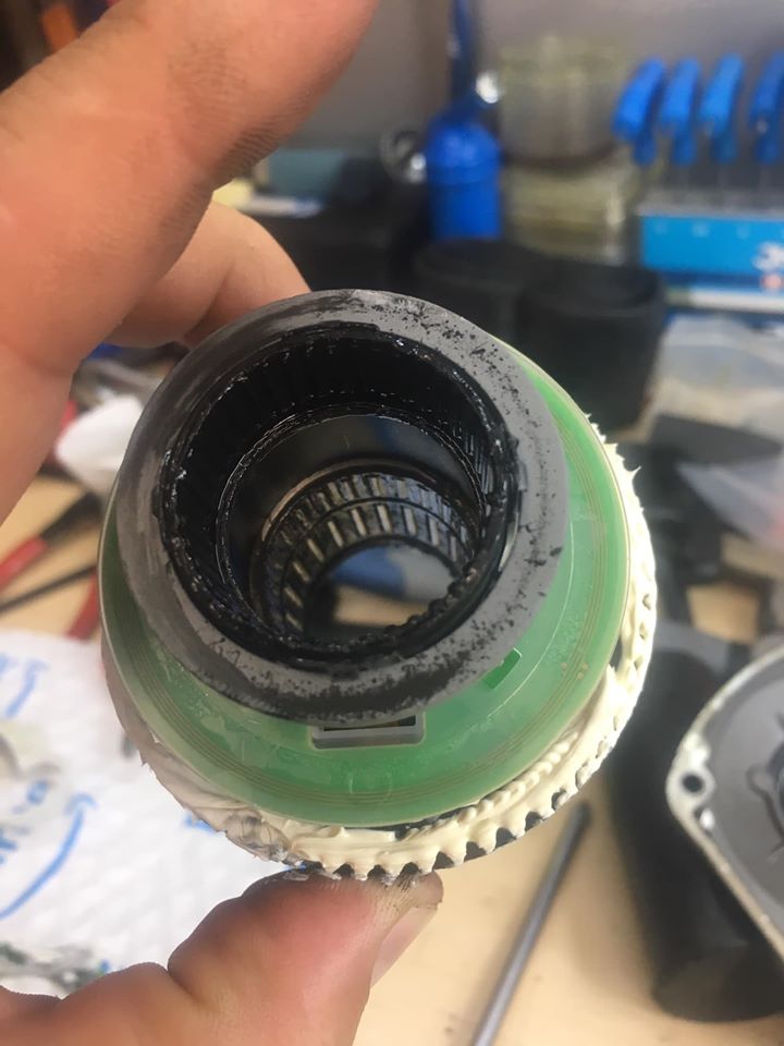

Inside my main shaft with the needle roller bearings, and the picture on Spiffs's post it looks like Moly Grease, anybody any thoughts on that.
Moly grease isnt preferred for roller bearings.
I suspect it looks a bit dark because over time tiny amounts of metal particles gets in the grease from normal bearing and race wear. I see it happen with the ball bearing grease that i use for the roller bearing as well. It starts as a light yellow beige color and after 1000km+ it is all dark colored.
OK S13, that was my original thought because there was a slight sign of water ingress on the rollers but the whole section is uni-formally coated in the black grease.
