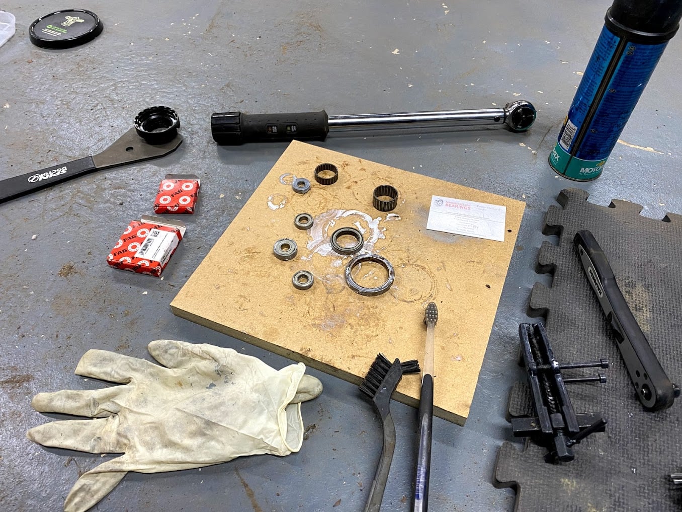

Well after 4,000 miles of pretty unsympathetic use and abuse my Shimano motor had started to grind and groan. There was definitely feelable grind or play through the cranskshaft when spinning at higher cadence and the motor just seemed to be quite "whiny" although it hadn't just appeared, it had been a very gradual and impercetible increase in noise over time.
Inspired by this thread, I embarked upon sourcing the spares needed for an overhaul. Given that I didn't really want to be taking the casing apart more times than necessary, plus the cost of the bearings were low, I decided a belt and braces approach - source all the bearings and replace them all while I was in there.
I have to say great work on the original write up by @SmokeyBear, I'm not sure I'd have been as confident to proceed without his earlier exploration and sharing.
Some of the tips such as how to open the casing were really helpful - I used some plastic car trim removal tools as well as a couple of old credit cards to insert and wedge the case apart. I did disconnect and remove the two smaller electrical boards - just for my own peace of mind to ensure they didn't get damaged while sliding the final drive assembly in and out etc.
I have to also say a huge thank you to Peter at Performance Line Bearings (forum user @Bearing Man). He was invaluable in sourcing some of the trickier needle bearings and without his help and pointers - this thorough an overhaul would not have been possible. I had not had cause to use Performance Line Bearings before and although I have no affiliation to them, I would have to say I'd recommend them whenever possible if only for the sheer commitment to customer service - getting me the needed items expressed out, when most others wouldn't have had any interest invested. So thank you Peter for everything.
I think I replaced nearly all the bearings - there was an unusual bearing inside the black plastic gear that I hadn't been prepared for - though inspection seemed to reveal no need to replace.
Another interesting find on my drive unit was the smaller of the two spring / thrust washers that sit atop the bearing shafts inside the upper casing, was snapped into two pieces. I reassembled with the larger part still in place - although I will look to source a replacement and get back in there with it.
My motor is noticeably quieter after all the replacements and this has hopefully given it an extension before anything more troubling is encountered.
@spr0cket can you please show the bearing extractors or any other specific tool that you used to remove and press the bearings.
The bearing puller I used is in the pic - the black legged device lower right of image. It wasn't great quality and struggled to get the rather industrial leg ends under a couple of the smaller bearings - meaning they had to be levered off with flat punches / screwdrivers but knowing I was replacing them, I didn't mind any leverage / scoring on the outer cages of the old bearings.
As for pressing the new ones on. The smaller ones can hammered on gently using a standard press cup for the bearing size... the larger ones had to be drifted on gently moving around the inner bearing race a couple of gentle taps as a time - pretty much as SmokeyBear outlined.
The needle bearings were the easiest, they simply slide out with finger pressure.

1 x 6808 2rs Sealed Ball bearing 40x52x7mm
1 x 6805 2rs Sealed Ball Bearing 25x37x7mm
3 x 6900 ZZ Shielded Ball Bearing 10x22x6mm
1 x 6000 ZZ Shielded Ball Bearing 10x26x8mm
2 x needle bearings (no dimensions available) supplied by Bearing Man

Updating the list:
1 x K25x29x10 Needle Roller Cage Assembly
1 x K25x29x17 Needle Roller Cage Assembly
