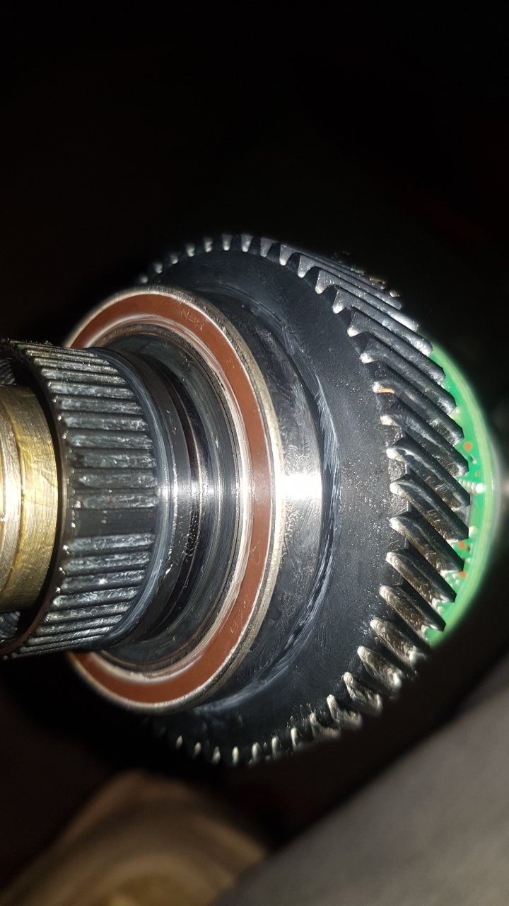

All I knew was that something had changed in the sound of the motor it was still driving fine, but the noise I could hear sounded like a bearing.

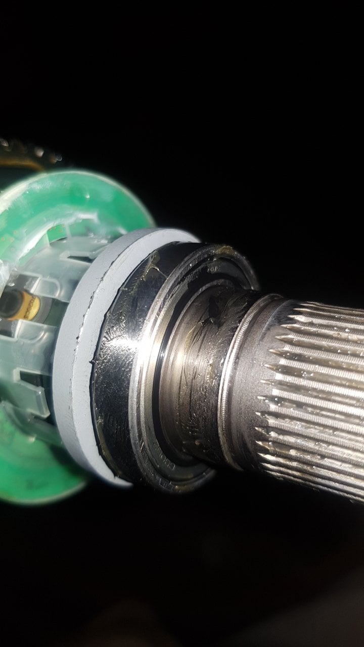

When I saw the shit that had got in past the seal, and the black greasy muck around the outside of the 6805Z bearing, it was obviously dead. There are also 3 one way clutches on the seperate gear spindles, one of those didnt sound/feel great either, I've since done about 30 miles on the bike, it definitely is alot smoother and quieter than it was before, but after seeing how the needle bearings had put a shine on the through axle ideally I should have replaced those too.
If/when I go back inside the motor I'll get some better pictures and dig deeper into the gears with one way clutches, I'm not sure if internal parts like that are even available.

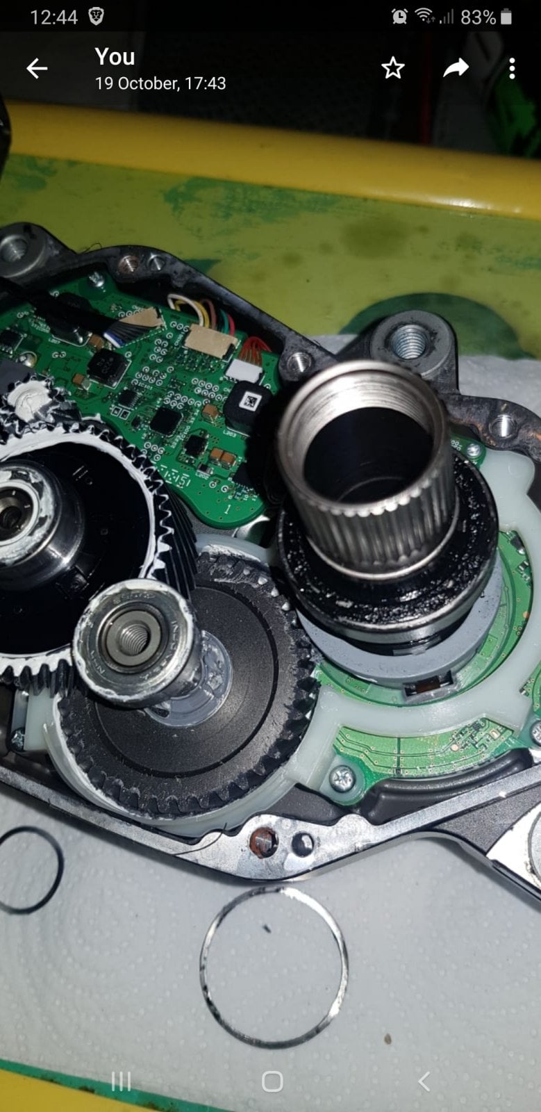

Just be aware that when you take the cover off the motor there are a couple of sprung shims that keep pressure on the gears. TAKE NOTE WHERE THEY GO!
In the first picture you can see the through axle on the right hand side, that bearing is the noisy one.
That's an NSK 6805Z, shown in the last picture too.
On the other end of the axle is the larger (brown rubber seal) bearing it's an NSK 6808D.
The other smaller bearings are 3x NSK Z0069, and 1x NSK 6000Z, but I found these to be ok.
You will see inside the speed sensor and final drive gear there are some cartridge style roller bearings in there, they just need to be cleaned and greased, one side needs a small hook tool to remove a rubber seal so you can get at the bearing.
You will need a small bearing puller, I bought a 4" one on amazon for £9.
A punch and a small hammer to seat new bearings carefully, (or a press and a sleeve), some degreaser or solvent, and some patience to clean everything before re-installation.
Hope this helps, as I couldn't find any info on repairing E8000 motors at all!
