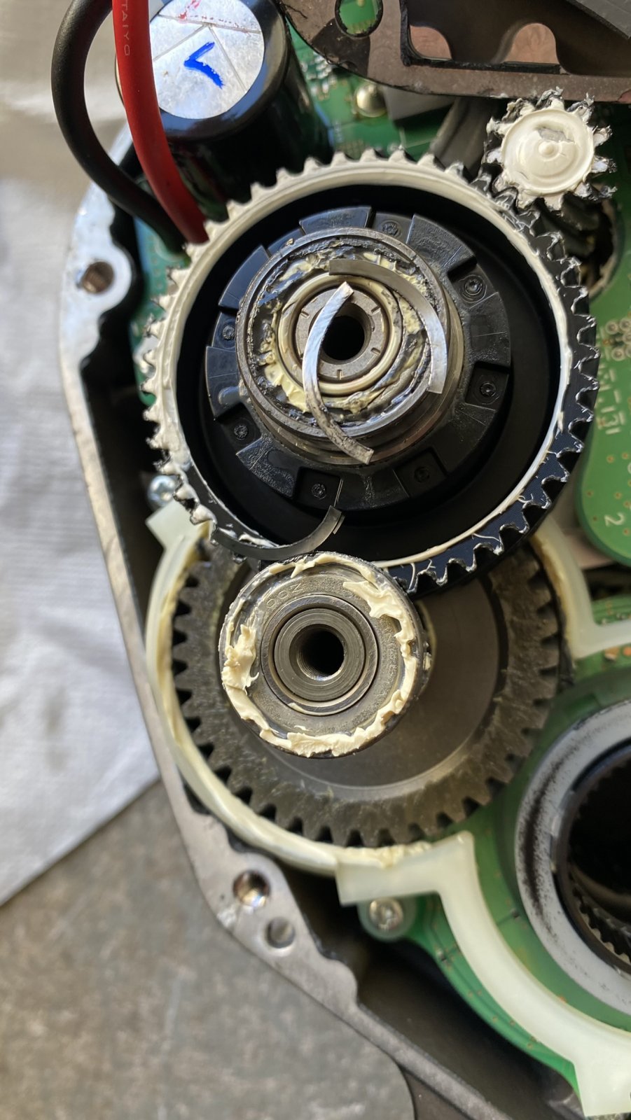

Hello colleagues, please advise. The shim in the picture is broken, where can i bye one. Its size should be approx. ca.19 x ca.22 x 0.4. The closest that I found is the 16.51 x 21.72 x 0.25-SS, will the smaller inner diameter be a problem? Maybe it will rest on the metal bearing cap.

Inside the top cover are two sprung shims, take note of where these go, take out and clean.

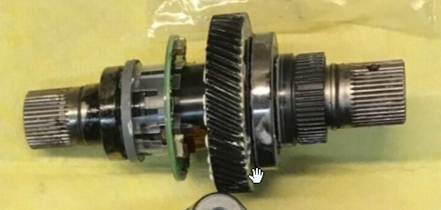

Then lift the through axle out, with dead NSK 6805Z bearing attached.
Twist and pull on the two gears (black plastic one and one beside), this will unseat the bearings in the bottom case and they will both lift away. Notice there is a sprung shim under the metal gear side, but not under the black plastic gear.

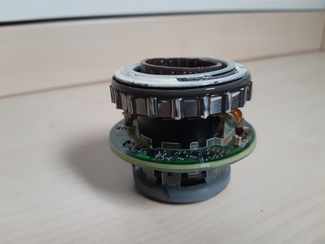

Then you will see the main drive or final drive that adds assistance when you pedal, this whole unit can be lifted out in one, and consists of speed sender on one end, a one way clutch connecting the final final drive gear, and one NSK 6808D bearing (this bearing was ok on mine). Inside there are 3x needle bearing cartridges, you can remove and clean these and regrease, (one requires a seal to be removed and refitted).

How many clutchs has the motor?
They are of the roller type and there are two of them mounted inside the large gears. They are Shimano specific and not available to buy, if they break, then there is no replacement.
One of them allows the cranks to turn backwards relative to the chainring, this clutch is inside the big black gear on the axle. Its purpose is to allow the pedals to rotate more slowly than the chainring in case the motor rotates faster than the rider's pedal strokes.
The second clutch allows the motor to turn freely backwards relative to the chainring, it is located inside the second large metal gear. Its purpose is to allow the motor to turn more slowly than the chainring in case the rider pedals faster than the motor rotations.
They are not available to change, but if necessary they can be disassembled, cleaned and greased, but be careful that you only have to use the specific grease or they will get stuck. You have to take note of how the rollers and springs are mounted and use quality thin needle-nose pliers and tweezers to mount back the rollers and springs in place.

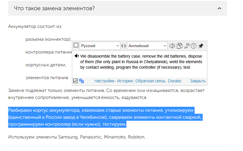

Hello everyone, there is information that shimano stops producing new batteries for old engines and now there is a problem of what to do. If you open the battery and change the cells yourself, the battery will turn into a brick and will not work. Maybe there is some information on how to bypass the blocking, maybe someone won? Share information for the people.

I accidentally found an office in my city that deals with repacking and assures that they can bypass the lock and reflash. But I won’t do it yet, since my battery is working, I’m just looking for information for the future and I wanted to share it for everyone.
