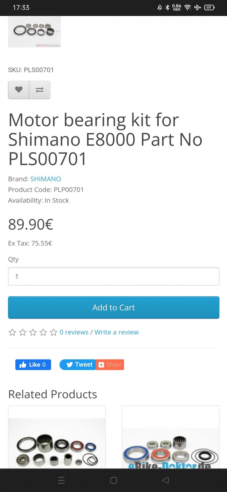

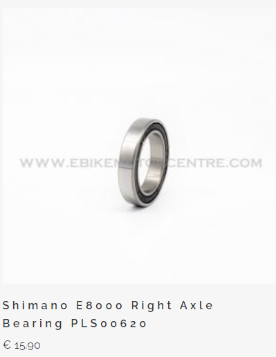

€ 50!!! I am way too cheap! Even Henryk is only charging € 15.90
It's listed as the right hand bearing but is actually the left hand one you wanted. I have asked him to change this. I have also asked why his site is not currently allowing any selection of these parts!?
