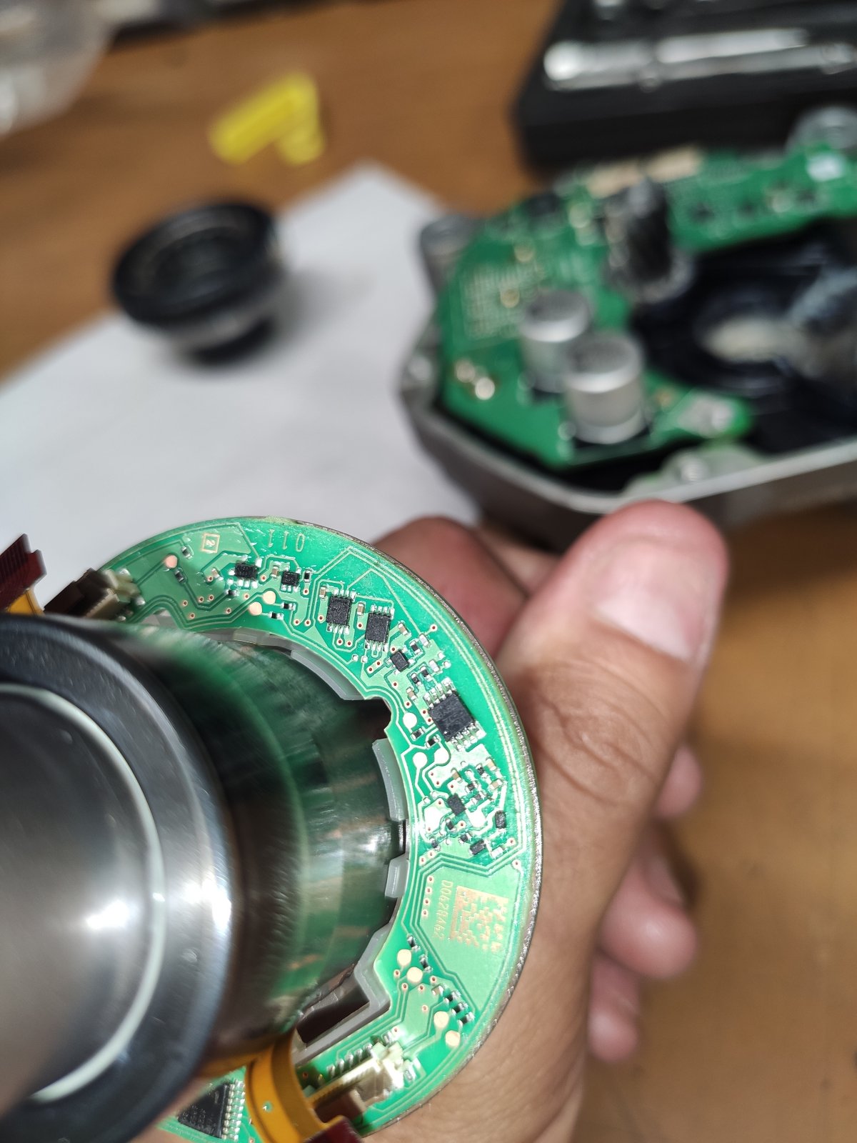

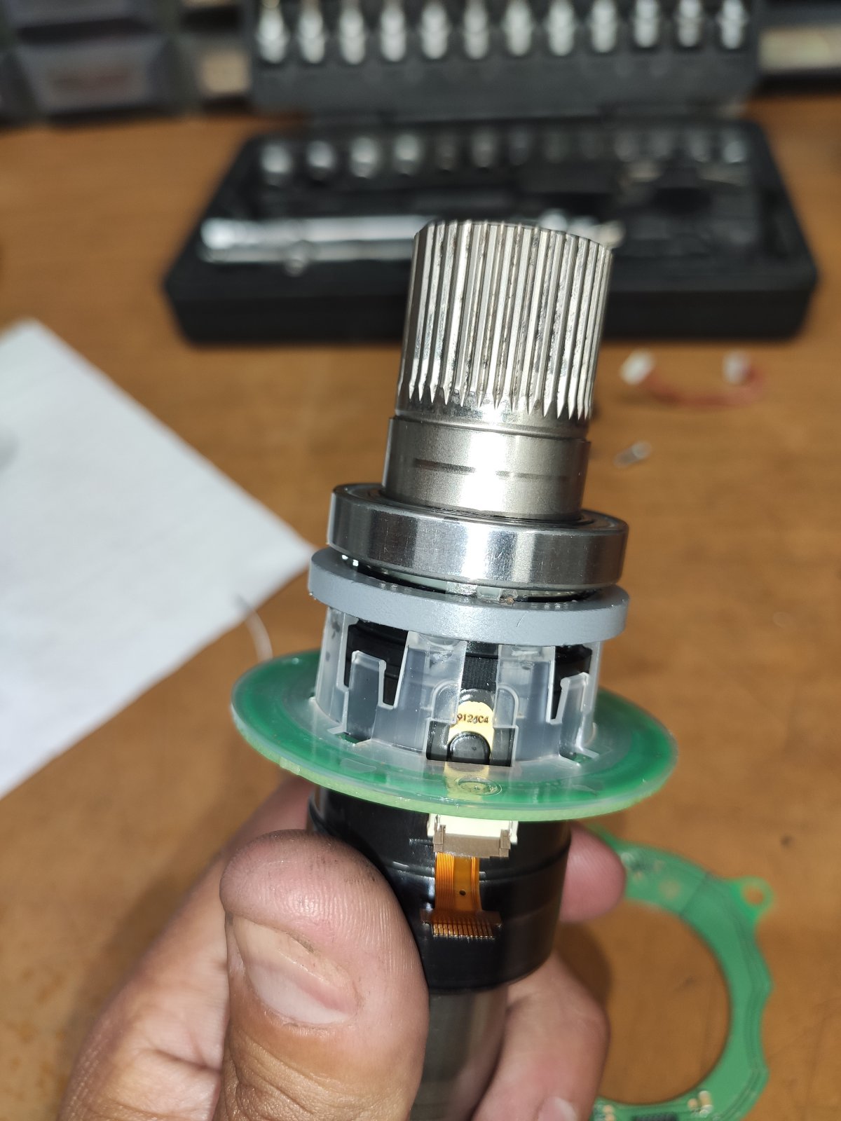

He has also no problems with the torque sensor

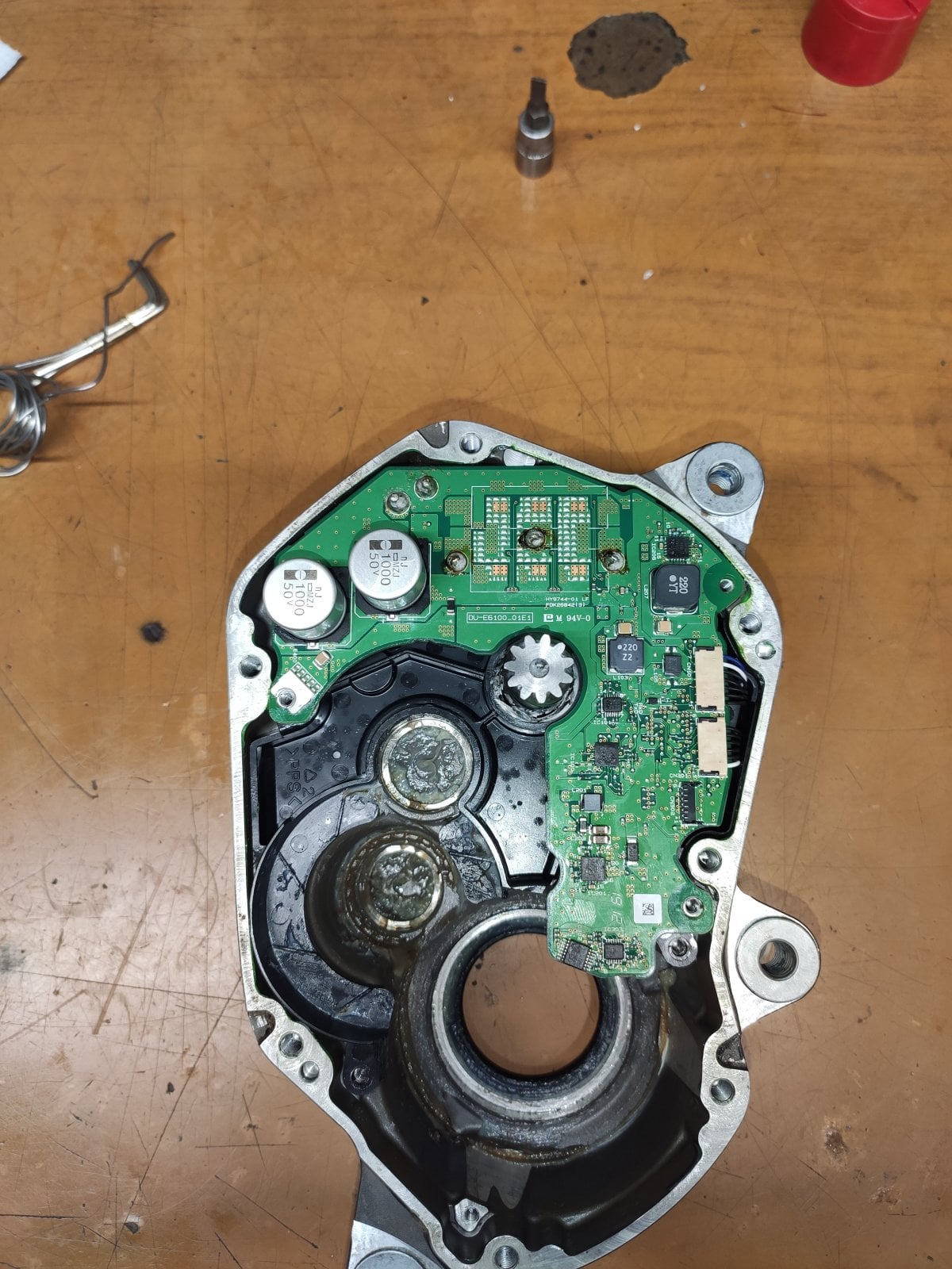

I think that this is what many people wanted to see, I hope iv'e done it justice, it's not an easy one to do due to the nature of all the exposed electrical components and connections. Bosch, Yamaha and brose are a little easier, we get all our bearings etc from Performance line bearings who are very helpful. Items like the 2 main shaft seals are not available, these really need changing at the same time. Perhaps this is something that Performance line bearings could m maybe work on. In the meantime please share the video.
Thanks
Dave
Thanks
Dave
Dave, the insertion of the bearings is not included in the video. Did you use a bearing press or other special tool?

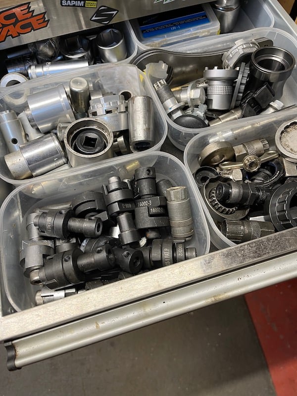

Hi, Were really fortunate to have lots and lots of bearing press tools and well as extraction kits for any type of bearing as well as a hydraulic press. we can also make custom tooling on our lathe. Dave

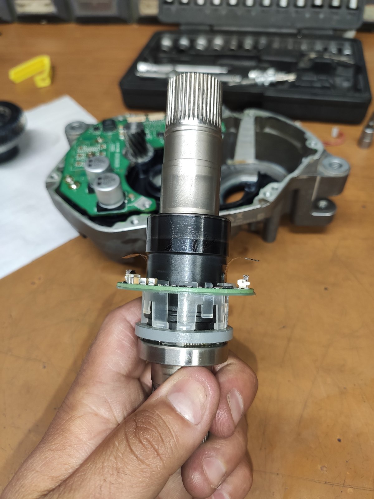

Thank you everyone for your effort, this post has been very informative! My E8000 makes this quaking/scratching noise when under load for a while (similar to this video) and I'm considering opening it for inspection. Few questions:
1. Could it be that original grease can not handle this much load (heavy driver, constant load for a while) and fails to lubricate properly and if so, what kind of grease should I apply and where? ... is there options for thicker/thinner grease and which should be used in this case?
2. Related question, does anyone have made any final conclusion what grease to use and where?
3. When applying new grease, should the original grease be fully removed and is isopronaol suitable for this?

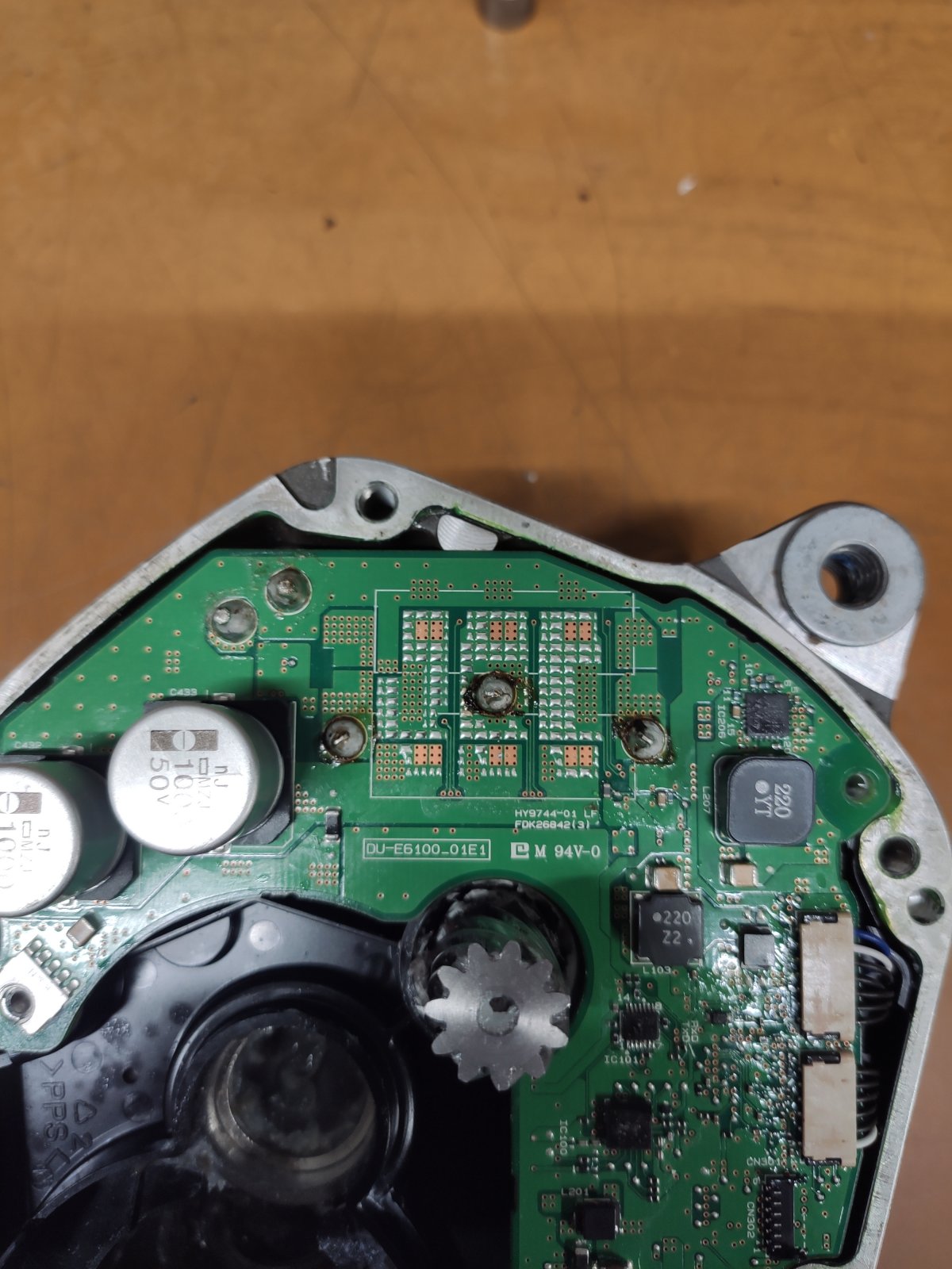

ciao il mio e7000 da errore e010, con uloker stunt ho letto e01020 ... ho notato che il magnete tondo gira, come dovrebbe metterlo? ho provato a girarlo e ad un certo punto si è incastrato su una bitta.....ho provato a metterlo lì e dargli un po' di colla, poi ho saldato di nuovo i connettori principali.....qualcuno ne suggerisce altro intervento da fare?

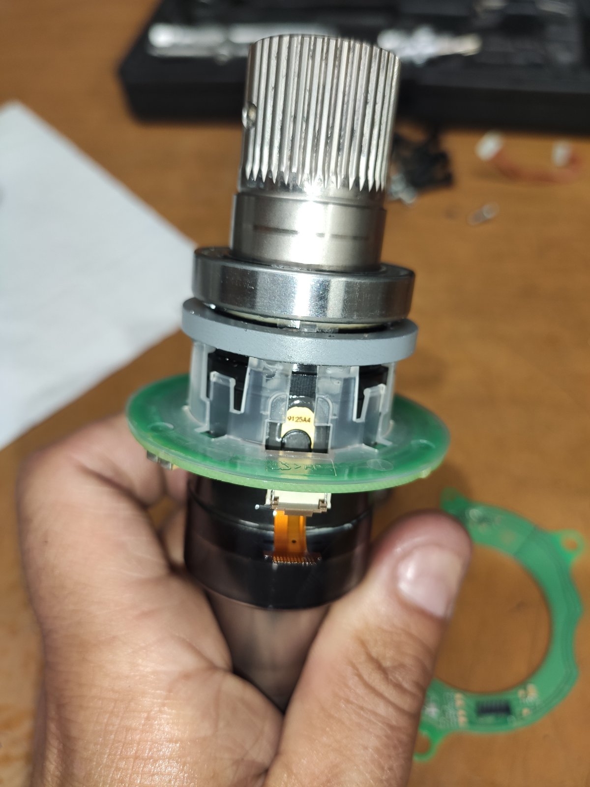

Hi guys
I hope you can help me.
Is this amount of play ok or is this a gradual way to bearing replacement?
is it an ok 6805 replacement ?
What a great question!
An ABEC3 LLU bearing would be a better choice. Everyone thinks that ABEC5 is the best quality you can get! It is only a standard denoting the tolerance of the bearing (it is harder to make, therefore costs more). It could still be made from chocolate!
Fitting a bearing designed for a high speed electric motor is not whats required for a crankshaft doing 90rpm max. There is a good reason ALL motor manufactures use ABEC3 bearings.
2-RS seals can come in many different guises, many cheaper bearings don't even have an inner race lip for the seal so sit in and offer very little in the way of protection. LLU is the best type of sealing you can get, offering a labyrinth type seal against any ingress. This type of seal does present slightly more friction, but a very small price to pay for protecting your motor.
