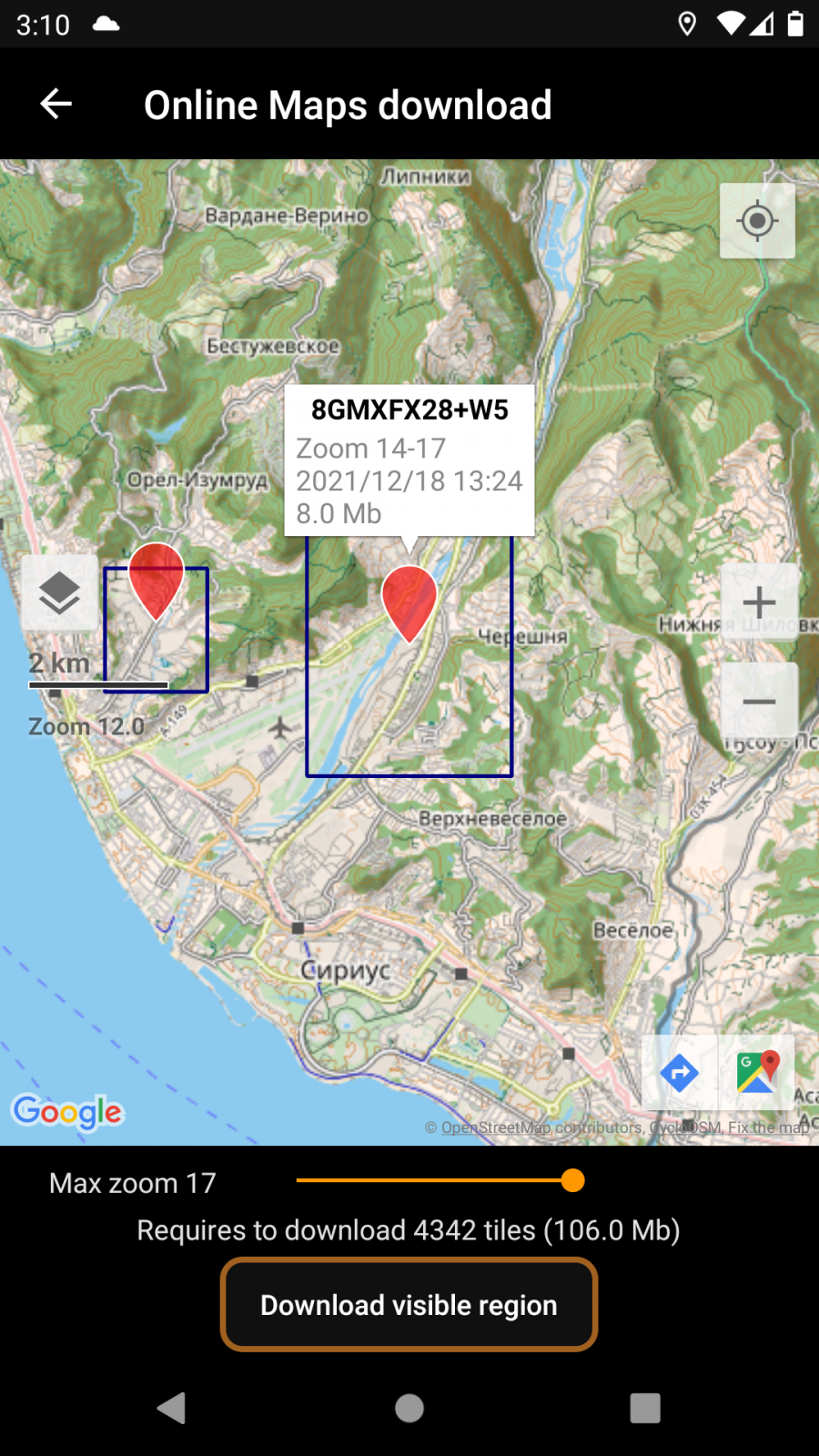

It's possible to download Online maps regions into App's cache (this will be useful if you want to ride in an area where cellular service does not work)
