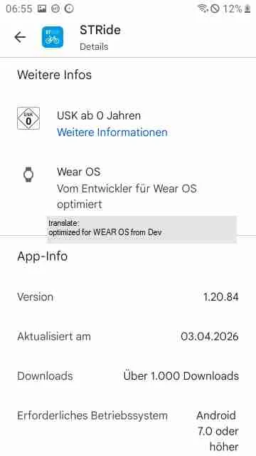

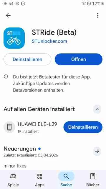

Beta Access: Version 2 is currently in Beta testing on Android. To update, join the Beta program on the STRide Google Play page.
There seems to be a problem. I signed up for the beta (Google confirmed it) and I got version 1.20.84 installed.
Hi vadll
Any ideas?
I'd love to support the beta test, but I only have version 2 on my watch, and I can't install version 2 for my phone.
Phone is Android 9.
Google is only offering me version 1.20 as a beta version.(the Photo above)

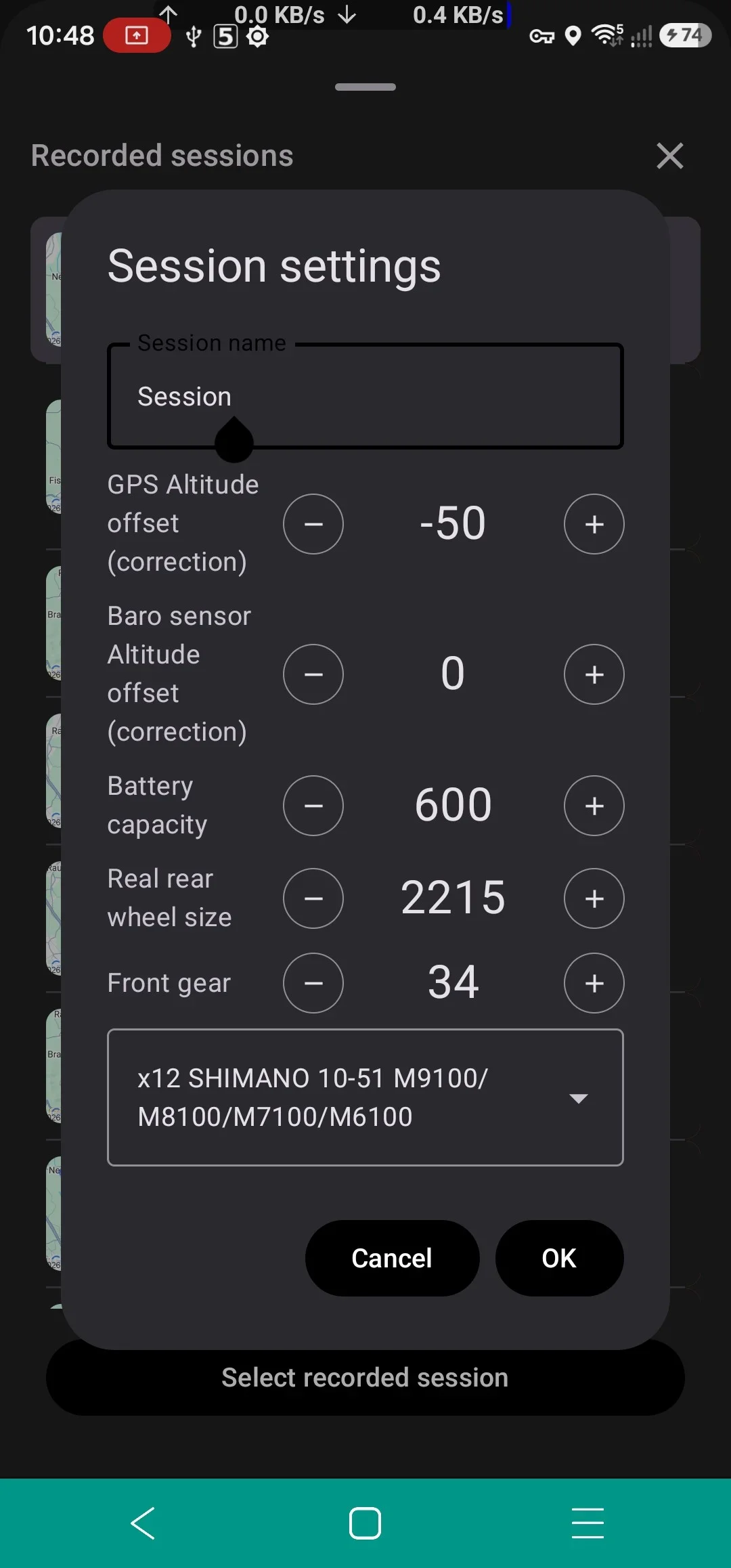

could you please change the colour of the write cursor in session settings from black to white? It is almost not visible on the display.Screenshot_20260525_104841.webp
Updated.
