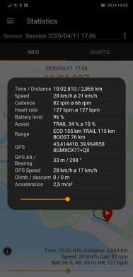

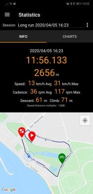

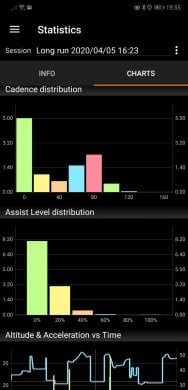

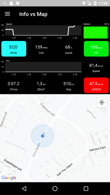

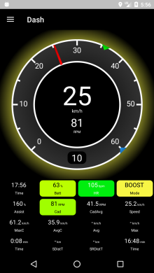

I decided to start developing an App for collecting and displaying information that is available for Shimano STEPS motors: speed/cadence/assist/Di2 data and etc, combined with GPS data and data from other external sensors as heart rate monitors and etc. The only problem is that data from the motor can be collected from any STEPS displays (E7000, E6100, EN100) other than the most common E8000. This is outrageously stupid on the part of Shimano.
It's lucky that the E7000 display is installed in my bike, so I made some initial version. At this moment the App collects bikes data (including Di2 data), HR from common Bluetooth HRM sensor and phone's GPS data. App has circumference correction factor, so it shows correct Speed/Distance on the dash even if you set minimal circumference for a higher speed limit.
So I am ready to listen to your suggestions for the further development of the App. For example, what features do you want to see in such Apps?
I expected some more feedback...

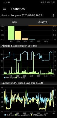

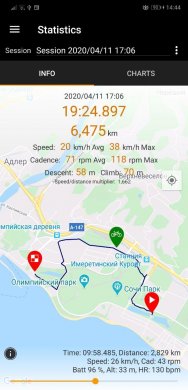

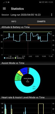

Anyway, here some other screenshots
The data is taken from a generated session, so it looks a bit strange
May be after that I'll get some more feedback :ROFLMAO:, for example what graphs/charts do you want to see.

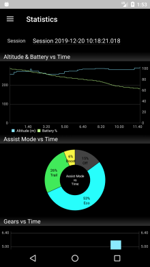

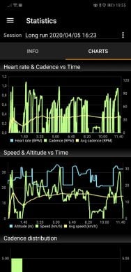

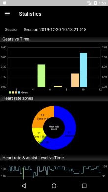

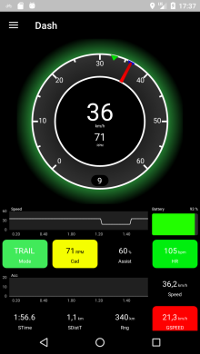

Here is some new screenshots from the App (not released yet)
Screenshot_20200407_195516_com.stunlocker.app.ride.jpgScreenshot_20200407_195532_com.stunlocker.app.ride.jpgScreenshot_20200407_195529_com.stunlocker.app.ride.jpgScreenshot_20200407_195546_com.stunlocker.app.ride.jpgScreenshot_20200407_195551_com.stunlocker.app.ride.jpgScreenshot_20200407_195557_com.stunlocker.app.ride.jpg
Dash scheme (type (chart, bar, text), colors, dynamic colors, parameters) are configurable in XML file (at this moment)
Quick demo
p.s. Assistant level can be retrieved for E8000, but only as 0-100%
