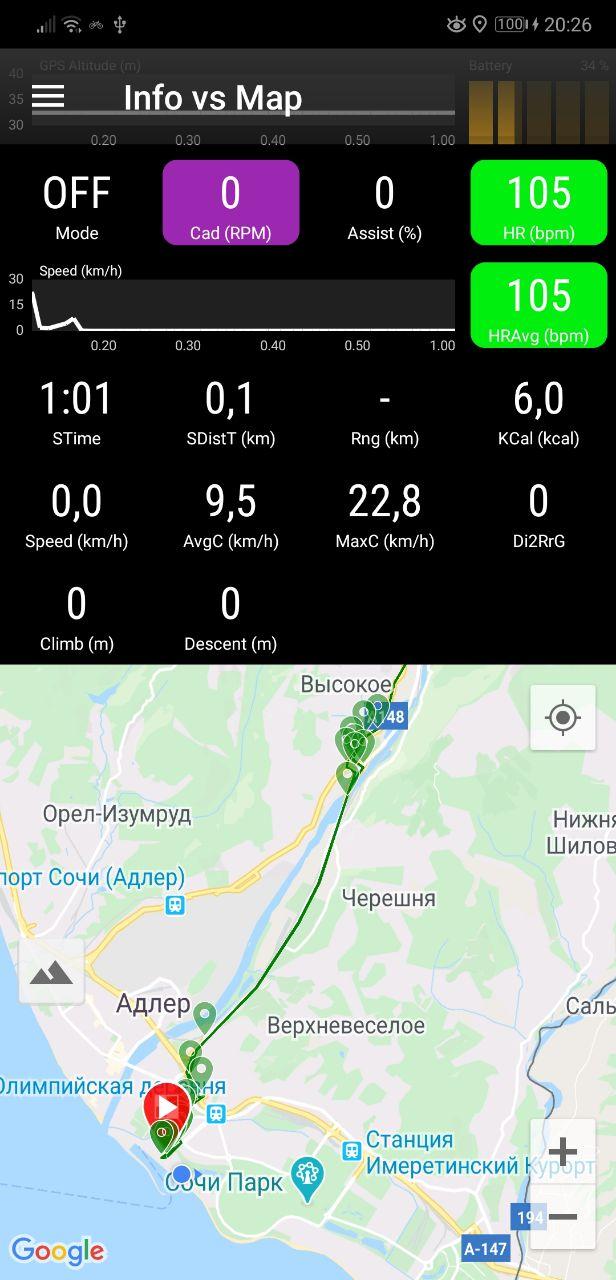

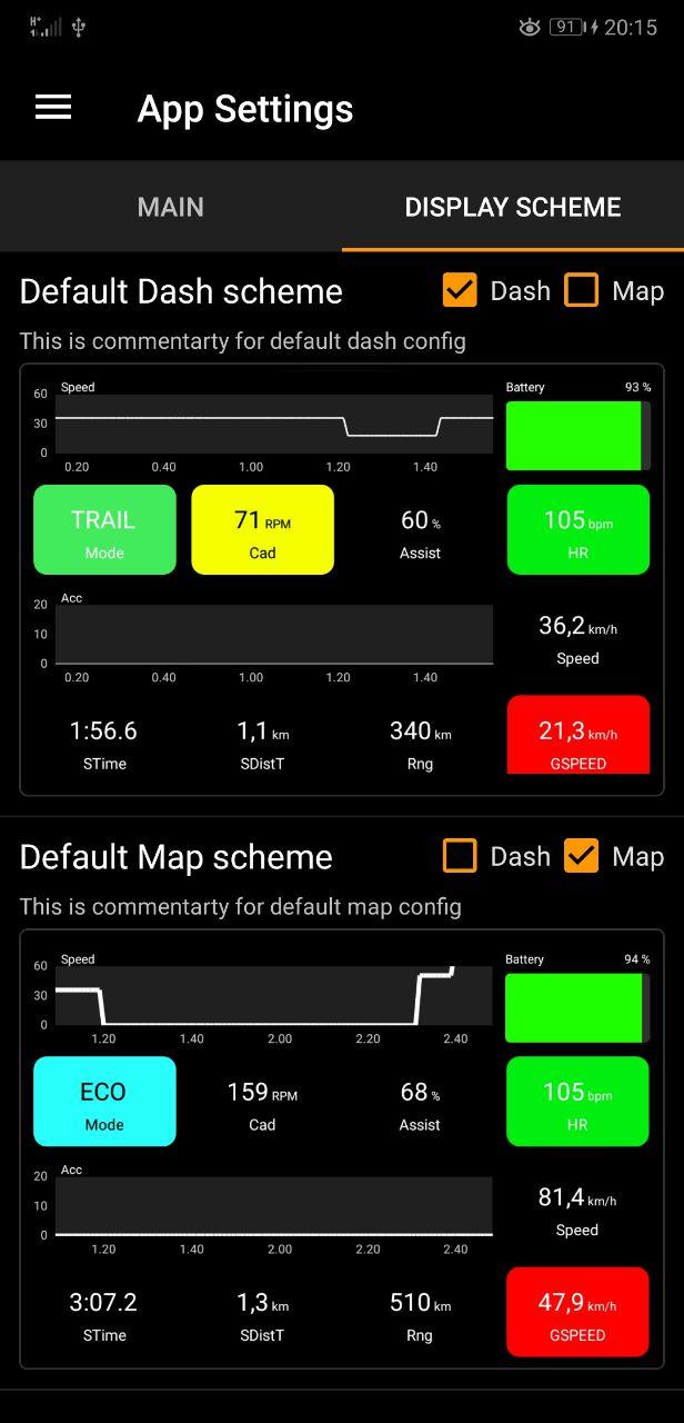

ST Ride App - Tracker/dash/logger for STEPS motors
- Export recorded sessions to external formats for Strava/FIT and etc.
- Customizing display schemes (custom XML files, no internal editor, for someone who able to create XML documents using templates)

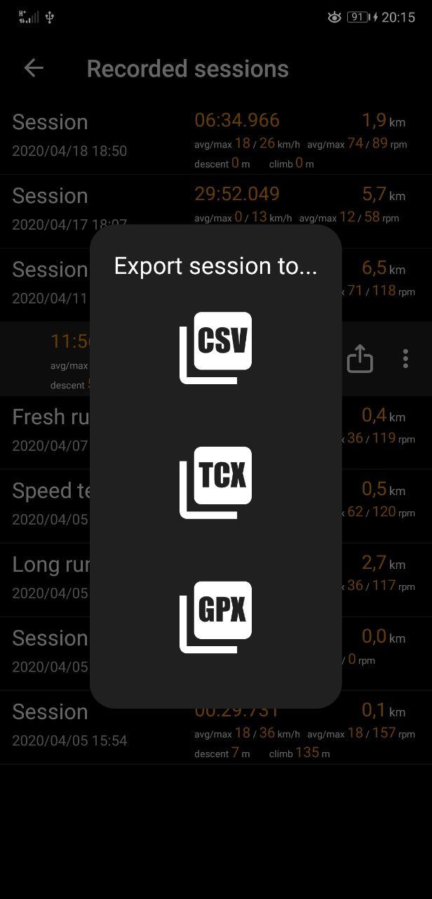

hello vadll, I tested the alpha version of ST Ride, it connects well to the bike, and correctly retrieves the data, I did not find the data file on my smartphone, where is it located?

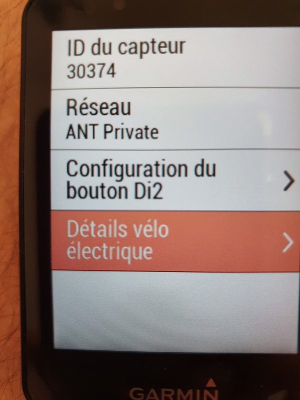

there is a problem, with my garmin edge 530, when the application is in service, it deactivates the sensor coupling between the edge and the bike. to be continued ;)
App doesn't save any data until you press "Record session". Recorded sessions stored in internal database. You can export session into files (GPX,TCX,CSV) at "Statistics"
ok, i found to export the data, thanks
for the disconnection of the "electric bike sensor" do you have an explanation,?
There should be no disconnections if your phone is always near the bike. The App can not control this, the system itself is engaged in this. Moreover, after the bike loses connection (if you turn off the bluetooth on the phone), you can no longer connect to it until you turn it off / on again.
the garmin disconnects from the bike when I start the app and I no longer have the bike information on the garmin ,. on the smatphone, everything works fine, I have no disconnection.
Only one device can be connected to the bike at same time

ok, but in one case we have the ANT private protocol and in the other the bluetooth, those are two different channels? so you can't use the smartphone with the garmin at the same time, it's less interesting for me.
