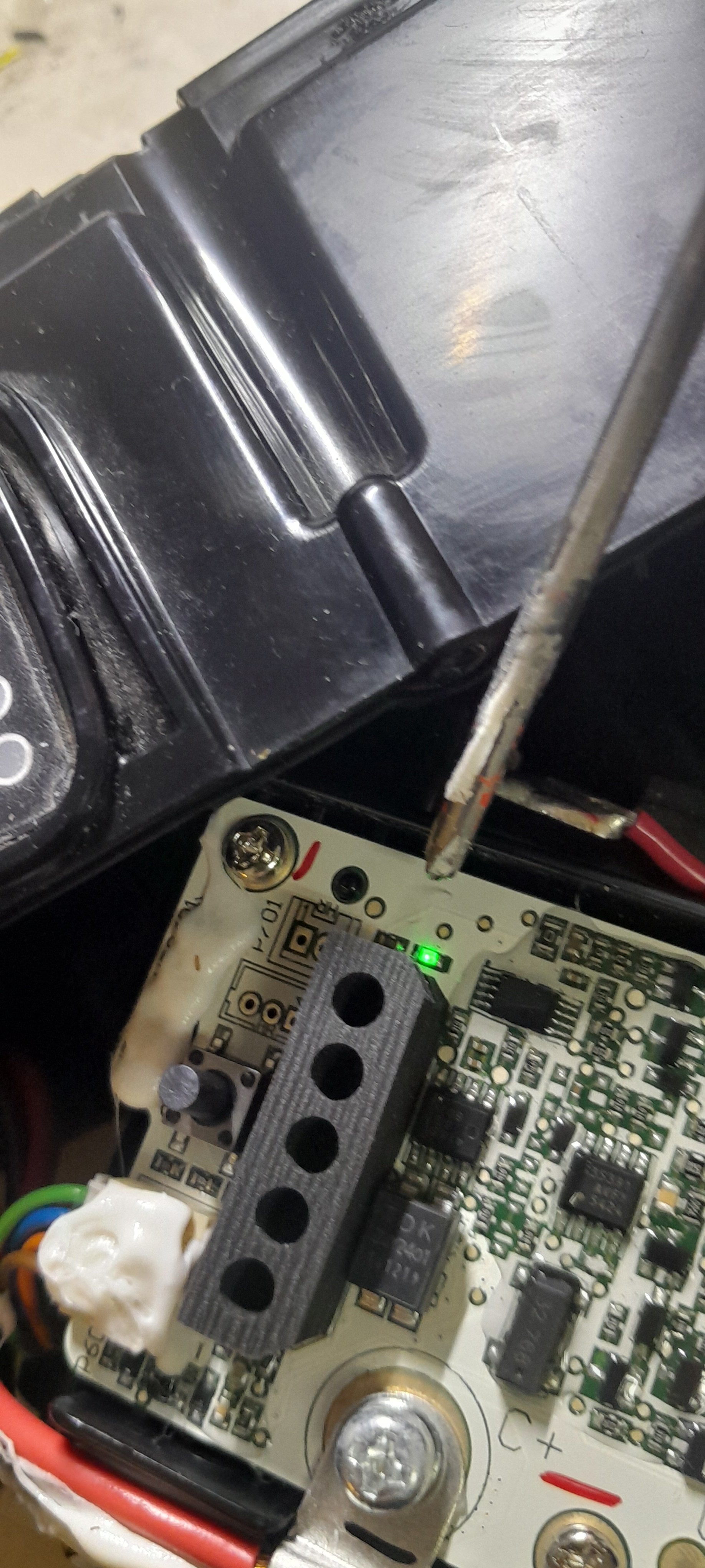

I have a SBC-B11 12.8ah
1 group of cells was out of balance (3,45v vs 4,05v) ive manually charged that cell group to 4.05v.
But there is 1 green led that is flashing (next to the state of charge leds), and the MCU part is warm.
Does it need a reset? (can i do that myself with an arduino orso?)
Most likely the BMS is locked. That bank with 3.45v probably has lower capacity than the rest. Even if you unlock the BMS, it will lock again as soon as that bank will drift from the others. My best bet in your case is to replace the cells. Sbc-b09 had LG MH1 cells (light blue wrapping) which are not so good, they tend to debalance especially after a couple of years of use.

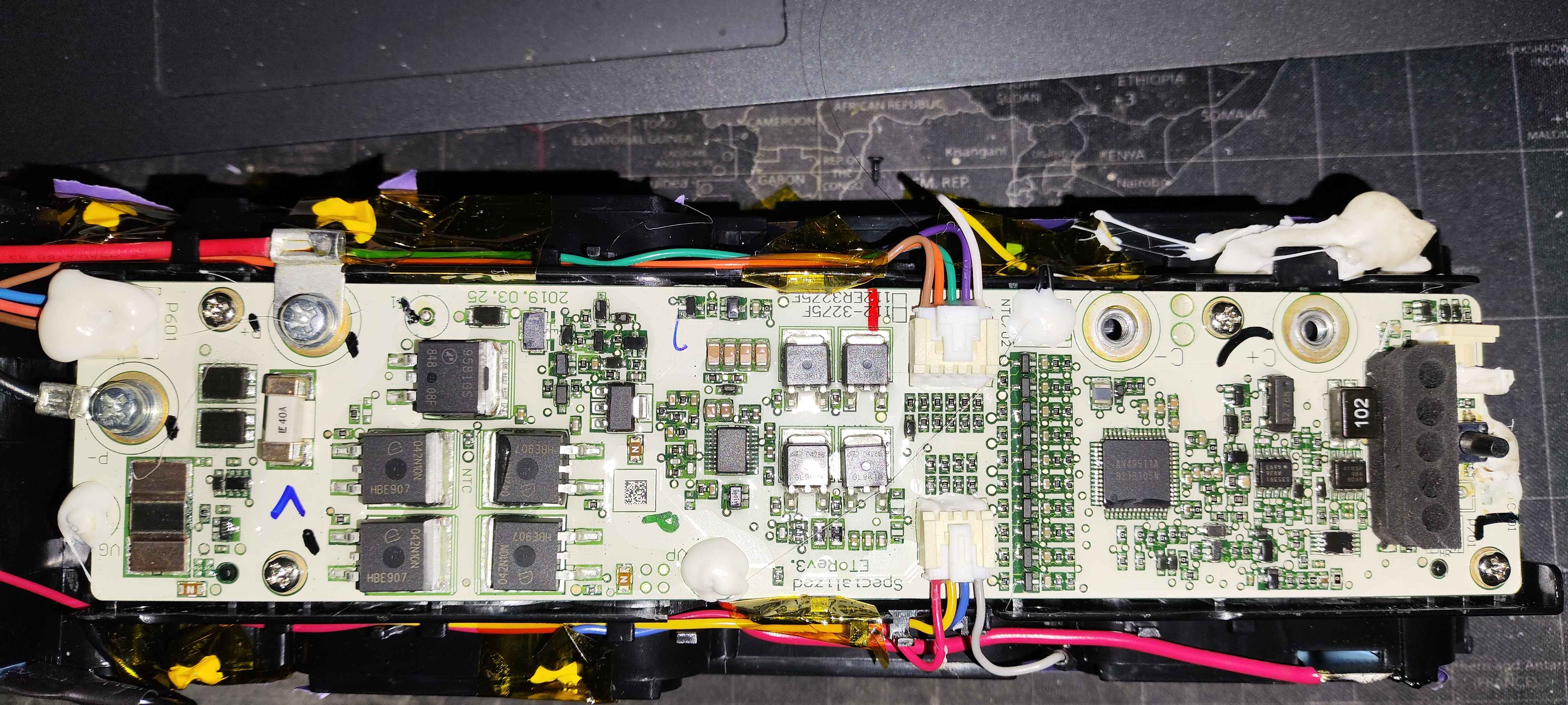

Hi @cream. I have a 700wh battery for my 2019 Turbo Levo gen 2. It has 3rd green led flashing. I have opened it and tested all the cells to confirm that they are not the source of the problem. So, I think it is locked up BMS. Please shoot me a message if you are willing to take a look and maybe unlock it.

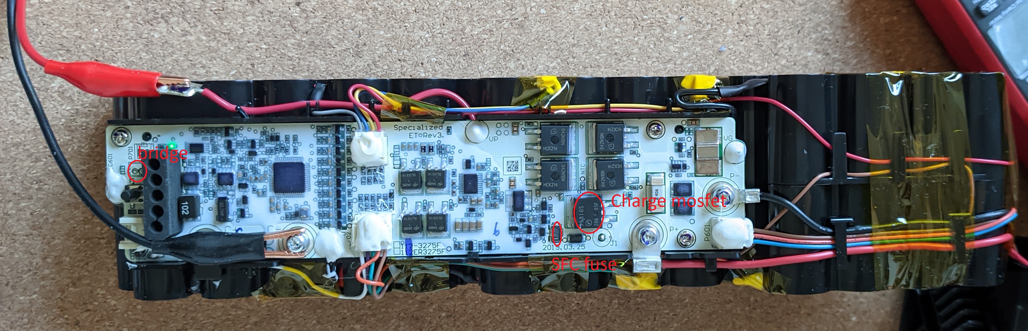

HI @cream I have a SBC-B09 from a friend that made a short between the two charging pins and now it does not charge with the charger anymore - I have opened it up and charged it with my lab-powersupply successfully though.
The BMS board on the top looks perfectly fine and I am getting an output voltage when I switch it on, so I think most of it is still fully functional and there is probably just some fuse that needs changing.
Now to the question, can I just disconnect the balance wires without risking that the BMS gets locked? So I can take the pcb out and have a look at it from the bottom. Anything else to pay attention to, so it does not get locked?

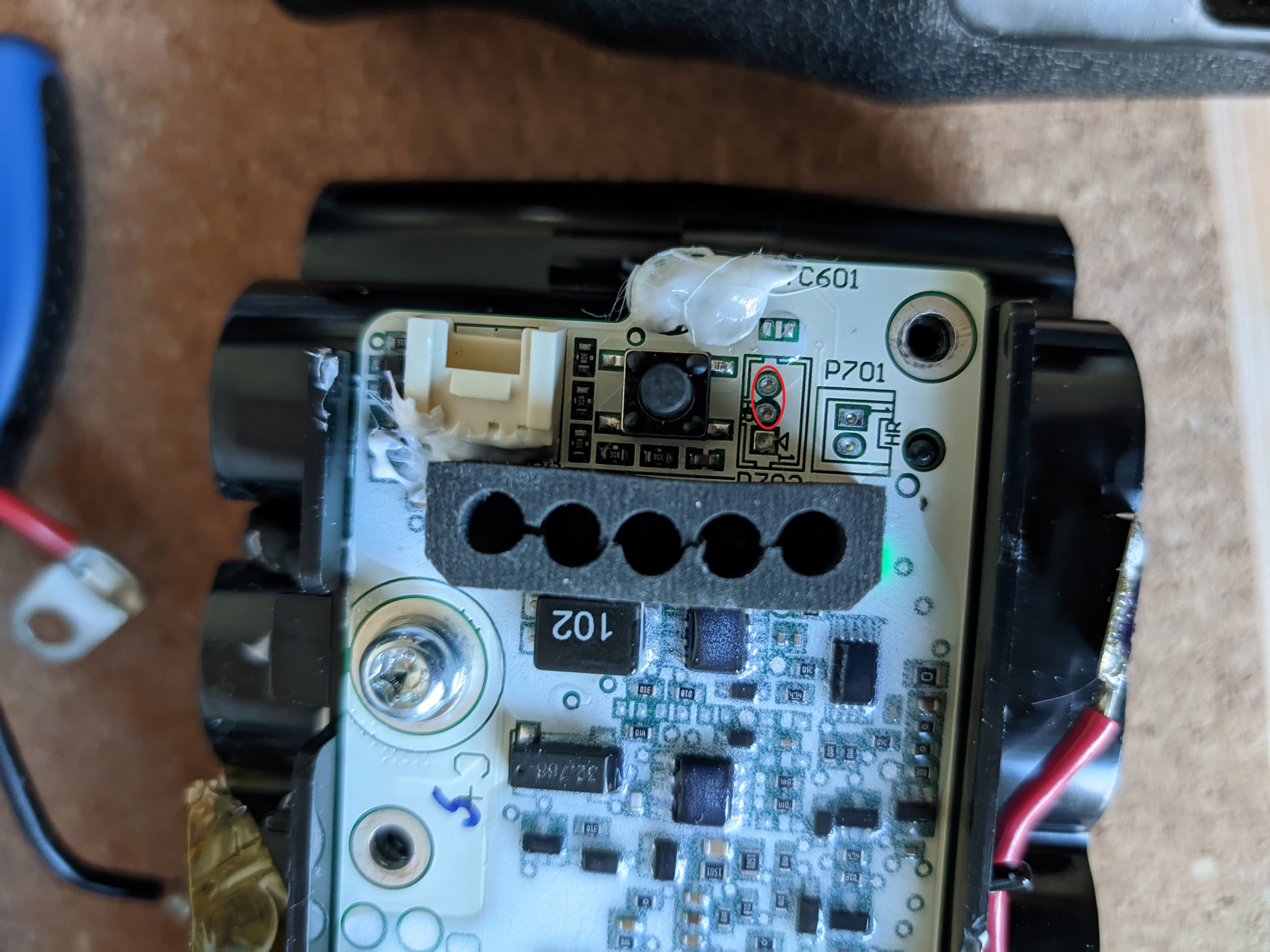

How do I know if the BMS is already locked? It has this one led that blinks like once every second (see picture)
Hi. Your BMS is not locked (as long as it will turn on voltage on the discharge connector when you power on the battery), but if you remove the balancing connection(s), it will lock. The key to prevent that while you disconnect the BMS is to put the MCU reset line to a low level.
As you suspected, most likely SFC charging fuse is blown, check also the charging Mosfet for short. So either you replace the fuse while the BMS is connected or you put a jumper wire between reset line and GND, followed by a fully disconnect, replace faulty parts, reinstall, remove reset jumper wire.
P.S. I think we've talked in the past about an M1 battery BMS on pedelecforum.
Awesome, thanks for the quick reply! It is indeed the SFC fuse! And the mosfet is still fine.
Since it is accessible like it is, I will probably try to replace it with the battery connected. Just in case I should need to reset the MCU though, the part you indicated has 3 pins, one of which is connected to ground, which of the other two is the reset pin?

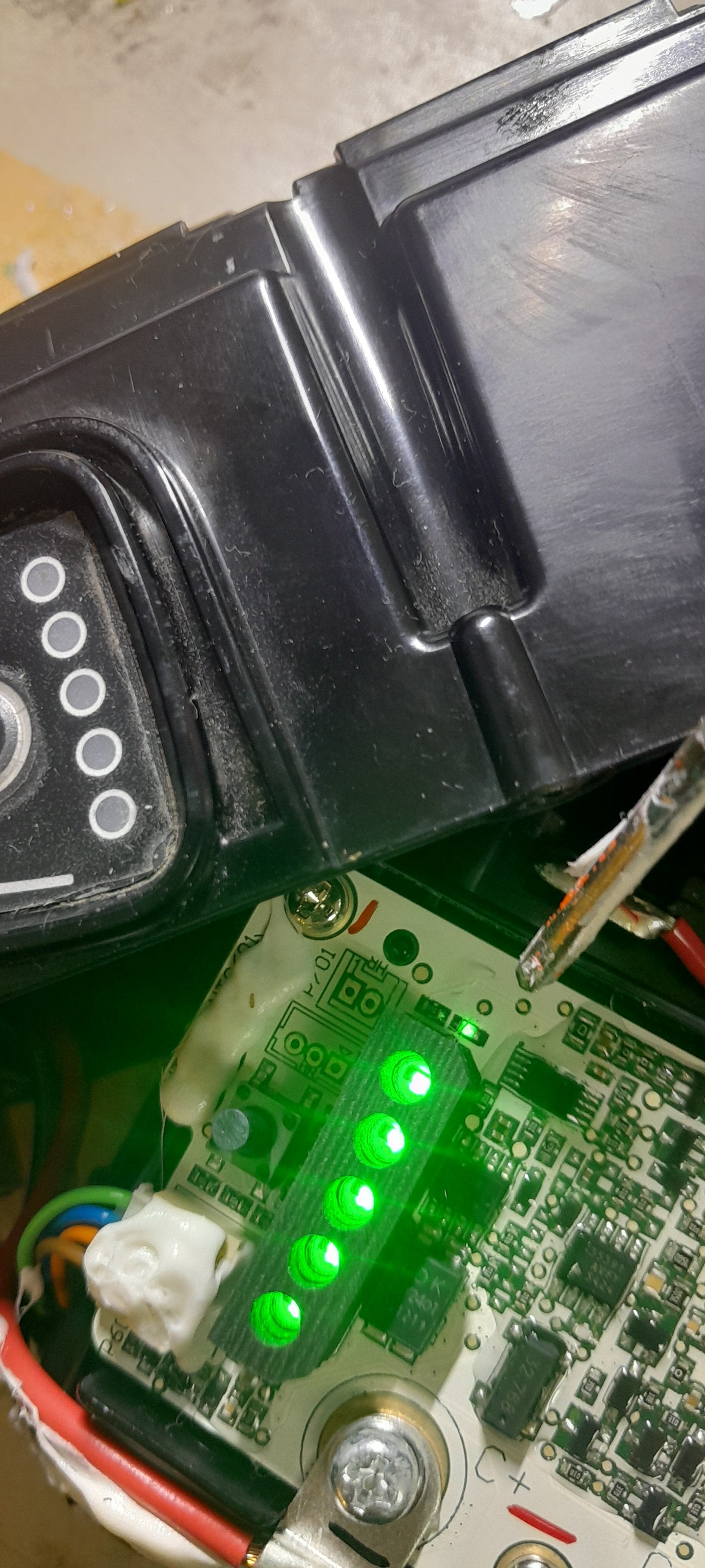

Hello , Cream i have a issue with my display when i turn of the Batt there be som strange stripe or letter (half) on it ,so i take the batt and see a little green light flashing what can it be for problem ? when i puch the button it starts to fast flashing , power of then ist slow flashing.
Thanks
This is normal internal led behavior. If the battery powers on the bike and also charges, your problem is somewhere else, not in the battery. If you're having problems with the display, why did you open the battery?

First it`s a other batt ,504 i get i from sombody how hat a broken frame , we test it in my wife (Como) and my (Vado) and see the same strange line`s letter`s on display , with my old batt (defect) i don`t have / see this problem .
For open it because the switch workt fine . and then we see this blinking led, so i tocht tis is a issue .
But anyway thanks for replay.
