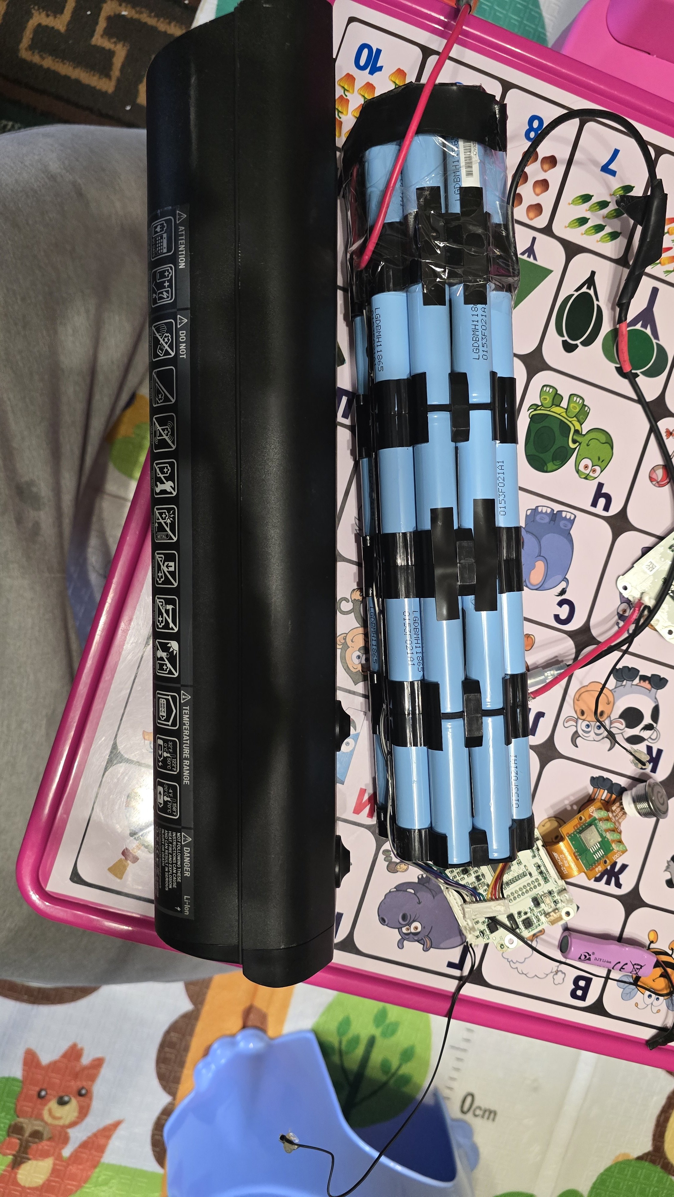

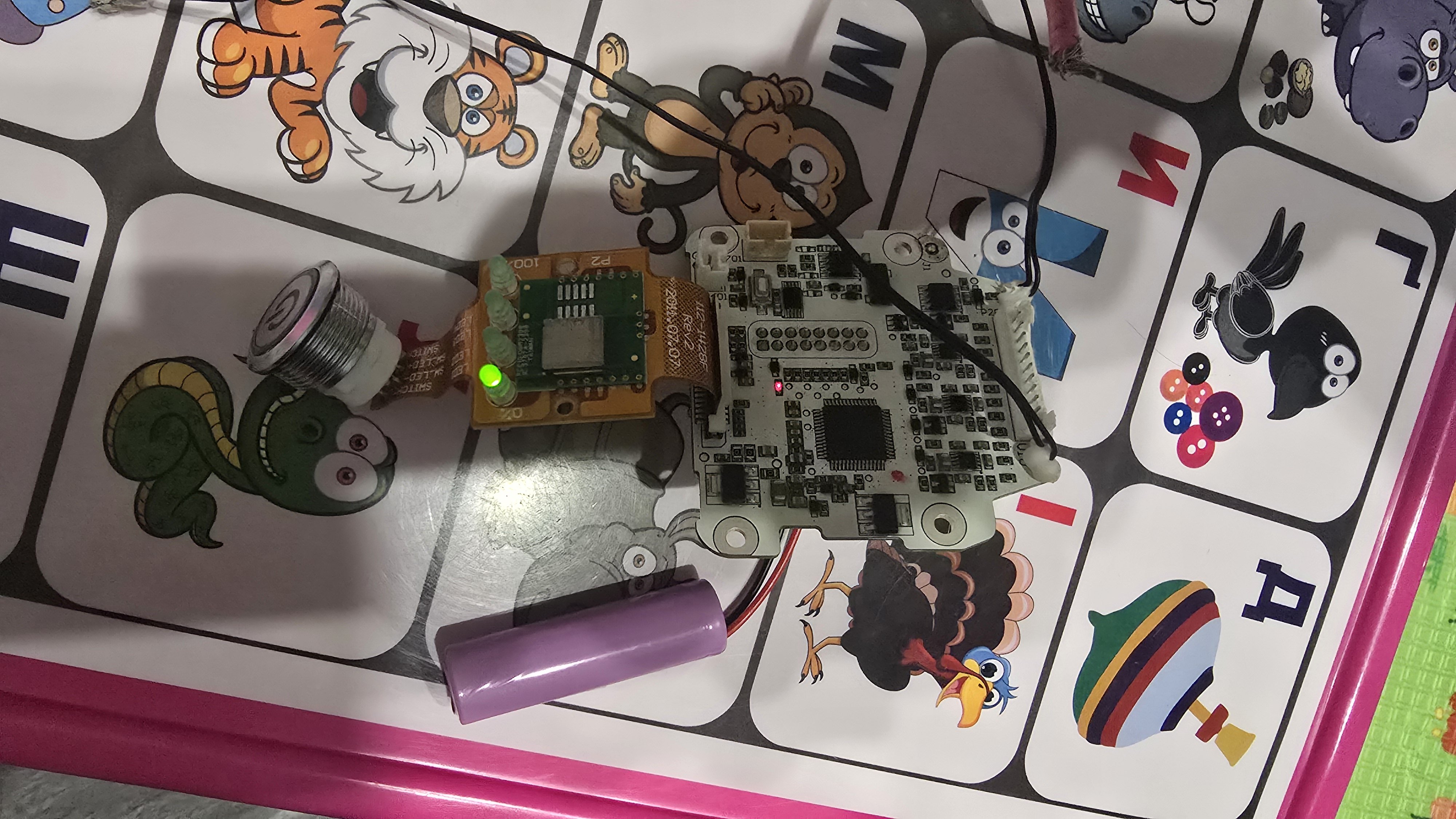

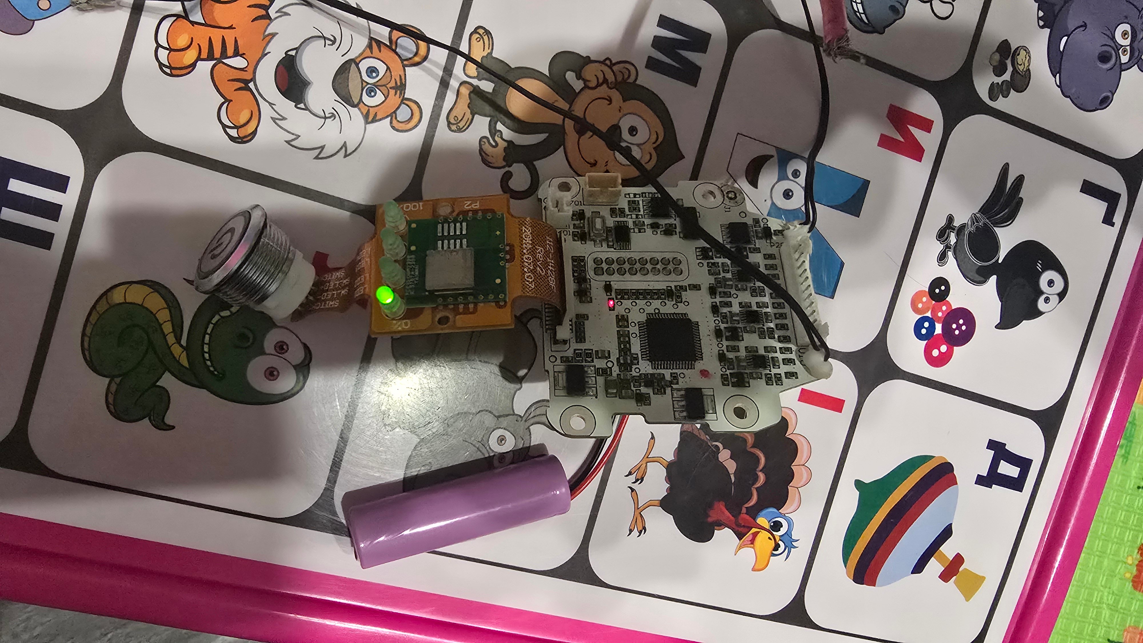

Hello. I have bh atom x bike. Brose motor. I want to use specialized battery for it.
I have one but it is blocked.

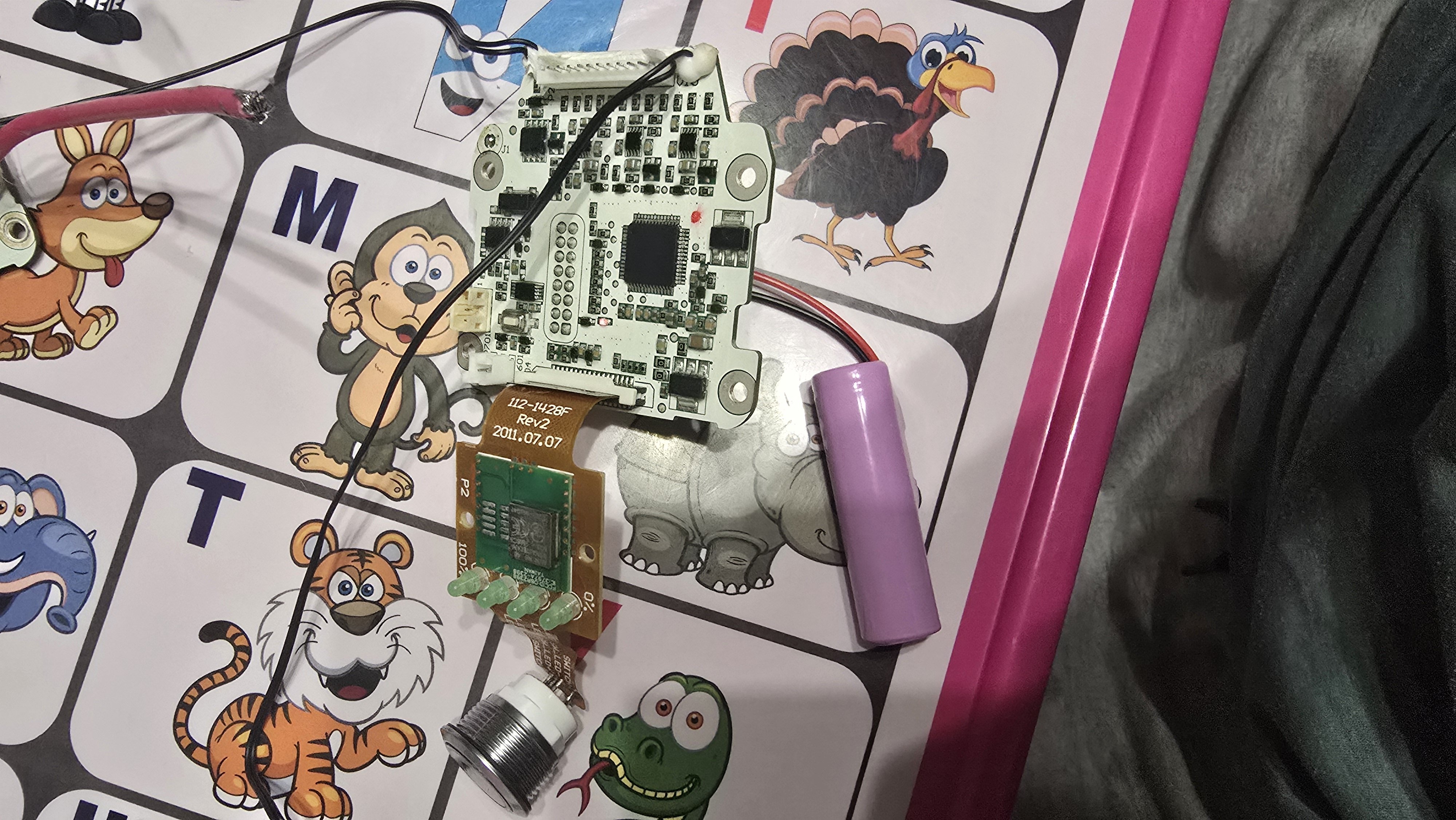

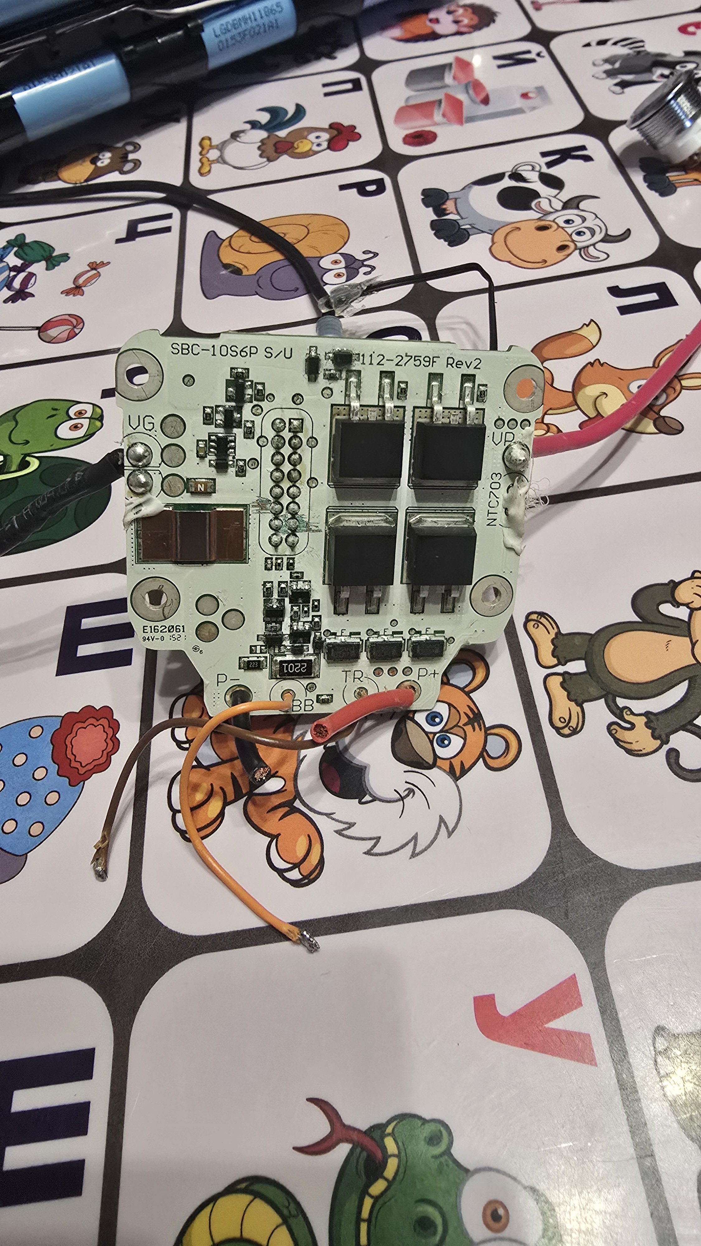

This battery's have two boards. When I conect them - they don't start.
When I give 3.7 v to the border with mcu it start but show 0 percent.
The brose morot battery has 6 connectors.
Blu and green - flash
Black and red - power.
And do you know for what are yellow and brown?
20250317_165336.jpg 20250317_165549.jpg 20250317_165540.jpg 20250317_165400.jpg 20250317_165400.jpg

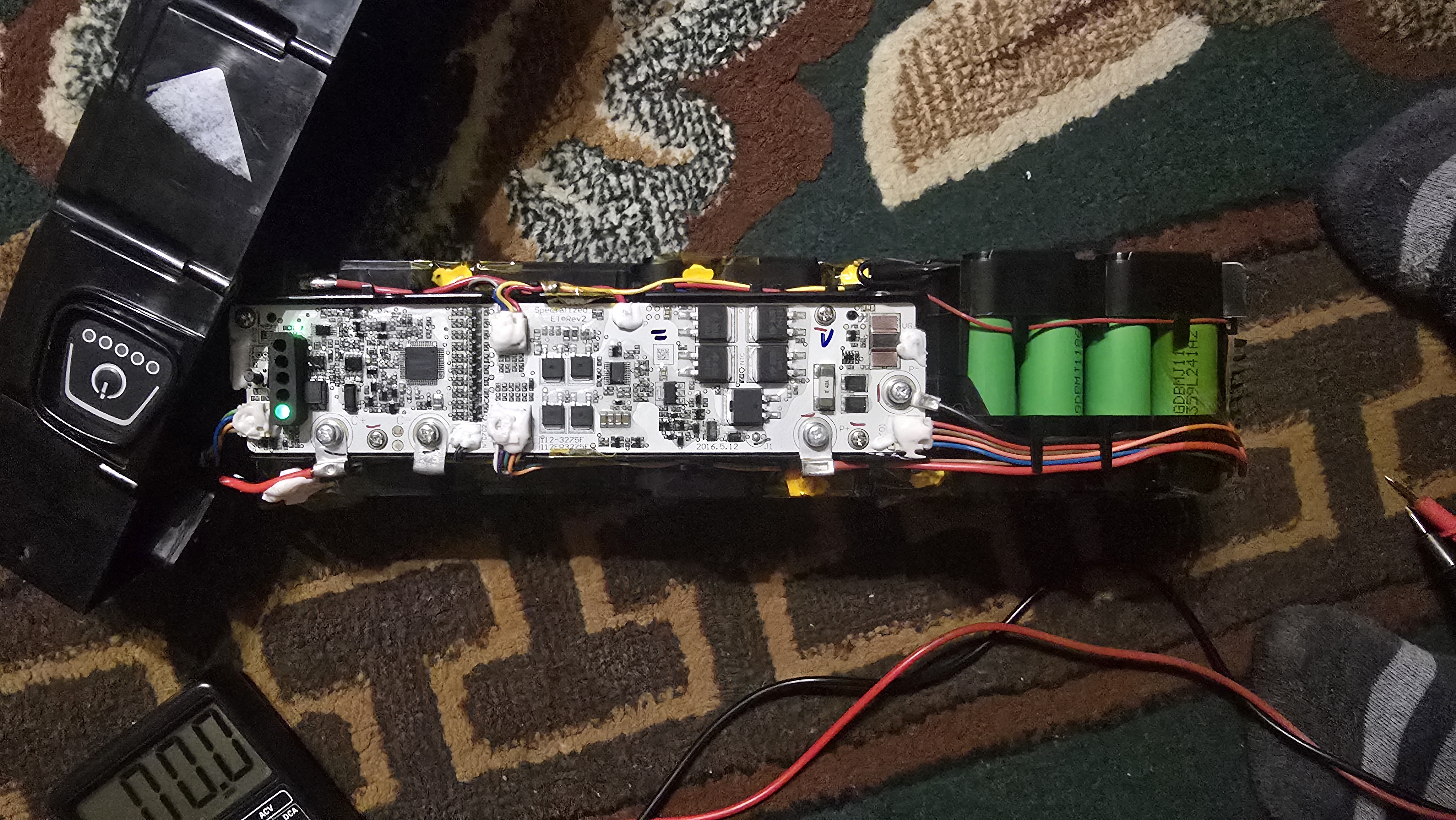

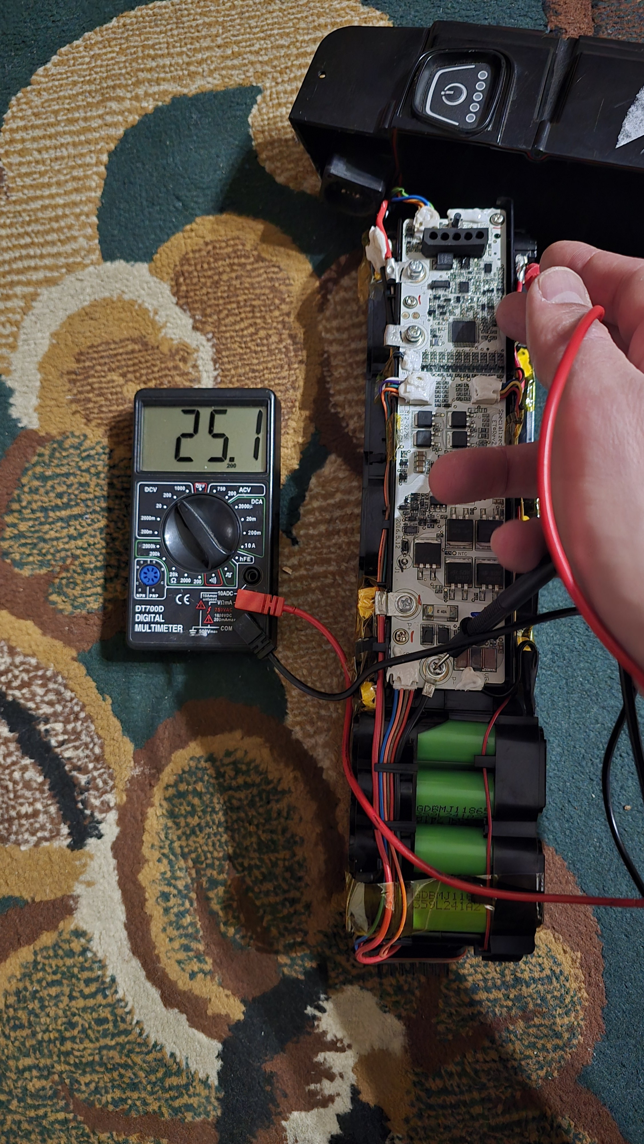

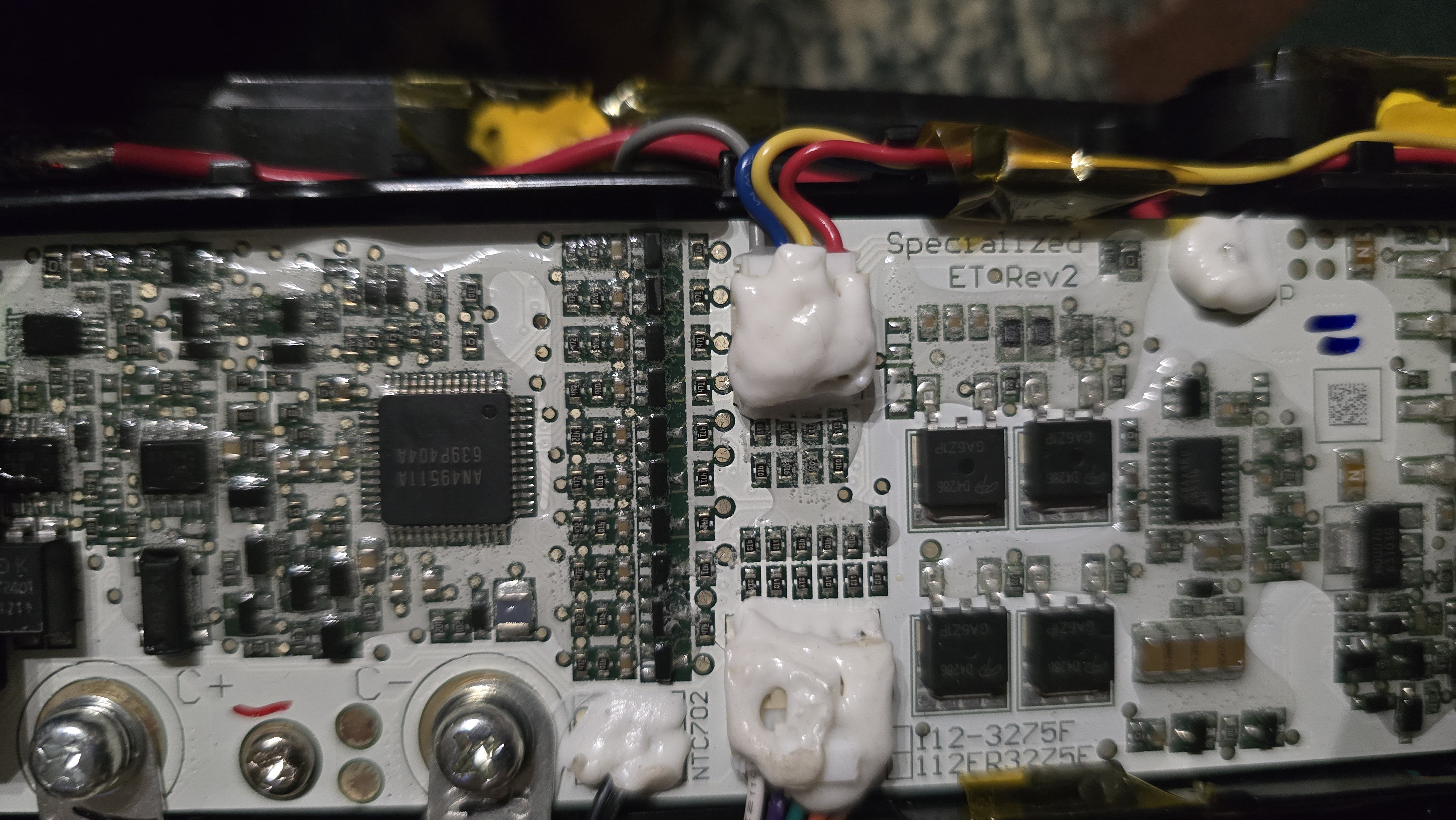

I have this battery. It shows 1 green light without blinking
But it have 25v 3groups of cells have 0 v

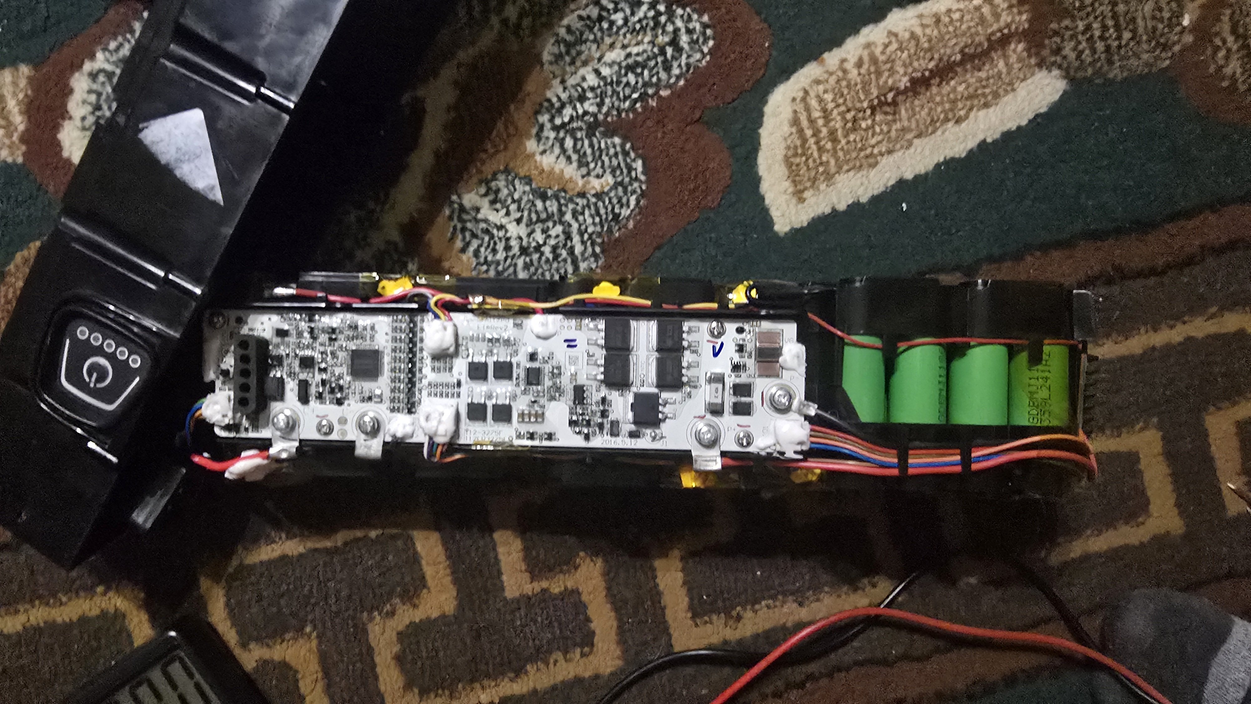

Can I charge them from this points from foto 3
20250320_192231.jpg 20250320_192237.jpg 20250320_192249.jpg 20250320_192336.jpg
If the cells reach 0v, you can safely dispose them, do not try to charge them or it might end up messy :)
Assuming the other banks are good (balanced with max delta of 20-30mV), you can try to replace the 3 faulty banks with same cell type. But if the rest of the battery cells are used (lower capacity) their voltage will deviate from the new banks and BMS will give an error.
Also, even if you replace all the cells, you need to unlock the BMS in order to used it again.
I would say the only reliable solution is to replace all the cells.
Specialized batteries CAN be repaired. Most M2 batteries with 3rd led blinking when charging have good cells inside and a locked BMS. Assuming the cells are good, I can unlock/repair the BMS so the battery can be used again.
