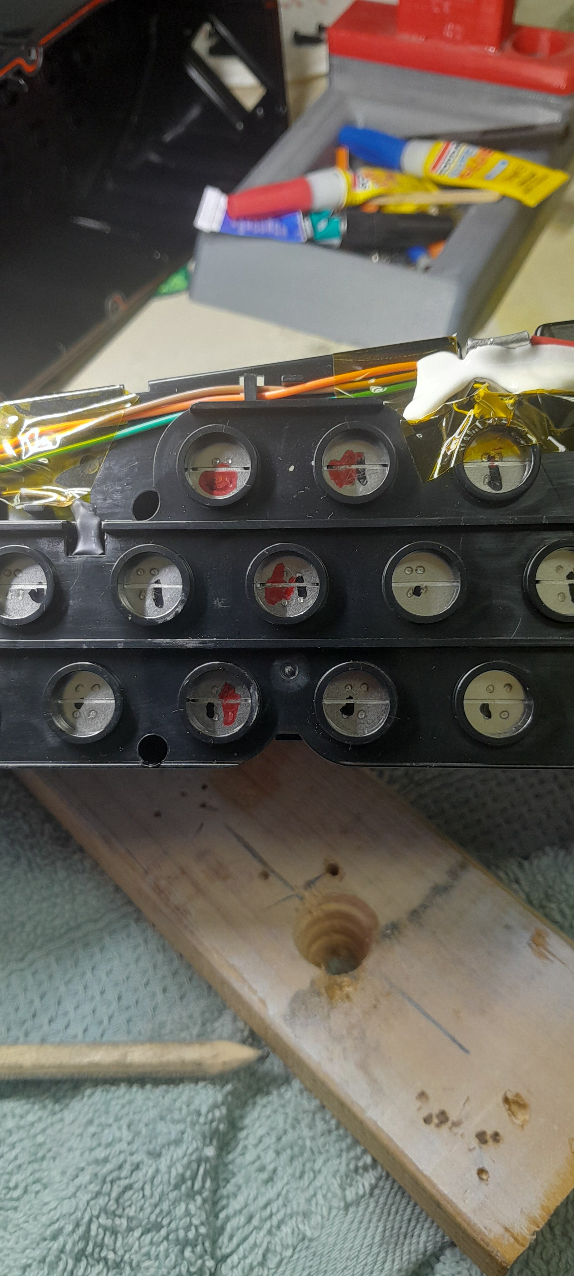

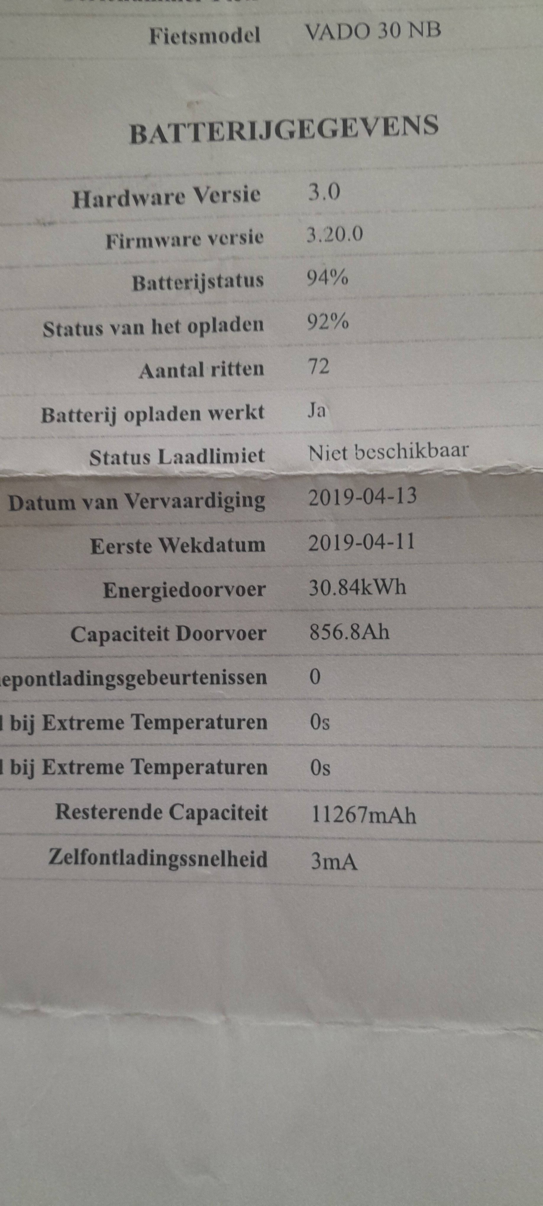

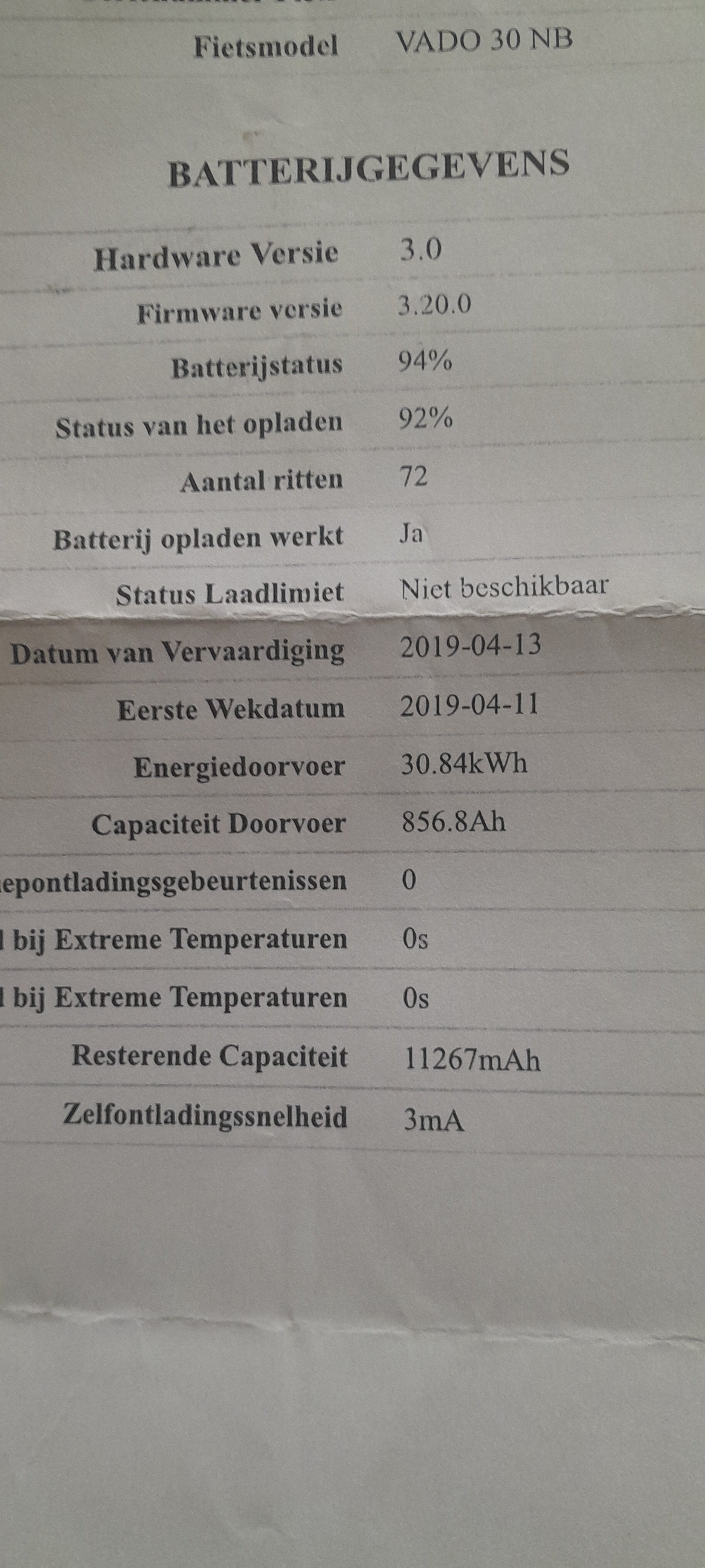

:mad: have a issue with my Vado battery ( 72 cycli 4300km), last week biking 64km in France and just into the montagne outo_O 46% at display ,trying at home now out with 43% , i open the cover and masure the cels , the one with red/black dot are les see picture , i hat a software update 3weeks ago same as for my wife Como (103 cycli 7200km), never hat a problem, iust biking alway`s till 20% battery.
Hoping its software bike is now by dealer :rolleyes:to read out.
Any way thanks for replay .

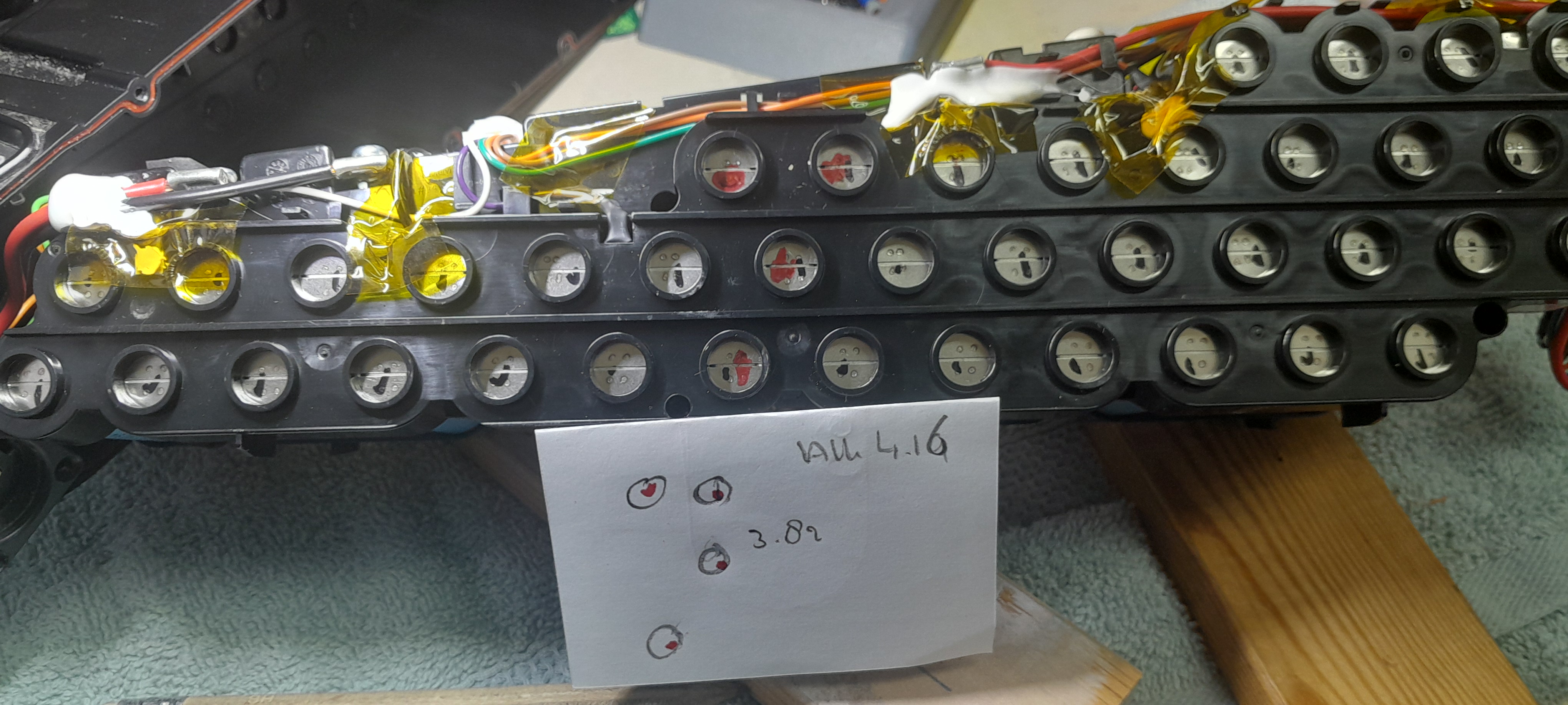

Both are 460w SB
With this level of imbalance (340mV) I wonder if the battery will power on the bike at all or charge.
If the bike still works, you can try to charge that bank to 4.16V and see if the situation will improve. But the BMS must be prevented to run or else it will block or damage when you manually charge that bank. But most likely that cell bank has lower capacity than others or might have higher self discharge rate.
I wonder if you store your batteries at 100% charge? This will damage the cells, especially LG MH1 (which is used in your pack).
Cream thanks for answer yes bike runs good untill 43% , storage !! whe use the bike`s almost every day about 100km a week , only last week on holiday uphill its stops never hat this issue charcing with the orignal Specialized chargers .
question can that be repair even by dealer ,or do we have to by new.
Dealers won't repair batteries or motors. They only replace them. Might get a discount if you bought the bike from them.
Other option is to rebuild your old pack with new cells.
