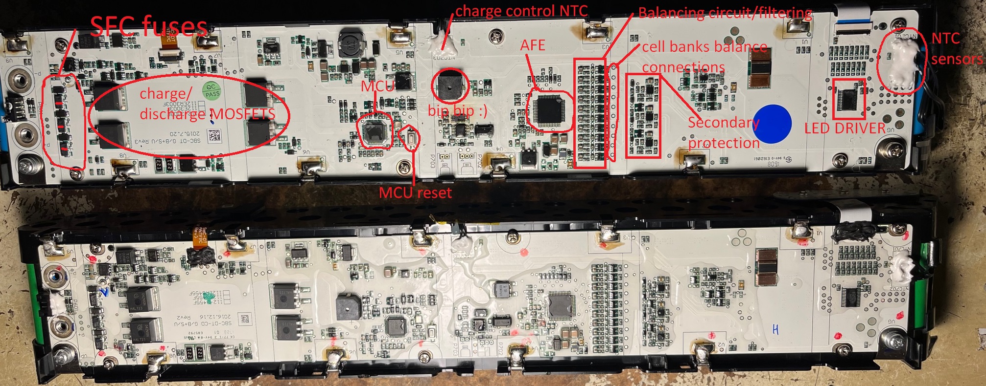

If it powers on the bike but won’t charge, you might have problems on the BMS charging circuit(it happens on this model). If not discharging or charging, might have a permanent failure flag activated in the firmware.
You can send the BMS board and I will check/repair it, as long as you are located within EU.
P.S.
Have you checked all balancing connections and NTC sensors when reinstalling the BMS? Is the pack balanced within 20mV?

Yes, I can help. Next time you disconnect the BMS make sure it's completely off (the safest way is to put a jumper on the reset tactile switch.

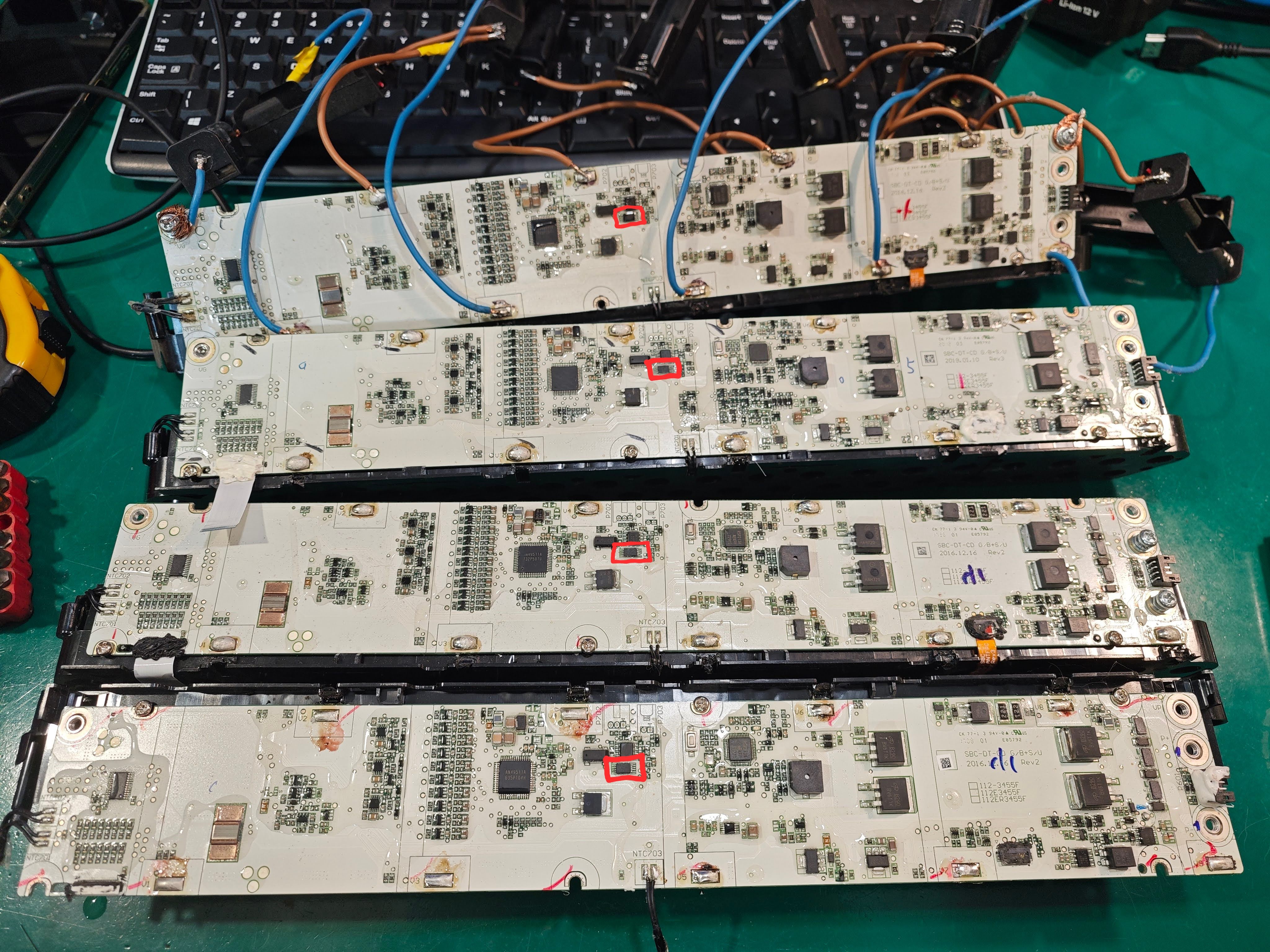

I can help you with board repair/diagnose/unlock but in order for everything to work, you need to replace all the cells not just a single cell or a segment of cells. I can't figure out what is happening in your case. You said the cells in series have 3.8-3.9V but then again you said the output voltage is 20V. That doesn't make any sense.

Is that an option that we can explore? We currently have a Specialized with the 3rd LED flashing. Have checked the voltages and cell group 1 is at 4.2v and the other 9 at 4.1v. Battery pack accepts charge, then goes into the 3rd led flashing mode.

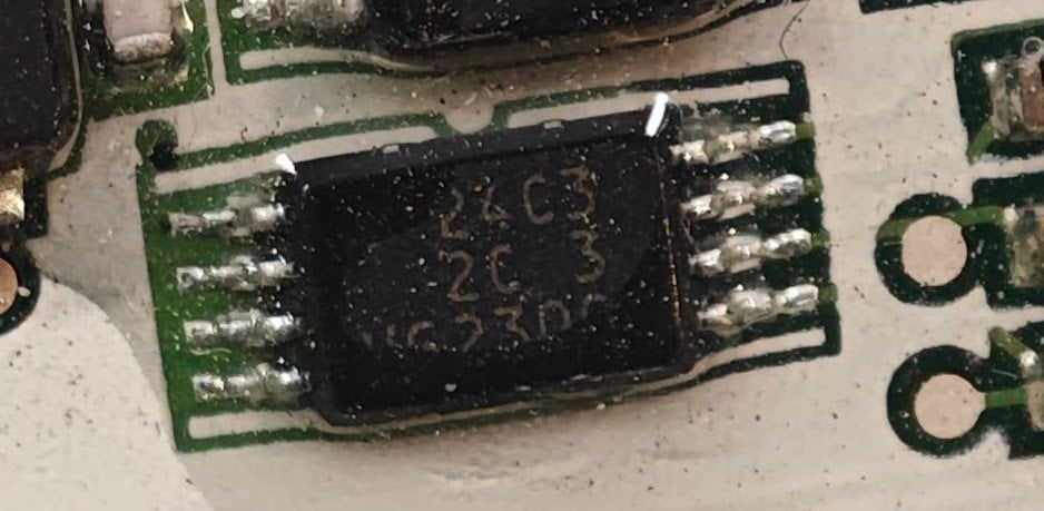

I have a battery with the following issue: the LED near the processor is flashing, and when I press the button, only the two outer charge level LEDs light up. The battery was previously sent to another service center where the cells were replaced, so the BMS is likely locked.
What battery type/model is that? It doesn't seem a Specialized one.
