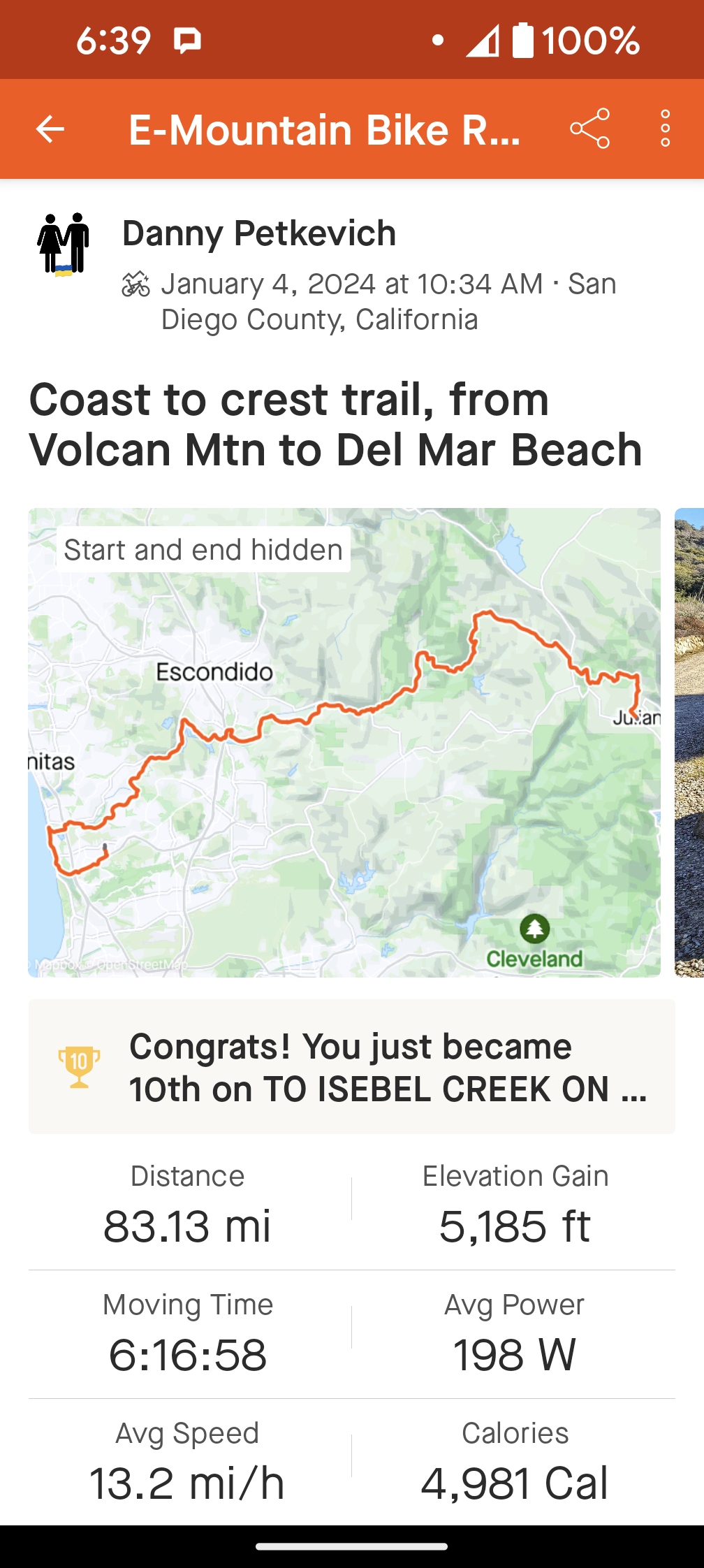

You can get a lot of range and elevation.
I think this has been my biggest ride so far.

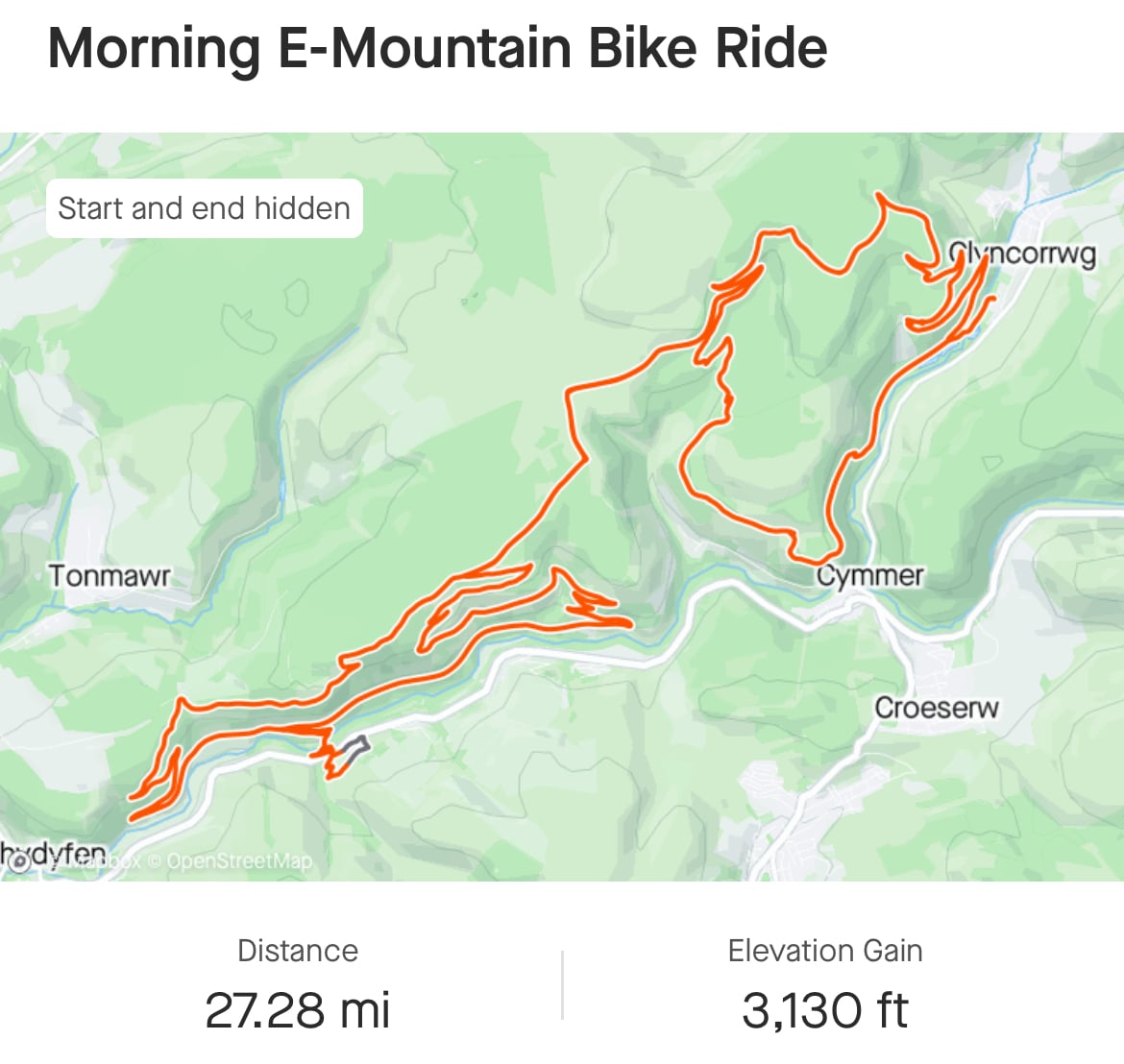

Very variable depending on what setting you use and where you ride. My longest so far 62km, 850m ascent and 30% battery left. So would guess 90km would be possible

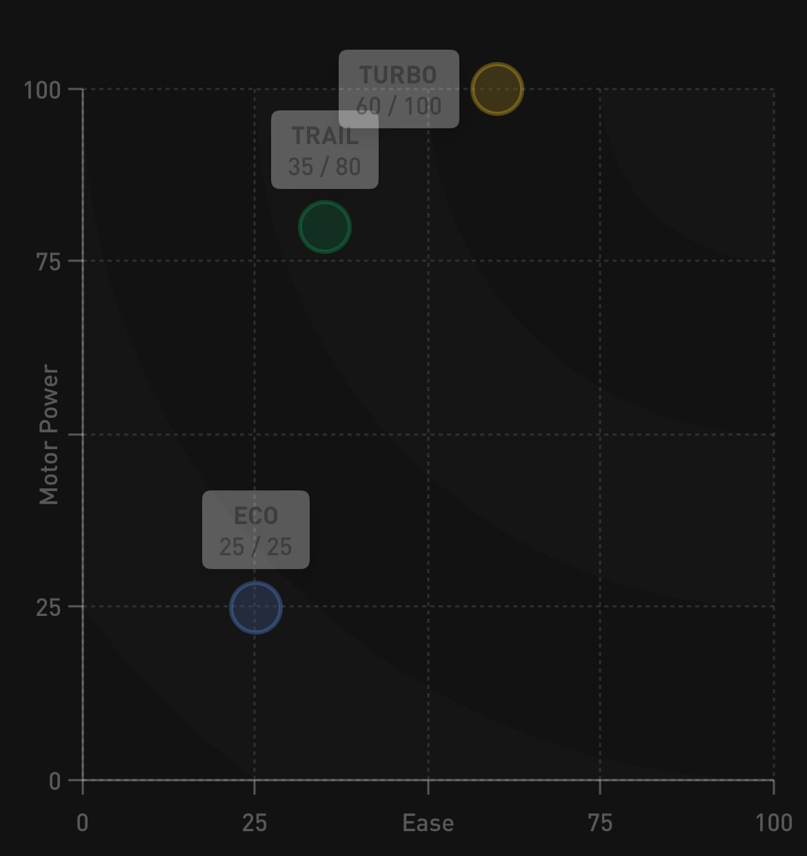

presumably the bike has the Mastermind TCU (I think that was the main difference in model year 2023 over 2022 for the comp alloy), which gives you Microtune. Ady Nash (EMBN) did a video designed to demonstrate that Microtune potentially makes the bike more economical - same motor and battery but instead of jumping from ECO to TRAIL (possibly more of a jump than you need right at that time) you can use Microtune to increase the assistance/peak power more subtly. I had a chat with him about it and he used the analogy of a modern automatic car (say 6 to 8 speed) being more economical (versus its manual counterpart) than the old 3 to 4 speed slush boxes of 30 years ago.

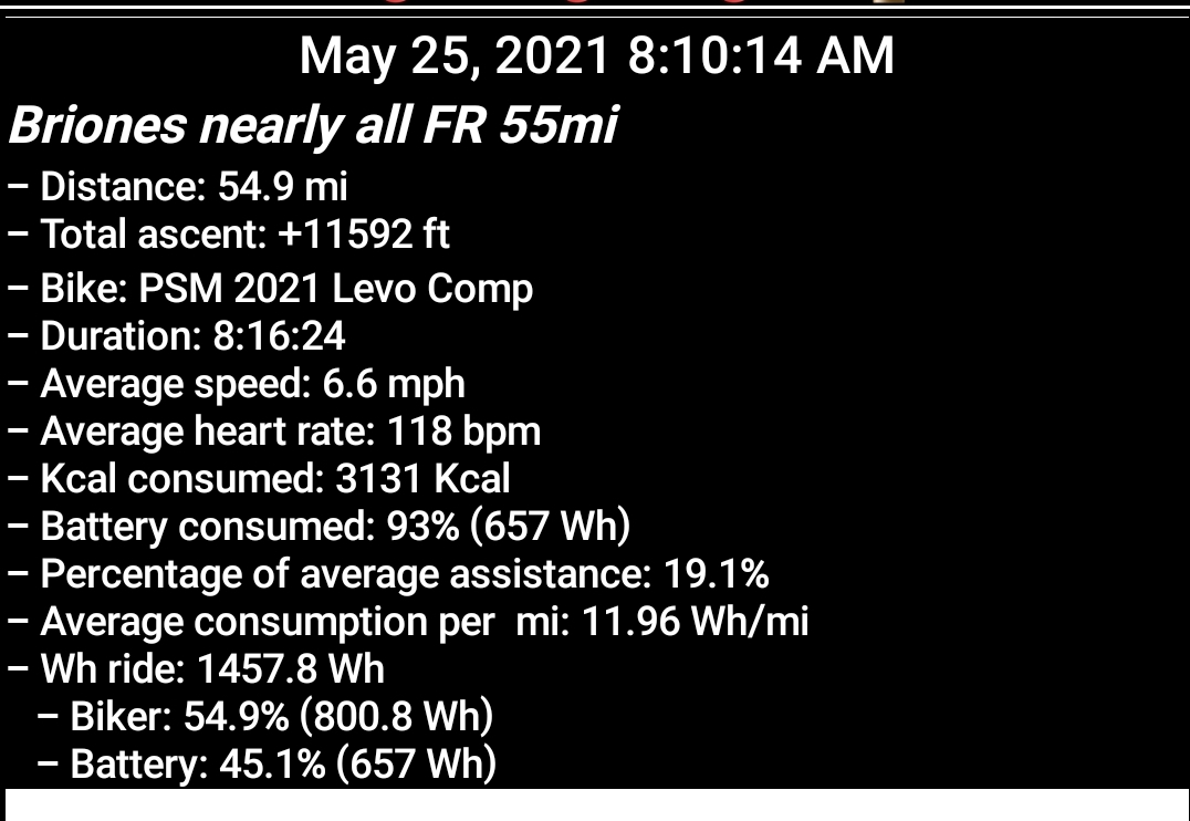

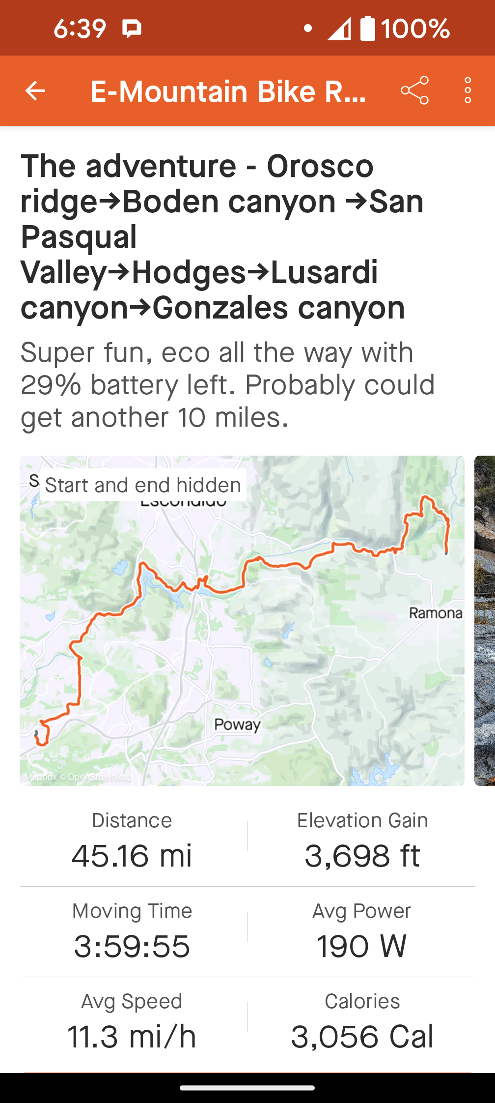

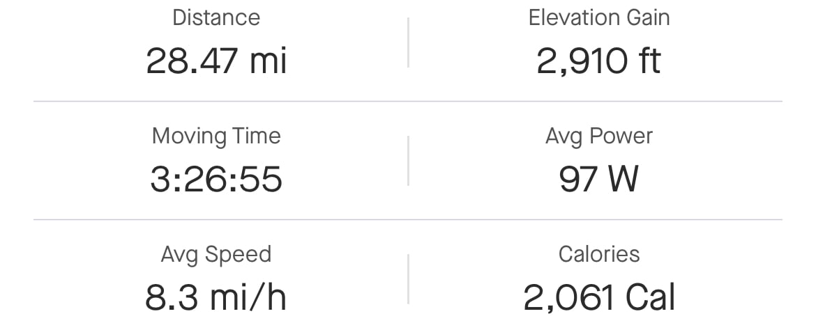

So much dependent on you, your riding style, how much effort you want to put out. My record length on a 2021 Turbo Levo Comp is 54.9mi see data below. I ride without assistance until absolutely required. 175 pound weight, 71 year age at that time. I see it is a bit late as you have already purchased, but you CAN go pretty far in hill country if you have to.

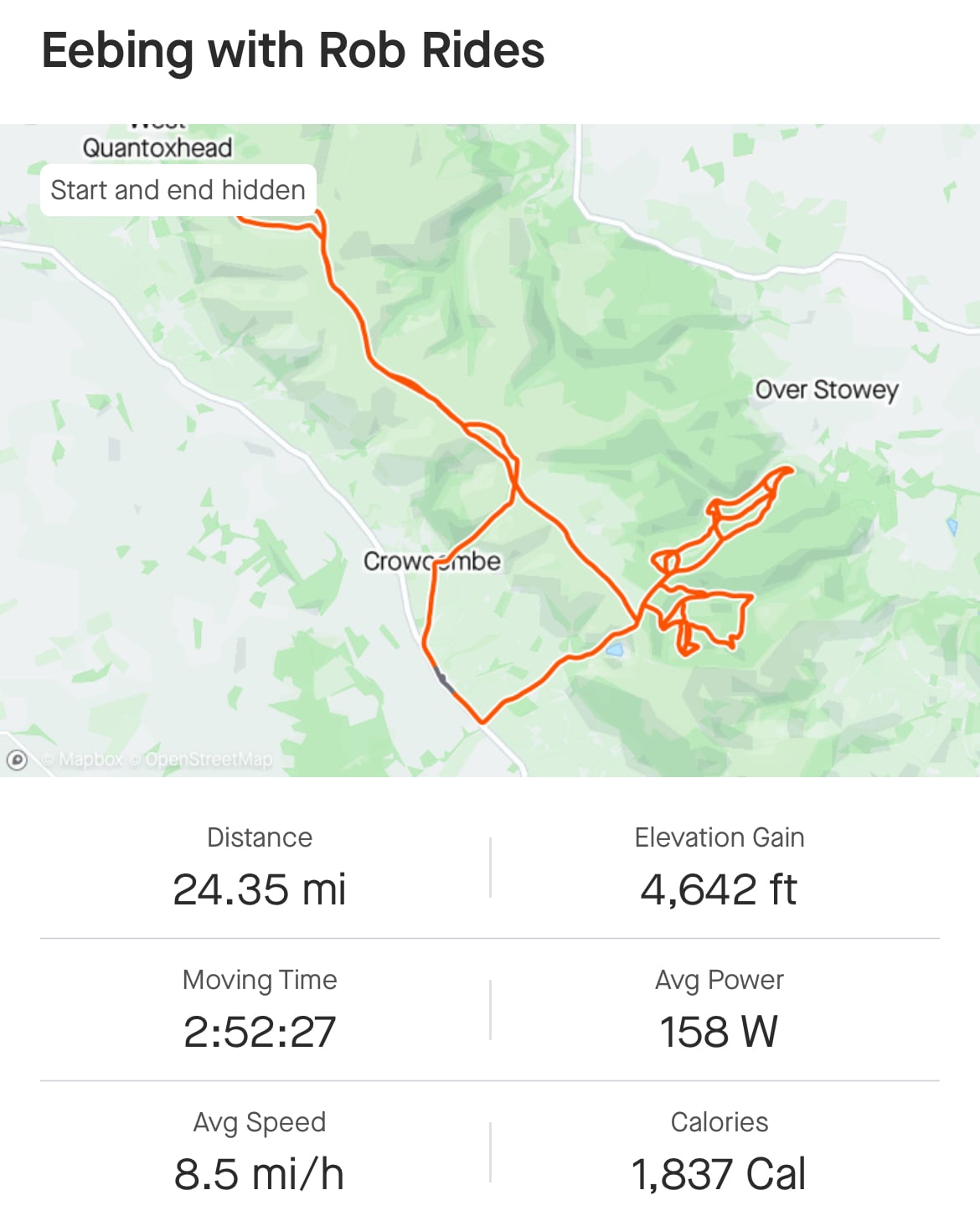

Generally when we do big rides in the Yorkshire dales , we do around 36 miles with 4500 feet of climbing mainly on eco and have around 14% battery left , back home in the cotswolds I would get 42 miles on eco and trail with and the odd turbo mode pressed , with about 2000 feet climbing I would have 20% left

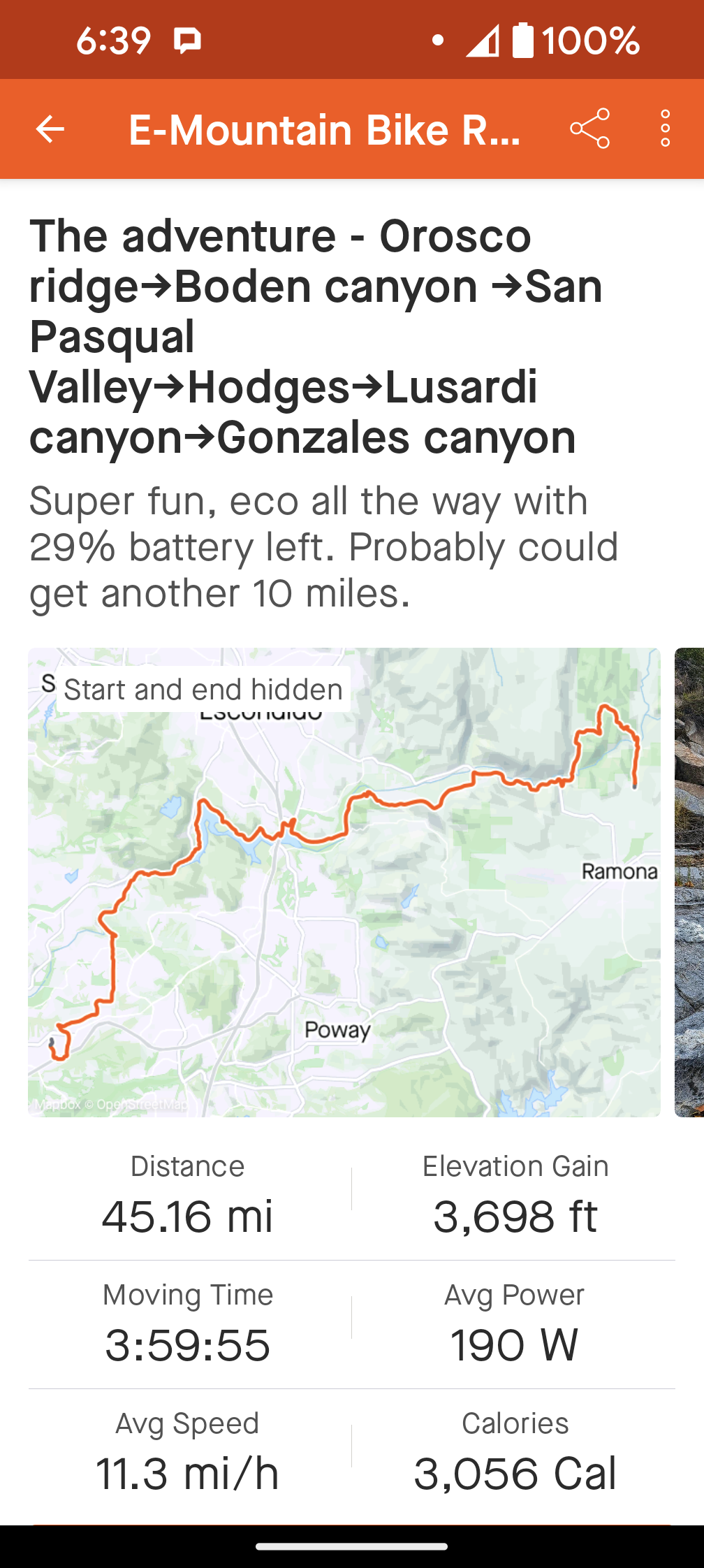

Another big ride today.
This time using the ‘battery friendly’ tune from the black Specialized app.
All on trail.
Finished with 28%

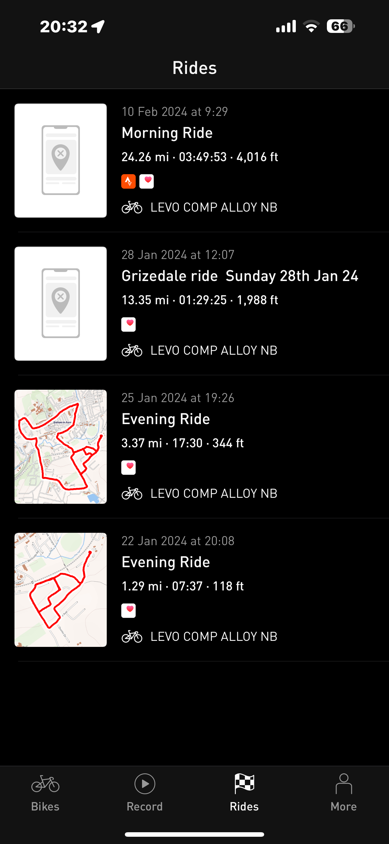

Anyone know why my rides don’t show up on the specialized app? As pic ? Some rides did show up as mapped , but n most recent ones have not, I can click on it and it shows the map, but not just for glancing at it

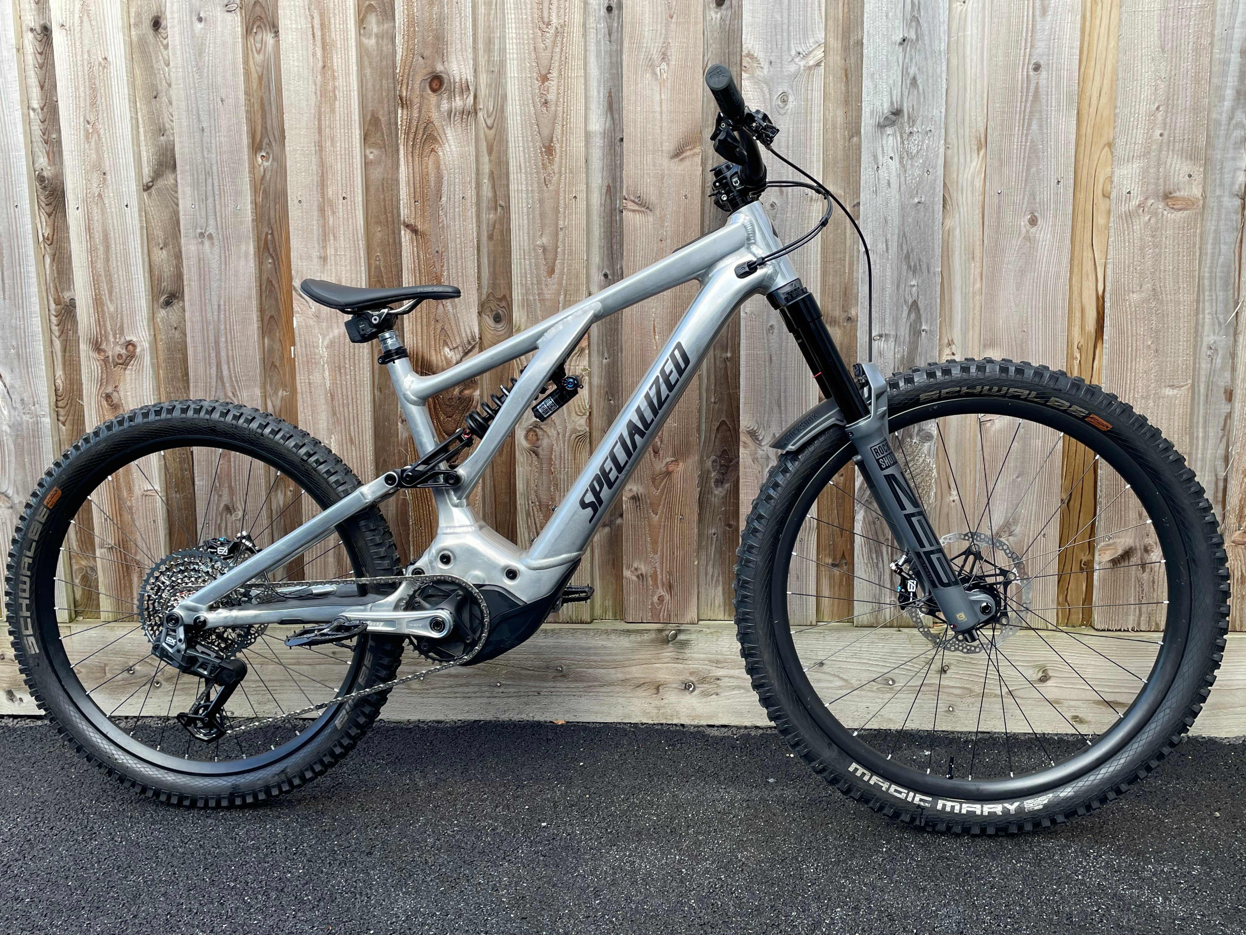

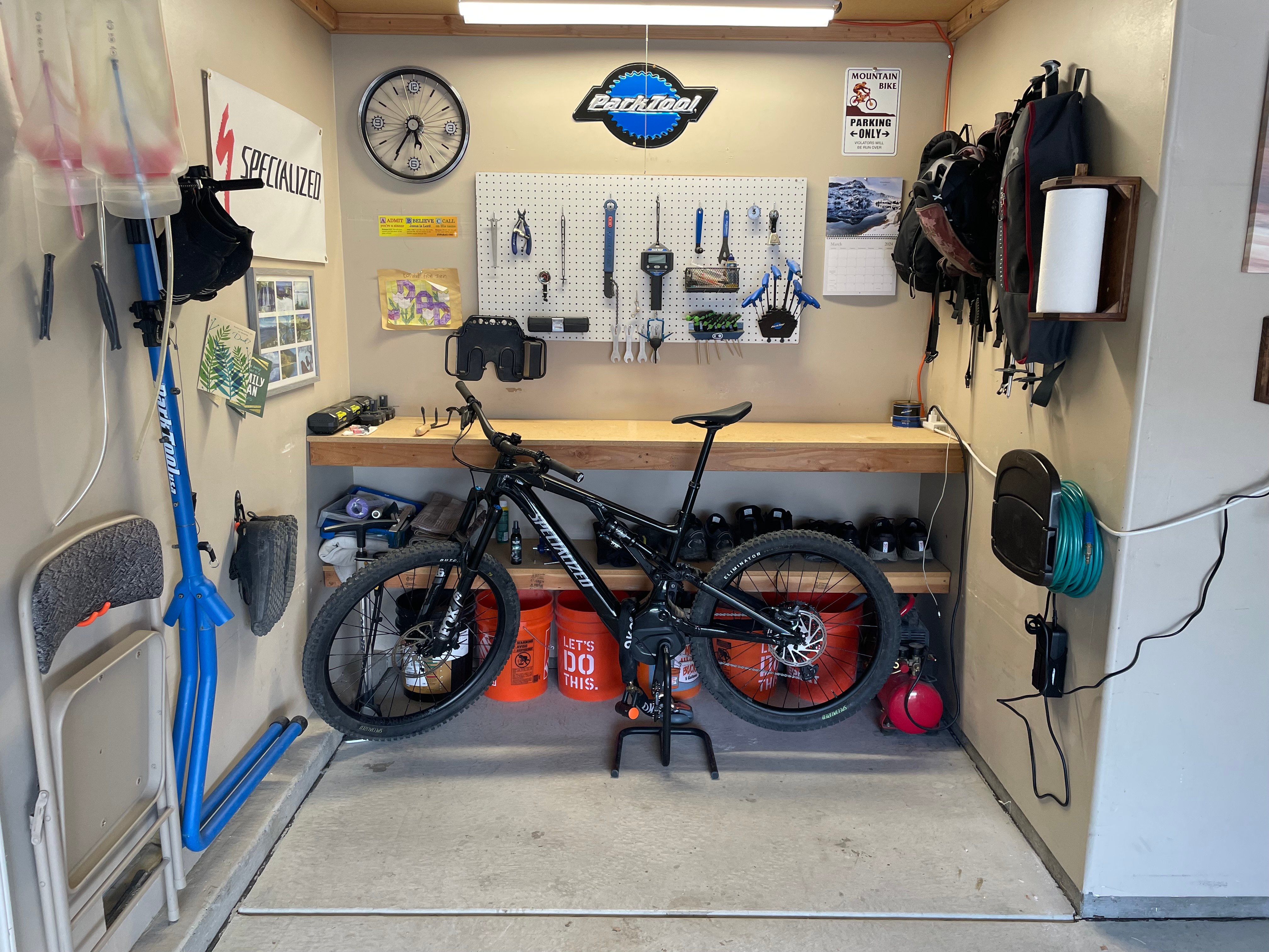

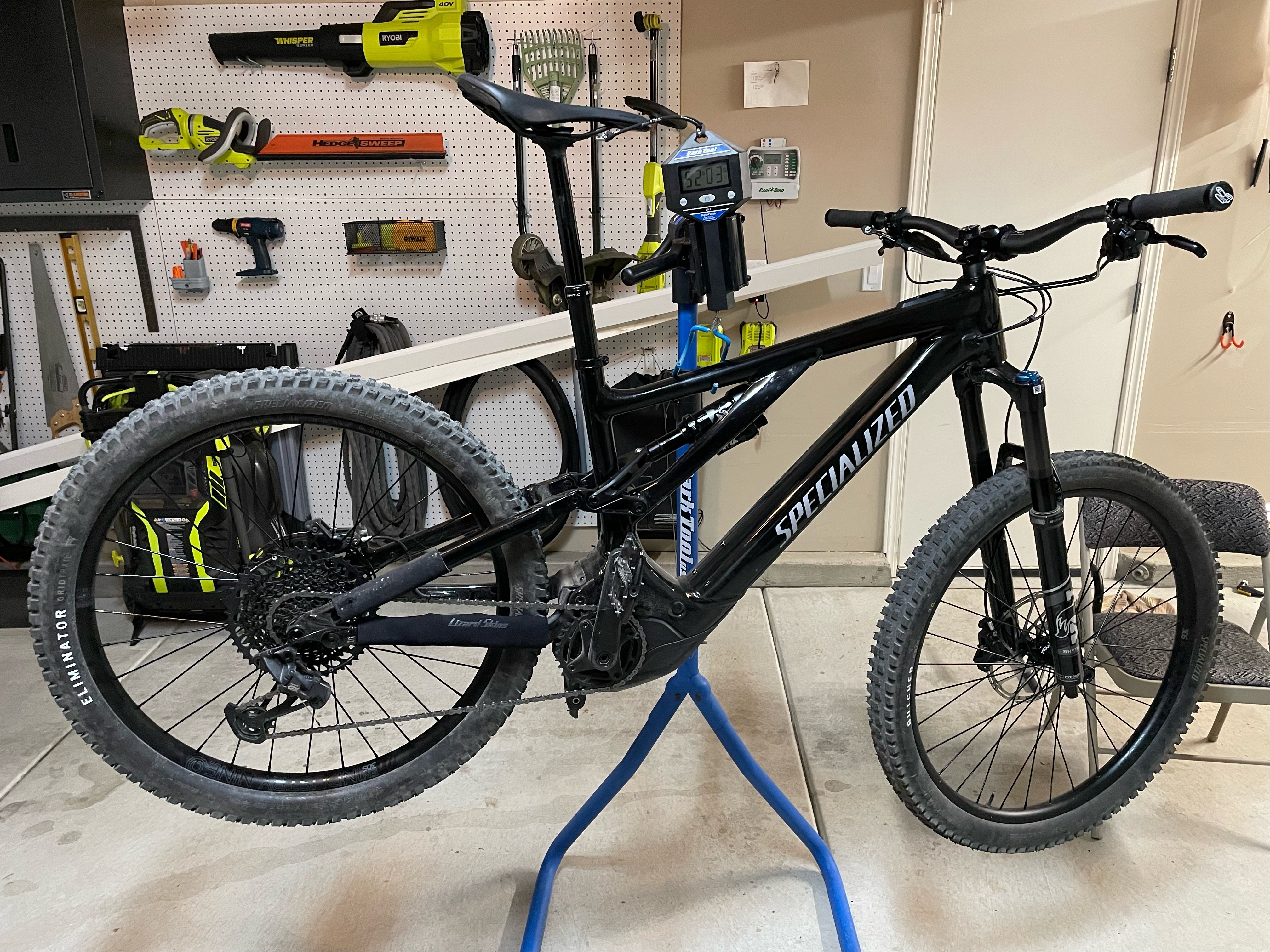

Hello, I recently purchased a 2023 Turbo Levo Comp Alloy and could not be happier! After about 100 hours of riding, this bike is a game changer. It does everything my analog Stumpjumper did but allows me to climb ridiculous trails. I upgraded the wheels (i9), the stem (i9), and installed carbon bars (RaceFace) and flat pedals (WolfTooth). Quite honestly this has been one of best purchases ever. I got a great deal through Specialized @ $5400. As an average rider an old guy at 57 this bike performs perfectly, I have 0 complaints. Weight is 52lbs with the upgrades and tubeless. I am 6’2” and I have an S5, it fits me perfectly.

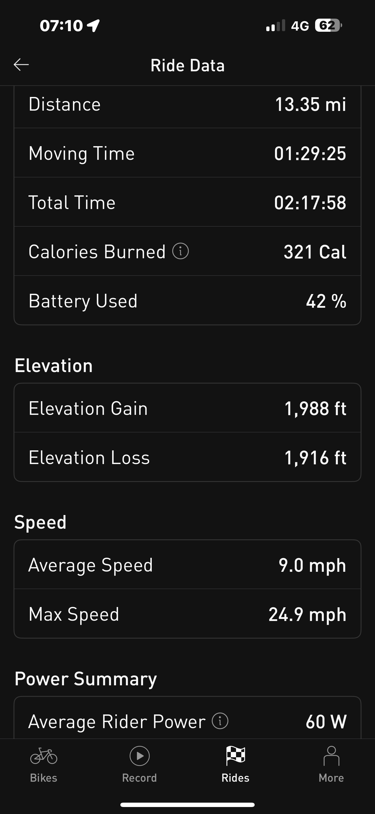

So I’m buying a new e bike. Specialized turbo levo comp alloy. Just wondering what sort of ranges can be achieved with 700 watt hr battery. And also thoughts on the bike itself , ?

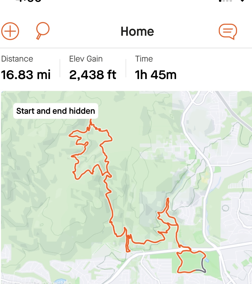

I just did this ride, I started with about 97% battery and finished with 43%. You’ll love your new bike, it’s a blast!
