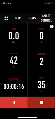

I didn’t hack bike, everything is stock. My mission control looks like this, there is no field for range
Specialized Mission Control does not, nor has it ever, provided for an estimated range display. If you are seeing a field for estimated range then you are most likely using the optional "Ebike" data screen that is part of the Garmin 530/830/1030"s software to be used with Shimano STEPS e7000/e8000 systems and is incompatible with other brands of motors. As has been stated several times in this thread, in order to display battery percentage and assistance in the Garmin Edge device you first must connect your device to the internet using Garmin's Connect IQ app and download/install either the Specialized Turbo Levo Data Field app, which has mixed reviews (mostly negative) or Jan Capek's Ebike Field app that has been quite usable when set up properly in the Garmin Edge device. This will allow you to connect to the 3 sensors listed for Specialized Levos.
IMHO from reading the several threads about this, I believe where 90% of those having problems go wrong is by using optional "Ebike" data screen when setting up the data display screens (shown on page 17 of my Garmin Edge 830 user manual...page number could vary with model and language). As stated under "USING AN EBIKE" this is for compatible ebikes such as a Shimano STEPS, which I believe is the only compatible system with that data screen at this time. To use one of the two data field apps mentioned above you simply select the downloaded "Ebike" data field when "Editing a Data Field" per instructions on page 20 (again, my manual). This will show both battery level and assistance level as a single data field, in the field you are editing.
