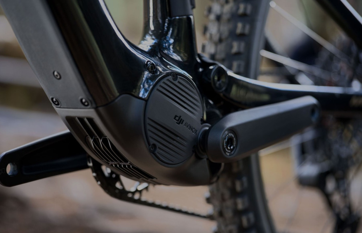

Does anyone know if the 400% support ratio bumped with the power update? Or is that still the max ratio? Just something I have thought about with Avinox offering 800% and rumours of Bosch offering 600% with their May update.
So is Specialized OTA power update 2.0 on its way to keep up with the arms race
Will S bump up to 120nm to keep pace or not bother?
