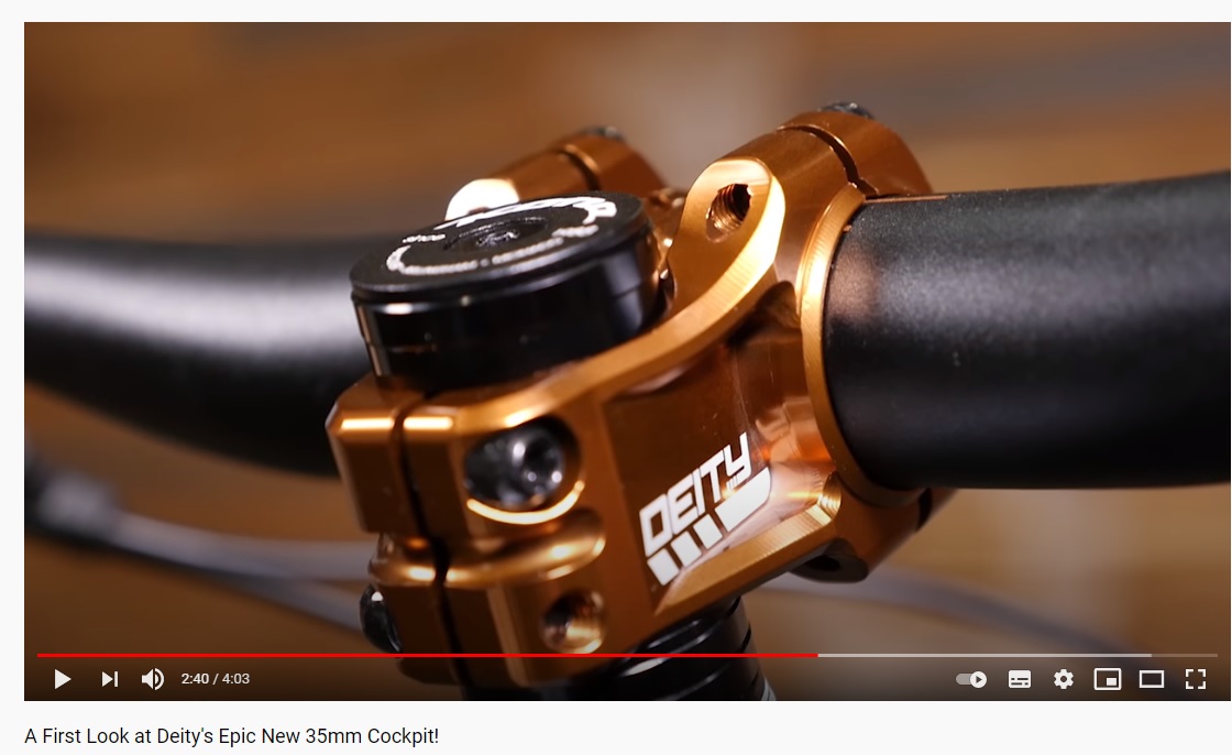

Wouldn’t it cause the bars to move around on hard core shredding?
i just remember the manual stating it should be equally spaced and torqued
same goes for their direct mount stem
i used to have it with zero gap on top like the enve stems and bike shop mechanic pointed out deity should have even gap all around
  • Like
Reactions: CjP
On this video the space is equal above and below. In the manual they should give indications for each type of component or not put anything in order not to create confusion.

Do you think this recommendation present in the manual , is also valid for the Deity Copperhead mounted on the PRO version?
There is nothing written on the Deity website.
I contacted Deity and got this reply, very nice to deal with by the way.
"Our Copperhead stem uses the hardware specs below;
* COPPERHEAD STEM (ALL)
* Face Plate
Hardware - M6 x 1.0P x 18mm
Torque – Per Hbar Specs (4nm - 6nm)
* Steerer Clamp
Torque - Per Fork Specs (4nm - 6nm)
We recommend tightening all stem bolts in either an alternating or X-pattern to evenly disperse the compression stress, and having even gaps on the faceplate as well."

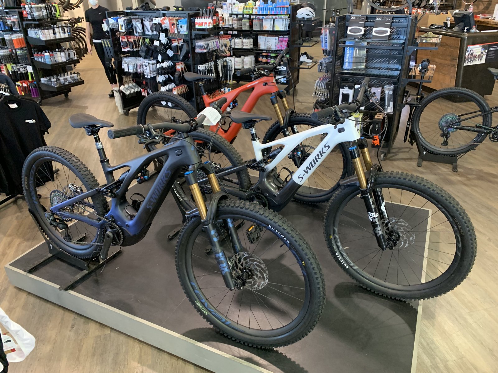

View attachment 59115View attachment 59116
Rydeezie - where is this bike shop? 3 pro and 2 S works. Looks like one of the Sworks has been sold. My lbs got 3 s works and got sold immediately. They only have 1 pro though. Thanks.

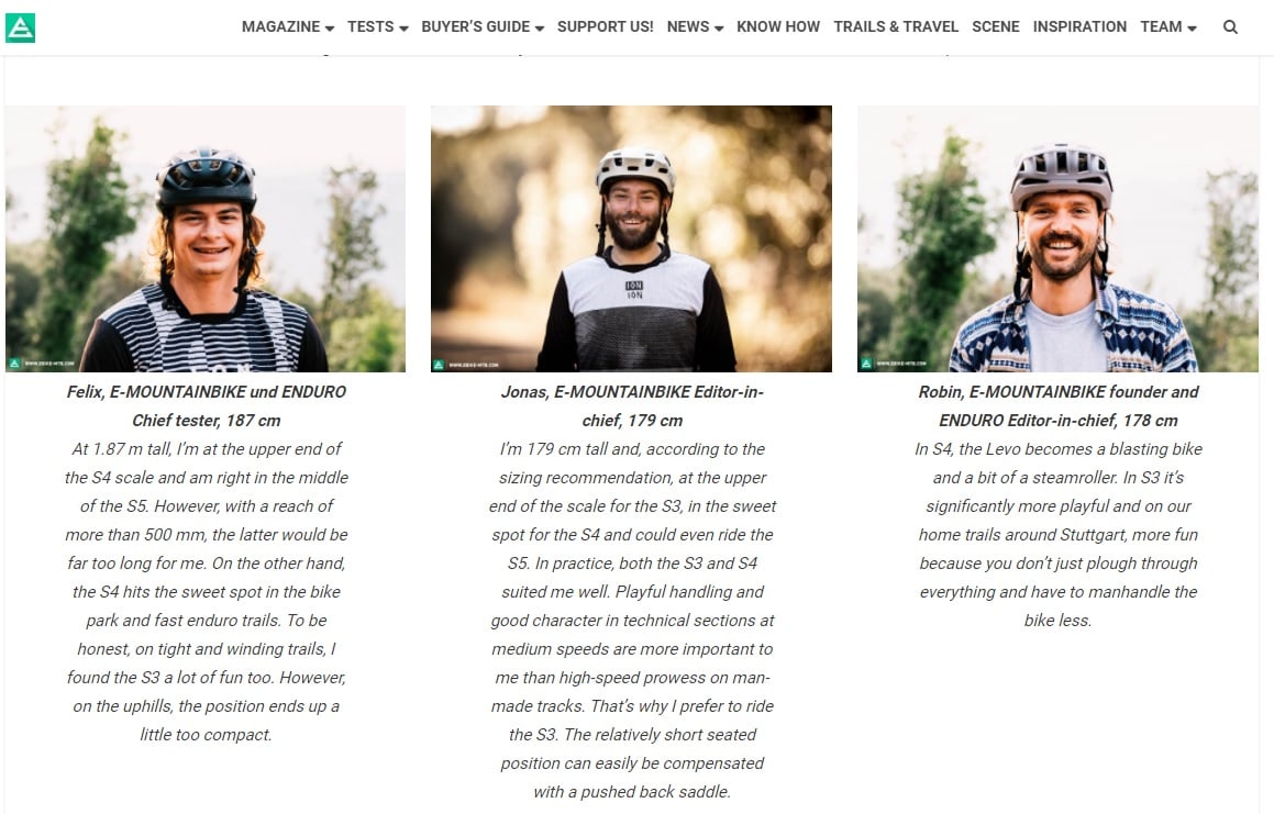

? I am 175 cm tall and I felt very comfortable with an S3 both uphill and downhill. Obviously it depends on the type of trail you prefer. Have you read this article? there are interesting impressions.

i wonder how much S sizing experience do those riders have? S bikes do feel too big if a rider is used to regular sizing
i do fit on an S3. I was leaning towards getting an S3 Levo to have and agile and poppy bike in my line up. It's roomier than my L Levo SL
