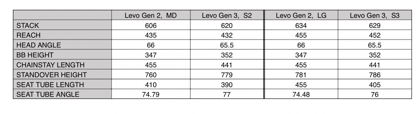

Some geometry number comparing gen 2 Levo and gen 3 Levo. Set up in the steep position using the headset adjuster.
So it doesn’t need to be a slack / aggro trail bike if you don’t want it to be. Reach number in comparison to the nearest equivalent in sizing between the years.

Great chart Rob, can anyone comment how they went from a 2019 Large stumpjumper to a 2022 Levo ... what size did you end up with? The jump in reach of 32mm is a little hard to fathom even with the understanding of steeper seat angles etc..
‘The guideline suggests a S4 is the right size at 5’11” / 180cm but the reach just seems ‘a stretch’.... do I trust the chart?

The good old ETT should be posted in geometry tables, so people would understand sizing a bit better. I went from XL Gen1 Levo to S5 2020 Kenevo. Reach increased 60mm. ETT increased 18mm, but I have a 18mm shorter stem on the Kenevo. So pedaling position is quite close to the old Levo. But Kenevo is all around better, and it's simply the best climbing bike ever and it corners really good because it's so well balanced.

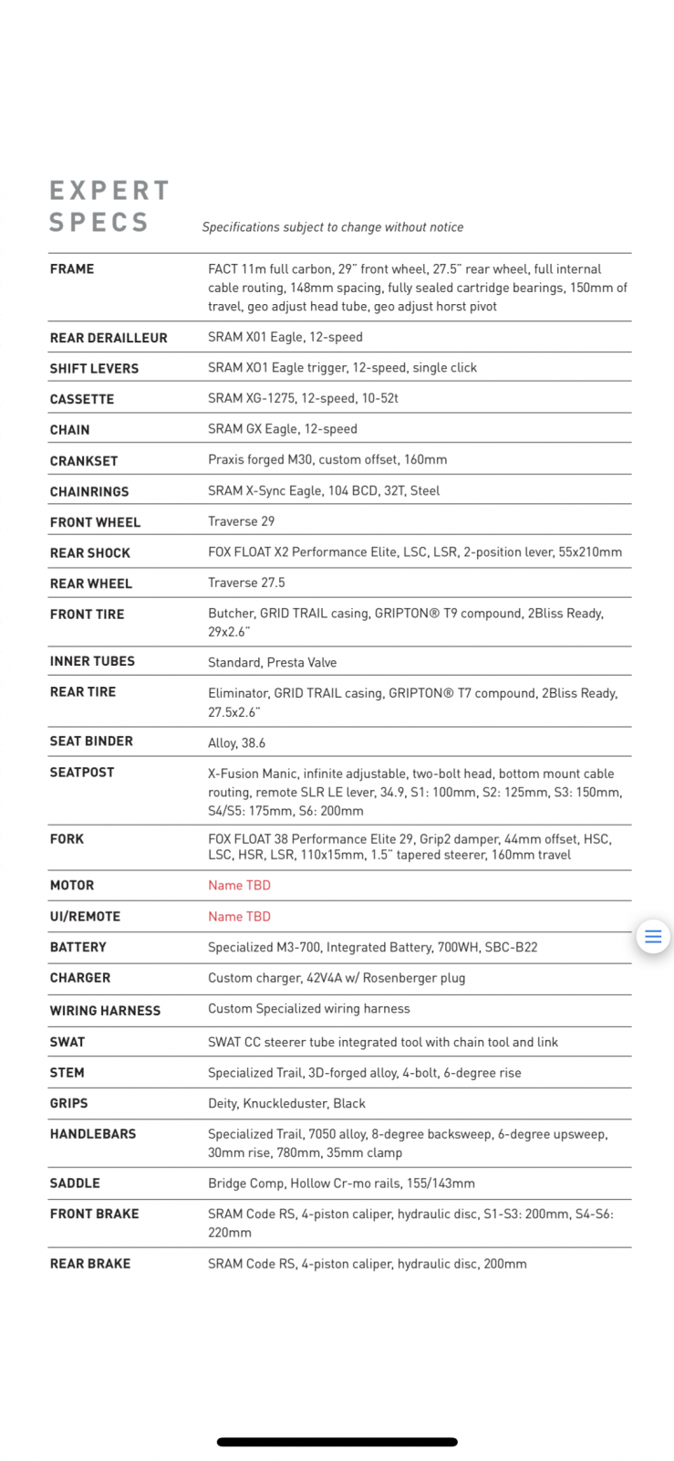

Here’s the full Expert specs. Coming this summer. Suspension is going to feel pretty identical, it’s the Performance elite stuff which is basically the same internals just without the Kashima coating.
2022 Gen 3 Specialized Turbo Levo Expert:

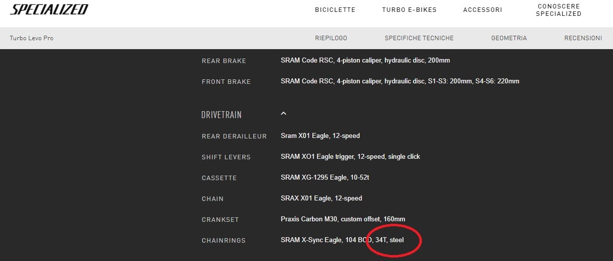

Strangely enough, both the Pro model and the Expert model have the same gear components, but chainrings with different tooth numbers. I would rule out that the engines have different specifications. :unsure:
Not only that, cranks aren’t carbon, cassette is GX as well as the chain on Expert.
