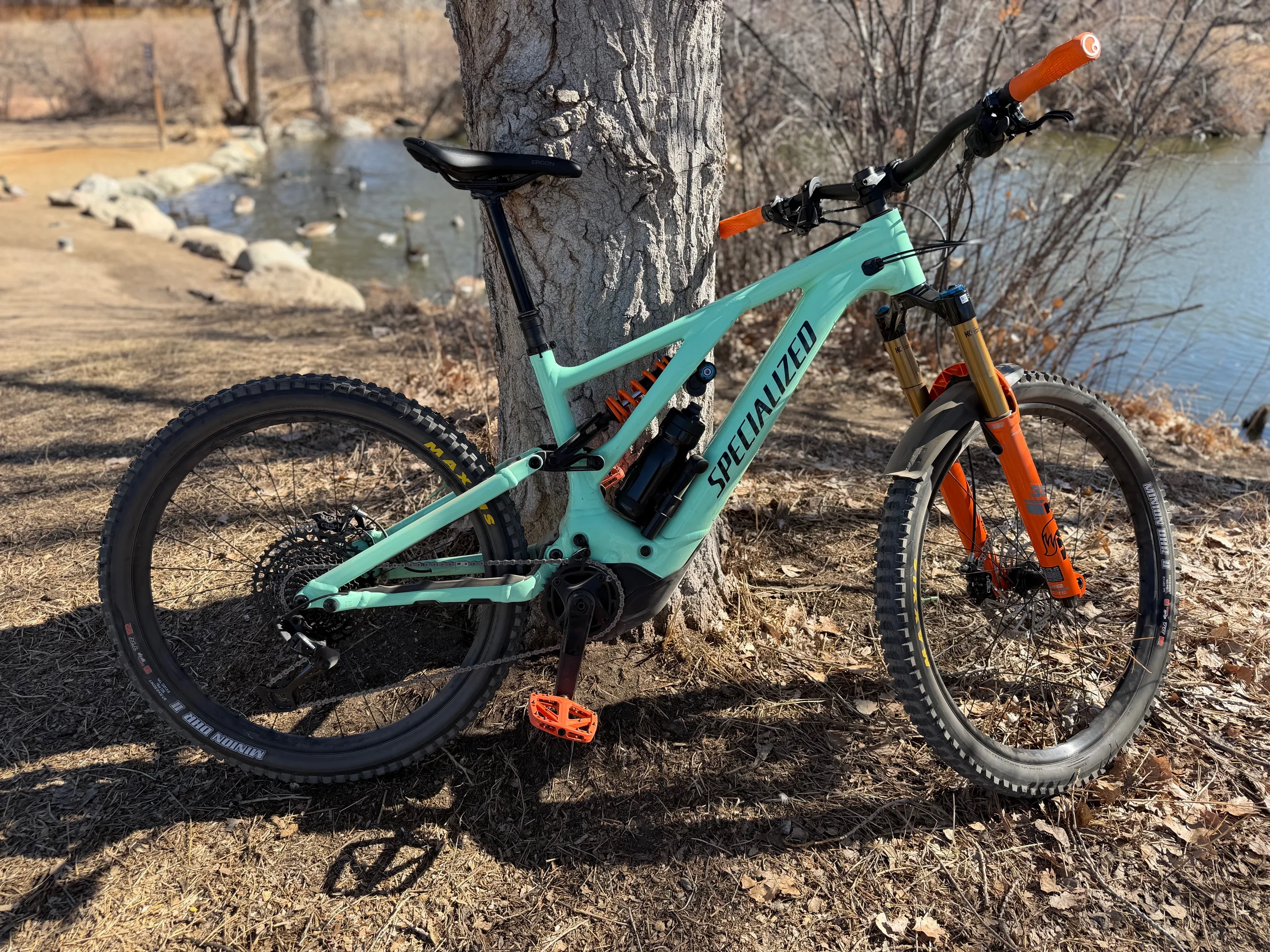

Glad I found this forum! Just bought my first ebike. A used 2022 Levo 3 Alloy with 250 miles/10 charge cycles and 6 months left on the warranty from a neighbor. Super stoked and put 2026 X2Grip 160 and the new 2026 DHX2 coil (600 spring) with the thicker shaft. Immediately upgraded the brakes to Hope GR4s and I am loving everything about it so far! The weather here in Colorado has been phenomenal for winter, so I've been able to get out on the trails a bit. Can't wait for summer up in Breck! If you're in Colorado, I highly recommend working with Ethan up in Boulder. He owns Dirt Merchant and was very helpful with my build!

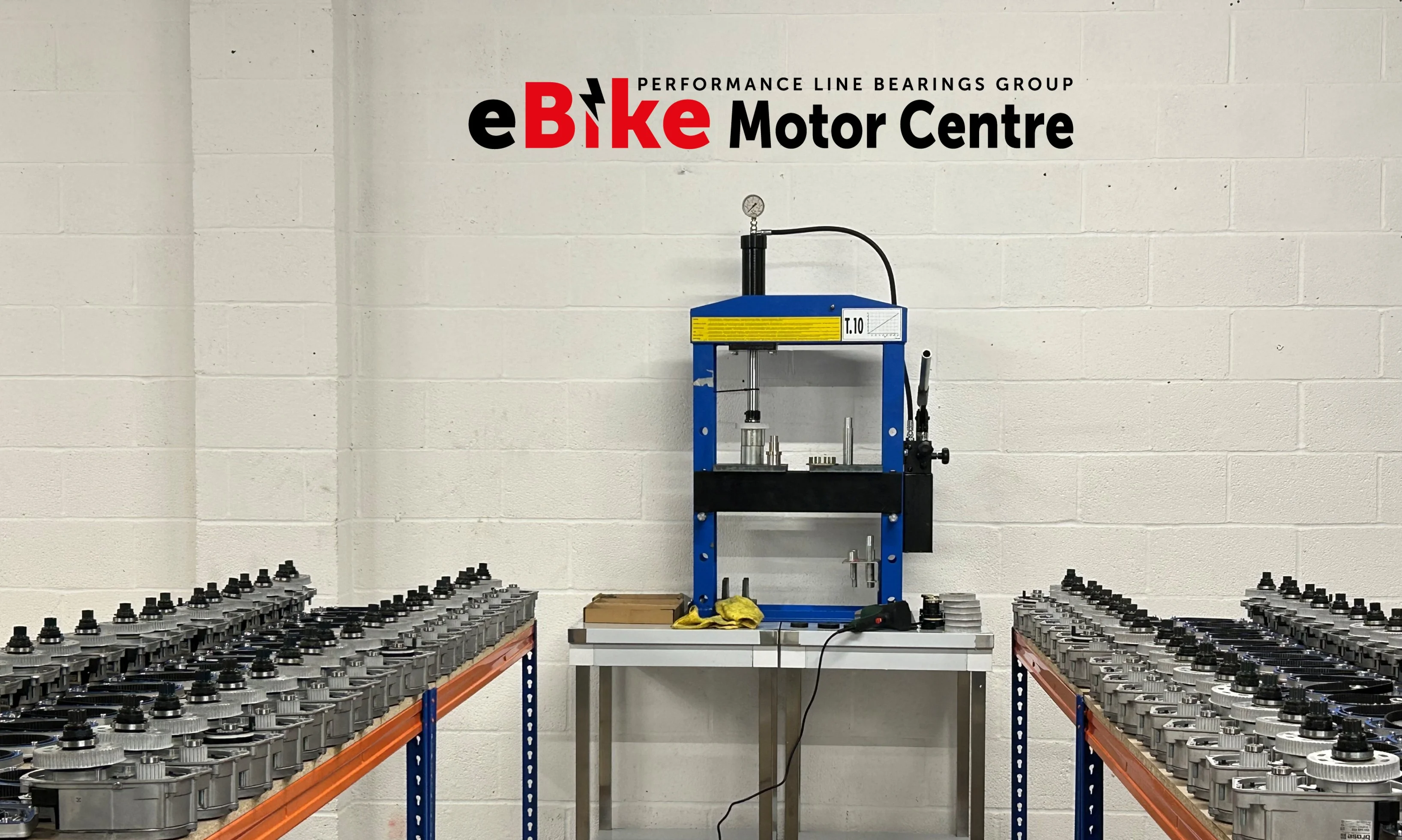

As the Brose warranty service centre for the UK and the trusted Specialized service centre for their after-warranty motor repairs... I would like to put the record straight. Brose tend to implement rolling changes without changing the motors designation or serial numbers. Over the last couple of years that have added extra sealing, changed the material of the planetary gears and ring gear for extra strength. Changed the sun gear belt pulley from magnesium to aluminium and altered the internal bearing position for added strength and less wear. Added a steel collar to better support the large belt pulley main bearing better, changed the belt from Gates to Dayco (which is definitely lasting well). Updated the software to give faster torque response for smoother linier acceleration, better light control for high power lights. The range calculation algorithm has been optimized, and new CAN battery diagnostics has been added.
With regards the belt, it should be classed as a "sacrificial" part. Most motors out there have at least one part that is weaker than the rest. In the event of a serious pedal strike, or crash, the motor can be massively overloaded with forces going through the crankshaft and internal drive train way higher than the design tolerances. If the motor was designed to take these impacts, it would need far larger, stronger parts internally, and these parts would weigh significantly more, resulting in a larger heavier motor. Brose is one of the only motors where this part, the belt, can be changed relatively easily and cheaply. For example, many other motors use a plastic gear which is expensive, difficult to change or completely unobtainable.
Also, the Brose motor can be further strengthened and upgraded by us at eBike Motor Centre or any of our partners Worldwide.
Picture below showing new Alu motors being upgraded by us for hire fleet work.

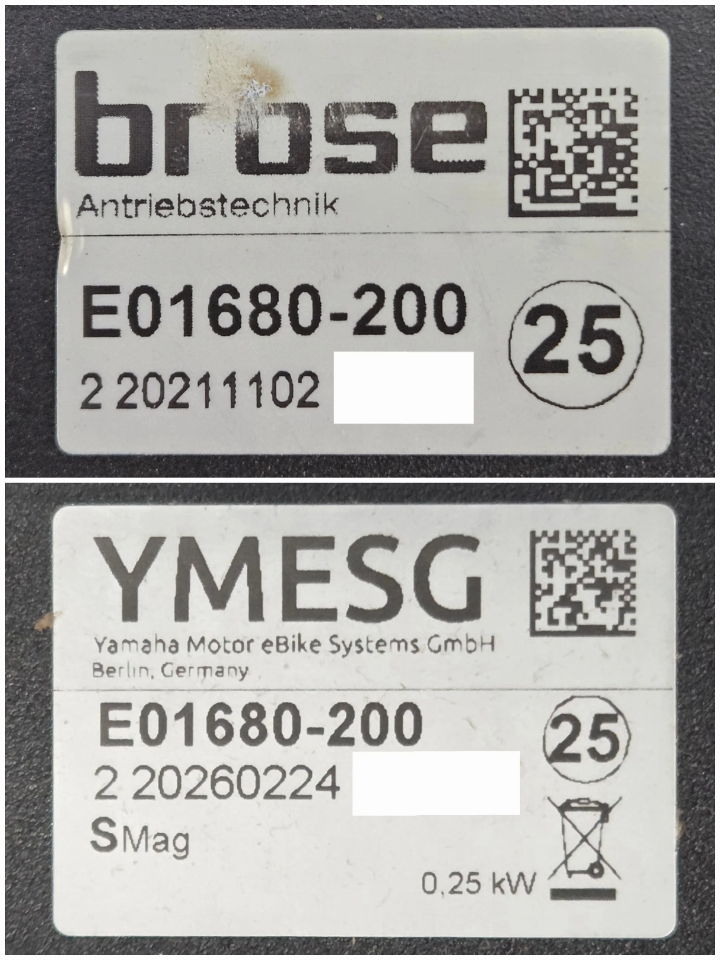

@Bearing Man
I did a preventive service of my 2022 Levo motor at one of your partners last year. Great customer service by the way. My picture heavy review here.
Unfortunately, after around 500 km my motor failed (this happened). I sent the motor to the same service center for repair, but sadly the motor got lost by the carrier during return shipping.
I was desperate to get back on the bike, so I ended up buying a brand new motor instead. The label says production date February 2026.
Since you mentioned the rolling changes and upgrades Brose has been implementing over the years, I’m curious what improvements this latest version has compared to my old motor produced in November 2021?
Are there still any known weak points in the newer motors that are worth addressing preventively in your shop, or have most of the earlier issues been resolved by now?
Motor labels:

@Bearing Man
Motor labels:

Sorry for my late response. There have been a large number of changes since 2021 to 2026.
An internal seal has been added to the drive side of the crankshaft.
Planetary gear material has been changed.
Ring gear material change.
Small belt pulley material change.
Large belt pulley material change.
Drive belt change.
Large pulley bearing collar fitted.
Several software changes and updates.
Internal torque sensor pick-up change.
And probably a few more I can't think of right now.
We can still improve on this motor, we still add two more layers of sealing, tougher sprag clutch bearings and some exotic lubricants etc.
