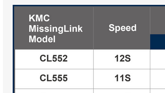

Thanks, any chance for a link to a suitable part? I got lost and couldn't find anything useful in Amazon
RebornRider
May 31, 2019
581
588
NorCal USA
Amazon
