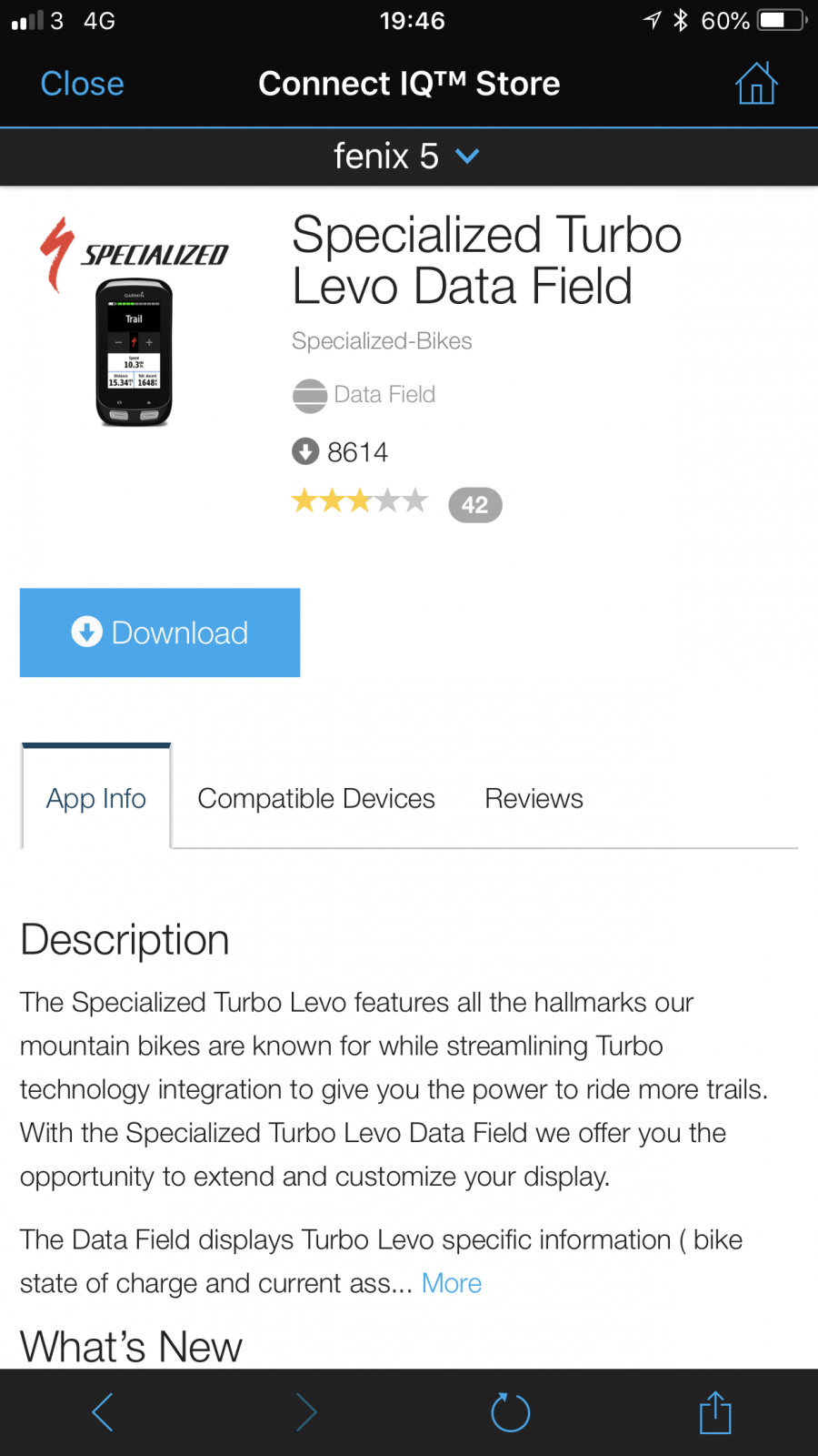

I would probably say your Ebike needs to supply an ant+ and/or Bluetooth signal, then it should work fine with your garmin as StuR has said, I’ve a levo which has a dedicated data field via iq for certain garmin but doesn’t work with all, I’ve ok with my fenix 5/edge 1000 but not my vivoactive 3.

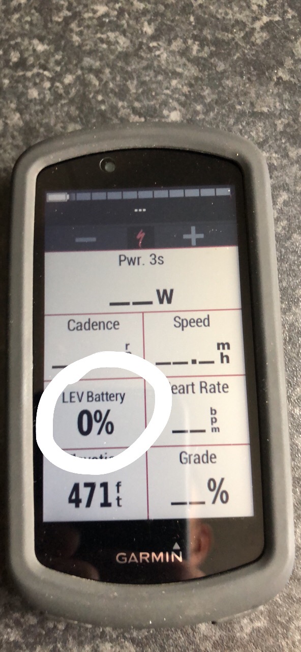

Have sussed it. You can select the app as just a small data field as per photo here and it just gives you a percentage field. That’s what I was after. Found it by mistake. Percentage more useful
