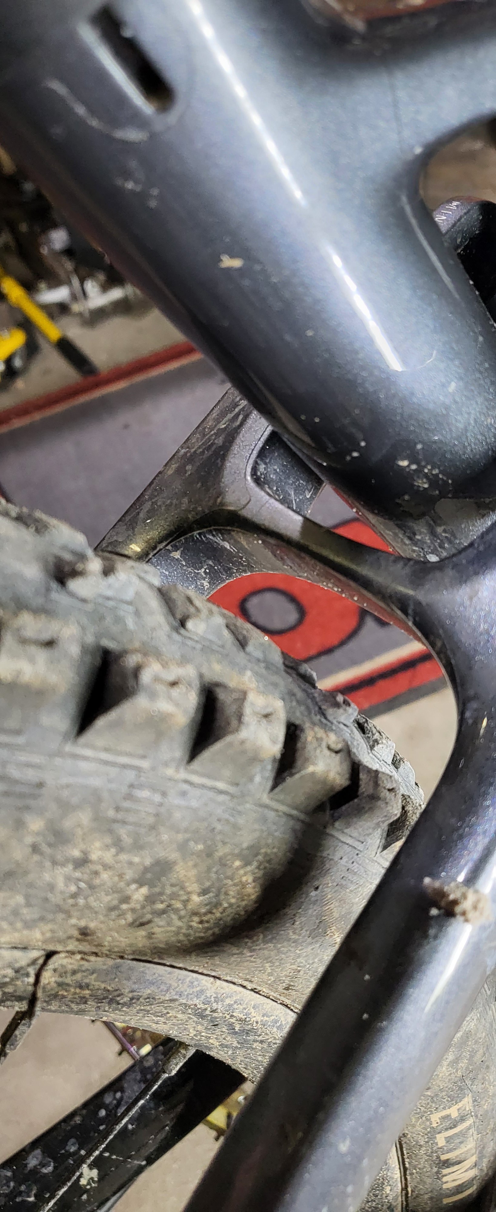

There may be a reason why the RS stuff is not as adjustable as the Fox in terms of travel. It may be to do with a hydraulic stop on the rear. I have stroked my 9.7 Fox stuff to 65mm (152mm) in the rear and 160mm in front. Both with good results. I started a suspension only thread so it may be good to park your results there.
The 9.8 Lyrik Select Plus fork can be extended to 160mm but you'll need the airshaft for this. They were limited in availability for a while after sale but should be accessible now.
With the RS Super Deluxe Select shock I couldn't tell you if there are removable spacers to extend travel. I will say that its performance is beyond its pay grade. I find it to be a very smooth shock out of the box, and I'm also running Factory X2 shock and Kitsuma coil on other bikes.
It delivers its 140mm very well, but I can see why you might want a touch more travel at the rear.
I've been tempted to get a 65mm stroke shock for 153mm travel but it feels risky. Not sure I'd notice the 6mm travel difference from a 62.5mm stroke shock.
Interesting to hear you've gone the extra 5mm stroke at the rear.
What size frame is this on as I hear clearance is frame size dependent?
Is the difference notable, and any downsides? No risk of overextending the linkage?
Size large. Cycled the stroke with no pressure and don't see any overly tight clearances. I am not a jumper- so there is that. In general just more stroke to stay away from the extreme ends of travel. So cushier. Maybe nearing the inevitable Slash EXe?
Very interesting, mine is XL, and I'd run it in high if I went this route.
I do jump from time to time on mine (and I weigh over 105kgs) so would like to avoid overstressing anything on the bike.
Thanks for the info!
How did you stroke your fox float X to 65mm? Did you do something more than take out the volume spacers?
Take the air can off. Inside you will find bright orange 2.5mm "C" shaped shims screwed in with M3 flat head screws. You can remove either 2.5mm or 5mm of shims to allow the shock to go from 160 to 162.5 or 165. You will need to get shorter 3mm screws depending on the travel you choose.
There is a vid on YT if you search a bit.
Here is a pic of my Large fully compressed after removing the 2x 2.5mm shims.
