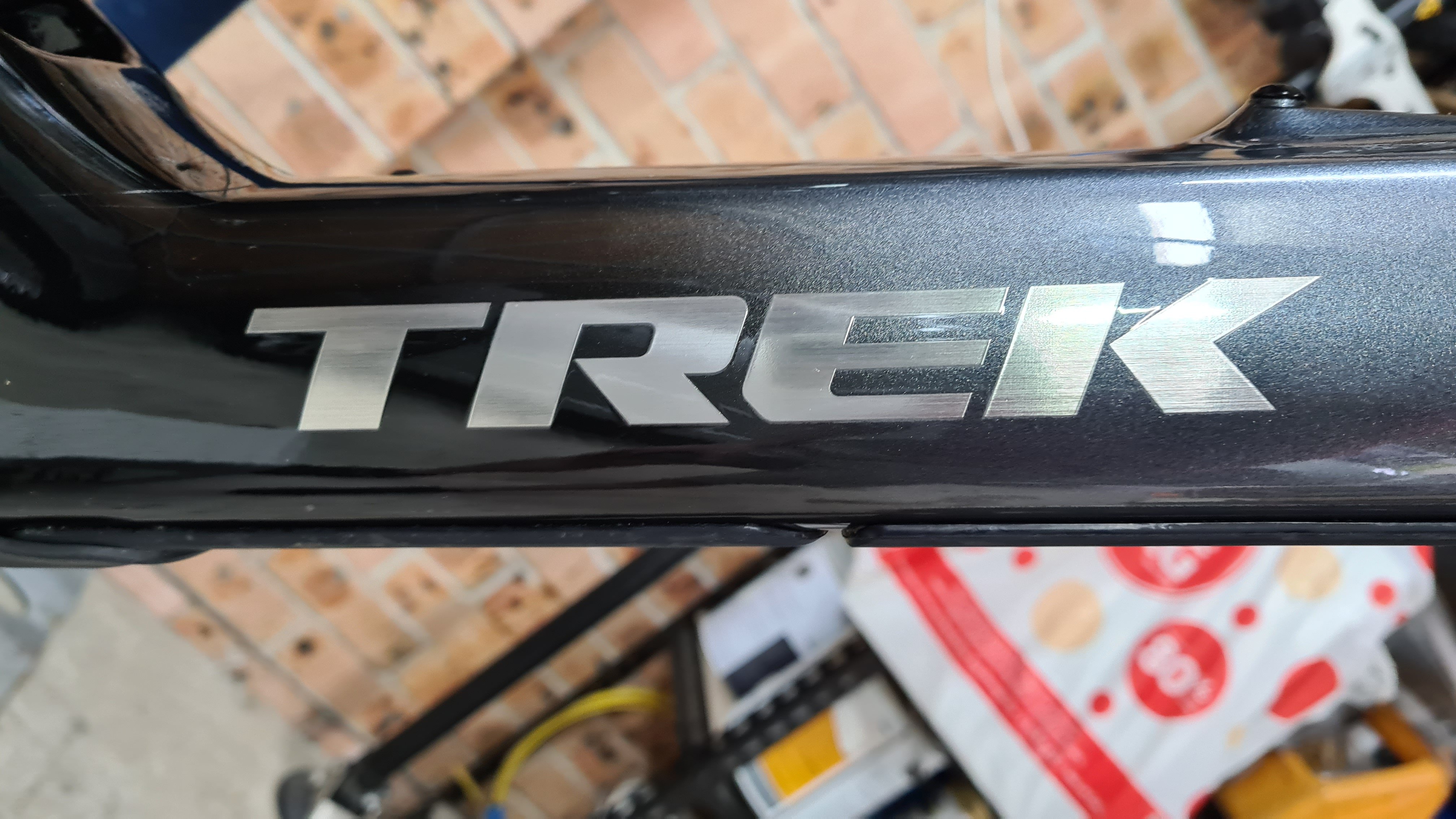

Hi - I have just ordered a 9.7 in Galactic Grey to Black Fade - am going to cover with ride wrap. Looking for recommendations for gloss or matte wrap? The pictures of the 9.7 colour on the Trek Website look matte - can anyone with a 9.7 in that colour confirm?
I have that exact bike and I wrapped mine using Gloss. For me the paintwork is a bit metallic and what I considered to be on the gloss side of things. I am very happy with the way it looks. (I am in Australia and purchased my kit via a local company called Frameskin). I also purchased some extra film to go around any exposed bottom bracket areas as I found the topcoat seems very soft and was showing scuffing and scatches very readily. Hope this helps.
Any pics?
Any pics?
Apologies, I haven't taken many pics of my bike... I will clean the bike on the weekend and try and get some good shots outside in decent lighting. But here are a couple of random (indoor) pics I currently have on my phone. The one with the wheels off looks very shiny but that is due to the ceiling downlights on max as it is when I was actually finishing applying the protective film. Outdoors in sunlight the gloss film looks quite balanced and not too glossy (in my opinion). There is one close-up to try and show the speckled finish of the (grey) paintwork. Hope this helps.
View attachment 104513 View attachment 104514 View attachment 104515
Thanks that was really helpful
Mate, absolutely nothing wrong with those pics!
I really like the look and shape of these bikes. Keen to see the new Transition Relay too but one of these is on the list of possible buys for sure.
